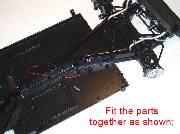

STAGE 32:

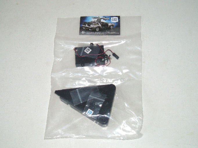

These parts will allow you to fit the fuel tank and battery box.

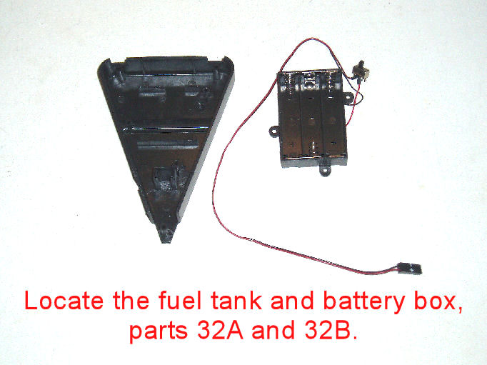

Locate the fuel tank and battery box, parts 32A and 32B.

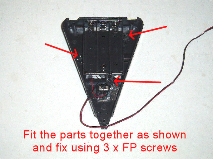

Fit the battery box inside the fuel tank, positioning the switch in the rectangular fixing turret and run the long wire out of the slot in the side of the fuel tank.
Fix the parts together with 3 x FP screws.

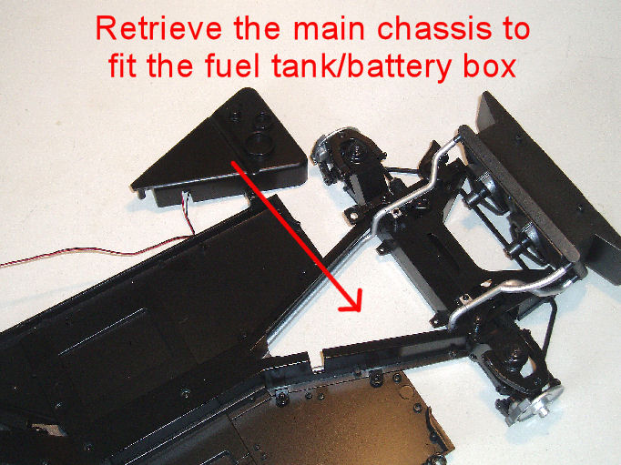

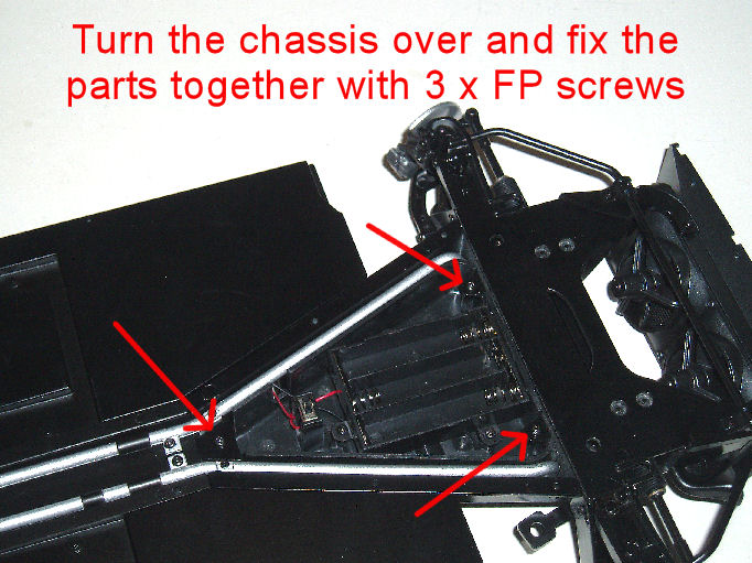

Retrieve the main chassis assembly and fit the fuel tank/battery box into the triangular space behind the front wheels.
Turn the model over and secure the parts together using 3 x FP screws.

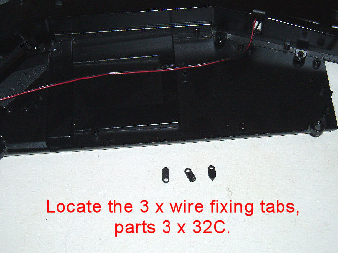

With the chassis the right way up, run the long wire along the floor, fitting it between the locating posts.
Locate the 3 x small fixing tabs, parts 3 x 32C.
Fit the tabs into the locating posts and secure with 1 x KM screw in each tab.
The tabs will only fit one way round.

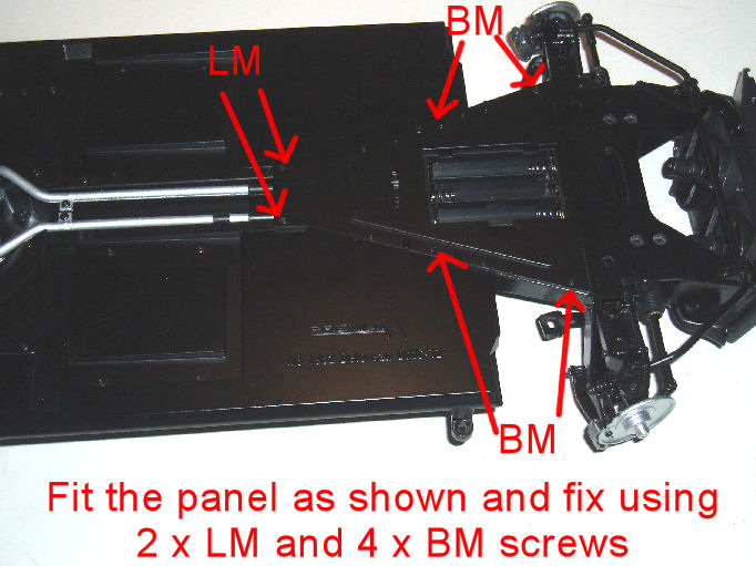

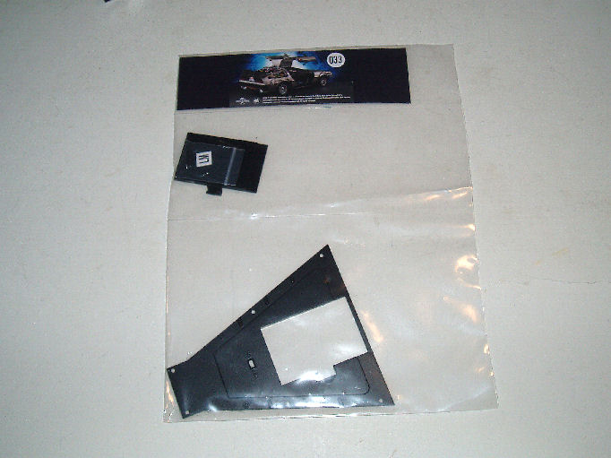

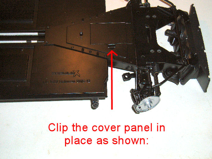

STAGE 33:
These parts will allow you to complete the fuel tank and battery box.

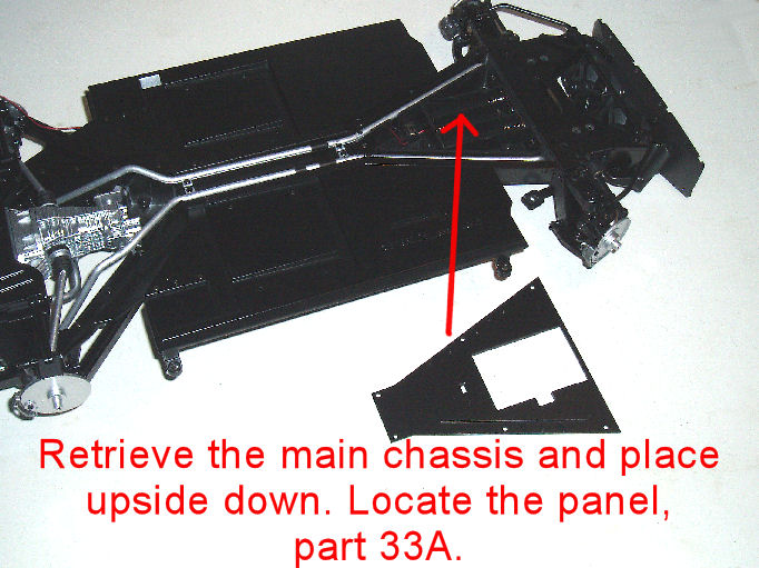

Retrieve the main chassis assembly and turn it upside-down.
Locate the fuel tank cover panel, part 33A.
Fix the panel in place using 4 x BM screws and 2 x LM screws.

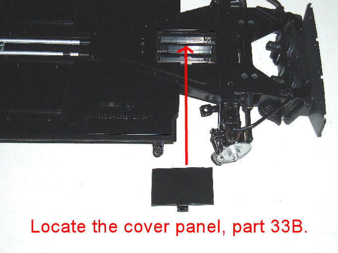

Locate the battery box cover panel, part 33B.
Clip this in place over the battery box opening.
The part will only fit one way.

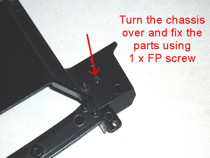

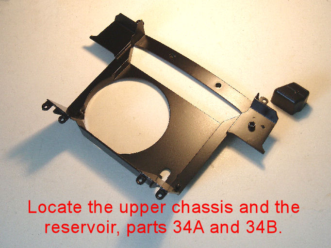

These parts will allow you to begin assembling the upper front chassis.

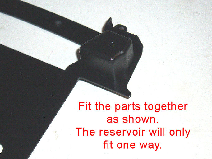

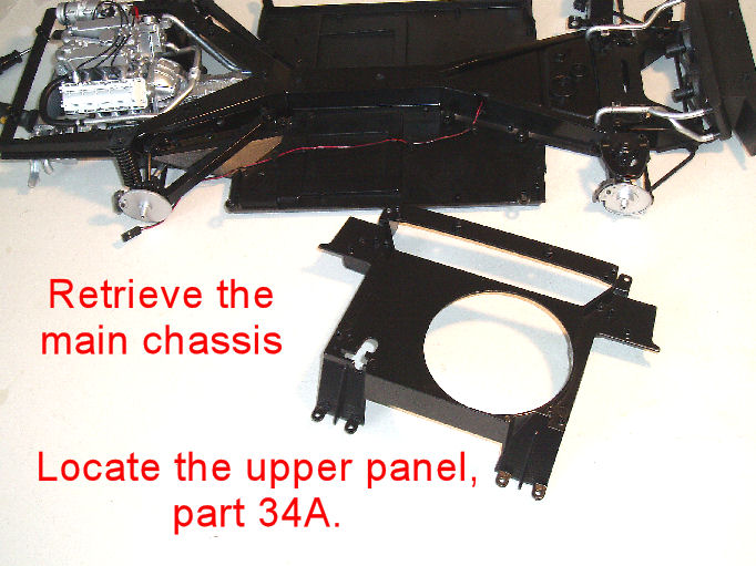

Retrieve the main chassis assembly and locate the upper panel and reservoir, parts 34A and 34B.
Fit part 34B onto the front right corner of the upper panel. The part will only fit one way.
Turn the assembly over and fix the parts using 1 x FP screw.

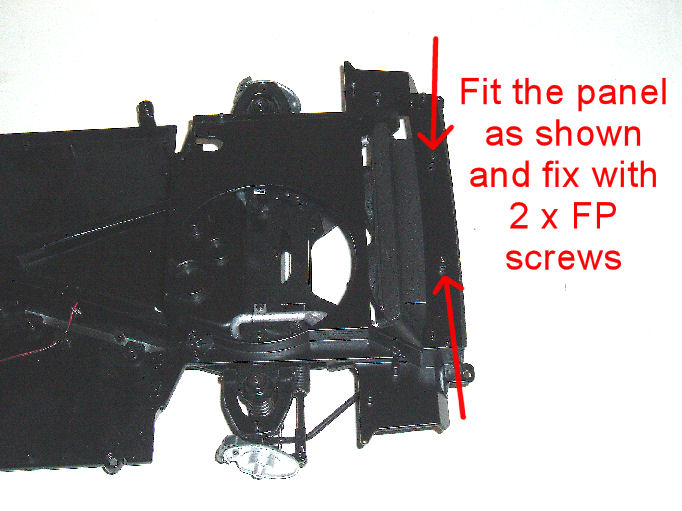

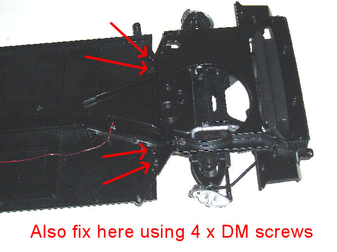

Fit the assembly to the front of the main chassis. It can only be fitted one way.
There are 6 x fixing points.
Fix the panel at the front just forwards of the radiator using 2 x FP screws.
The other 4 x fixing points are at the lower rear of the panel where it meets the chassis floor.
Fix here using 4 x DM screws.

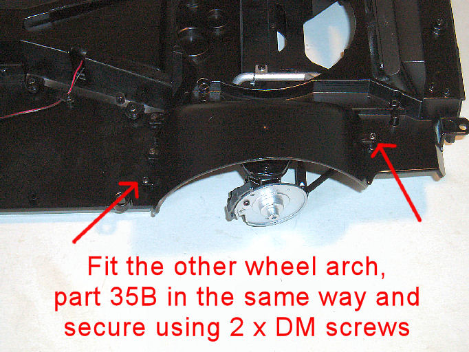

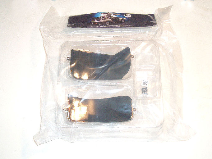

These parts will allow you to fit the front wheel arches.

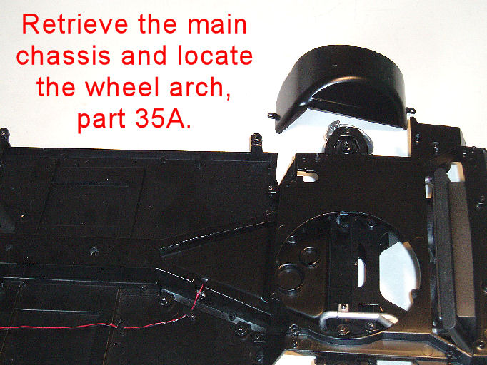

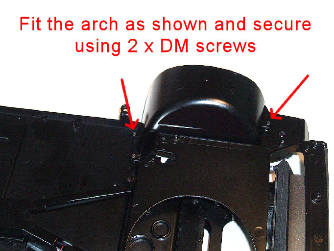

Retrieve the main chassis assembly and locate the left wheel arch, part 35A.
Fit the arch to the main chassis as shown and secure using 2 x DM screws.
Locate the right wheel arch, part 35B and fit it in the same way.
Secure using 2 x DM screws.

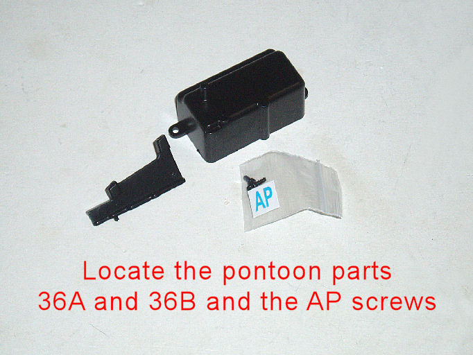

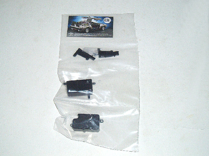

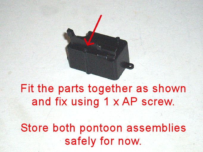

STAGE 36:
These parts will allow you to assemble the chassis pontoons.

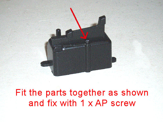

Locate the pontoon parts, 36A and 36B.
Fit the two parts together and fix using 1 x AP screw.

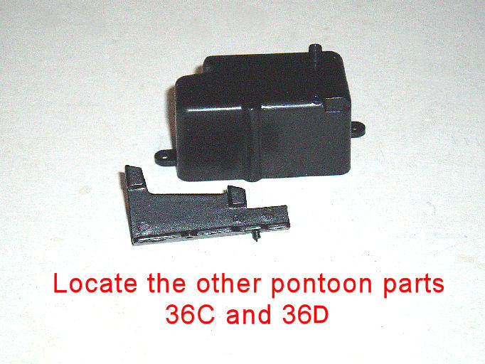

Locate the other pontoon parts, 36C and 36D.
Store these parts safely for now.
