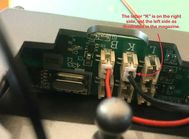

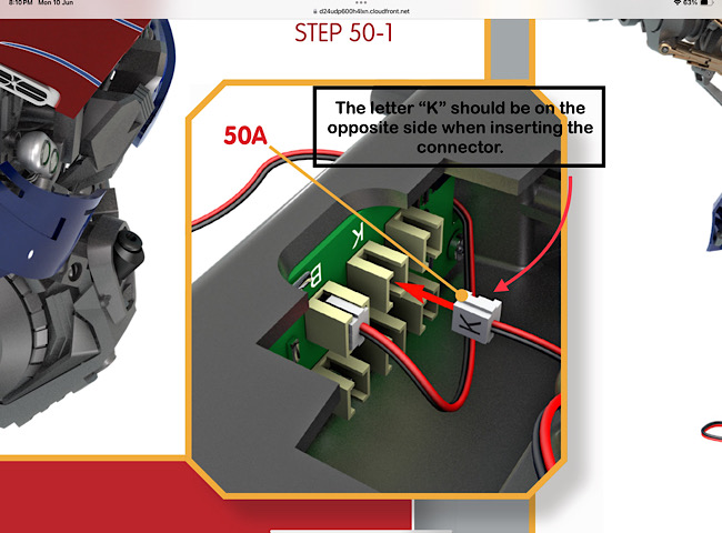

For those about to construct issue 50 of the Transformers/Optimus Prime, please note that the magazine illustration shows the “K” cable being inserted with the letter “K” on the left hand side. This is incorrect and the “K” should be on the right hand side. Please look carefully at the two pictures attached. If there is any resistance whilst connecting the cable to the circuit board, check you have the connector the right way round for the pins to go in as you may damage the board.
