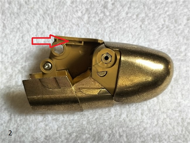

Parts supplied.....Pic 1, you will also need the middle finger from Issue 51.

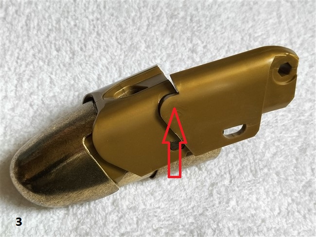

Bring the finger assembly from Issue 51 to the table and note the slot indicated in Pic 2. Then press part C21 fully into that slot as in Pic 3.
Position the assembly with the open side upwards and place the washer into position. Pic 4. Now press part C20 in place. Pic 5 and 6. Note: The washer must remain in place. The diamond shaped lug must engage with part C20 and at the top, the parts C20 and C21 must be fully engaged.

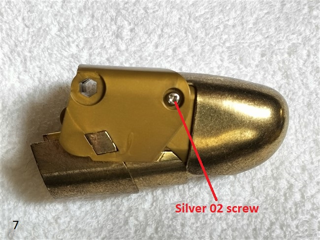

Finally fix the parts together using a silver type 02 screw. Pic 7.

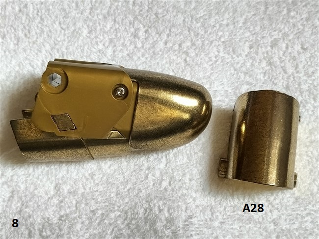

That`s it for this update. Pic 8. Keep part A28 safe for later use.

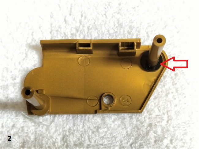

Start by placing one of the black washers onto the long spindle of part C23, Pic 2. Then pass the long spindle through the finger assembly from Issue 52. Pic 3.

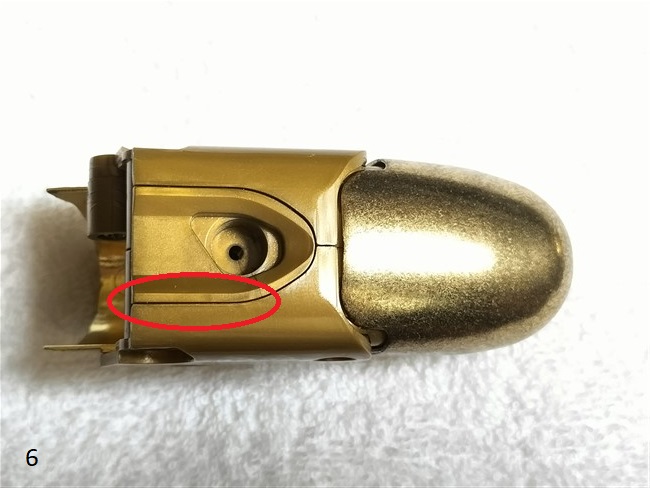

Next press the part C24 into C23, making sure that the parts are fully engaged. Pic 7. Now position the second black washer in place, Pic 8. Then position part C22, pressing the top edge fully onto part C24. Also make sure the lug of A28 engages with the hole in C22 and that the washer is kept in place. All indicated in Pic 9.
Finally secure part C22 using a silver type 02 screw, Pic 10.

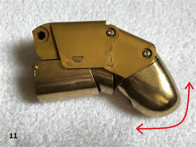

That ends this update, just make sure the finger flex`s and straightens as shown in Pic 11.

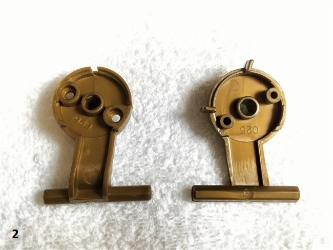

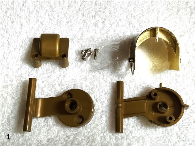

Parts supplied.....Pic 1.

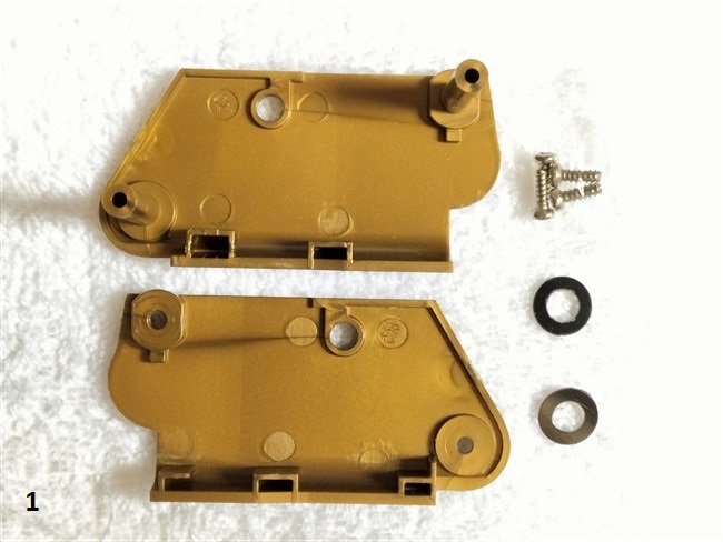

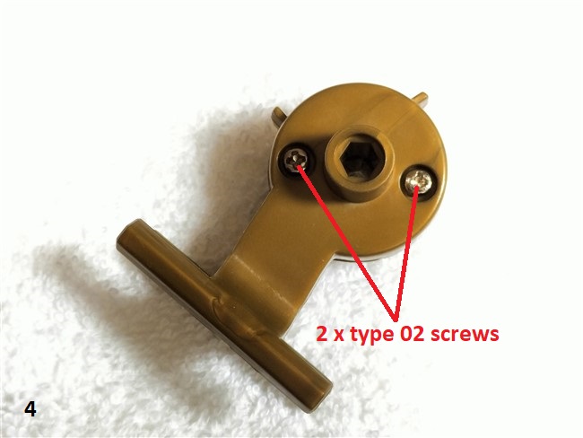

Bring the parts C25 and C26 to the table Pic 2, engage the tabs and slots on these parts and press them together, Pic 3. Then secure the parts together using 2 x
(silver) type 02
screws, Pic 4.

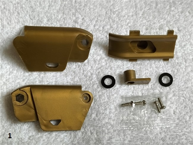

Back with the next update for the Gauntlet, Issue 55. In this update we will continue the assembly of the root of the middle finger.

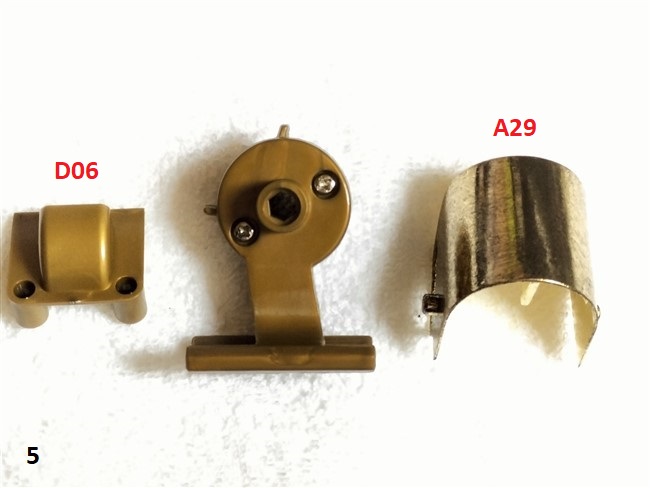

Parts supplied.....Pic 1. You will also need the assembly and part D06 from issue 54.

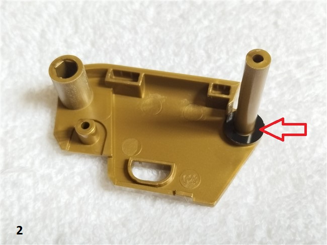

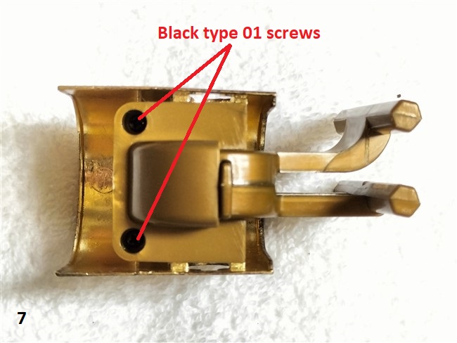

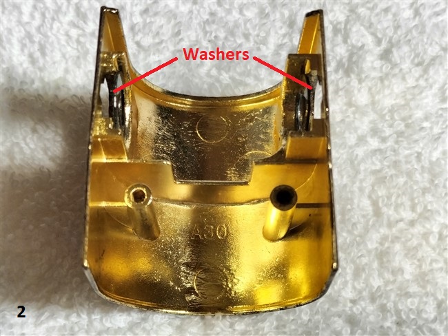

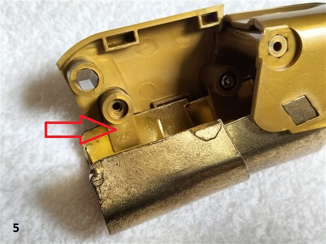

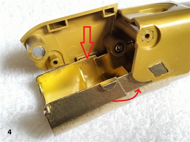

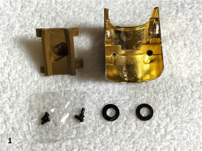

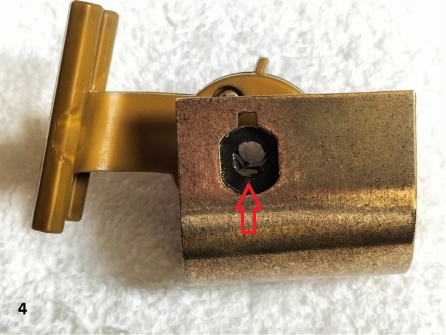

Start by placing the two black washers inside of part A30 Pic 2. Then place the assembly from issue 54, between the washers, Pic 3. Check that both washers are still in their correct position as shown in Pics 4 and 5.
When you are happy with the position of the washers, place part D06 as shown in Pic 6 and fix it in place using 2 x type 02 silver screws. Pic 7.
That completes this update, Pic 8. Carefully store part C29 for future use.

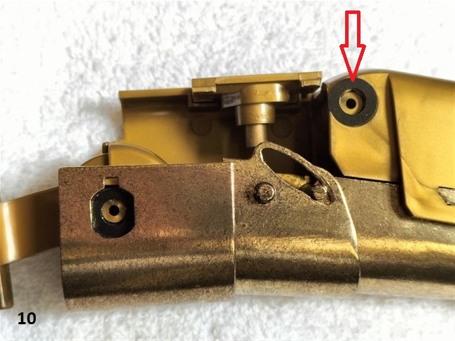

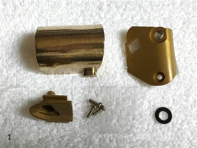

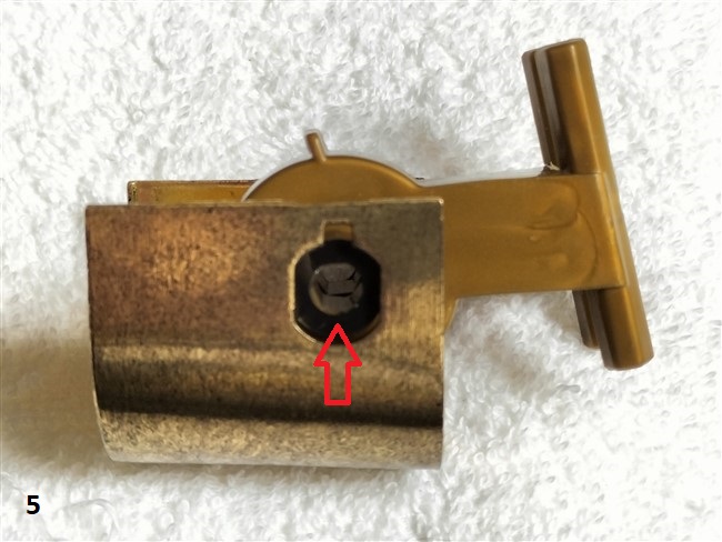

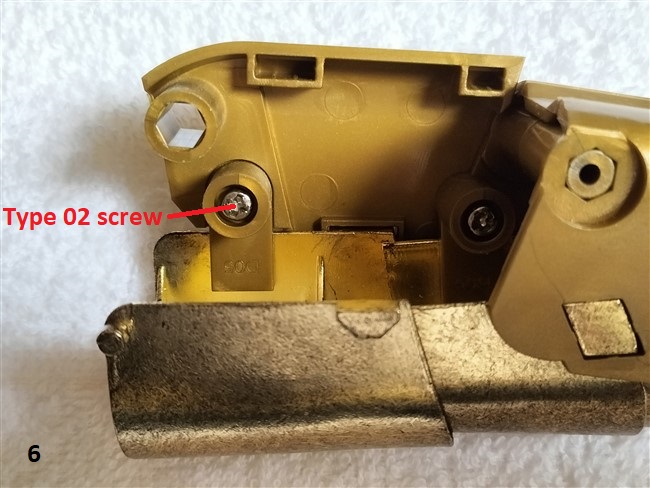

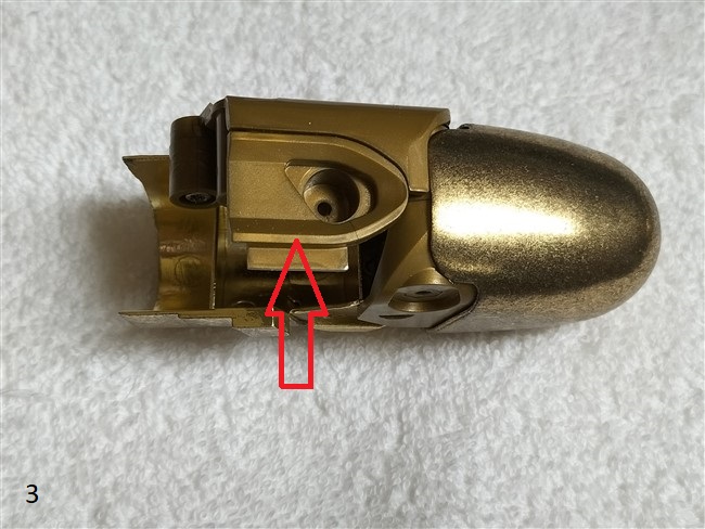

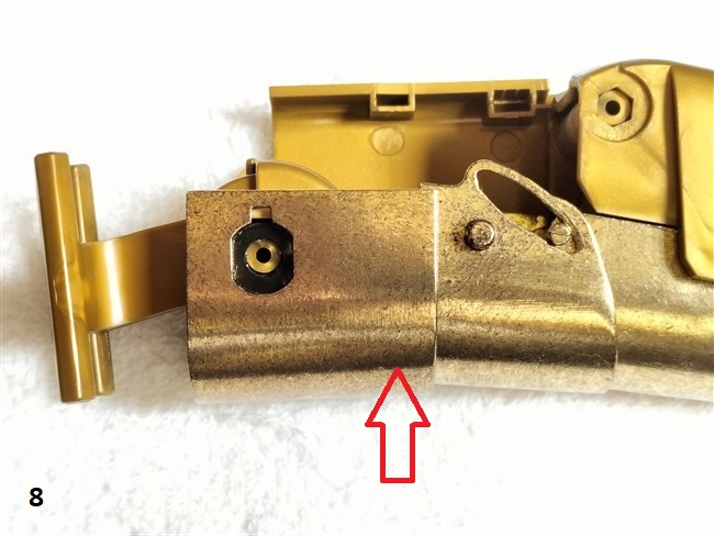

#5 Posted : 09 June 2024 12:32:23
Hi All, BigGrin

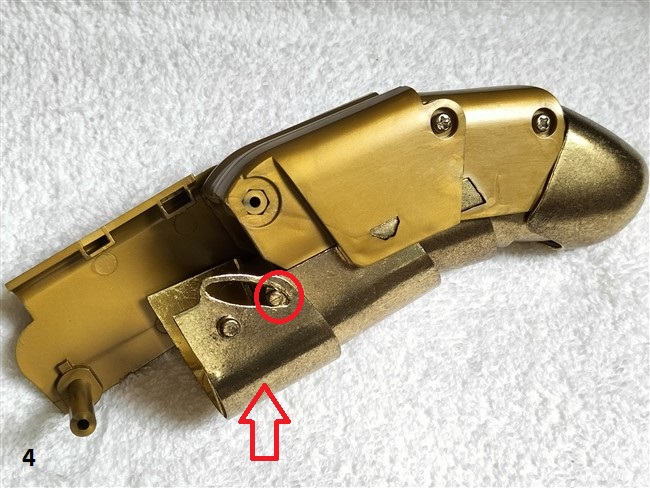

Here we go with the last update of this pack, Issue 56. In this update we will finish the main structure of the middle finger, ready for the top armour plates to be added in the next updates.
Parts supplied.....Pic 1. You will also need the finger assembly from issue 53, the part A29 from issue 54 and the finger root assembly and part C29 from issue 55.

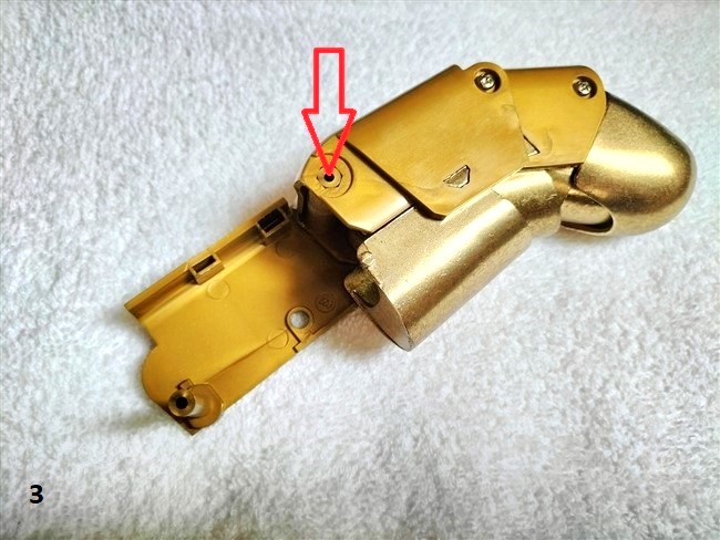

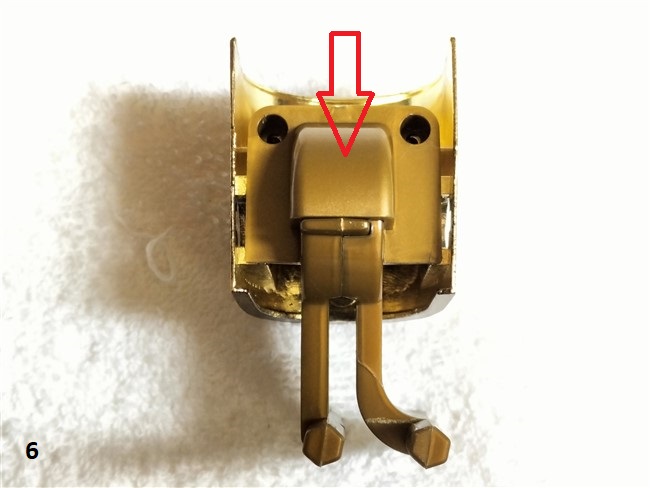

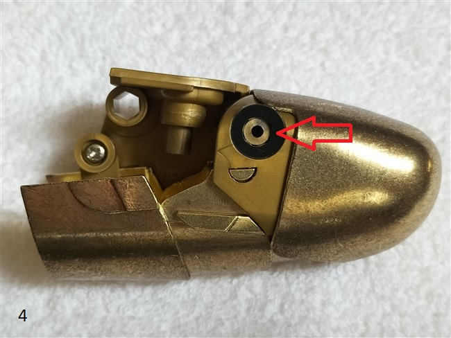

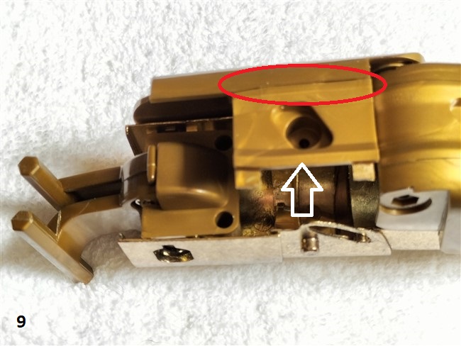

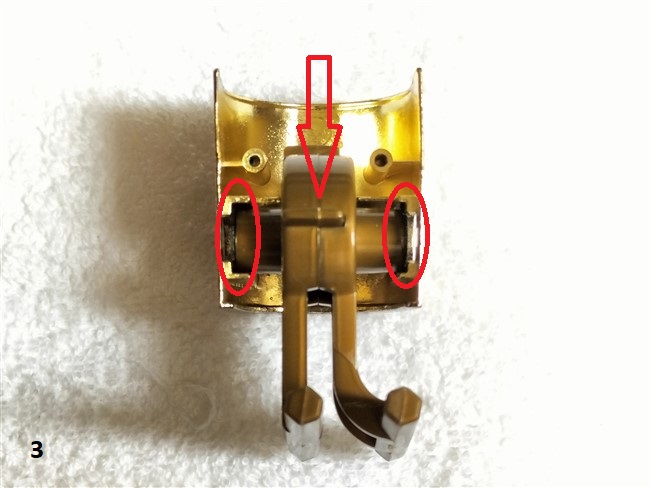

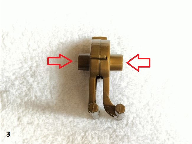

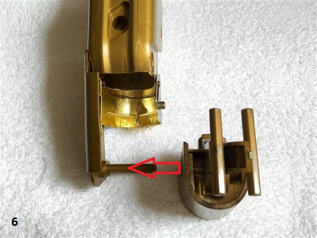

Start by placing a black washer onto part C27, Pic 2 and then pass the spindle through the finger assembly Pic 3. Next take part A29 and position it so that the pin of A28 (the last part fitted to the underside of the finger) goes into the elliptical hole in A29 and the pin of A29 engages with side plate C27. Shown in Pics 4 and 5.

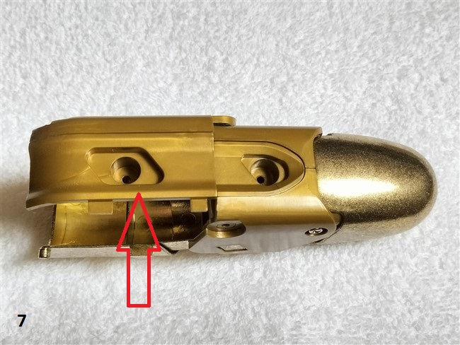

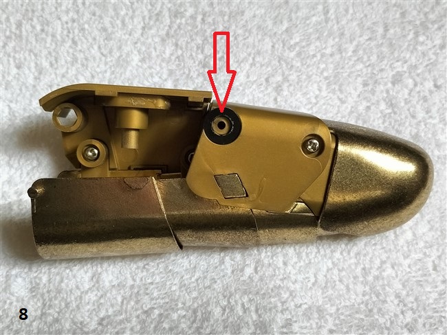

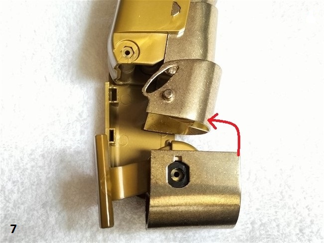

Next we fit the finger root, so position the parts as shown in Pic 6 and slide the finger root onto the spindle of C27, Pic 7, rotating the assembly when fully engaged in the direction of the arrow. The finger should now be like that shown in Pic 8.

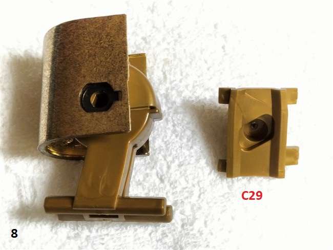

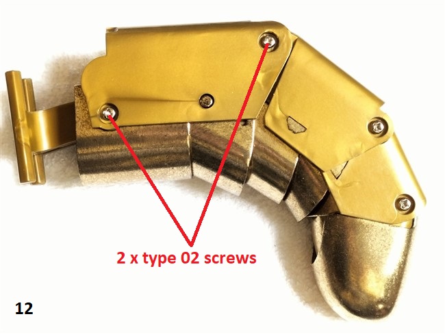

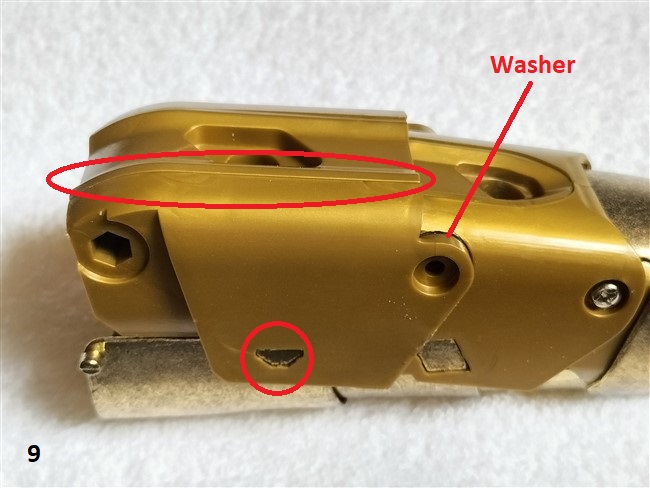

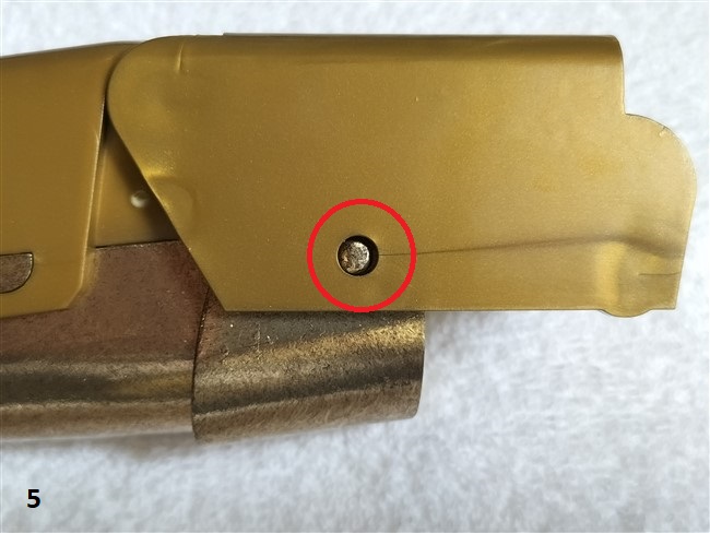

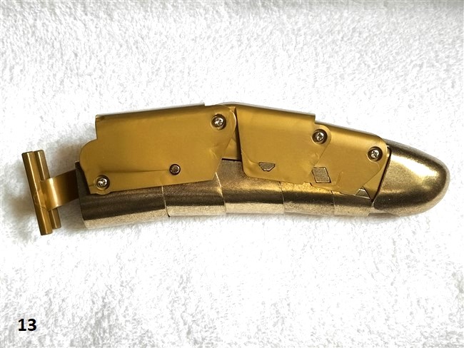

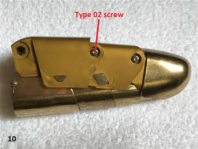

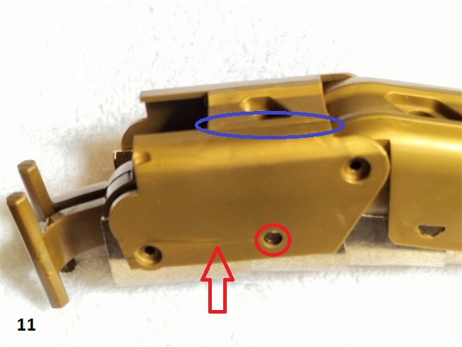

Take part C29 (issue 55) and press it firmly in place, ensuring there is not a gap between the parts, Pic 9. Lay the finger over and position the second black washer as in Pic 10. Then, (keeping the washer in place), press part C28 in place and make sure the pin locates correctly. Pic 11. Finally, fix the plate in place using 2 x type 02 screws. Pic 12.
That completes this update and pack, Pic 13. See you soon for the next pack of updates. ThumpUp ThumpUp
