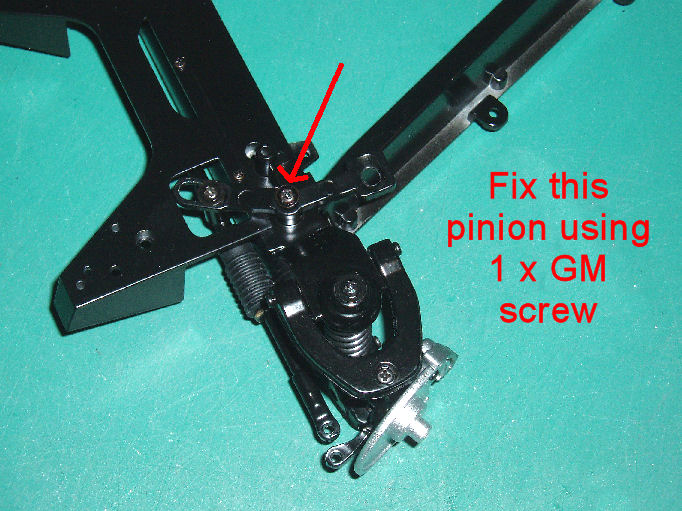

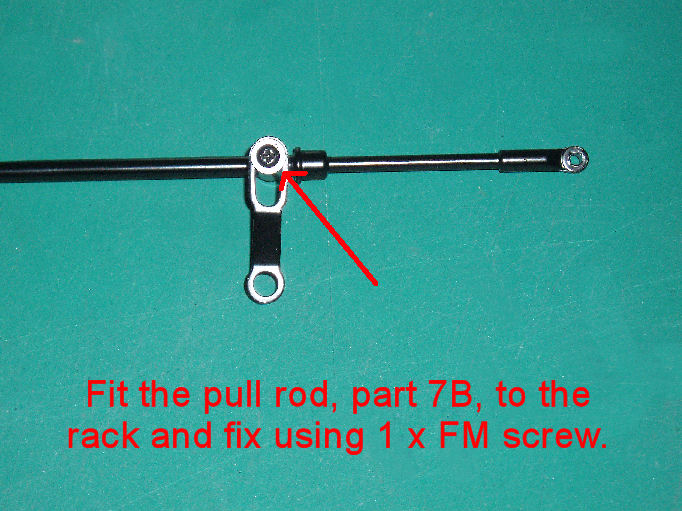

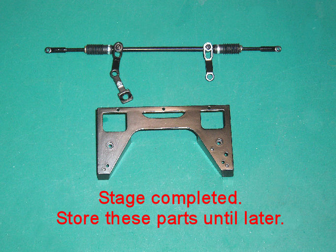

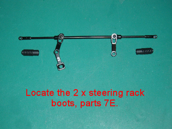

STAGE 7:

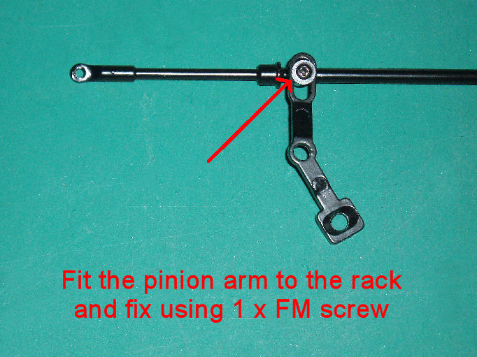

These parts will allow you to build the steering rack.

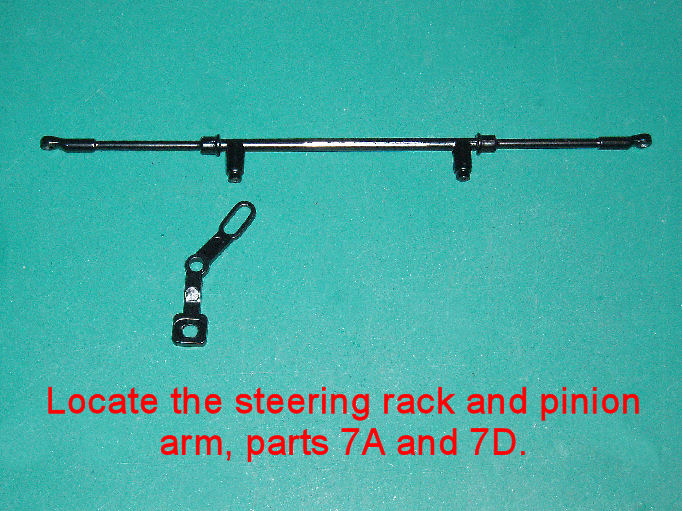

Locate the steering rack ant the two pinions, parts 7A, 7B and 7C.
You will also need 2 x FM screws.
Fit the pinion arm 7A to the left link on the steering rack making sure it is angled correctly.
Fix in place using 1 x FM screw.
Fit the right link in the same way and fix with 1 x FM screw.

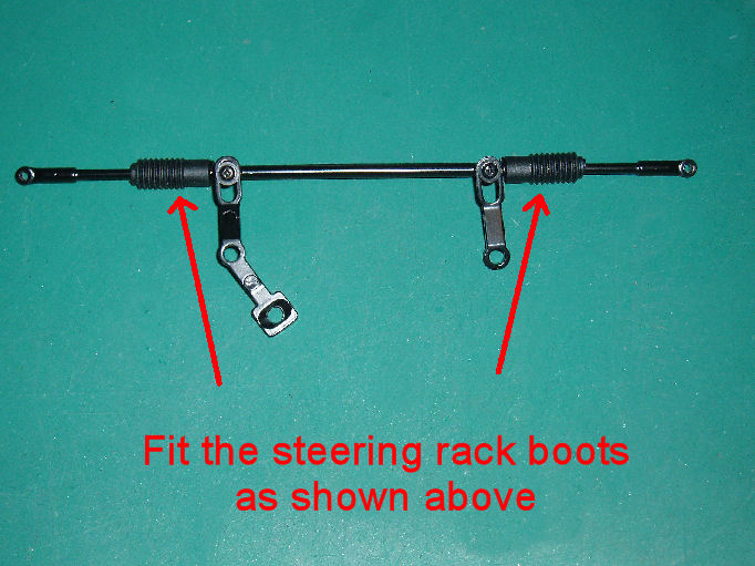

Locate the two rubber boots, parts 2 x 7E, ans slide them in place over the ends of the steering rack.

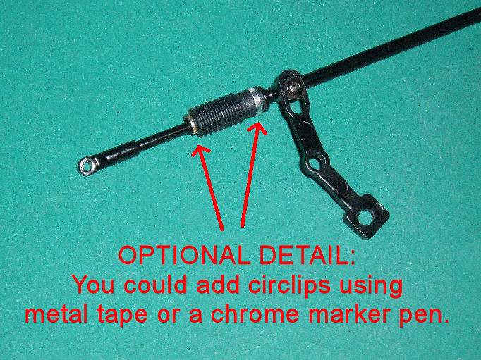

OPTIONAL DETAIL:
You can enhance the appearance of the boots by adding circlips using metal foil tape or a fine chrome marker pen.
These options are at the builders own discretion.
Store the assembly until later.

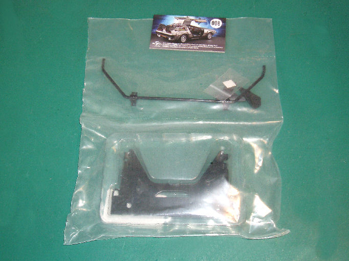

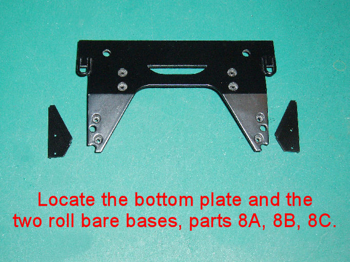

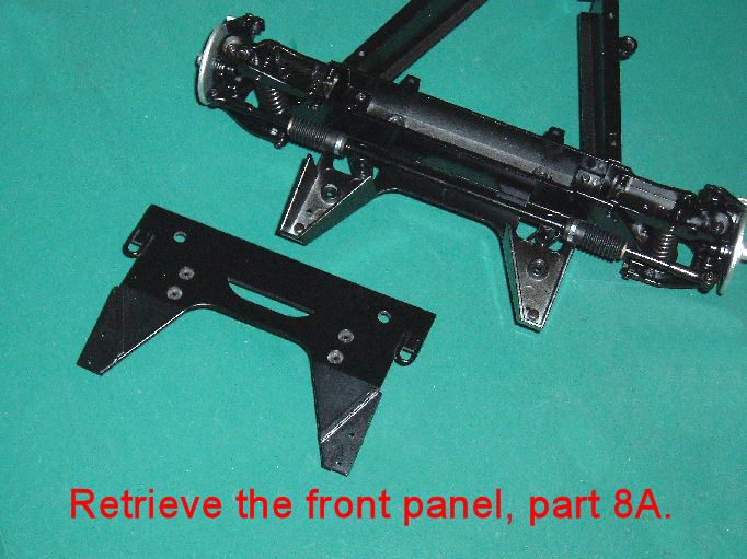

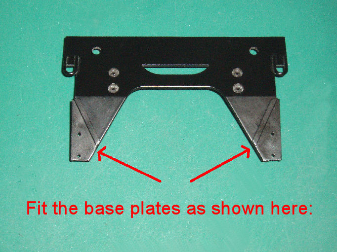

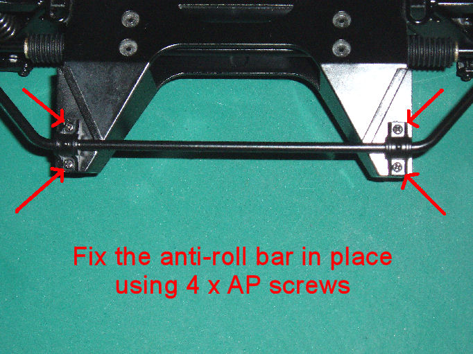

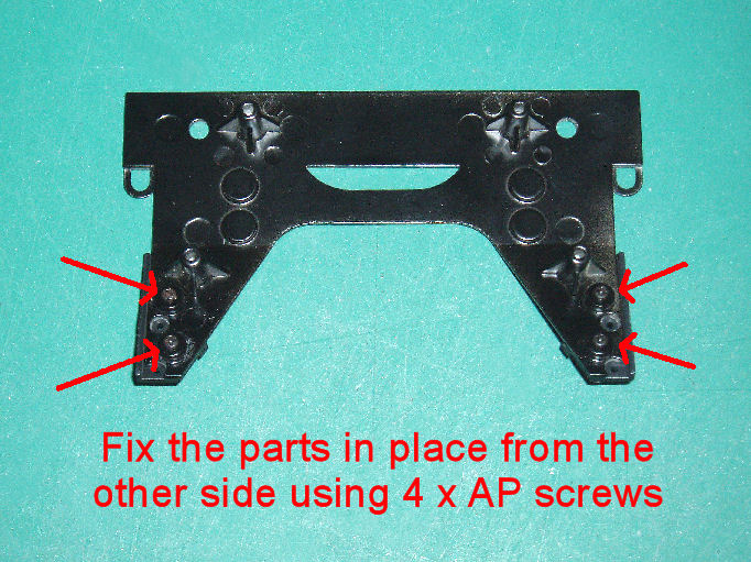

STAGE 8:
These parts are for beginning to assemble the front chassis plate.
Locate the metal bottom plate – 8A and the two anti-roll bar bases, 8B and 8C.
Press the two small plates into place on the metal panel. They will only fit one way.
Fix in place using 2 x AP screws in each panel from underneath.
Store this assembly with any spare parts and screws until needed later.

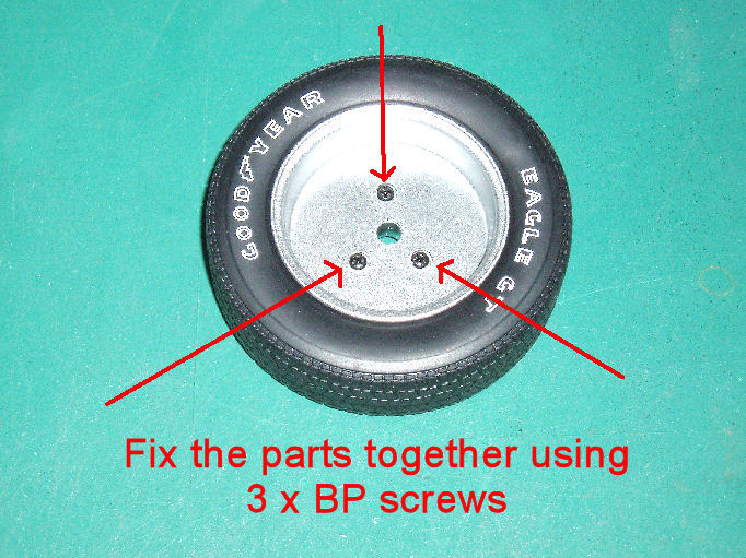

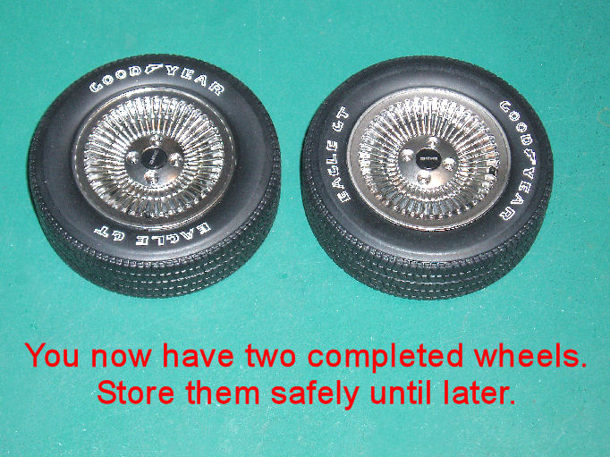

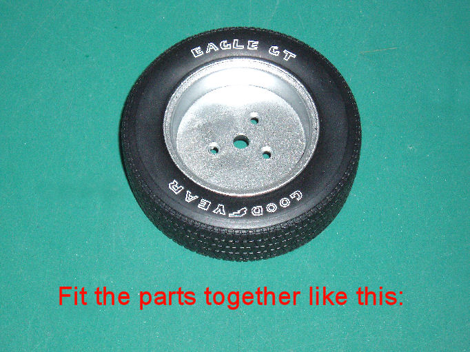

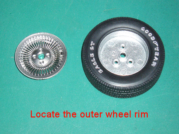

STAGE 9:

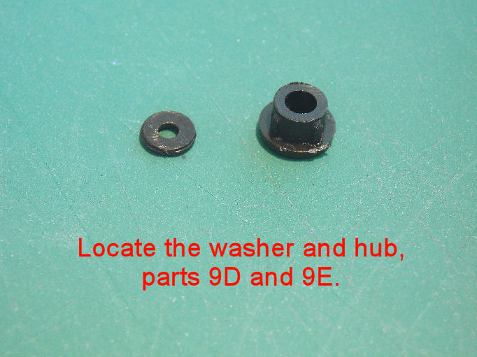

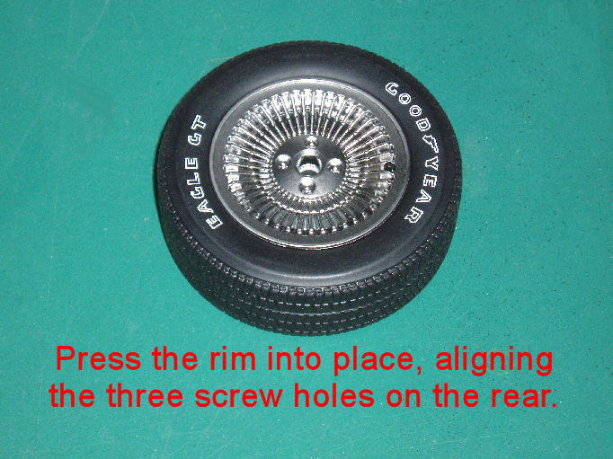

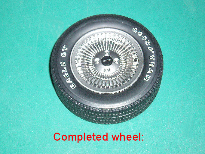

These parts are to assemble the second front wheel.
NOTE: The printed instruction incorrectly show the parts list from stage 1.
This wheel is assembled in exactly the same way as the wheel in stage 3.
Refer to that stage for further details.
Store this assembly until needed later.

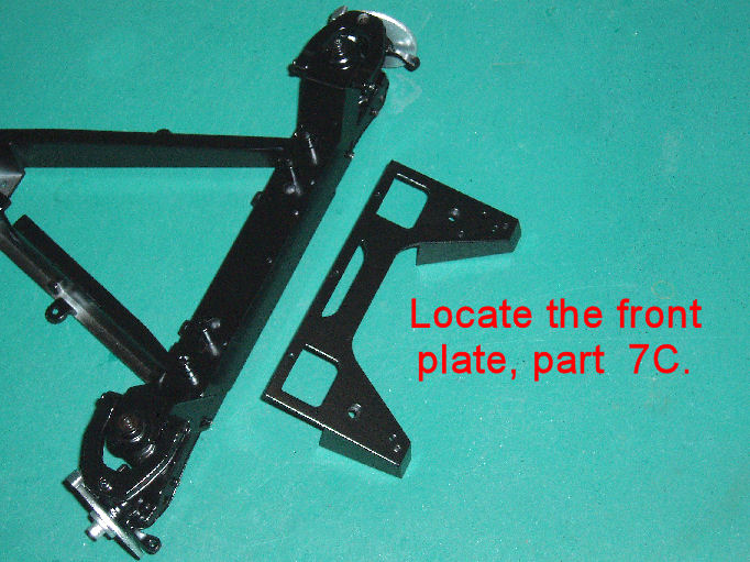

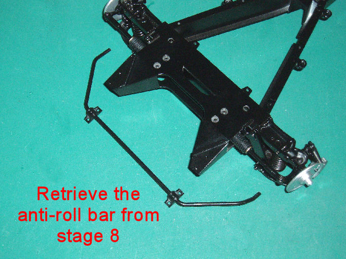

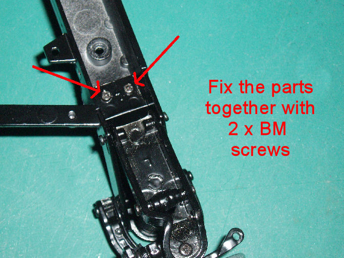

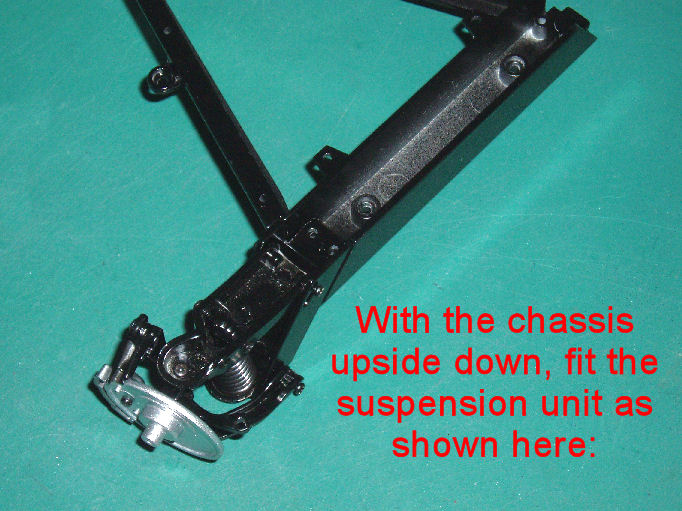

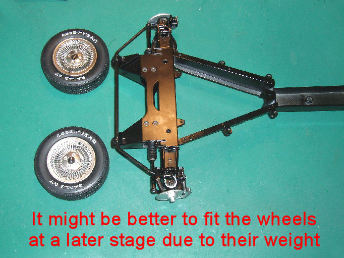

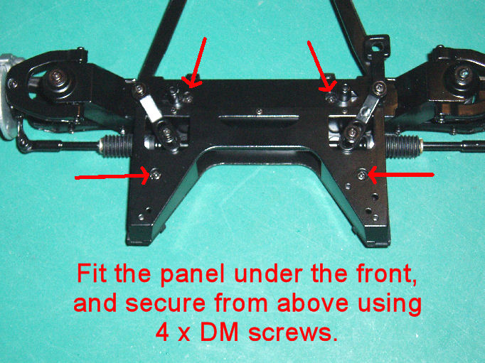

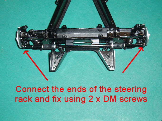

STAGE 10:

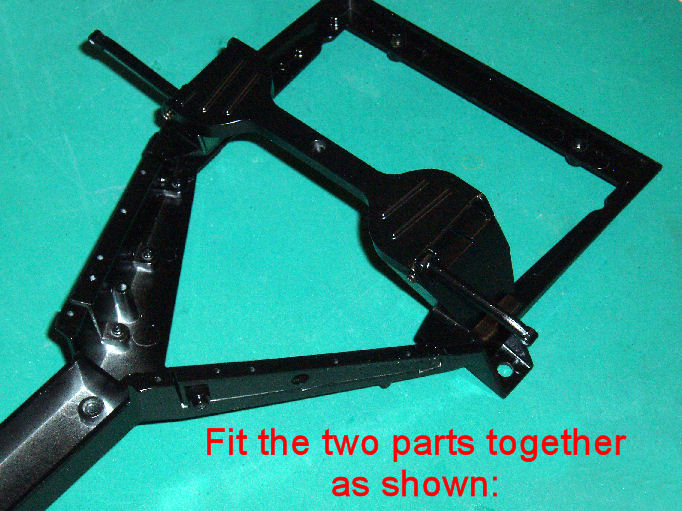

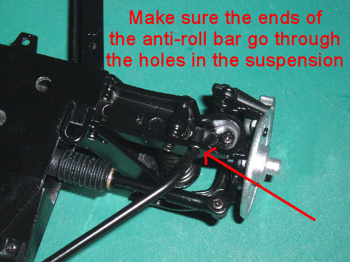

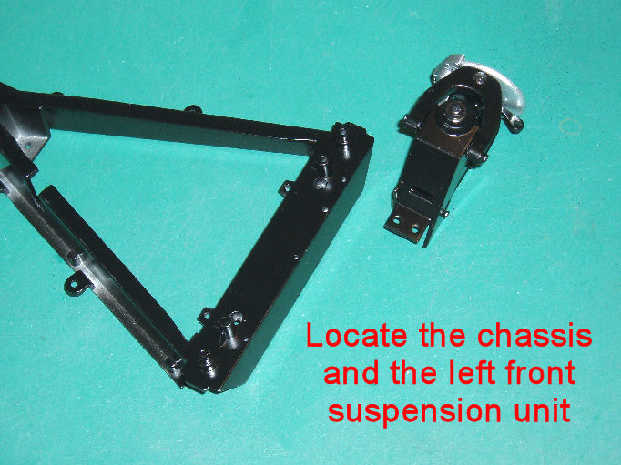

This set of parts will enable you to begin building the main chassis.

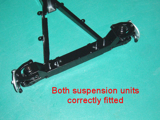

Locate the main frame, part 10A and the two front suspension assemblies previously constructed.

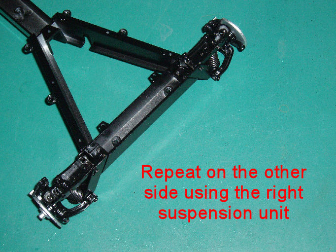

Fit the left suspension unit to the front of the main frame and secure using 2 x BM screws.
Repeat for the right suspension assembly.
Fit the front panel part 7C, from stage 7 to the front of the main frame.
Secure in place using 3 x AM screws.

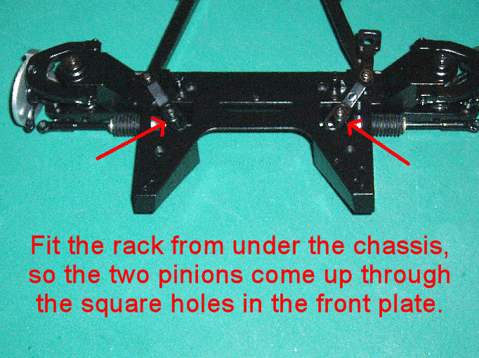

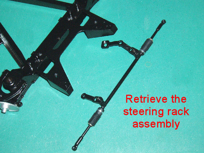

Fit the steering rack in place under part 7C, so that the two pinion arms come up, through the rectangular holes in that part.
Fit the pinion arms over the locating studs in the main frame and secure using 2 x DM screws.
Turn the chassis over and fit the steering rack in place. Make sure the ends go through the holes in the ends of the chassis frame, and then secure the rack to the front plate using 4 x AP screws.
The instructions suggest here that you can now fit the front wheels but due to their weight and the possibility of damaging the suspension parts, it might be advisable to fit the wheels later.
This is at the builders discretion.

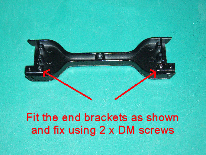

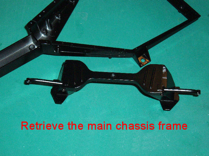

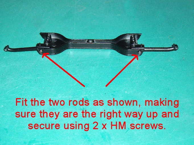

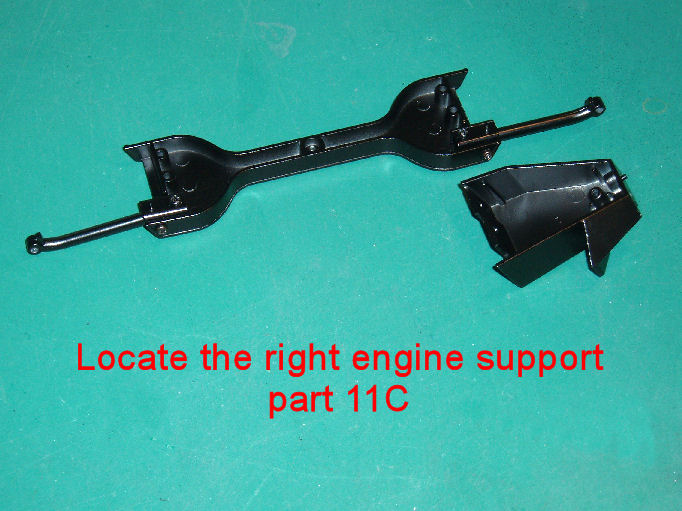

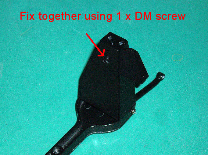

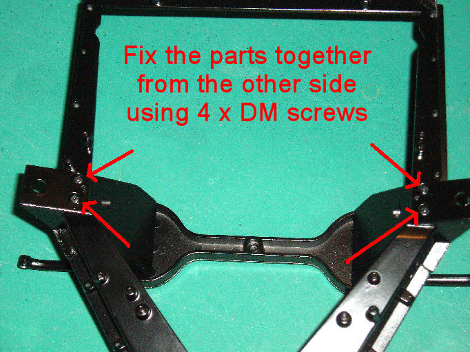

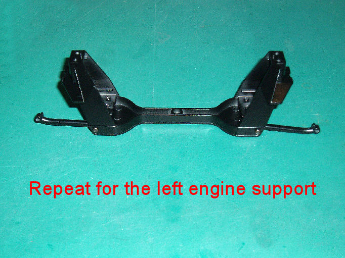

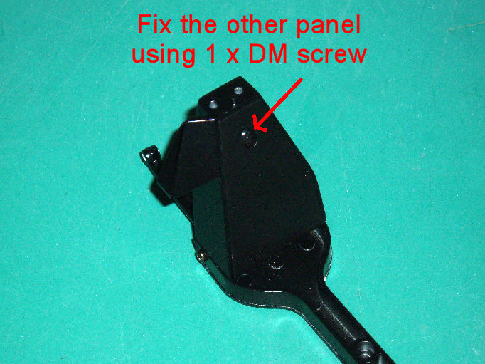

STAGE 11:

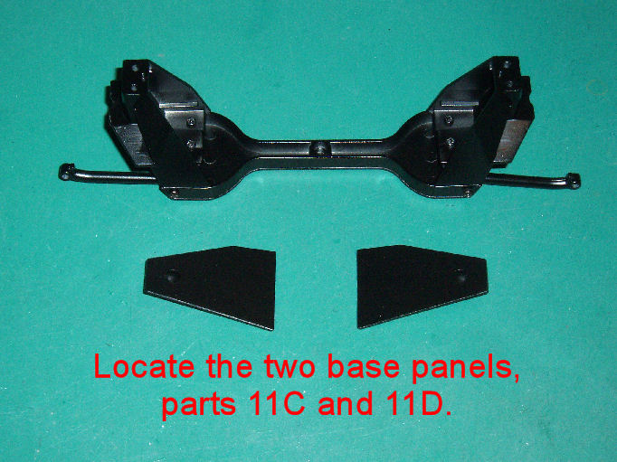

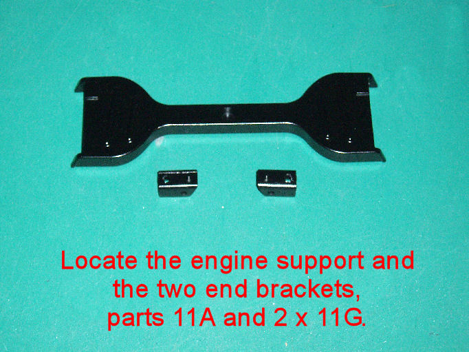

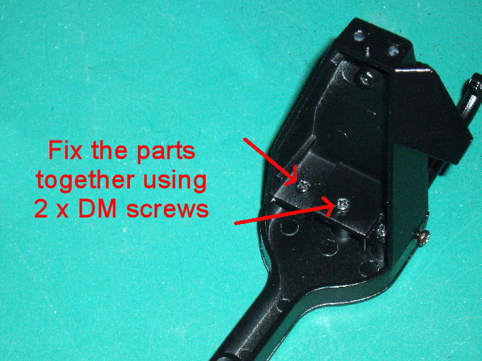

This set of parts will let you assemble the engine support cradle.
Locate the cradle frame, part 11A and the 2 x small support brackets, parts 2 x 11G.
Fit the brackets in place. They will only fit one way. Fix in place using 2 x DM screws.
Fit the two rods, parts 2 x 11F, into the previously fitted brackets and secure with 2 x HM screws.
Make sure the rods angle in the correct direction.
Fit the two side supports, parts 11B and 11C, to the frame cradle. They will only fit one way.
Secure to the cradle using 2 x DM screws in each side support.
Fit the two cover panels, parts 11D and 11E, to the support sections. They will only fit one way, and secure using 1 x DM screw in each panel.
Turn the main chassis frame upside-down and fit the cradle assembly at the ‘square’ end of the chassis, up against where the frame narrows into a ‘V’.
From the upper side, secure the frame on each side using 2 x DM screws.
Store the chassis frame safely until later.
