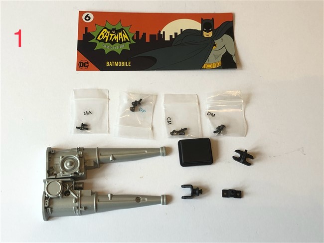

Issue 6
Picture 1 shows the parts for this issue.

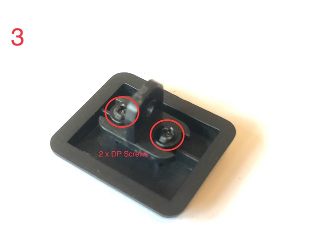

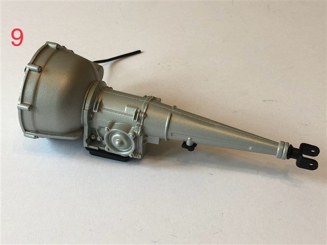

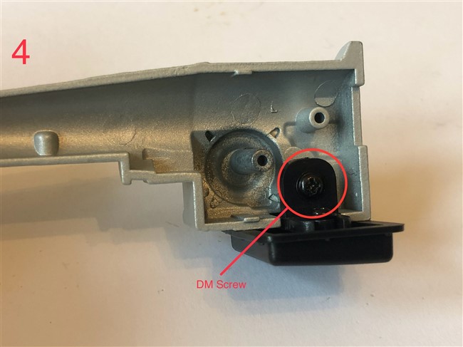

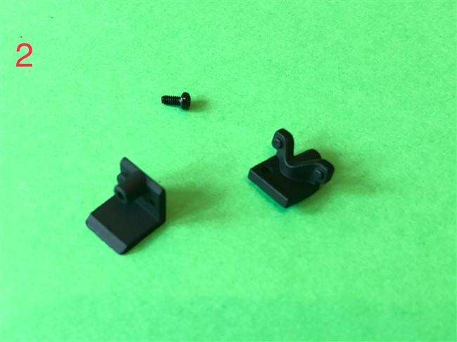

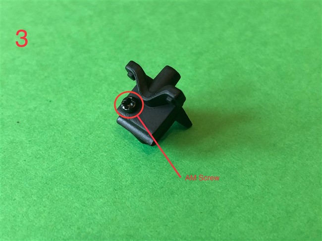

Fitting The Oil Pan

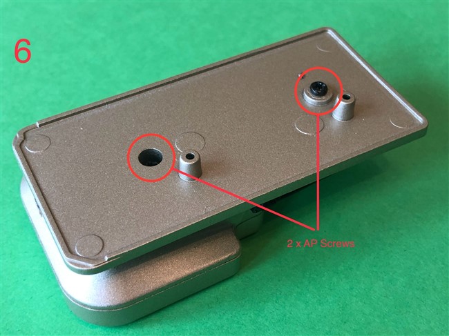

Place the oil pan bracket (06E) inside the oil pan (06D) and secure with 2 x DP screws, pictures 2 and 3. Place the oil pan assembly onto the gearbox housing (06B) and secure it with a DM screw, picture 4.
Completing The Gearbox

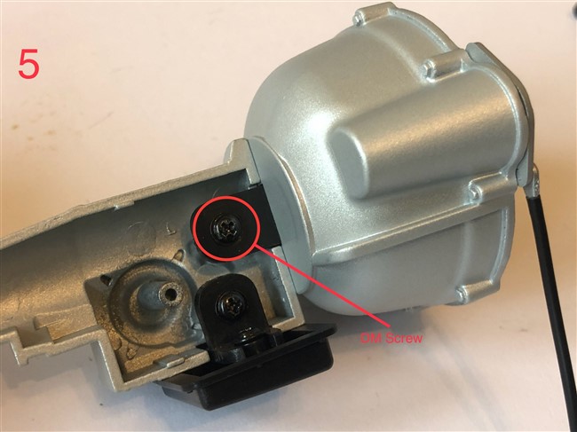

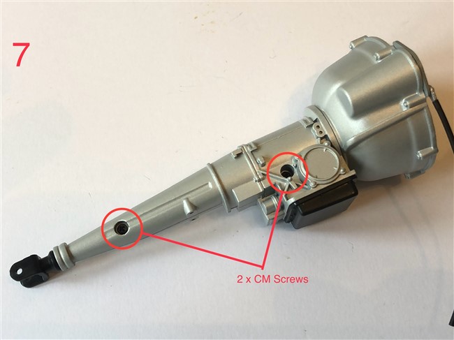

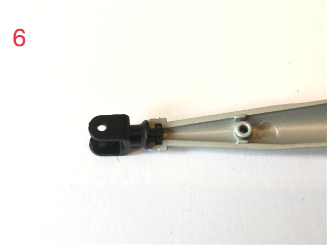

Fix the bell housing to the end of the gearbox housing and secure with a DM screw, picture 5. Next, rest the slip yoke (06A) into the end of the gearbox housing, picture 6. Place the other half of the gear box housing onto the left one and secure them together with 2 x SM screws, picture 7.

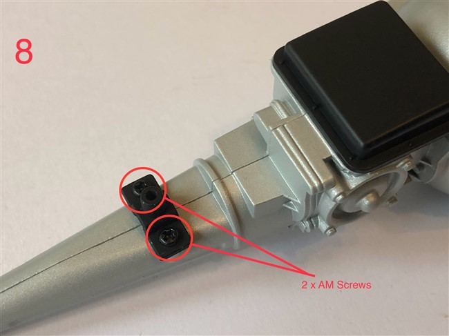

Turn the assembly over and secure the gearbox bracket (06F) with 2 x AM screws as shown in picture 8.
Picture 9 shows the complete assembly for this issue.

Issue 7

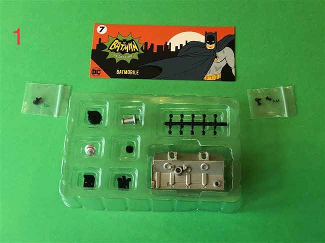

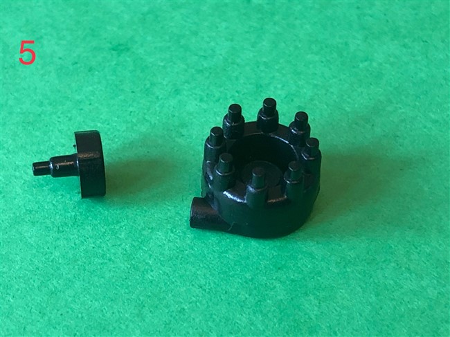

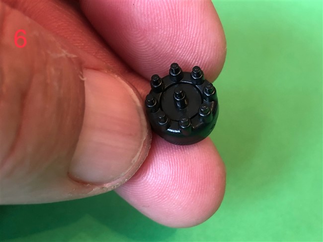

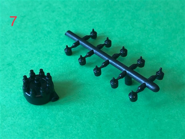

Take the distributor cap centre (07H) and push fit it into the distributor (07E) as shown in pictures 5 and 6. Next, remove the distributor cap plugs (07F) from the sprue, note you have one spare.

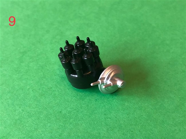

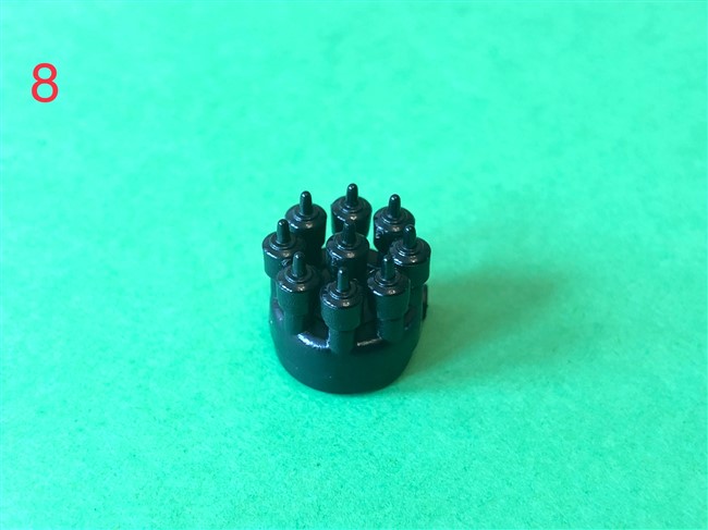

Place all the cap plugs onto the distributor assembly as shown in pictures 7 and 8.
Tip: When placing these caps onto the distributor assembly, start with the centre and work your way around the outside. When placing the caps on, I didn’t push them down all the way, just placed them on enough for them to stay in place. After they were all assembled, I turned the assembly over and gently push it down on a hard surface, such as a worktop, to push them fully onto the distributor assembly.
Push the vacuum advance (07E) onto the side of the distributor as shown in picture 9.

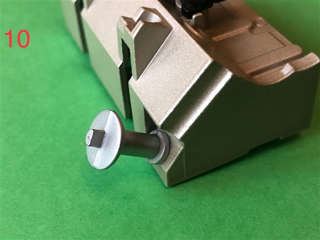

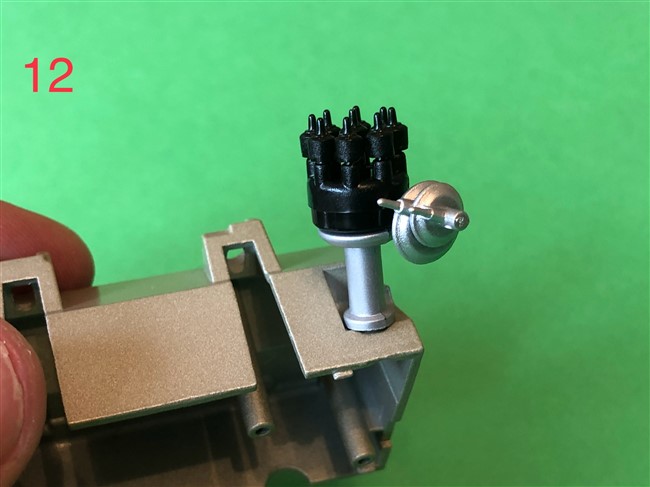

Secure the distributor shaft (07D) to the engine block using a TP screw, pictures 10 and 11. Finally push the distributor assembly onto the shaft as shown in picture 12.

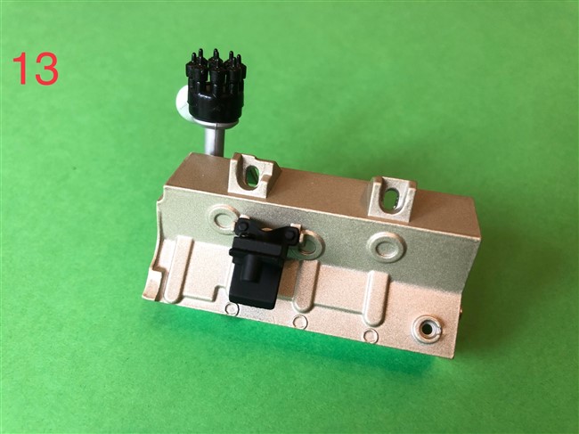

Picture 13 shows the complete assembly for this issue.

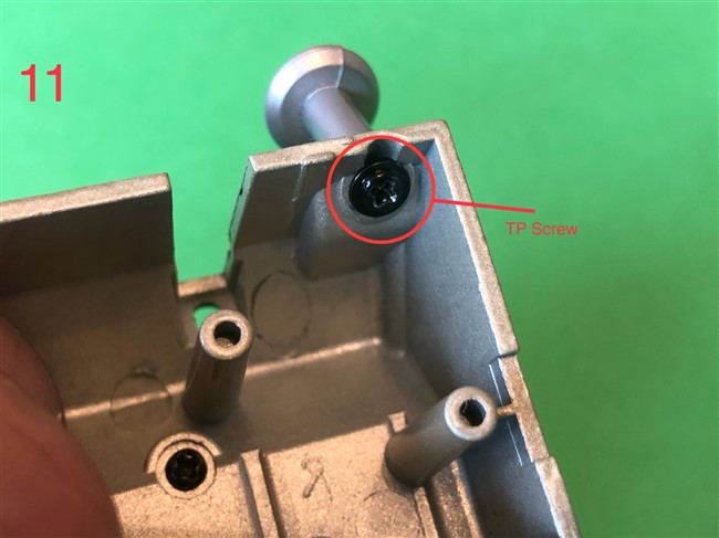

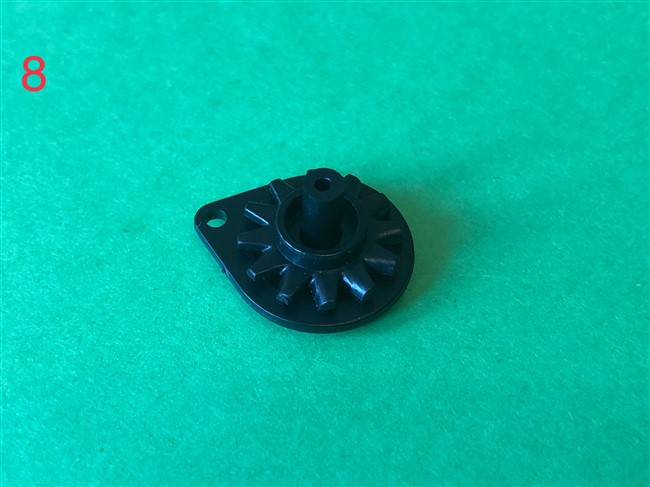

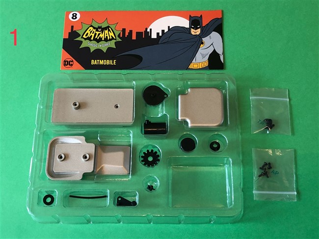

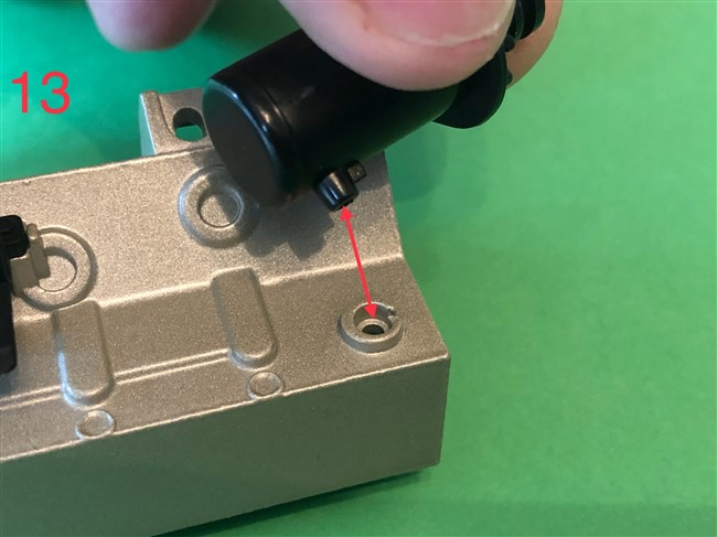

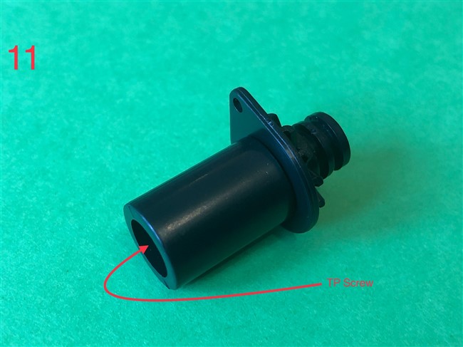

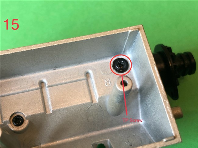

Issue 8
Assembling The Oil Pan

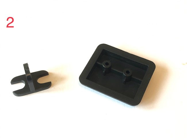

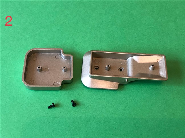

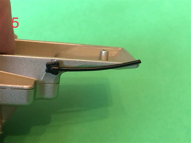

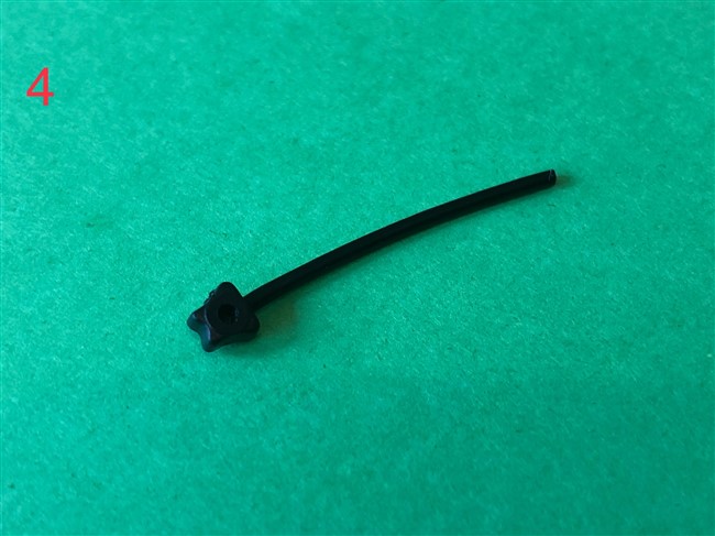

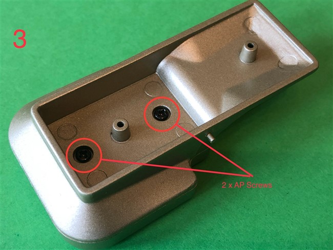

Take the oil pan parts (08C), (08B) and 2 x AP screws, picture 2. Assemble as show in picture 3. Push the oil pan hose bracket, (08E), onto the oil pan hose, (08E), picture 4. Push fit this assembly onto the side of the oil pan as shown in picture 5. Next, fit the oil pan top to the top of the assembly, securing it with 2 x AP screws, picture 6.
Assembling The Generator

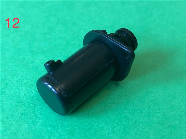

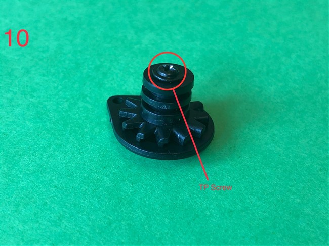

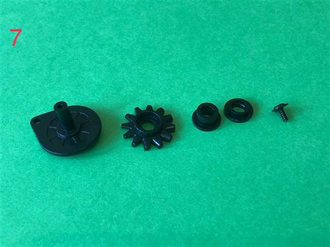

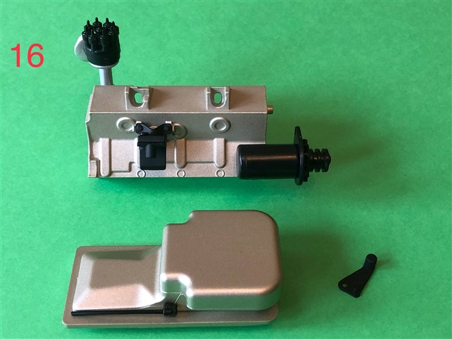

Take the parts, (08I), (08J), (08L) and (08K) along with a TP screw, picture 7. Fit the parts as shown in picture 8, 9 and 10, securing it all with the TP screw. Next, fit the generator (08F) and secure with another TP screw, picture 11. Place the rear cover as shown in picture 12. Place the assembly onto the right engine block, shown in pictures 13 and 14, and secure with a TP screw, picture 15.
Picture 16 shows the complete assembly for this issue.
