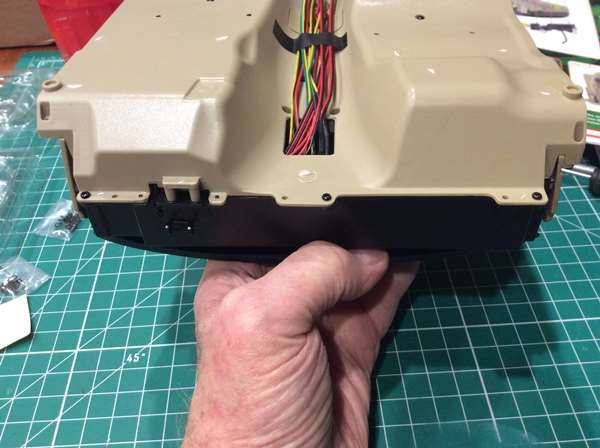

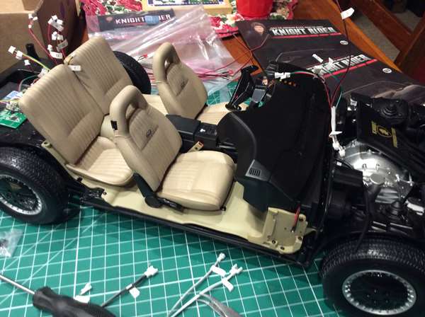

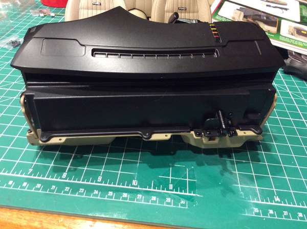

Issue 63 Build the left rear seat and seat back. Attach to the interior tub.
Issue 63 Steps 1-6 Complete the backrest for the driver’s side backseat and install as shown.

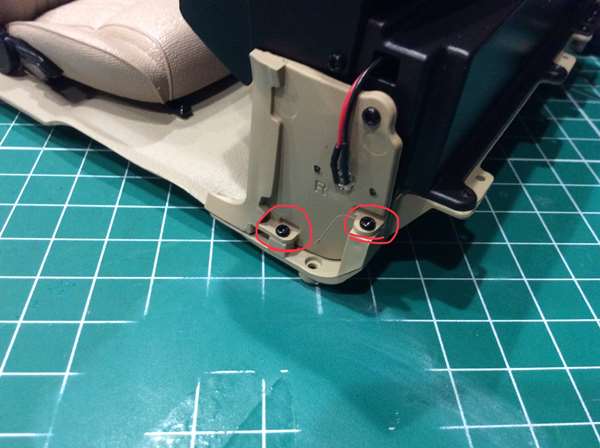

Issue 64 passenger side seat base
Steps 1-4 build and attach to the interior tub.
Issue 65 Passenger side backrest and wire management.
Steps 1-4 Build and attach to the tub.

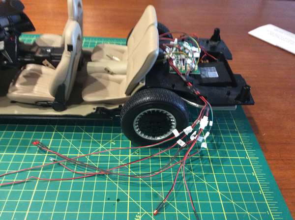

Steps 5-12 Try to be as neat as possible with the wire and tape, it will make the clearance thru the tunnel better.

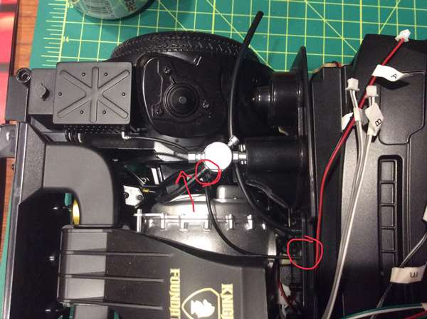

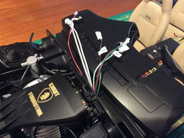

Issue 66 The completed floor tub will be mounted to the chassis. More wire management.

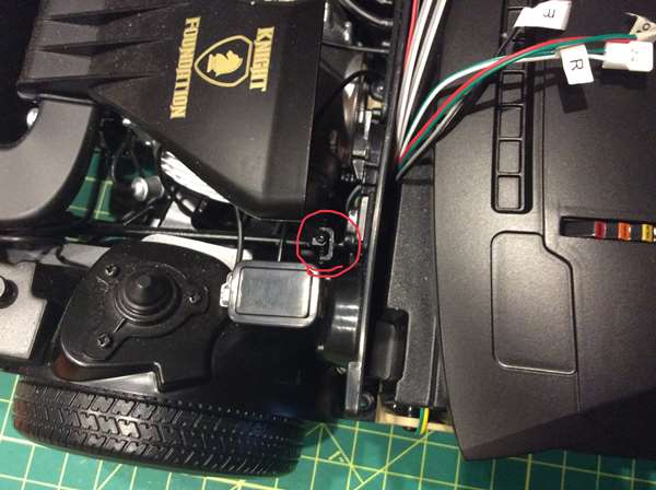

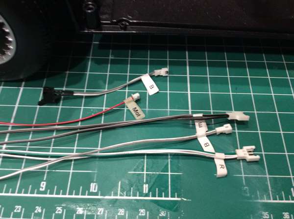

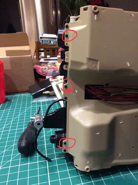

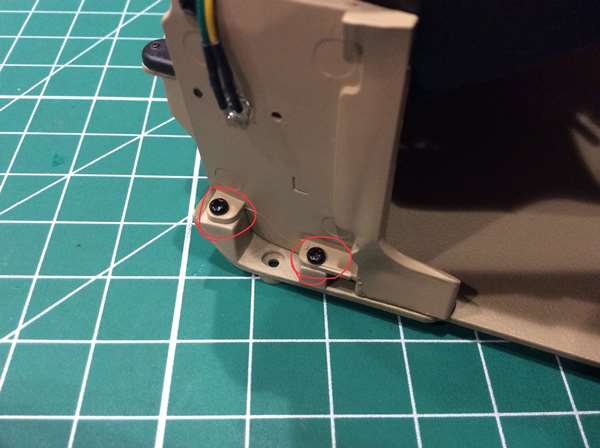

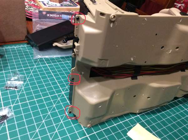

Steps 1&2 I followed the instructions, everything worked out except getting the wire connectors thru the slot between the firewall and dashboard. I figure there are two solutions. 1- remove the middle and driver's side screws, slip the wires through (this is what I did). 2- try to gently spread the firewall, slip in something to hold a small gap. Slip the designated connectors and wires thru the slot. Be careful if you try the second method, the parts are hard plastic and may be brittle.

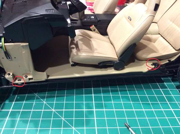

Step 3 Attach the tub to the chassis with 4GM screws.
Steps 4-6 Reconnect the connectors and wires as shown.

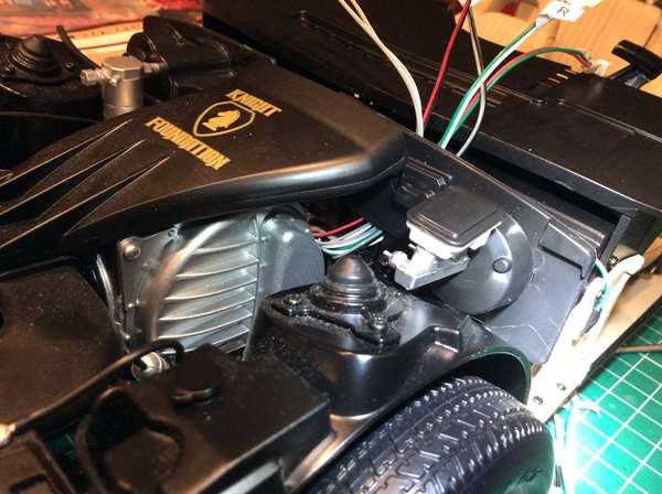

Step 7 Connect the steering column.

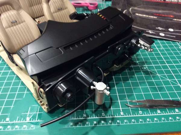

Step 8 Fit 3 tubes as shown.
Step 9 fit two tubes to the master cylinder.
Box 16 is complete
