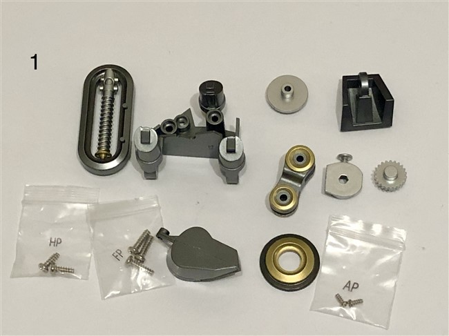

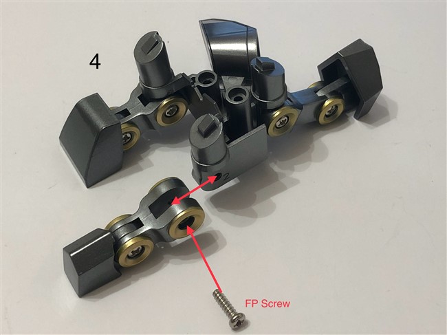

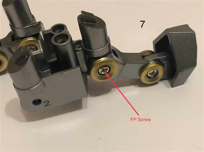

In this issue we continue with the assembly of the right foot.
Picture 1.
shows the parts with this issue.BigGrin

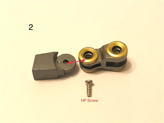

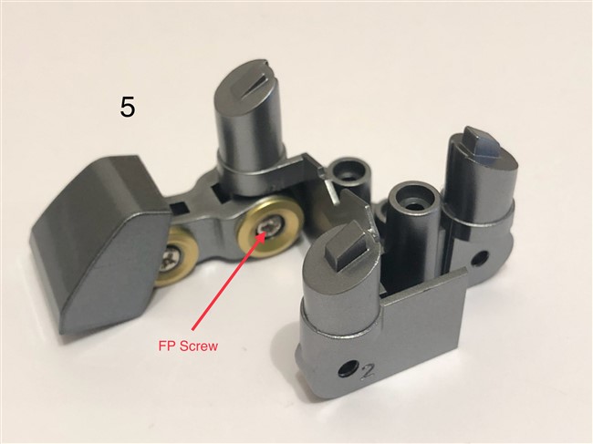

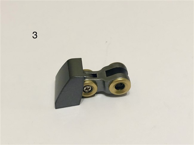

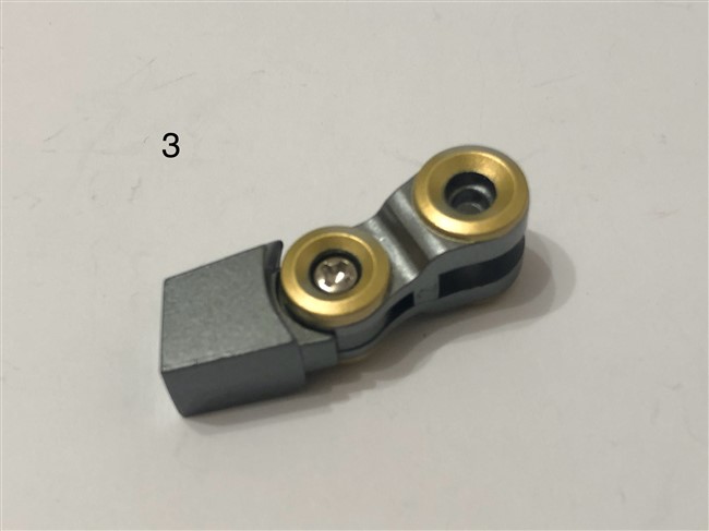

Picture 2. Fit the stabiliser joint over the stabiliser as shown in picture 3 with a HP screw.
Picture 4. Note the position of the parts and fit the stabiliser on the right foot sole structure with an FP screw as shown in Picture 5.
Next, retrieve the rear stabiliser from issue 5 and position it to the assembly marked 1, picture 6.
Fit with an FP screw as shown in picture 7.

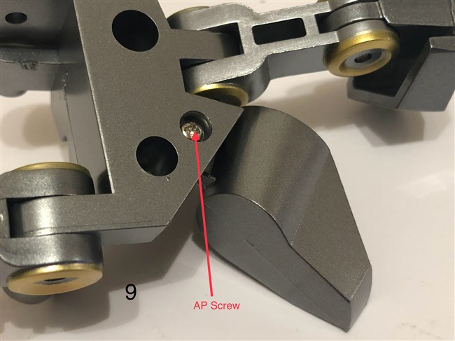

Attach the side turbine as shown in picture 8. Next, turn the assembly over and secure with an AP screw as shown in picture 9.
Note: The magazine says IP screw, this should say AP. Do not over tighten.

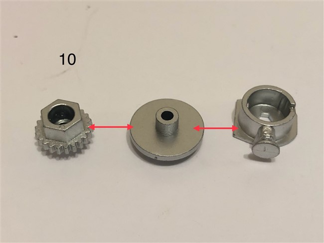

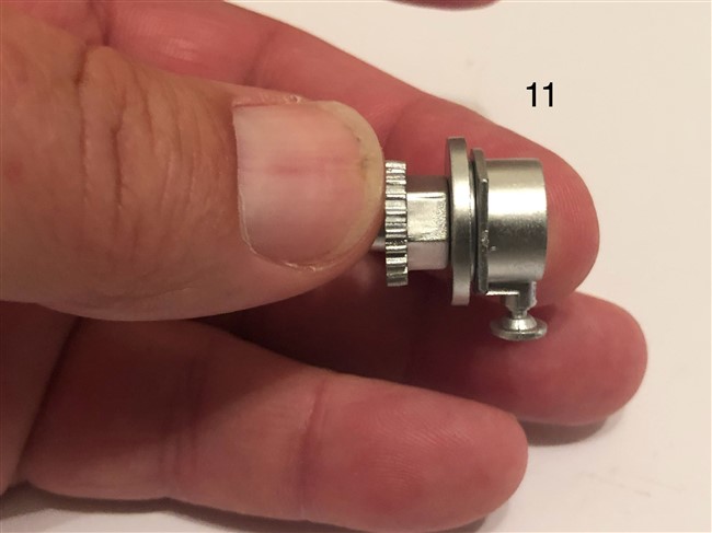

Locate the 3 pieces of the instep gear, picture 10. Now assemble as shown in picture 11 by snapping them together.

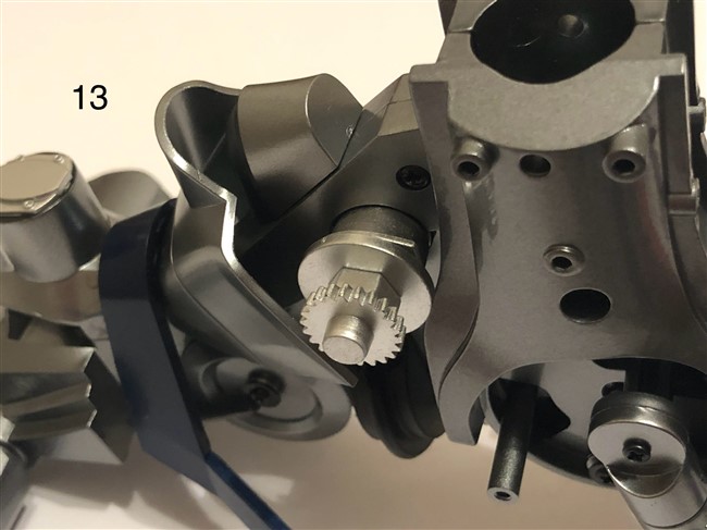

Attach the assembly block to the foot, it will only fit one way, pictures 12 and 13.

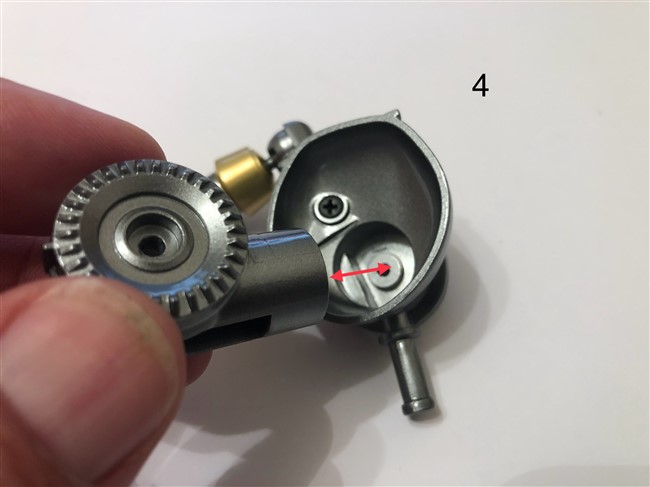

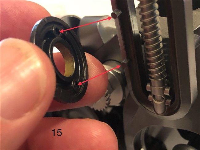

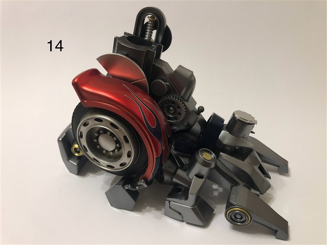

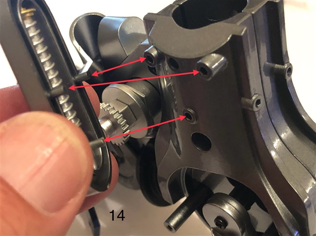

Warning: In this next part to fix, the auger, the magazine says to fix this to the foot section as seen below. This is a tight fit and will need to be removed again in issue 19. I would highly recommend leaving this off until later when you have finished issue 19.
Now add the auger to the foot as seen in picture 14 by push fitting the part on. Next add the outer disc, note the orientation and fit in place with a little pressure, picture 15.

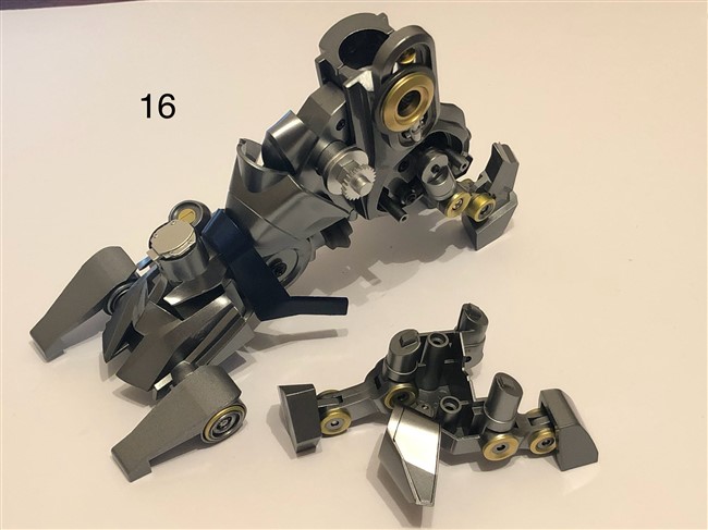

Picture 16 shown the complete assembly for this issue.Drool

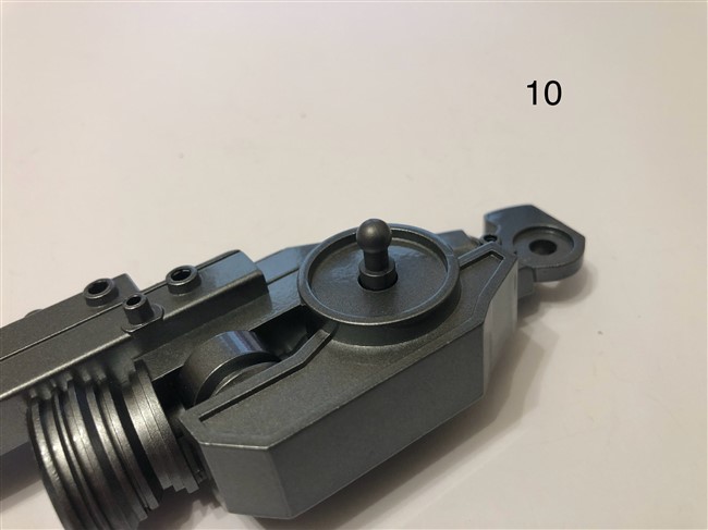

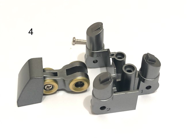

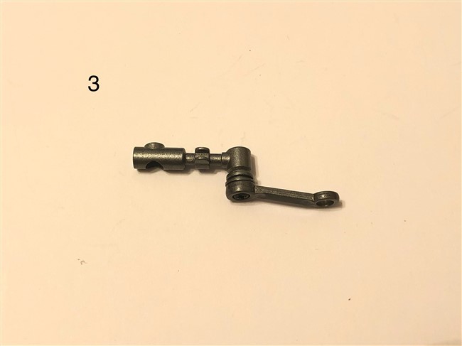

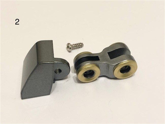

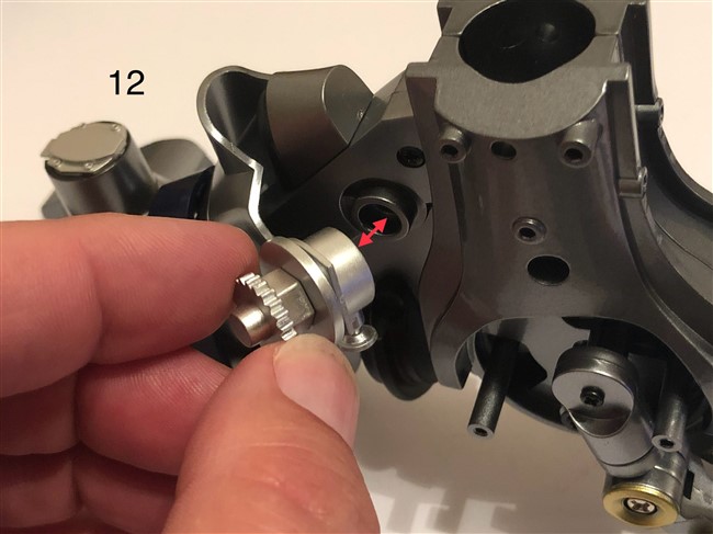

Issue 8

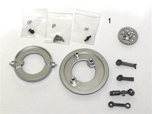

Picture 1
. shows the parts with this issue.

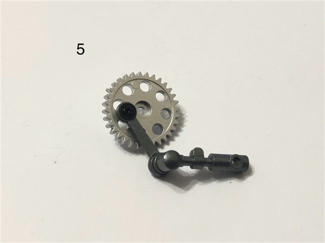

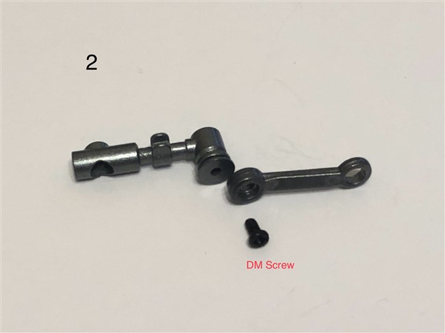

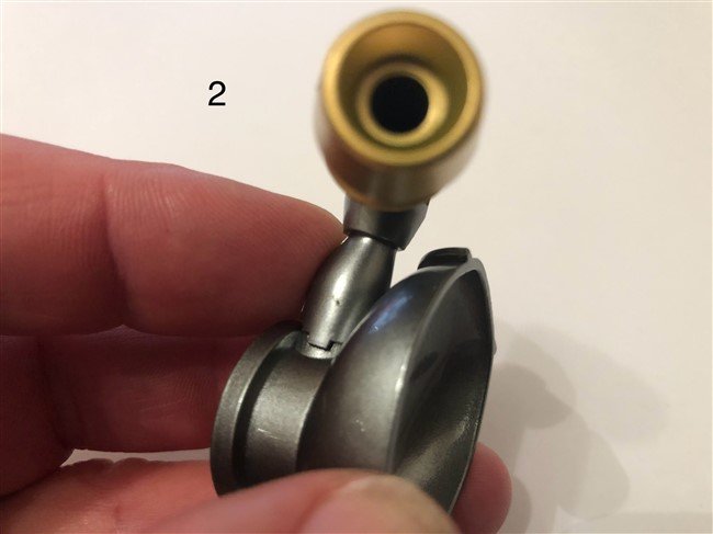

Observe the position of the parts in picture 2, noting the correct orientation. Assemble the parts with a DM screw as shown in picture 3.

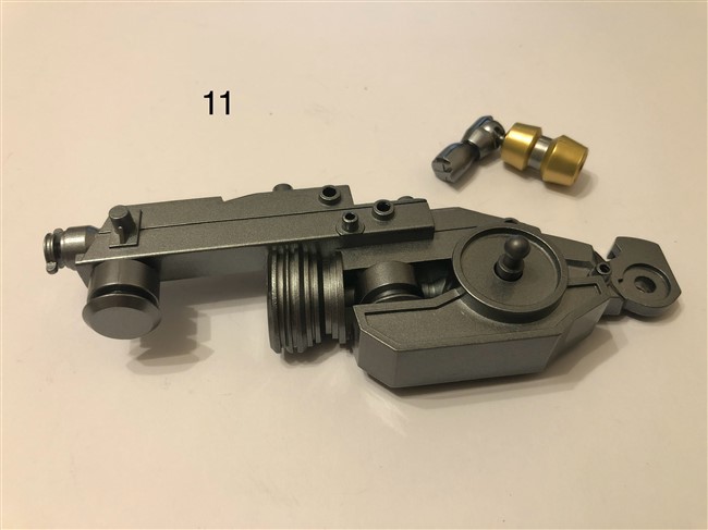

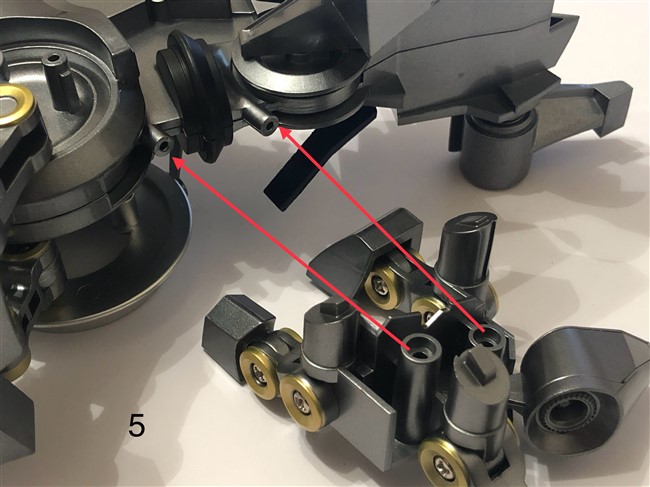

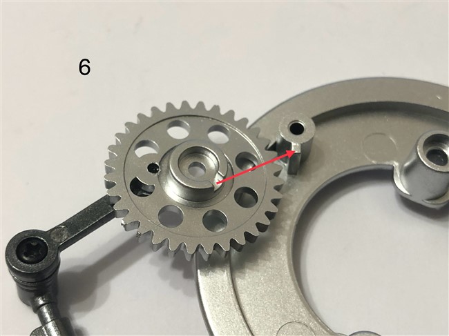

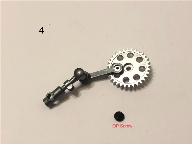

Now take the part you have just assembled along with the wheel gear and attach it to the narrower end of the arm with an OP screw as shown in pictures 4 and 5. Now fit the assembly onto the small pin wheel fitting the wheel gear onto the notch as shown in picture 6 and fix with an IP screw as shown in picture 7.

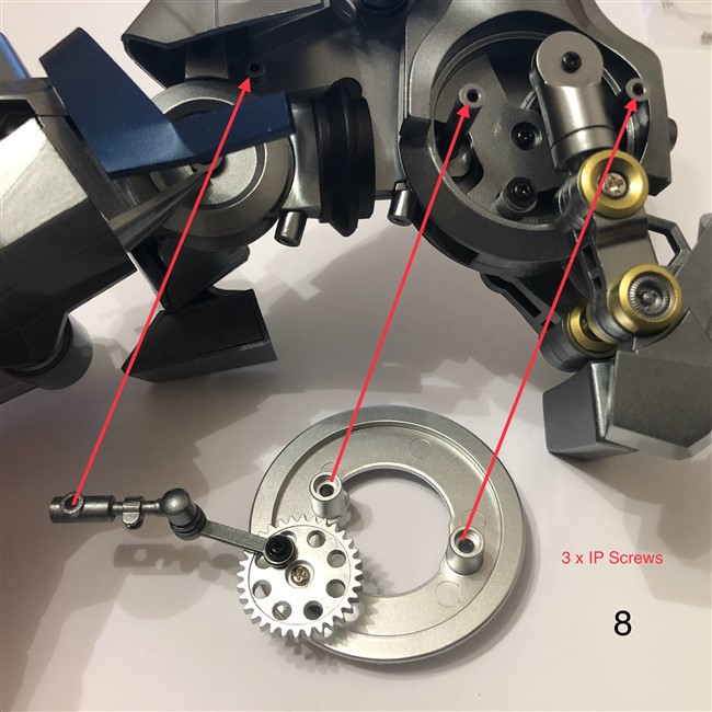

Fit this assembly to the foot section as shown in pictures 8 and 9 with 3xIP screws.

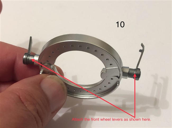

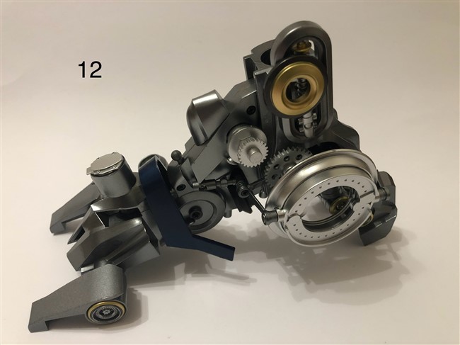

Attach the front and rear wheel levers, shown in picture 10 and then fix the assembly to the foot as shown in picture 11.
Picture 12 shows the complete assembly for this issue.Cool

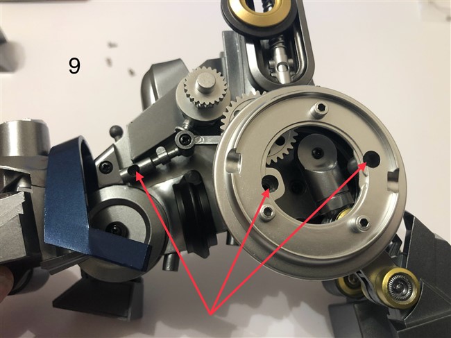

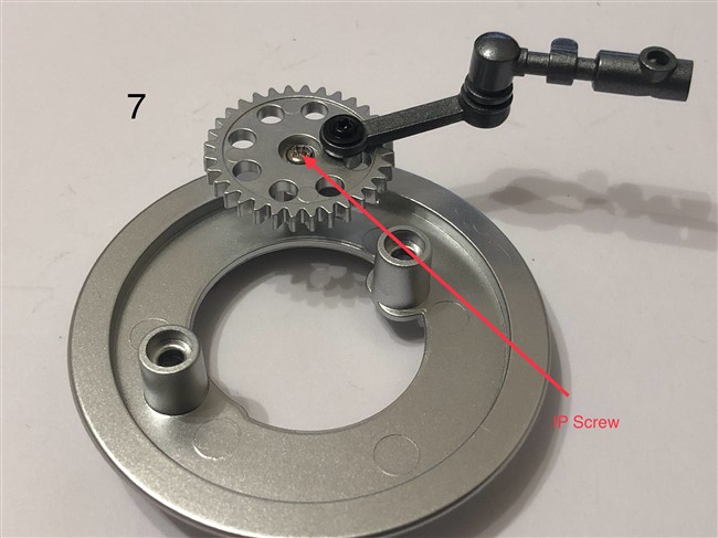

Points: 21,211

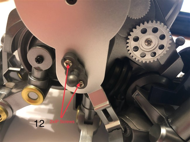

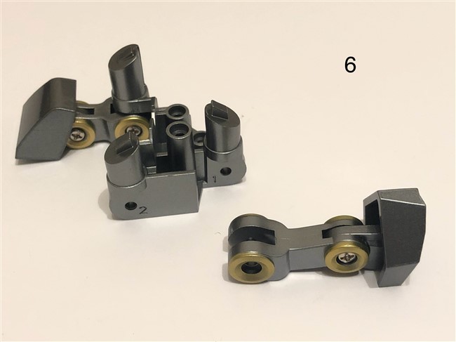

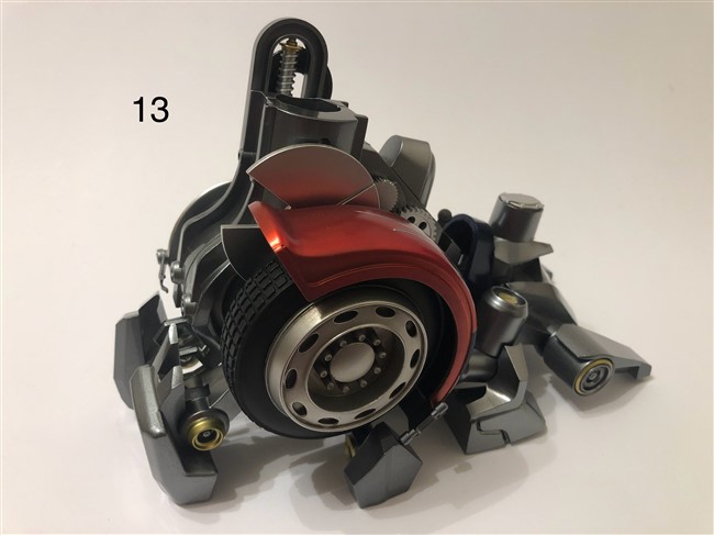

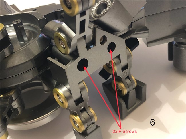

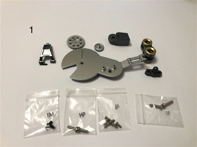

Issue 9

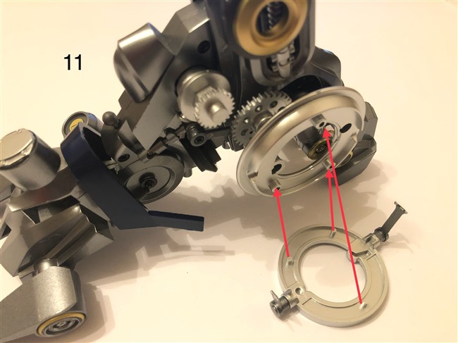

Picture 1
Note the orientation of the parts in picture 2, and secure with an HP screw as shown in picture 3.
Retrieve the assembly in issue 7 and attach the new stabiliser with an FP screw to complete the assembly as shown in picture 4.
Now it is time to attach the assembly to the bottom of the foot. Position and fix with 2xIP screws, pictures 5 and 6.

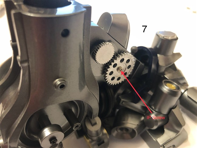

Now fit the outer upper gear, the smaller cog, applying a little pressure to push fit in place. Next attach the lower gear and fix in place with an IP screw, picture 7.

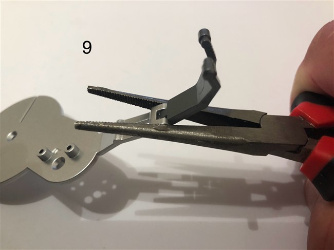

Note the orientation of the parts as shown in picture 8, making sure they are correctly in position before inserting the pin. This needs to be inserted using a pair of small pliers as shown in picture 9.
Note take care when inserting the pin.

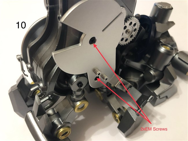

Now attach the assembly using 2xEM screws as shown in picture 10.

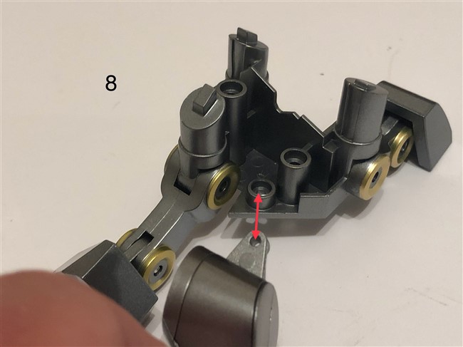

Attach the ball joint as shown in pictures 11 and 12, using 2xIP screws.
Next retrieve the wheel assembly in issue 6 and push fit it onto the ball joint as shown in picture 13.
That complete the assembly in this issue as shown in picture 14.

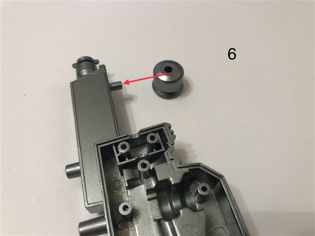

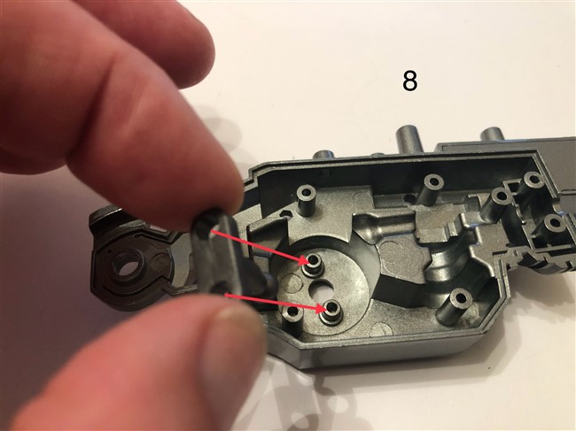

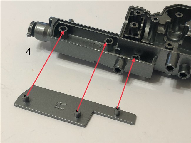

Issue 10

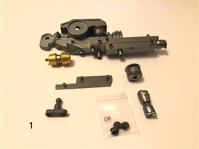

Assembling the Right Leg
Picture 1

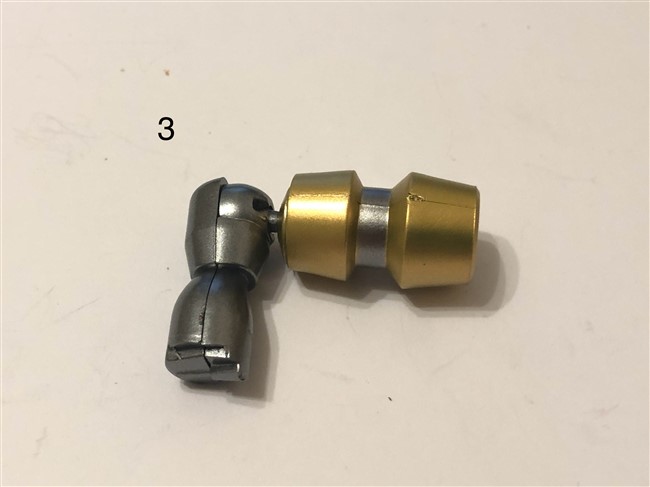

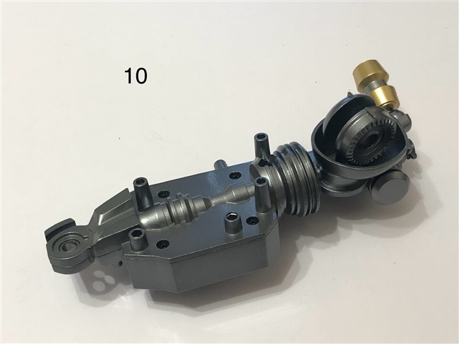

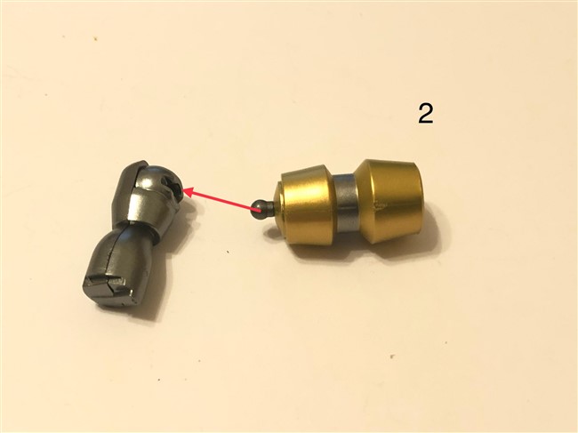

Fit the ball joint of the cylinder into the cylinder bracket as shown in pictures 2 and 3.

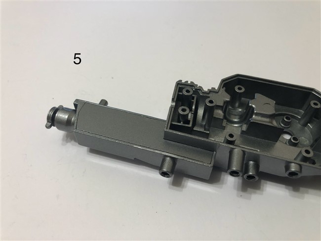

Next, fit the plate to the thigh structure as shown in pictures 4 and 5, push fitting it in place with a little pressure.

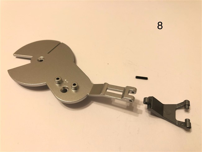

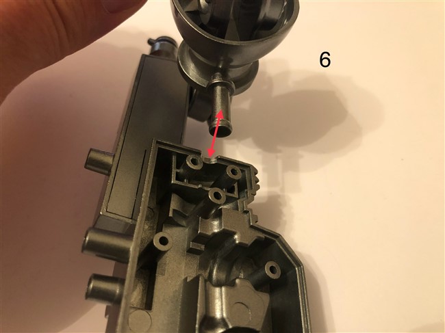

Place the right leg frame detail on the top pin as shown in pictures 6 and 7.

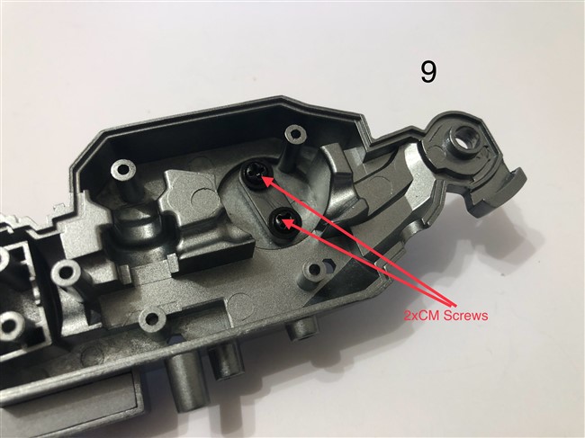

Now fit the ball joint using 2xCM screws, pictures 8, 9 and 10.
Picture 11 shows the final assemble for this issue.

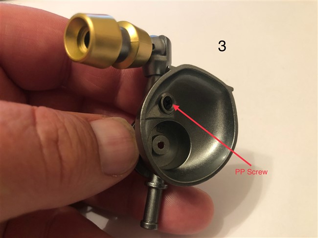

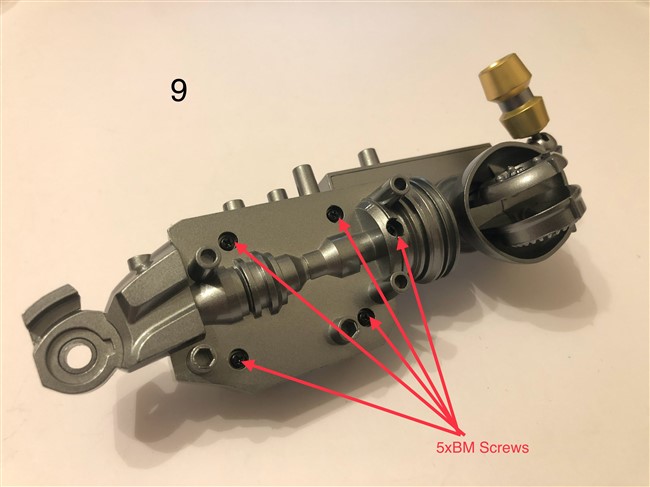

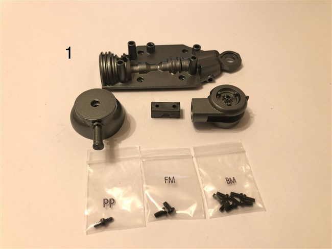

Issue 11
Picture 1

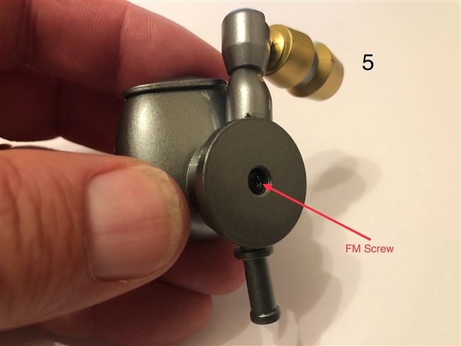

Recover the cylinder from issue 10 and fit to the hip joint using a PP screw as shown in pictures 2 and 3.
Fit the joint to the assembly as shown in pictures 4 and 5, securing with an FM screw.

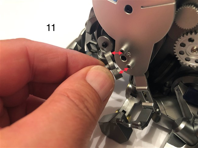

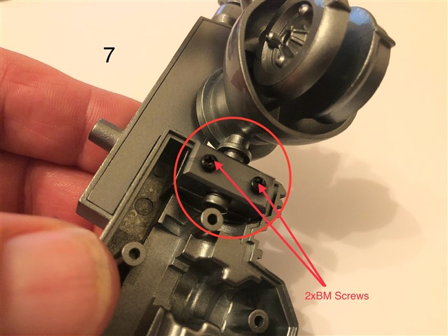

Next fit the joint assembly to the thigh structure as shown in picture 6, noting the orientation of the part. Hold in place a fit the support bracket over the hip joint that is placed in the thigh and secure with 2xBM screws, picture 7.
Finally, add the lower thigh plate, as shown in picture 8 and secure with 5xBM screws seen in picture 9.
Picture 10 shows the final assembly for this issue.
