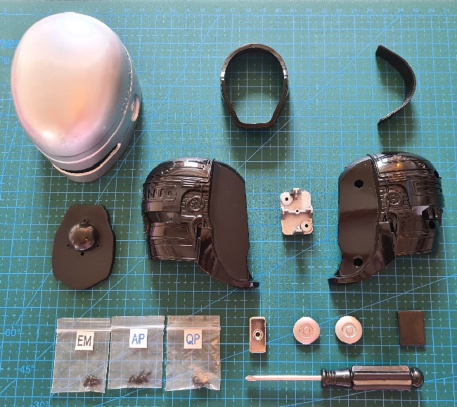

We start with the line up of the components for issue 1 (Pic 1) that also comes with a screwdriver.

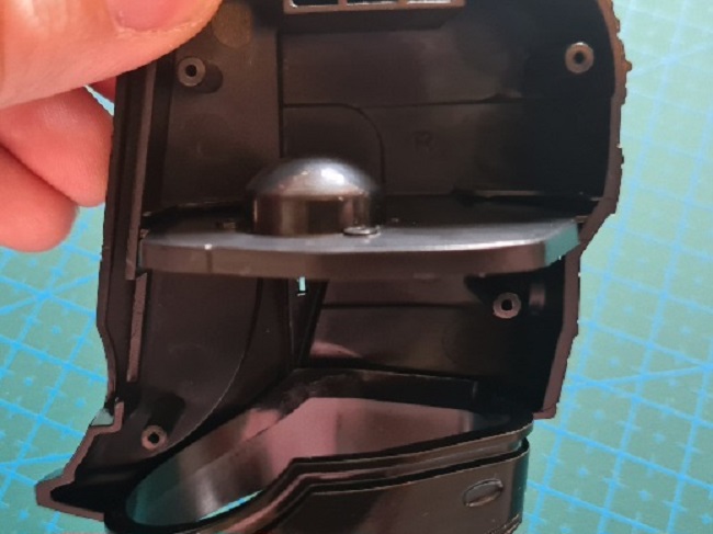

The internal plate (1F) has a raised section with holes around it, that end of the plate goes towards the front of the inner head (1E) as shown in (Pic 3)
There is a recess for the plate to go into as shown in (Pic 4)

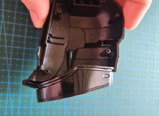

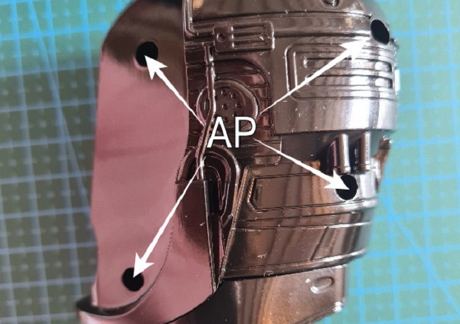

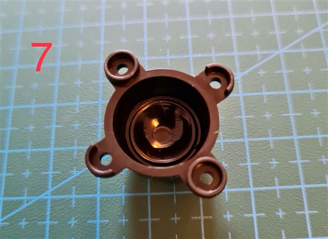

Lay the assembly on its side for now, it is stable enough to not roll around (Pic 6). Place the other half of the inner head (1D) onto your assembly and press into place gently, taking care to check that all inner parts line up. Now use 4 x AP screws in the holes indicated to secure both halves together (Pic 7)
Note: Do not over tighten the screws as the plastic thread that has been cut will strip out.

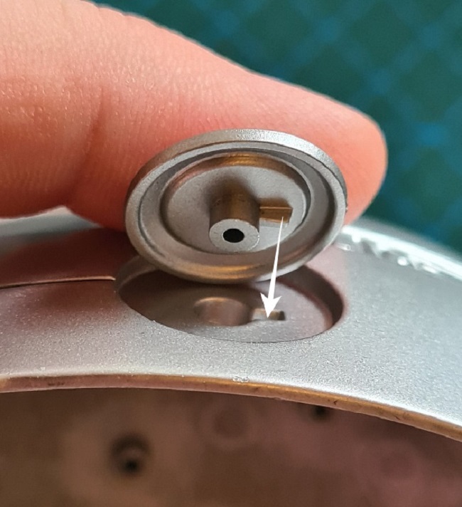

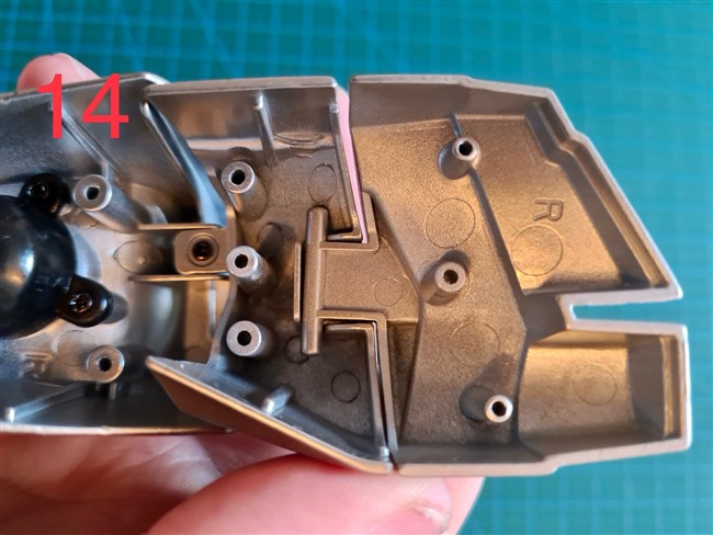

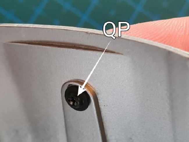

The ear pieces (1C) are not handed so can be used as either left or right. The both have a locating lug on their inner side that has a matching recess on the helmet (1A)(Pic 1)
Place each ear piece in turn into its location on the helmet and hold it in place whilst holding the helmet upside down and using a QP screw to secure it in place (Pic 2). Be careful as you will be going in at an angle due to the other side of the helmet, so do not apply excessive pressure when screwing it in as the screwdriver may slip and cause injury or damage.
Now repeat for the other ear piece.

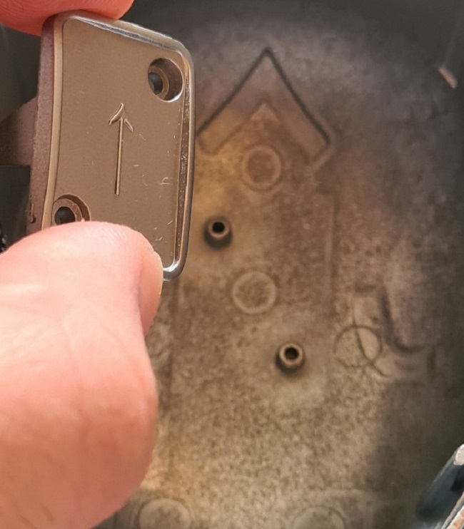

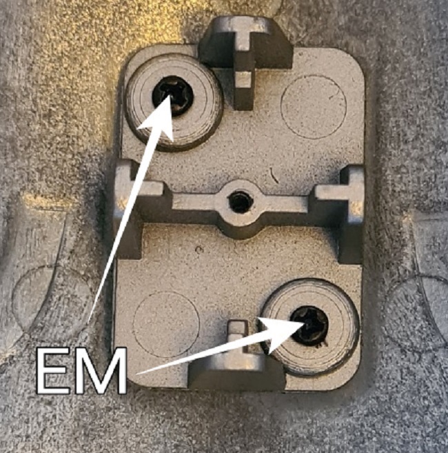

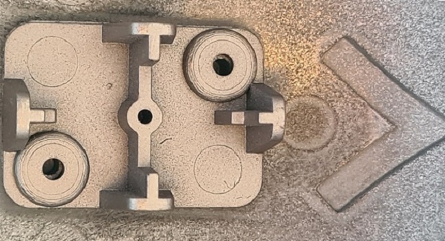

The magnet holder (1J) has an arrow on it, this points in the same direction as the large arrow inside the helmet (Pic 3 and 4) and is secured in place with 2 x EM screws (Pic 5)

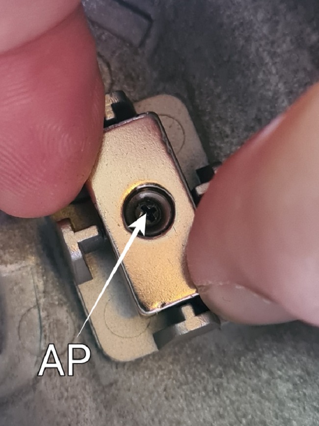

The magnet (1H) goes in next. It has a recess for a screw on the top side. Use 1 x AP screw. Put the screw in the hole then put it in place inside the magnet holder (1J) and pin it in place with two fingers as you bring the screwdriver in (Pic 6)
It is a strong magnet and will leap out onto your screwdriver before you can get close enough to tighten the screw if not held down.

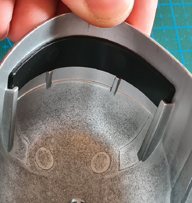

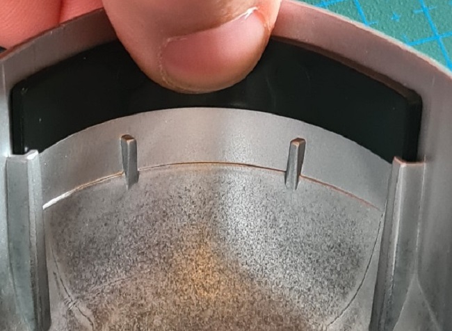

The visor (1B) goes into the helmet next. Place the visors outside edges into the retaining grooves as shown (Pic 7) and slide into place. Apply gentle pressure to secure in place. There is no click once in place, as soon as the top edge contacts the raised stopping points, your visor will hold in place (Pic 8)

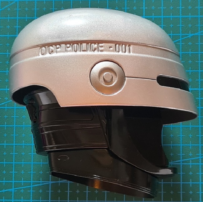

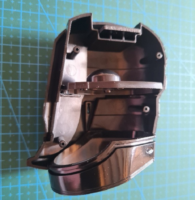

You can now place the helmet onto the inner head assembly. The magnet holder fits inside the hole on top of the inner head. It can be a bit tricky to locate properly until you have the hang of it, so keep a firm grip on both components and position them gently until the magnet holds the two parts together (Pic 9)

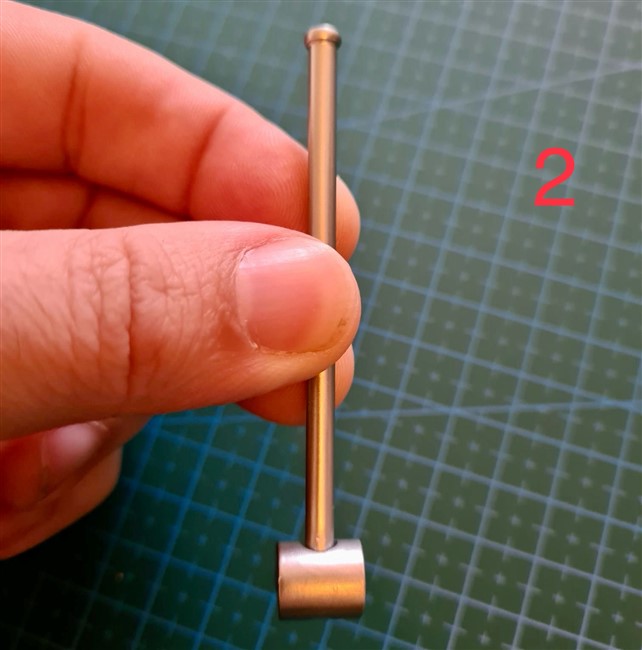

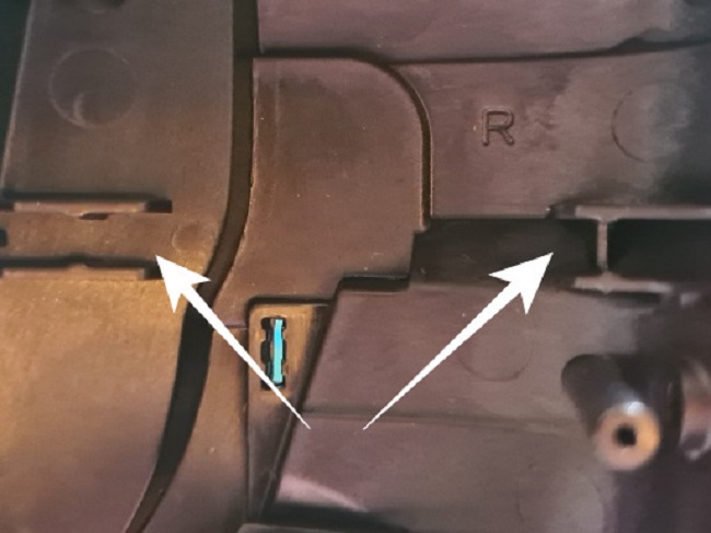

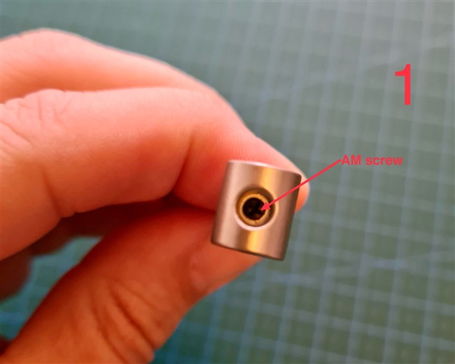

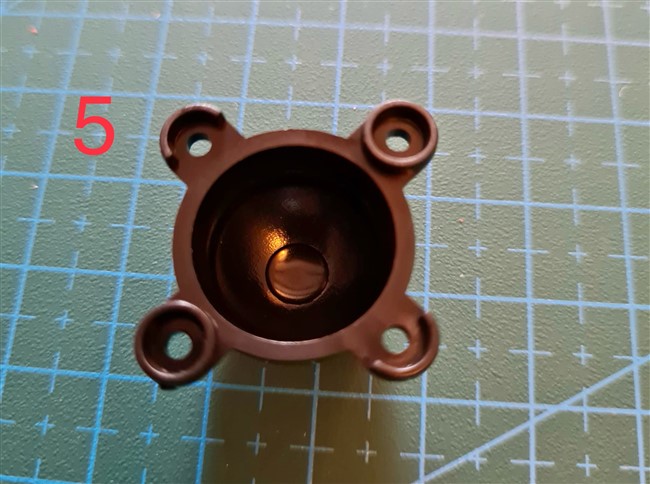

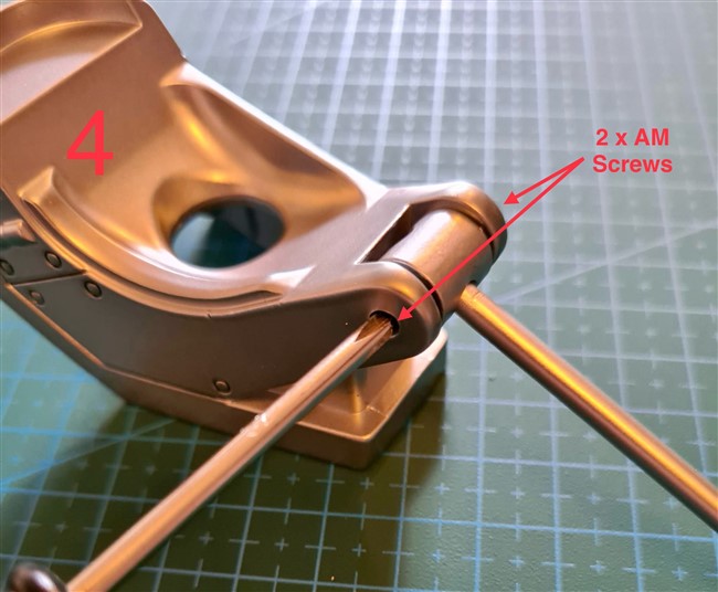

Join the heel support pieces with an AM screw as in picture 1 and 2.
Note: The screw is a very tight fit. I had to grip the rod with a pair of pliers lined with rubber to grip it whilst screwing in the screw.
Next, fit the support to the back of the main foot piece with 2 x AM screws. Pictures 3 and 4.

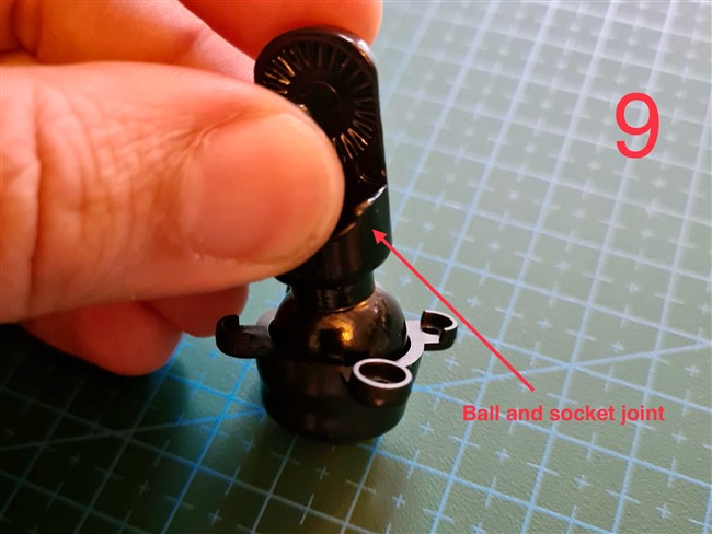

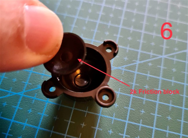

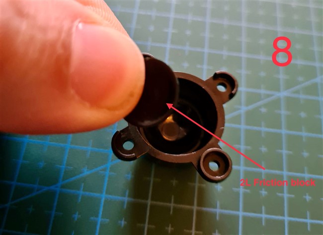

Now insert the 1st friction block into the base of the joint, pictures 5 and 6. Then place the smaller friction block in the same way, then insert the ball and socket joint with the ball facing downwards, pictures 7 to 9.

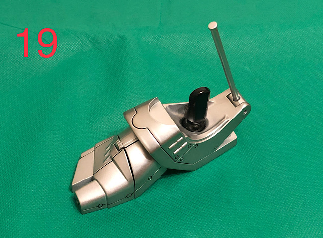

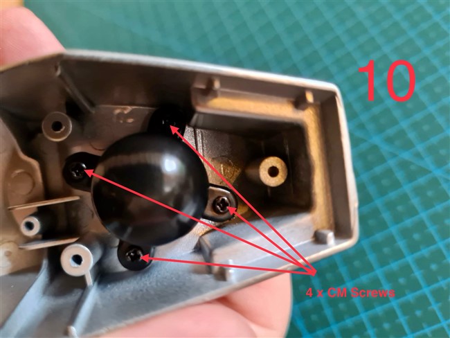

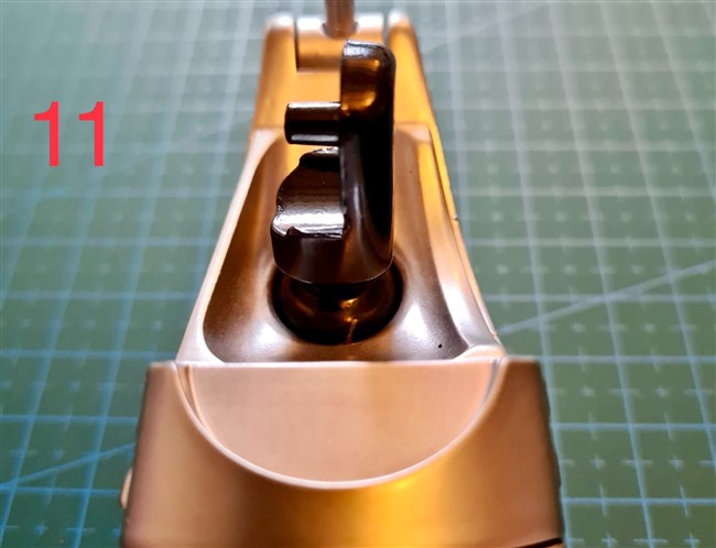

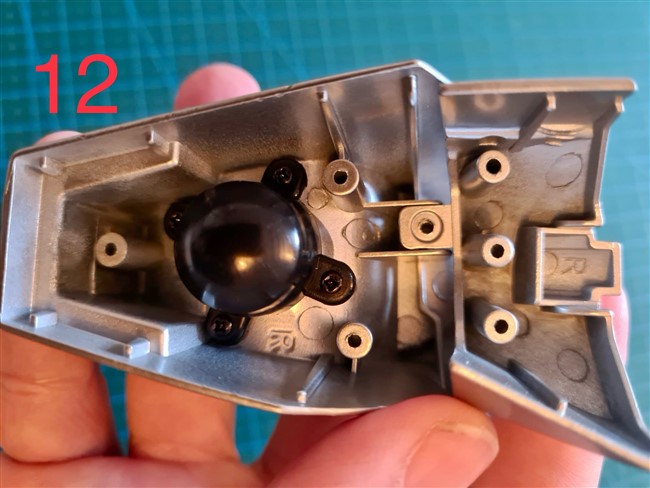

Now assemble the four elements with 4 x CM screws as shown in picture 10. Picture 11 shows how it will look on the top view.

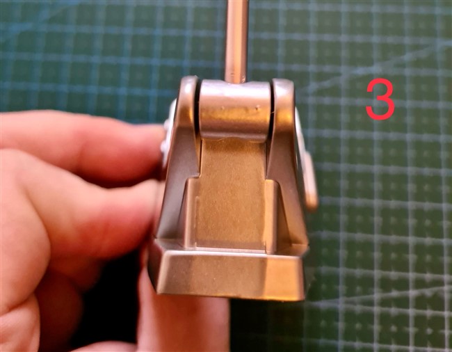

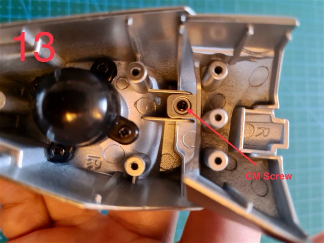

Place the instep under the main part of the foot, picture 12, and secure with a CM screw, picture 13.

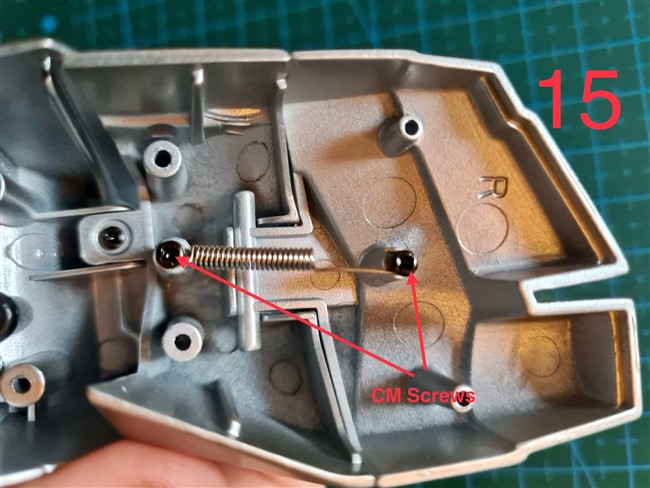

Fit the toe cap on the inside of the foot and fit the spring, pictures 14 and 15.
Note: The easiest way to fit the spring is to attach the closed end of the spring first with a CM screw, then fit the other CM screw, but don’t screw it all the way, then stretch the open end of the spring around the screw and secure tightly.

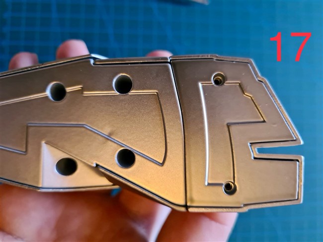

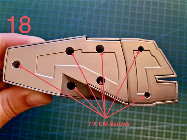

Finally fit the rear sole and then the front sole and secure with 7 X CM screws, pictures 16 to 18.
The final picture shows the complete assembly.
