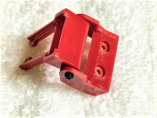

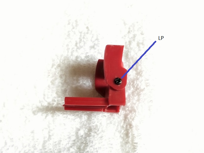

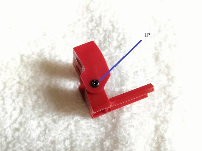

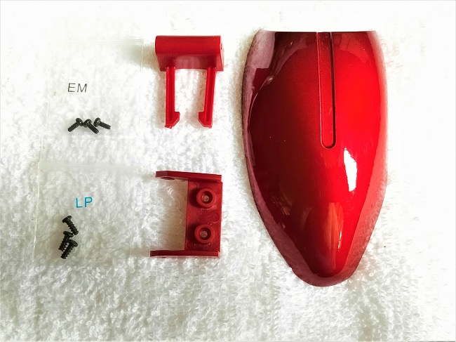

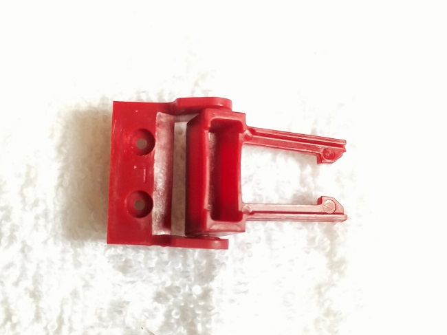

Position the two parts of the hinge supplied in this issue as depicted in Pic 2. Then fix the parts together with an LP screw (one on each side) as shown in Pics 3 and 4. Note: the two LP screws need to be tightened enough so that the hinge does not move without some applied pressure and is not so tight that it won`t move at all.

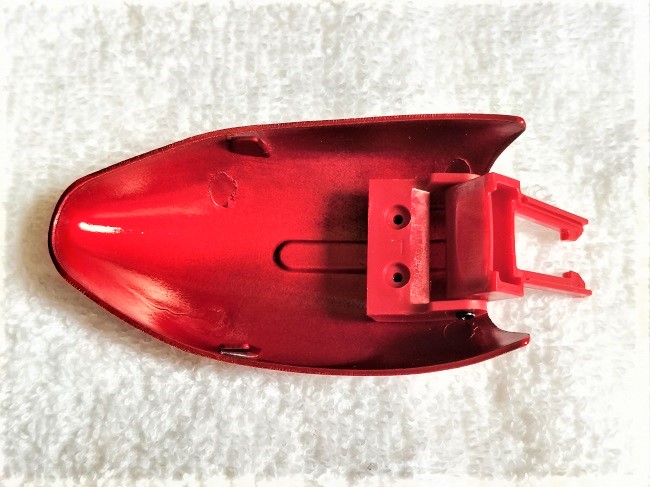

The completed hinge is shown in Pic 5.

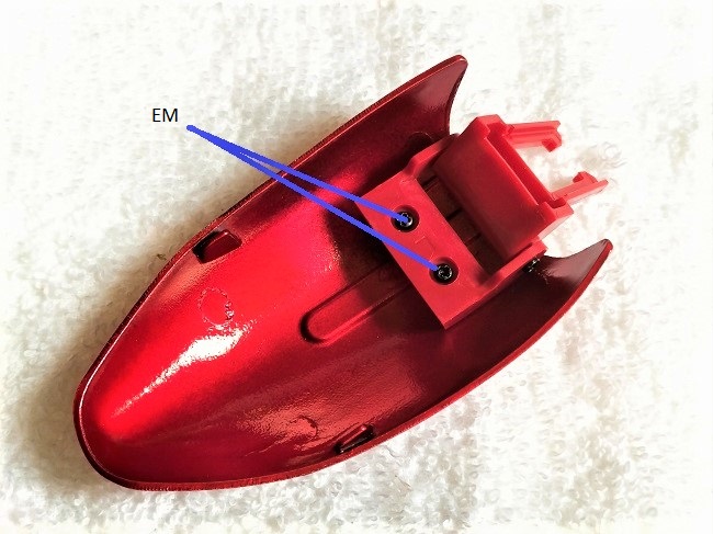

Next, position the hinge on the inside of the calf plate as in Pic 6, then fix the hinge in place using two EM screws as in Pic 7.

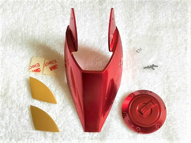

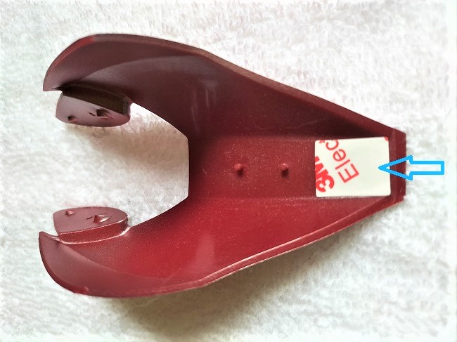

Take the Upper leg plate and one of the double sided pieces of tape (second piece being a spare). Removing one of the protective covers of the tape , fit the exposed sticky side downwards, placing the tape onto the Upper leg plate as shown in Pic 2.

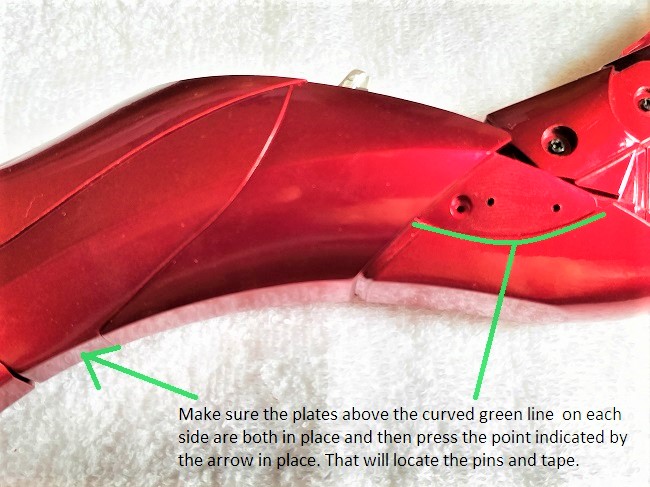

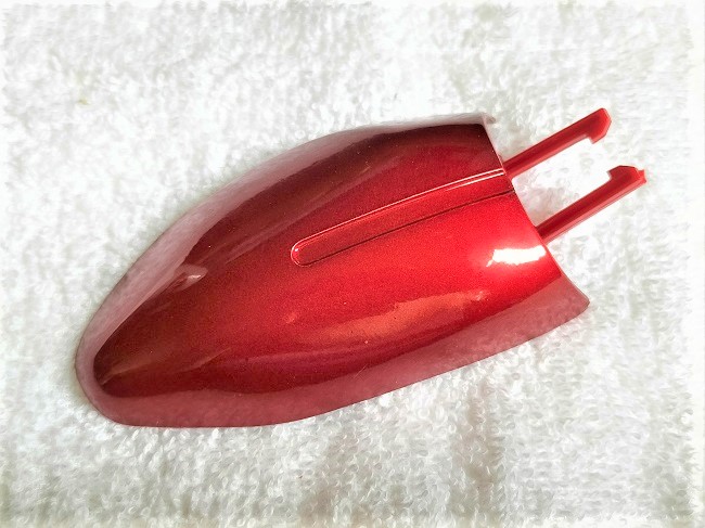

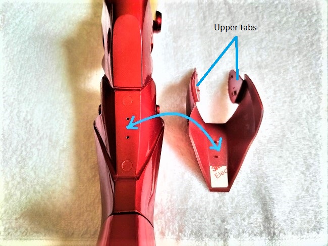

Bring the main leg assembly back to the work space along with the Upper leg plate as shown in Pic 3. Note: the relevance of the arrow in Pic 3 relevant to the locating pins and holes of the two parts, plus what I have described as the "Upper tabs".

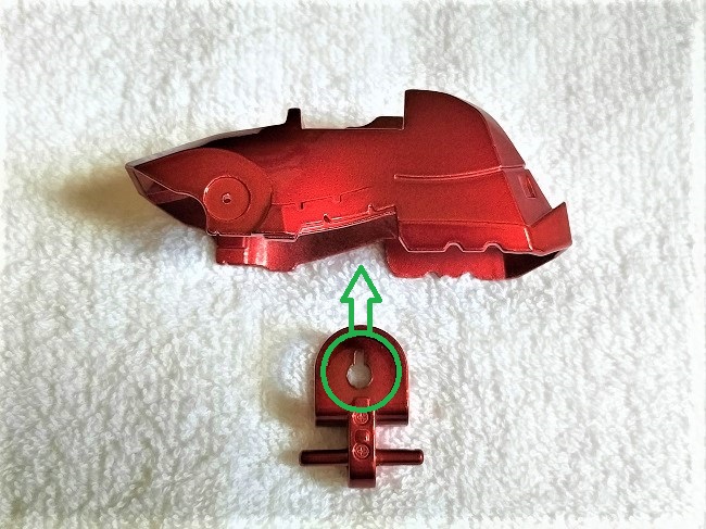

The next constructional stage, brings the Upper leg plate into its final position. I found it best to get the Upper tabs into position first and then bring the plate in towards the main leg assembly so the pins locate and the double sided tape holds the lower edge in place. Pic 4.

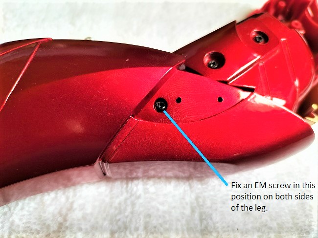

That tricky little bit done and dusted, you now need to lock the "Upper tabs" in place using an EM screw, one on each side as shown in Pic5 for one side.

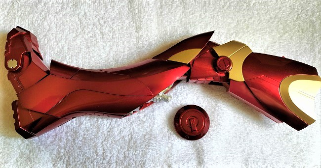

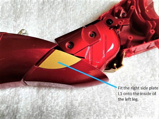

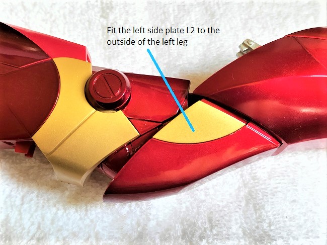

There are now two detailing parts to press fit over the points where you placed the last two screws. Noting that the Right side plate L1 fits on the inside of the left leg, Pic 6 and the other detail L2 is pressed in place onto the outside of the left leg. Pic 7.
That completes the Left leg as far as it will go at this stage. Pic 8.

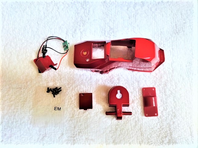

Parts supplied with this issue are shown in Pic !.
My hope is, that there will be enough detail in this and following updates to save you going back in time and look at old posts and/or issues you have received. My apologies if something is missed, but feel free to let me know and I will make any amendments needed. Crying

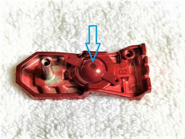

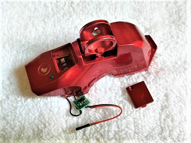

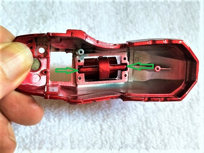

So to start, bring the Right Foot and Ankle Joint to your work space, placing them in the orientation shown in Pic 2. Note: that as indicated by the green circle, the large round hole in the Ankle Joint is uppermost. This will make sure that you have the correct orientation of the ankle for future updates.

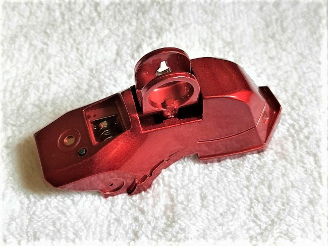

Keeping the parts as placed previously, slide the Ankle Joint inside the Foot and locate the pivot posts as shown in Pic 3 by the green arrows.

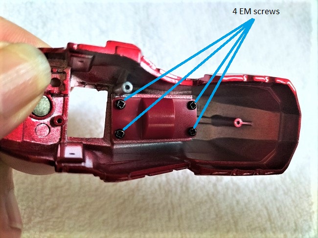

The Ankle Joint Cover is now positioned on the inside of the foot and over the Ankle Joint. Pic 4. The cover is then fixed into position using 4 x EM screws as indicated in Pic 5.

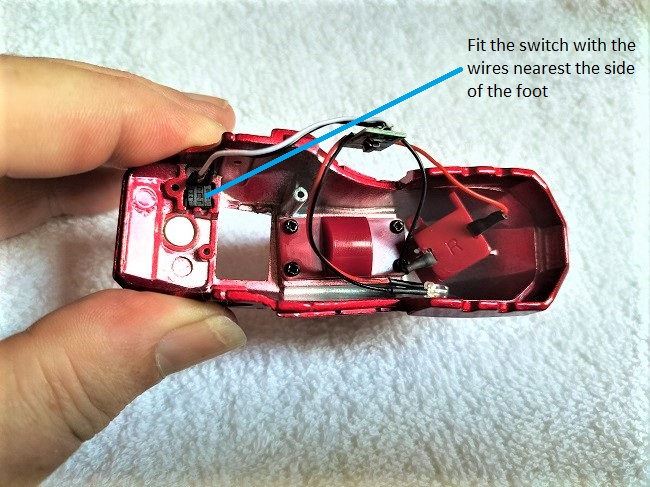

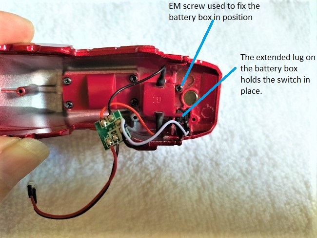

From the parts supplied with this issue, now bring the LED assembly to the table. Then position the switch into the hole next to the magnet, making sure that the wires from the switch are next to the outside of the foot, Pic 6.
The next task is to fit the battery box, but first make note of the extended lug on the battery box. This is positioned over the switch (to hold it in place), then the battery box is secured into position using an EM screw. All indicated in Pic 7.

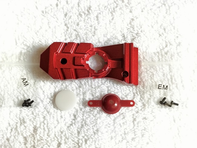

Parts supplied for this issue are shown in Pic 1.

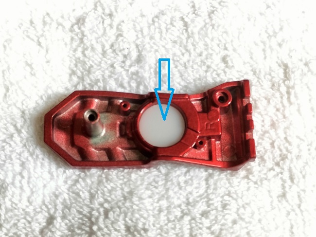

To start, take the heel section and insert the LED screen into its position as shown in Pic 2.
Position the LED support over the screen Pic 3 and fix the support in place using 2 x AM screws as shown in Pic 4.
Continue by bringing the main foot assembly back to your work space along side of the heel plate. Then carefully press the LED into the heel plate as shown in Pic 5.

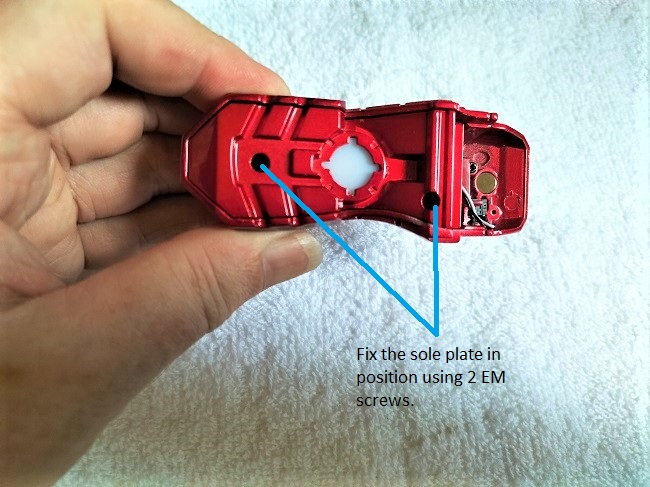

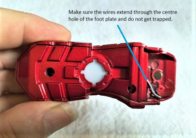

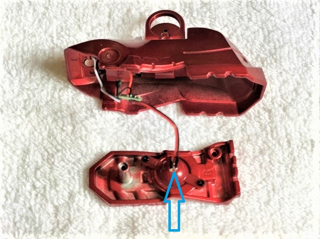

Bring the heel plate into place under the main foot assembly, making sure that the wires from the micro switch, pass through the centre hole of the heel plate and do not get trapped between the parts. Pic 6.
When, and only when you are sure the wires are in the correct position and not trapped, fix the heel plate to the main foot assembly using 2 x EM screws as shown in Pic 7.
