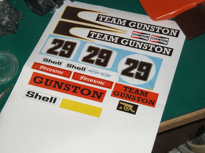

#3 Posted : 25 June 2023 09:00:40
Posts: 5,192
Points: 15,725
Hello John.
As Mark has said, making your own is really easy when you get used to it.
Just make sure you scale your art/text to the right size.
If you have light text or art over a coloured background, create a 'box' with your model colour in it and put the text etc on top.
The Gunston Lotus in the pics has every decal created by me.
It's actually good fun when you get the hang of it.
Roy.
