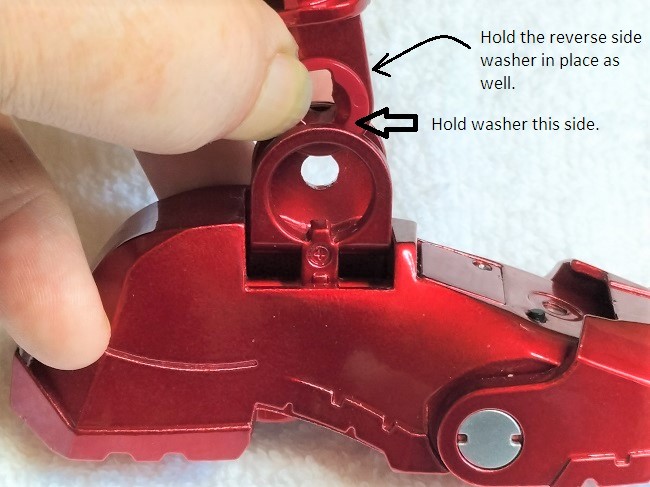

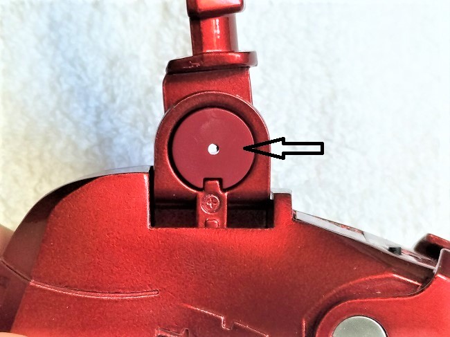

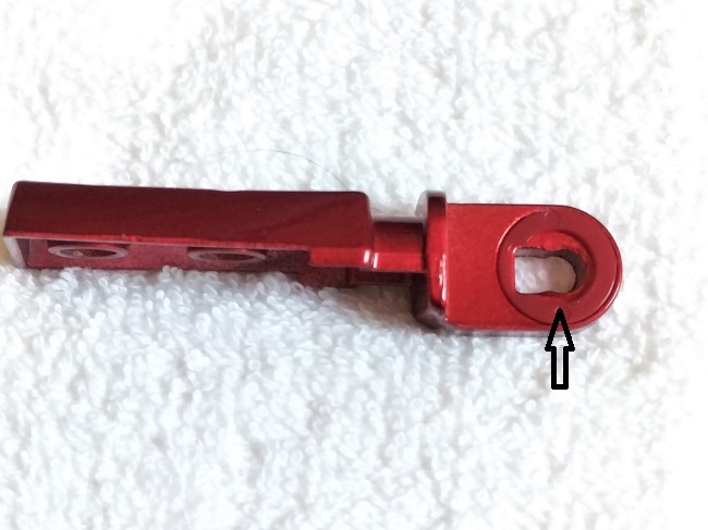

Then, position an Ankle Washer (Checking the Orientation) into the indented side of the Lower Leg as shown in Pic 3. Now, whilst holding the washer and lower leg in position add another washer in place to the lower leg on the other side to the previous one and follow on by placing the Lower Leg into the Ankle Pivot of the left foot (keeping both washers in place as you do it. Pic 4.

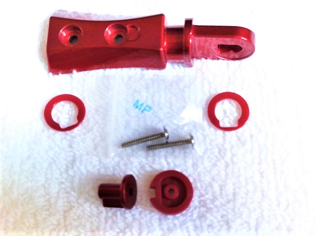

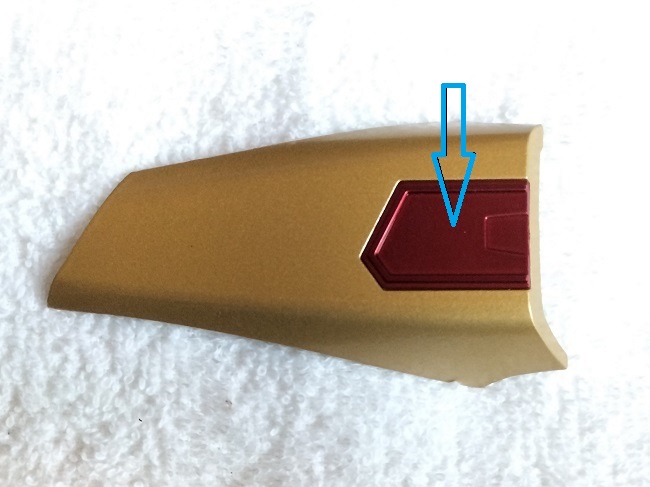

With the Lower Leg and the washer on either side in place, position the Ankle Joint through the Foot and Lower Leg. Pic 5.

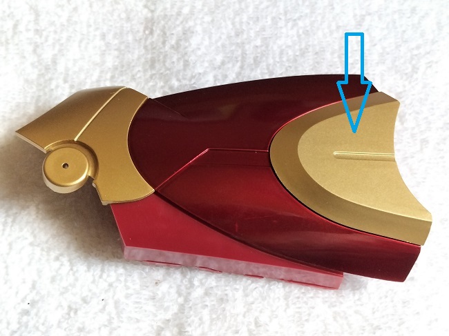

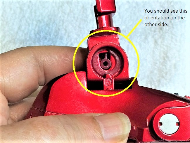

I have added another pic to show the orientation of the Ankle Joint on the reverse side. Pic 6. Now fit the Ankle Lock Washer in the orientation shown in Pic 7 and hold the Ankle Joint together using an MP screw. Pic 8.

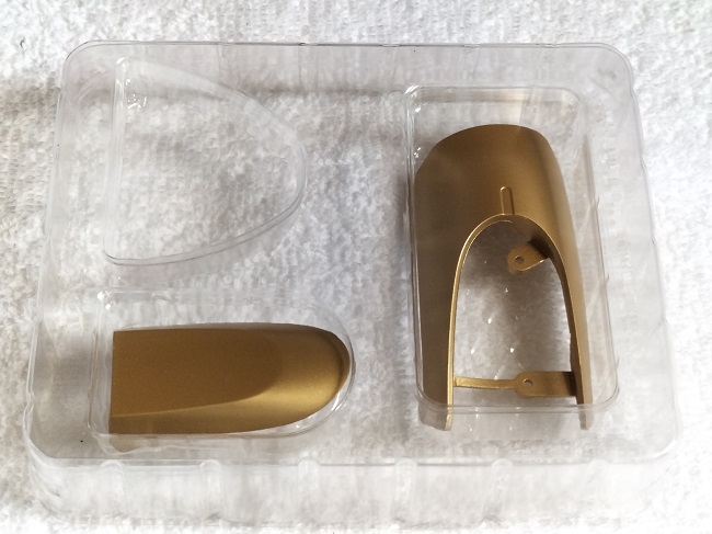

The parts supplied are shown in Pic 1.

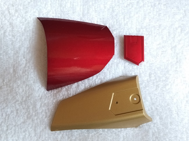

The first thing to do is retrieve the Outer Thigh from Issue 34 and carefully press the Outer thigh plate provided with this issue into place. Pic 2.

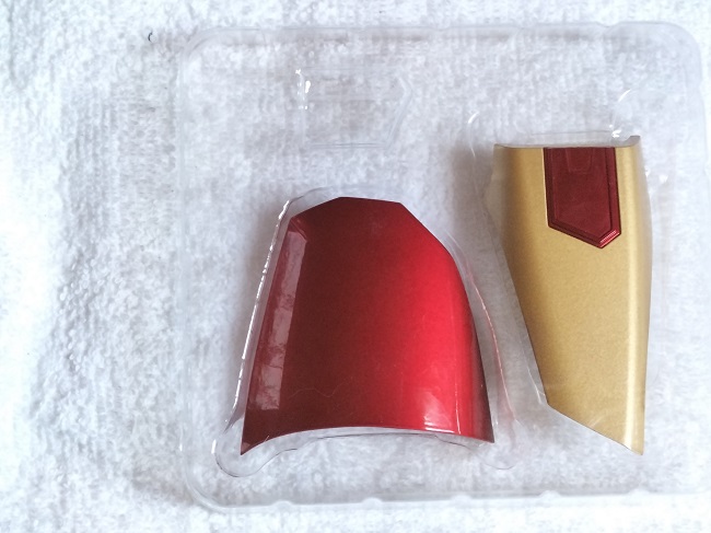

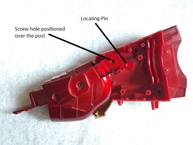

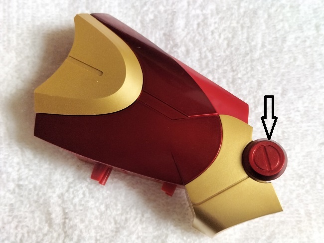

Issue 38 parts are shown in Pic 1.

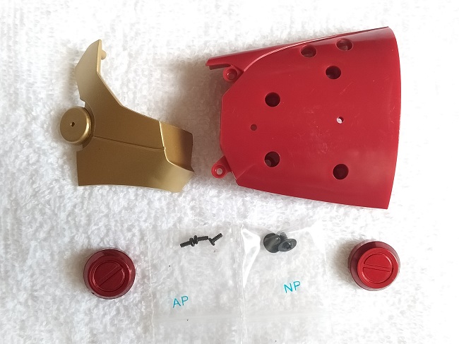

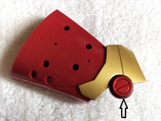

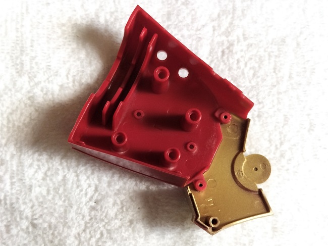

Position the Left inner thigh frame and Left inner thigh plate (supplied in this issue) as shown in Pic 2.

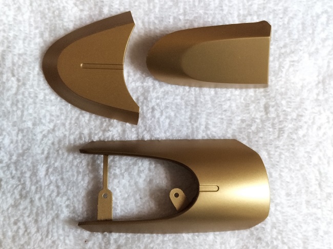

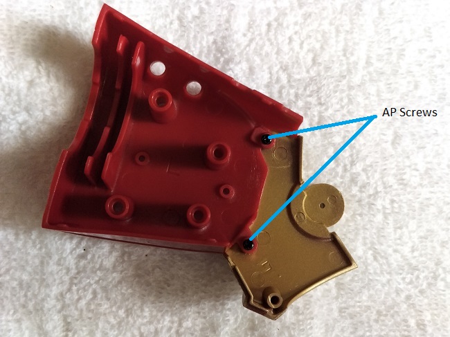

Whilst carefully holding the parts together, fix them using two AP screws. Pic 3.

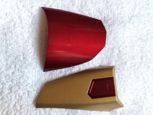

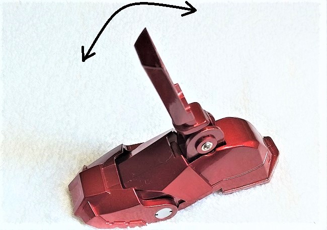

Now flip the parts over and press one of the Knee details into place, Note: that this part can only fit in one position. Pic 4.

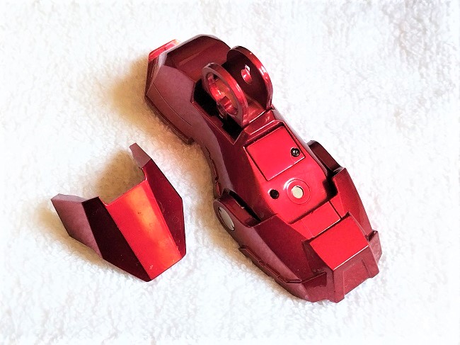

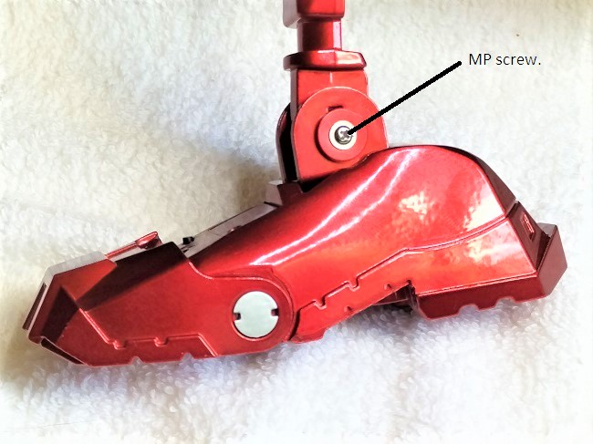

Recover the assembly from Issue 37 and press the second Knee detail into its position as before. Pic 5.

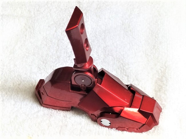

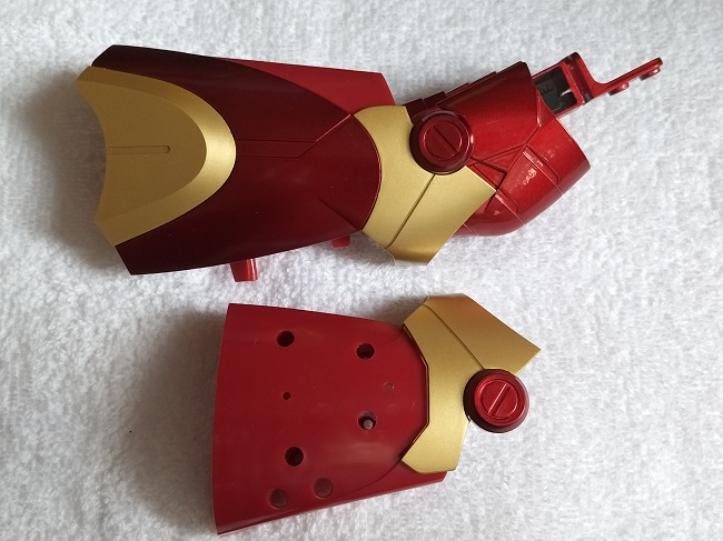

Time to bring the Knee joint from Issue 32 back to the work place along with the last piece we worked on.
Important Note: The instructions for Step/Stage 3 of this issue are incorrect. The notes say you need "the assembly from Step/Stage 1", when in fact, it should read "the assembly from Step/Stage 2".

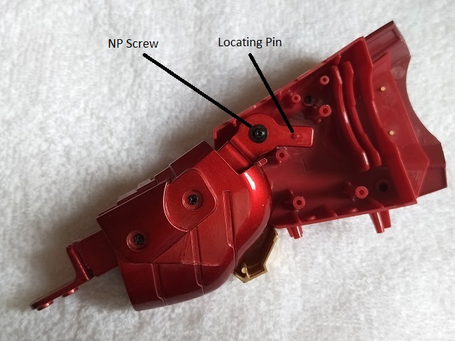

So, with the correct assemblies on the table, position the parts as shown in Pic 6 making sure the locating pin and screw fixing hole are in the correct position. Then carefully holding the parts in position fix them together with an NP screw as in Pic 7.
