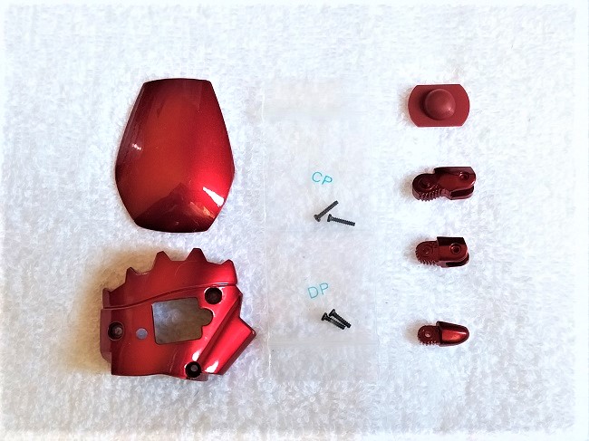

Parts supplied are shown in Pic 1.

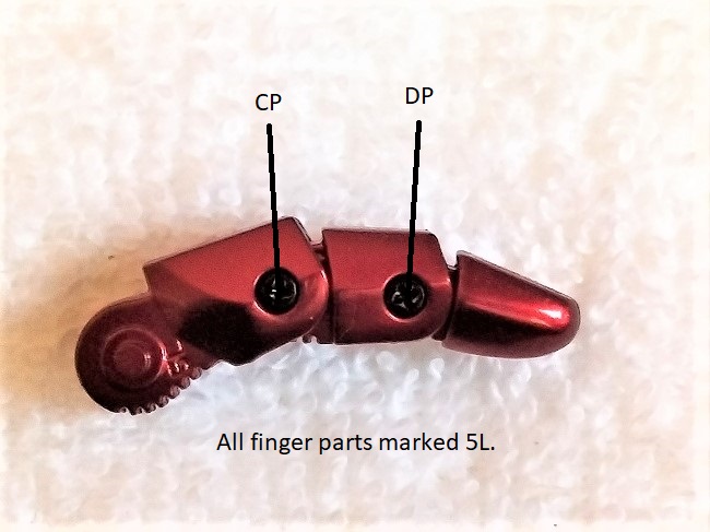

The Little Finger parts are all marked 5L and the whole construction is shown in Pic 2, with the relevant screws used notated.
The rest of the parts supplied with this issue will be used along with the issue 28 parts to complete the Left Hand/Arm. So keep them safe and I`ll see you soon for the next update. ThumpUp ThumpUp ThumpUp

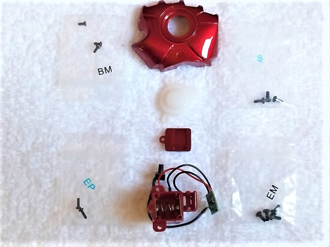

So the parts for this issue, are as usual shown in Pic 1.

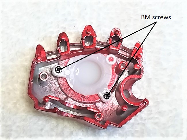

To start, place the screen inside the palm and make sure the pin locates correctly into the screen and fix the two parts together using two BM screws. Pic 2.

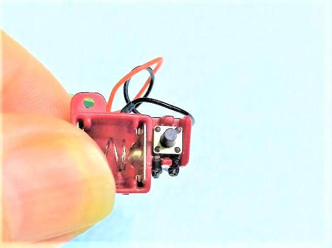

As with the Right Hand, take the LED assembly and being very careful with the wires put the micro switch into its position in the side of the battery box. Pic 3.

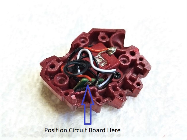

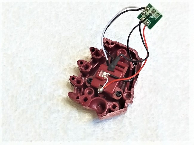

You now need to place the circuit board of the LED assembly and its associated wires as shown in Pic 5, making sure that the wires will not get squashed/trapped when the hand halves are screwed together.

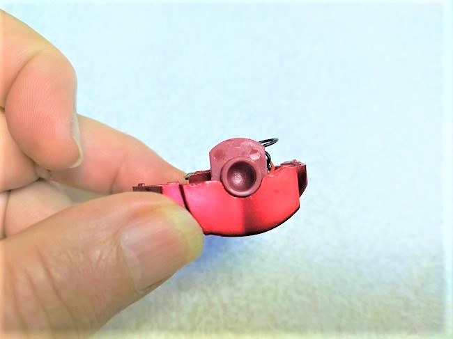

Install the wrist joint supplied in issue 27 at the base of the hand. Pic 6.

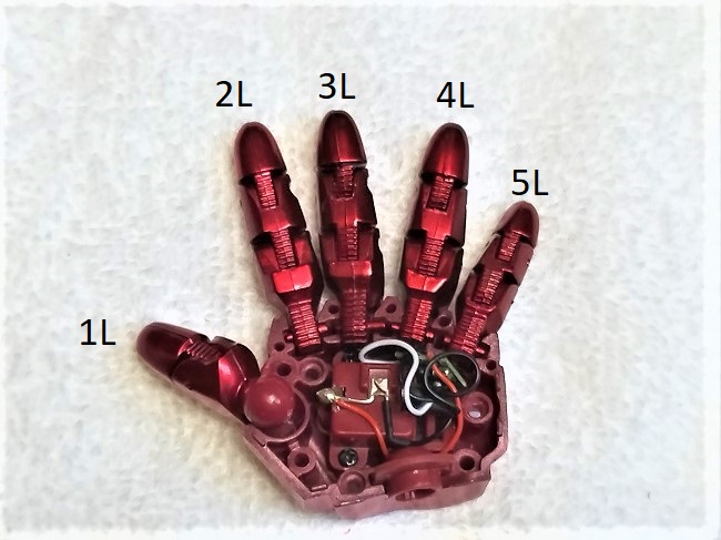

This is the tricky bit Blink , position the thumb and four fingers in the orientation shown in Pic 7. Then place the Palm with the screen in place making sure that the thumb, fingers and wrist joint all locate properly and that you have not trapped any wires. Pic 8.

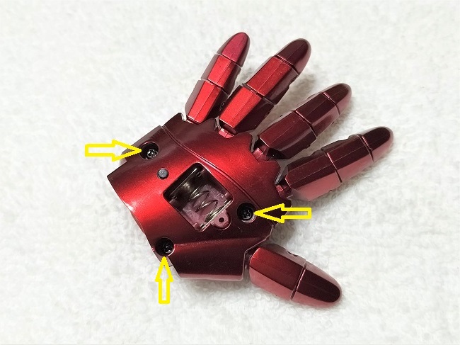

If all is OK as per the above, then hold the back and palm of the hand together. Carefully flip the assembly over and fix it all together using three EM screws as shown in Pic 9.

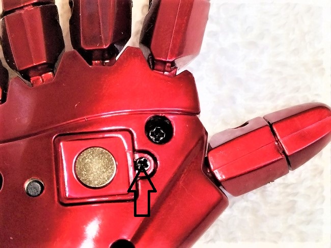

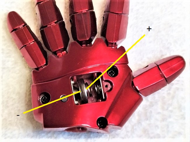

Keeping the hand in the same position, insert a battery (supplied in an early issue) into the battery box following the polarity shown in Pic 10.
Position the battery cover (supplied in this issue) over the battery compartment and fix it with an EP screw. Pic 11.

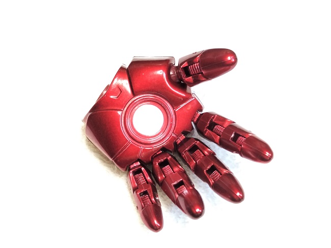

Press the micro switch button on the back of the hand and check the palm light comes on . Pic 12. Don`t forget to turn it off again.Crying

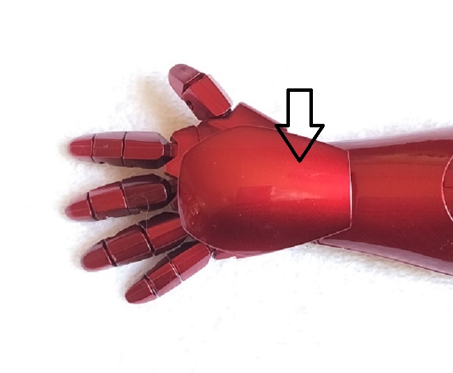

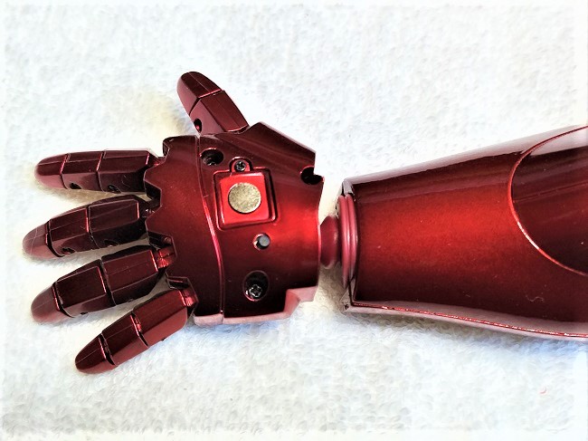

Carefully press the hand onto the lower arm so that the joint clicks into place. Pic 13.

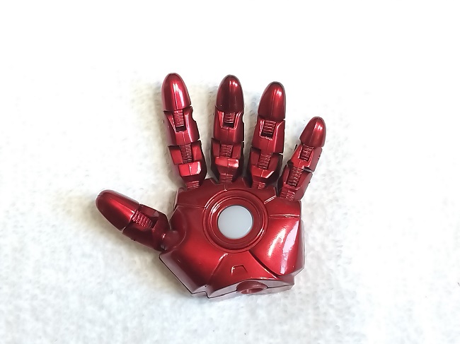

Position the magnetic hand guard onto the back of the hand. Pic 14 and you have completed the Left Arm. Pic 15.

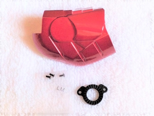

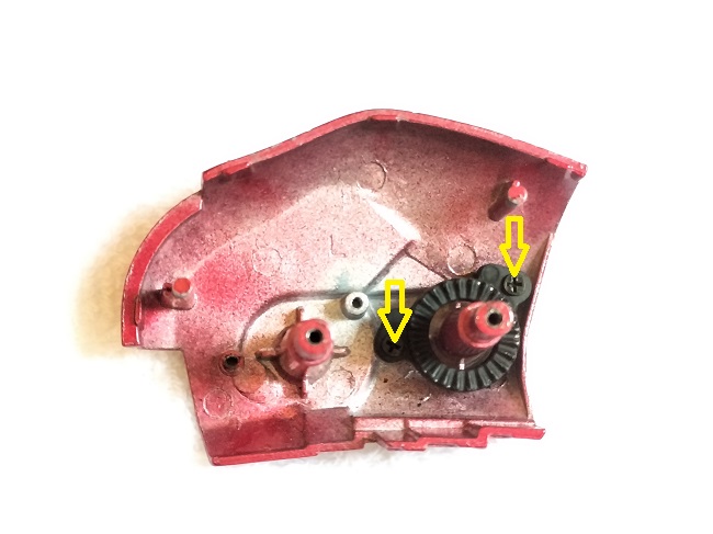

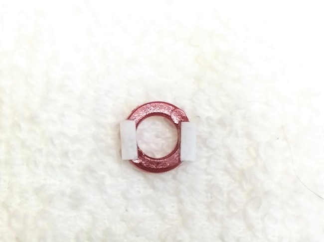

For this issue: Place the Left Knee Gear Ring in place on the cover plate (supplied with this issue). With the gear teeth facing upwards, it can only be orientated in one position as shown in Pic 2.
With the Gear Ring in the correct position, fix it in place using two LM screws as shown in Pic 3.

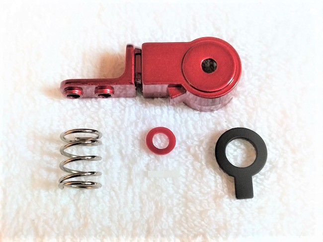

The parts received in this issue are shown in Pic 1.

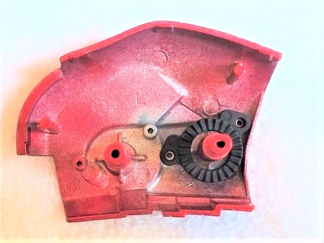

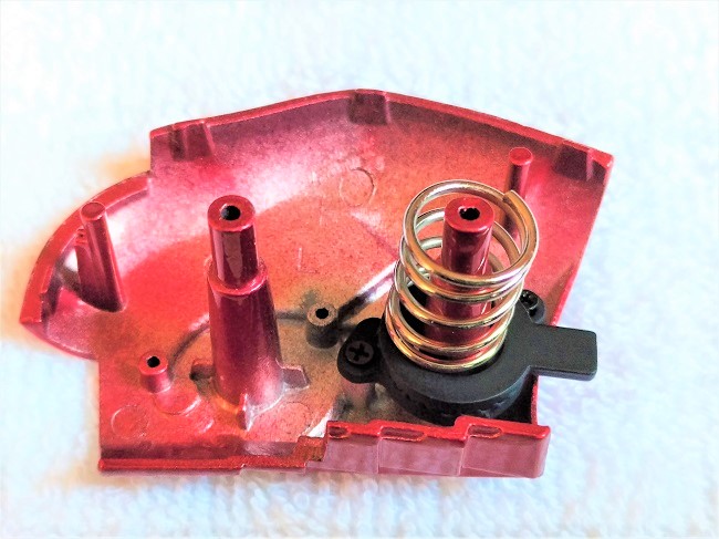

Bring the Knee side plate back to your work space from the last issue and place the Left Knee gear ring supplied with this issue onto the ring gear already installed in Issue 29. (The positioning of the gear tab must be in the position shown) Pic 2.
Then place the spring supplied in this issue over the post so it sits on the gear ring. Pic 3.
Now remove the covering from one side of the double sided tape and position a piece on each side of the washer and press firmly into place, as shown in Pic 4.

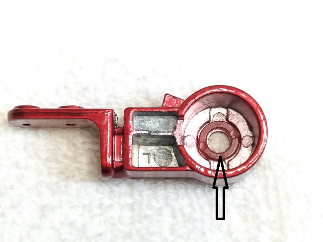

For this part of the build I used a sharp craft knife to remove the second sides cover from the double sided tape, then using a pair of tweezers positioned and pressed the Washer into place inside the Left Knee Lower Joint. Pic 5.
Rest the Lower Joint in place over the spring, noting that the Joint needs to line up with the tab on the upper gear. Pic 6.
