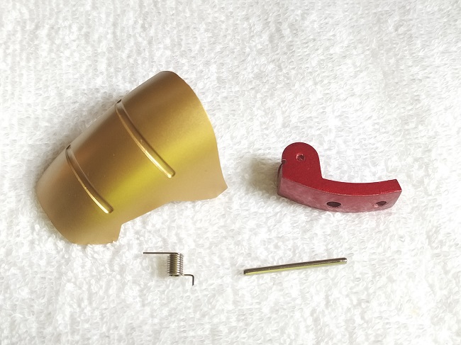

So, onto Issue 23 where we will complete the Upper Arm and the Shoulder Joint, the parts for which are shown in Pic 1.
Complete the Upper Arm with the Gold coloured Arm Plate being careful to align the locating pins in line with the holes, or the pins may get damaged. Pic 2.
Continue by placing the Shoulder Support into position. Pic 3.

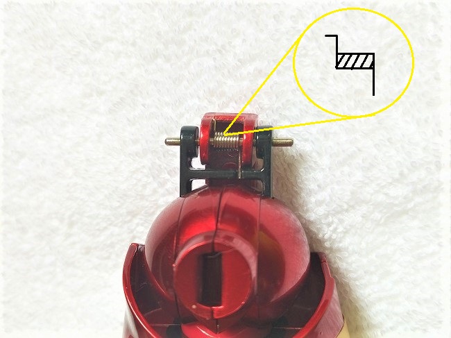

In the next stage we put the spring in place and feed the Shoulder Frame Pin through the centre of the parts. The correct spring orientation and the location of the pin are all shown in Pic 4.

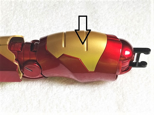

That concludes this Issue and the end result is shown in Pic 5.

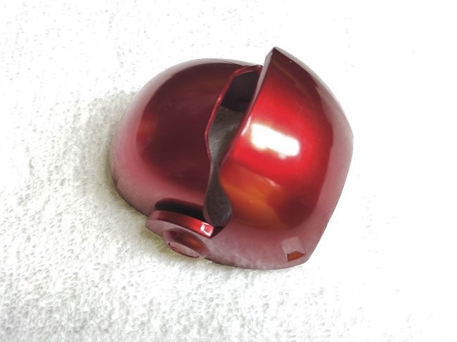

Issue 24 will finish the arm (without the hand) by the addition of the Left Shoulder Armour.

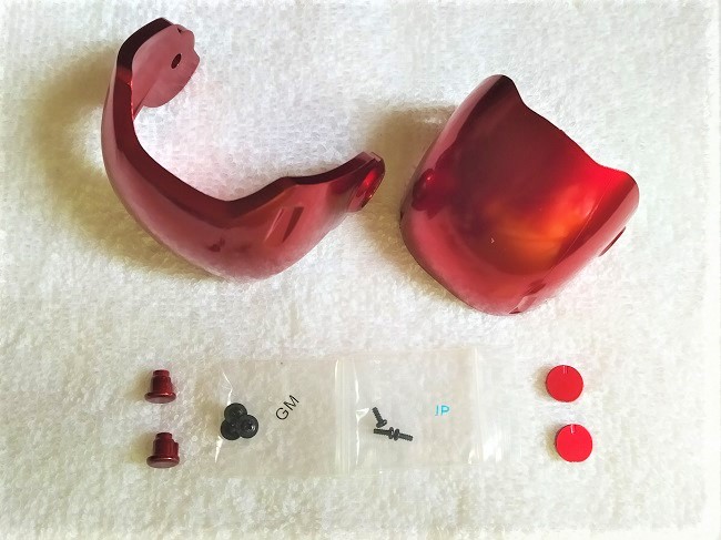

As per, the parts supplied with this issue are shown in Pic 1.

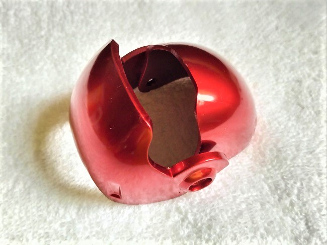

To start, orientate the two Shoulder Plates as shown in Pic 2.

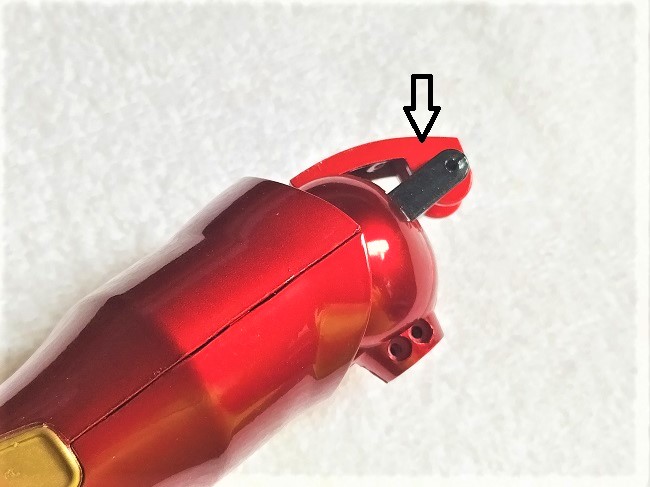

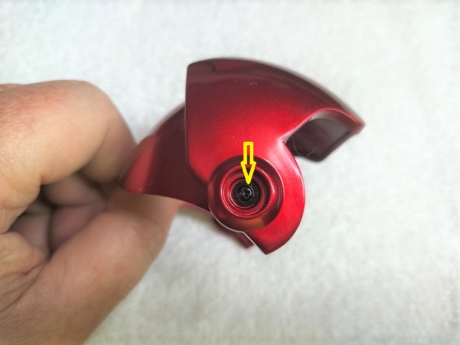

Insert a pivot into one side as shown in Pic 3 and fix it in place with a GM screw Pic 4. Then repeat for the other side. Pic 5.

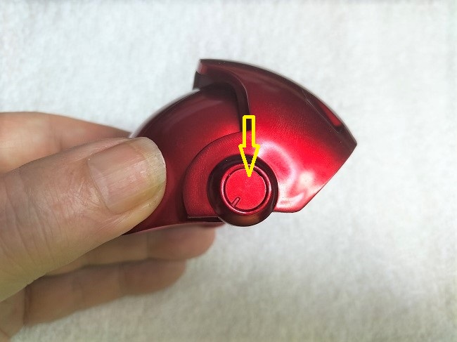

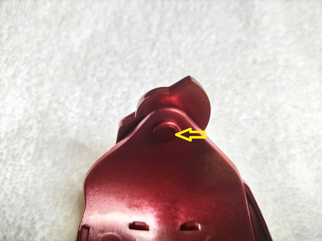

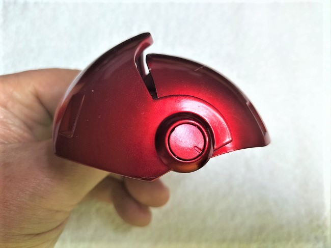

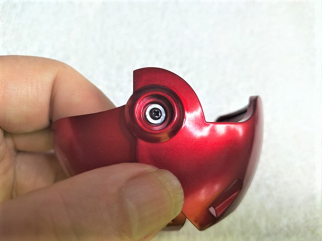

To complete the Shoulder Plates fit a Shoulder Cap over each of the GM screws. Pic 6 and 7. The completed Shoulder Plates are now shown in Pic 8.

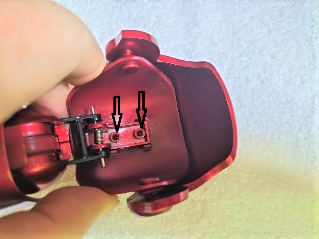

The last task for this issue, is to fix the Shoulder Plates onto the Shoulder Joint. Position the sprung loaded Shoulder Support (of the shoulder joint) inside the newly constructed shoulder plates and fix them together using two IP screws as in Pic 9.

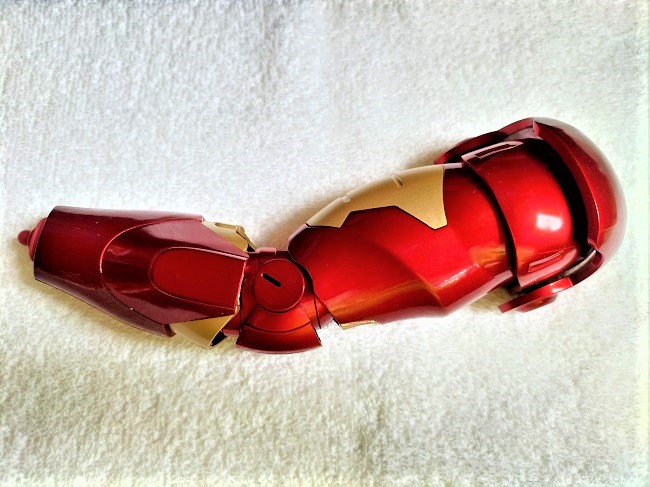

The Left Arm is now complete Pic 10 and the Left Hand construction will start in the next issue (25).

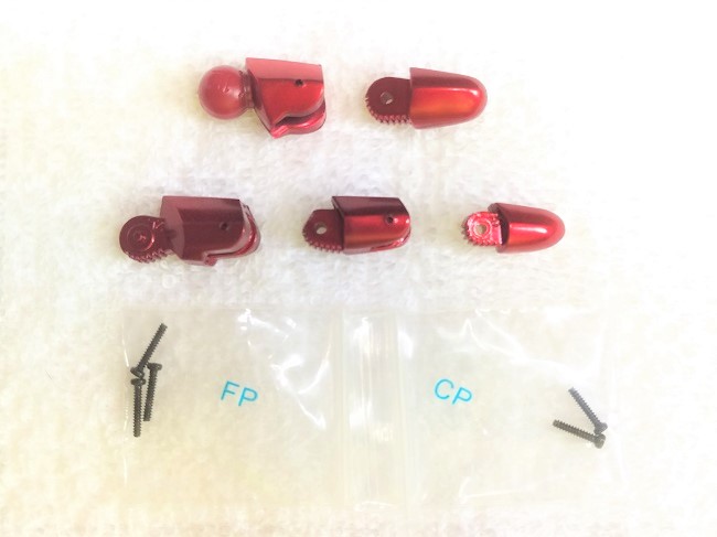

The parts supplied are in Pic 1:
Where parts for the Thumb are marked 1L and the parts for the Index Finger 2L.

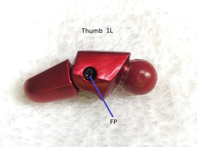

Pic 2: shows the completed Thumb with the screw identified.

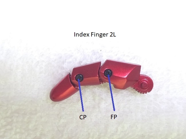

Pic 3: shows the completed Index Finger with screws identified.

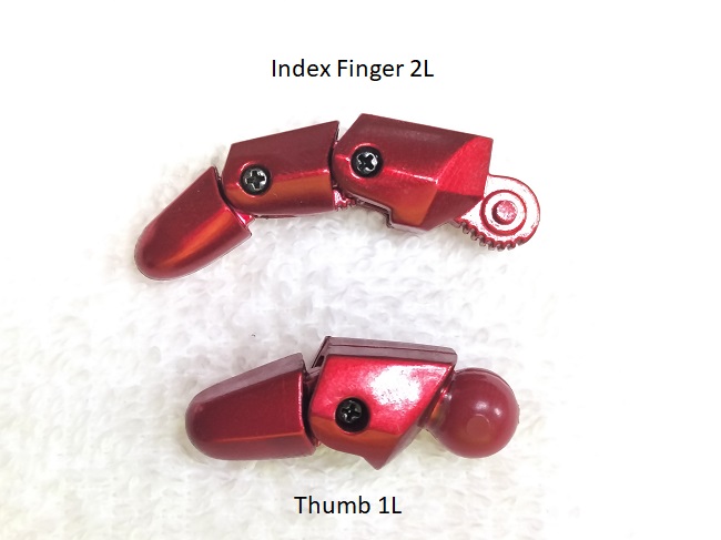

Pic 4: is of the completed digits of this issue.

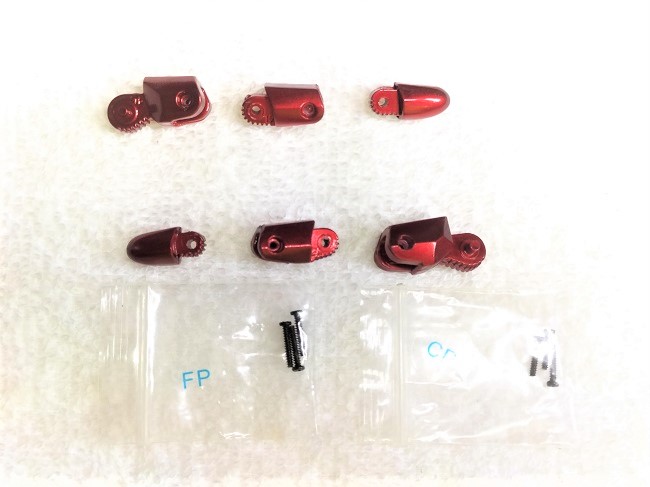

This issue builds up the Middle and Ring Finger of the Left Hand, parts of which are shown in Pic 1.
The Middle Finger parts are all marked with 3L and the Ring Finger parts with 4L.

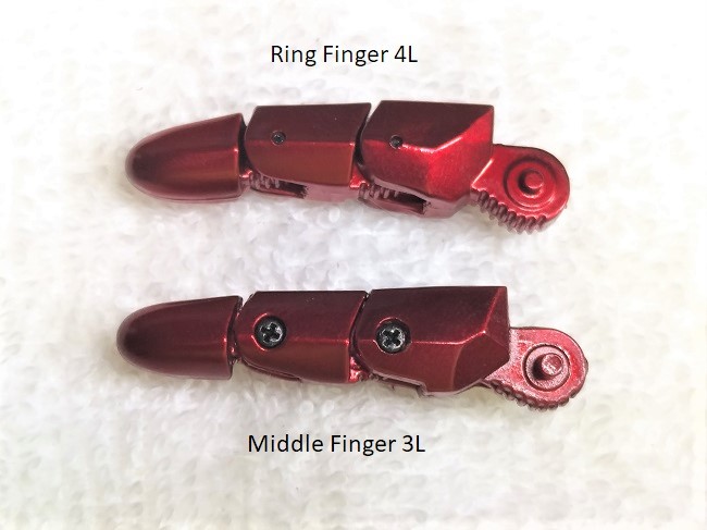

As for the previous Thumb and Index Finger constructions, I have posted one pic for each to show the completed construction with notation of the screws used.

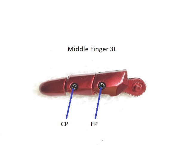

Pic 2: Middle Finger construction.
Pic 3: Ring Finger construction.
Pic 4: The completed stage components.
