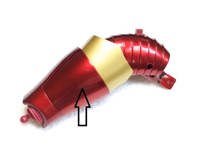

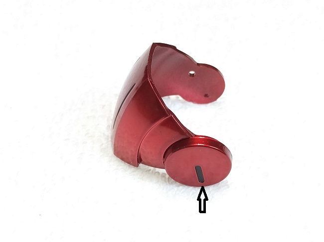

Issue 19 will complete the left forearm and the elbow joint. The parts of which are shown in Pic 1.

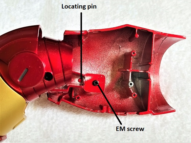

The forearm is completed by the addition of the left forearm cover (an easy press fit), just make sure that the part is in line with the forearm or you may break the locating pins. Pic 2.

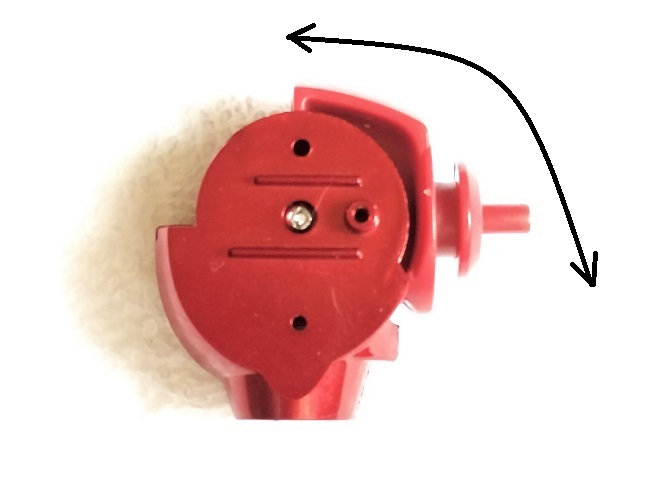

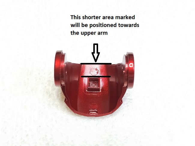

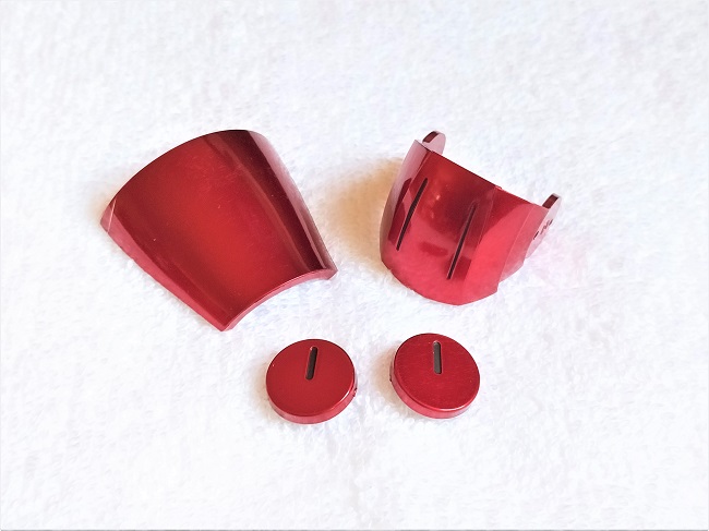

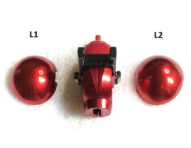

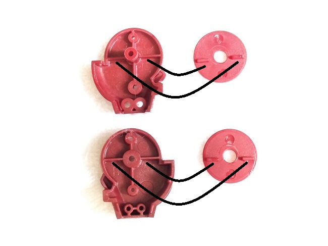

The elbow cover consists of three parts, two discs and the curved plate. The discs (L1 and L2) can only fit in one orientation as the locating pins are different sizes, so fit them as shown in Pics 3 and 4.

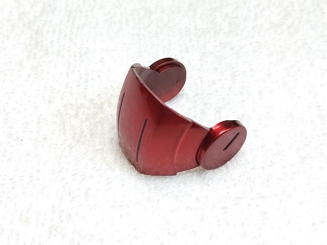

The elbow cover must now be fixed to the elbow (push fit) and must be placed as per the orientation shown in Pic 5.
Having affixed the elbow plate, the completion of this issue is shown in Pic 6.

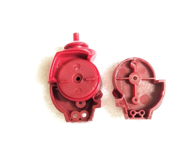

I`ll start as usual with the supplied parts for this issue shown in Pic 1.

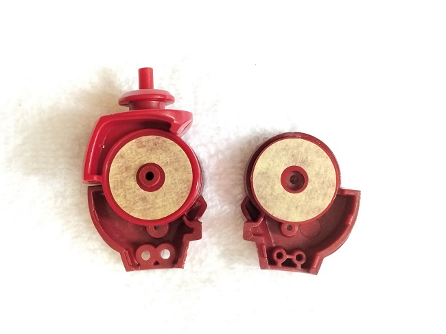

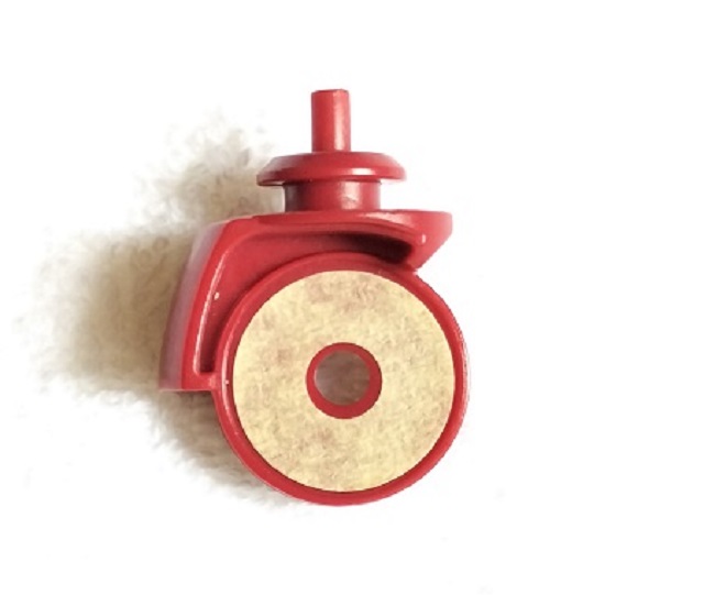

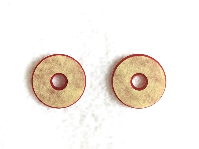

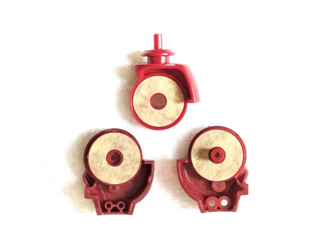

As before a friction disc is applied to either side of the Shoulder Joint as seen in Pics 2 and 3. Then a friction disc is applied to both flat sides of the Shoulder Washers. Pic 4

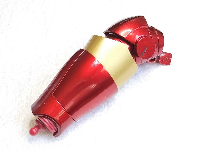

Assemble the parts of the Shoulder, following Pic 5 to Pic 9 (making sure that the Joint Washer orientation is as per Pic 5).

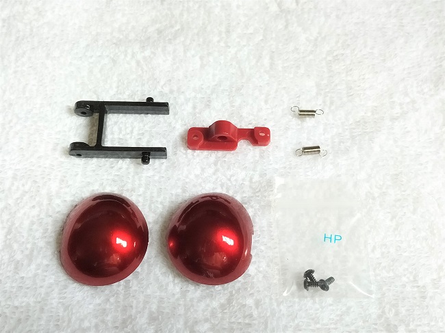

Here we are with Issue 21.Cool
As per the usual, parts supplied are shown in Pic 1.
In this issue we will complete the Left Shoulder Joint, that will be installed with the Upper Arm in Issue 22.

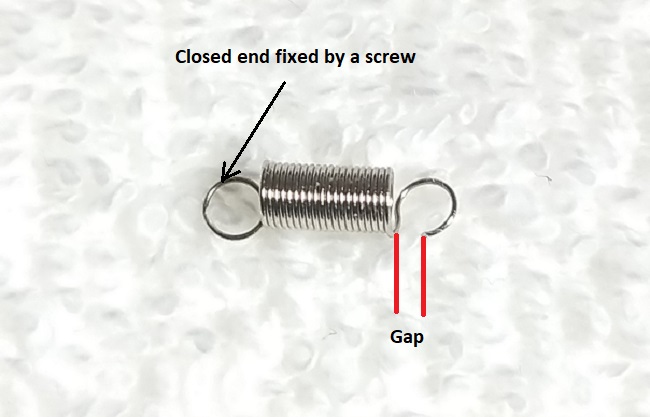

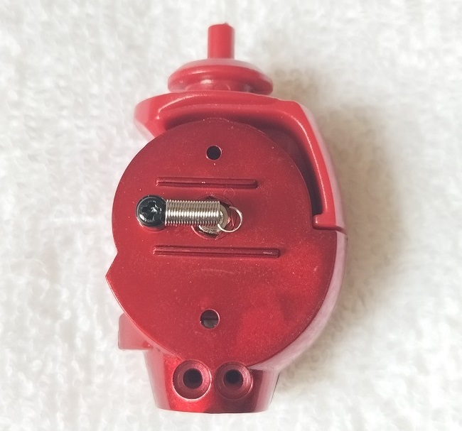

As with the Right Arm, check out the orientation and shape of the springs supplied with this issue. Pic 2.

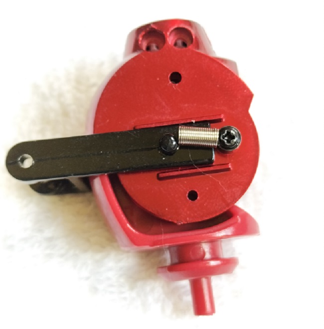

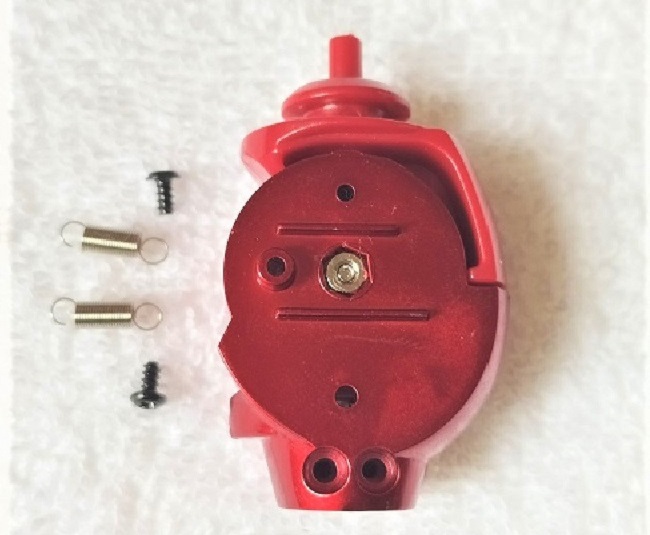

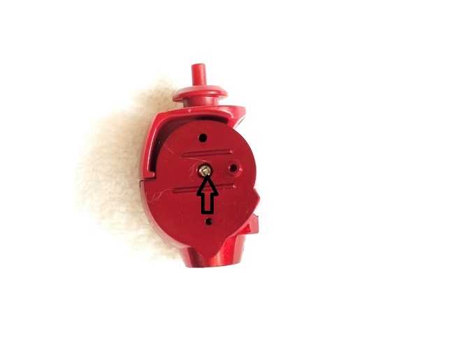

Bring the Shoulder Joint (from previous issue) to your work place, along with the two springs and two HP screws supplied with this stage. Pic 3.

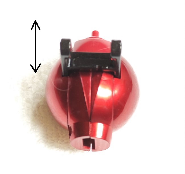

Now fix a spring, using an HP screw to each side of the Shoulder Joint. Pic 4.

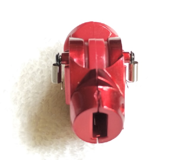

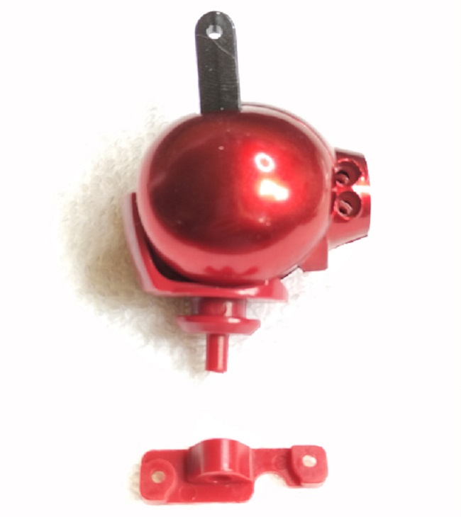

With both springs connected, you Shoulder Joint should be the same as that shown in Pic 5.

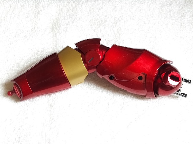

Now fit the frame to the Shoulder Joint, making sure that the orientation is as per that shown in Pic 6.
Connect the open ends of the springs to each side of the frame as shown in Pic 7.
Position the Shoulder Joint and Shoulder Covers as shown in Pic 8 and then push both covers in place as shown in Pic 9.
The final thing to check, is that the frame can be moved away from the shoulder and will return under the spring tension to its normal position. Pic 10.

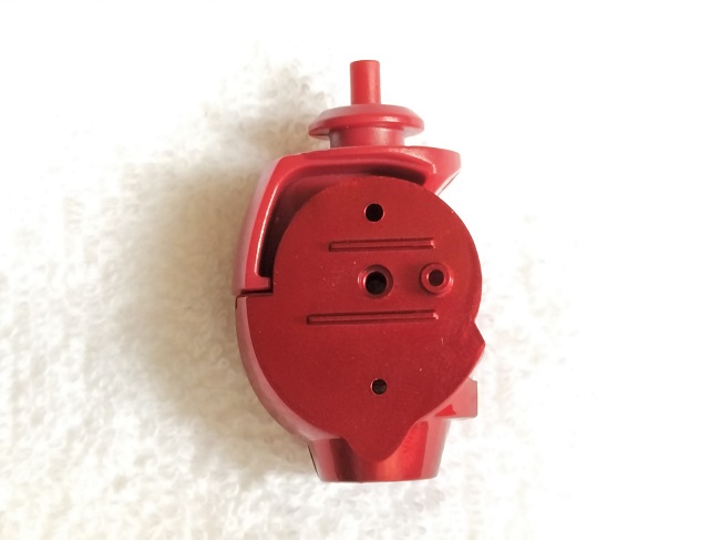

In this issue we will build most of the Upper Left Arm and connect the Shoulder Joint.

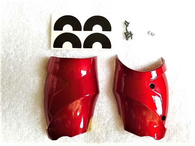

The parts supplied are shown in Pic 1. Please note: you can use the protective stickers from the earlier issue and keep the four from this issue as spares, so they are all on one piece of backing paper.

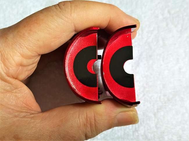

Which ever stickers you choose to use, fit one to each half of the Upper Arm as shown in Pic 2.
Now bring the Lower Arm/Elbow Joint from the previous stage back to your work space. Position the end of the Elbow Joint into the Outer Arm Cover supplied with this stage and when correctly located secure them together using an EM screw. Pic 3.

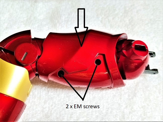

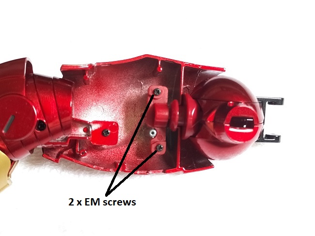

Bring the Shoulder Joint and Securing Plate back to the work space now and fix them in place with two EM screws as shown in Pic 4.
Lastly put the Inner Arm Cover in place and secure that with two EM screws. Pic 5.
Pic 6, shows how the Left Arm should look at this time. BigGrin
