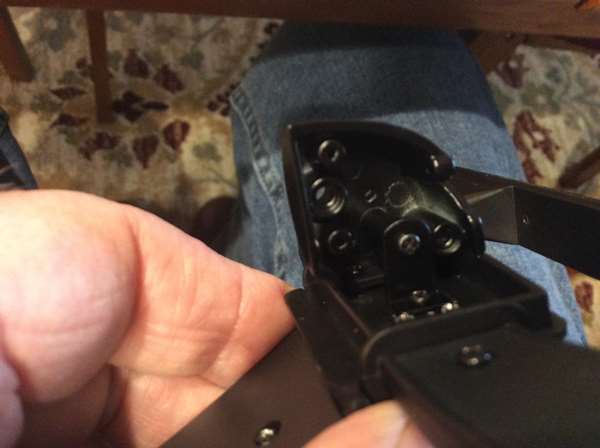

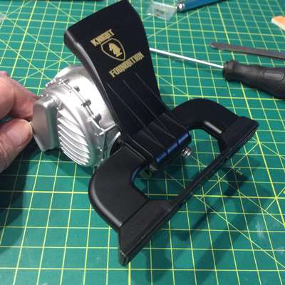

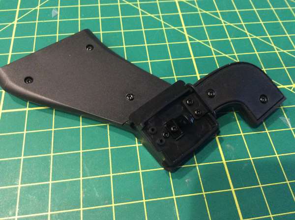

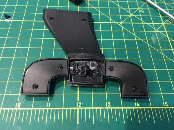

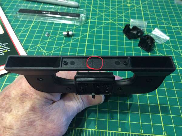

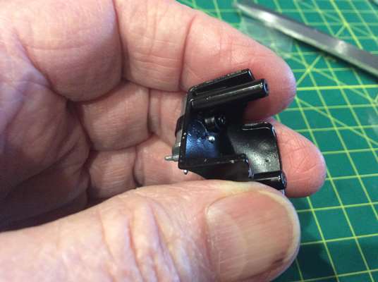

Pack 6 goes very quickly, so I don’t really have a lot to say about it!
Box 6 Issue 23 Turbine bottom
Mount the bottom, 23C to the bottom turbine housing. Secure the turbine back to the turbine as shown. Mount the Bottom of the turbine housing to the previously completed turbine parts. When the bottom is in place , the gaps on the top of the turbine should close up.
Issue 24 Start assembly of the Turbine air intake
Put the air intake together as shown.
Issue 25 Right intake assembly
Put the right intake together. Attach the intake to the intake base. Secure the mounting post, 25D to the intake base. This assembly will attach to the air duct.
Issue 26 Turbine air intake completion
Assemble the left air intake the same as the right. Attach the intake to the intake base completed in the last issue. Attach the front intake filter frame to the two air intakes. There is an up and down arrow for correct attachment. Attach the air filter to the frame. The screws are very small. Don’t overtighten. Fit the air intake cover 26F to the intake base. Build up the intake cover 26E with the air intake motor. Secure the entire assembly to the turbine as shown. Attach the left intake cover with the motor attached to the right half intake cover, 26F. At this point, the completed air intake should be secure to the turbine motor. Box 6 is complete. Box 7 will continue assembly of the turbine. The turbine will also mount to the front clip.
