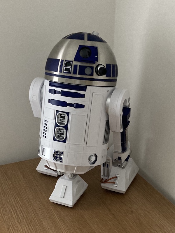

And R2 is finished! Batteries should be arriving in the next day or so, but reading issue 100 I suddenly realised that even though I initially charge the batteries separately, I can't turn on R2 unless I use the charger to activate the protection circuitry. And of course, they missed out the charger when they sent me pack 100.
Does anyone have an amazon link or something to a suitable replacement charger?
Also, I noticed that the sticker describing what the chest buttons do was in Italian. The box with the main circuit board in was also covered in Italian warnings, sot his has me a little worried - will this mean the audio accompanying the holograms will be in Italian? I remember reading on here that the audio was country-specific.

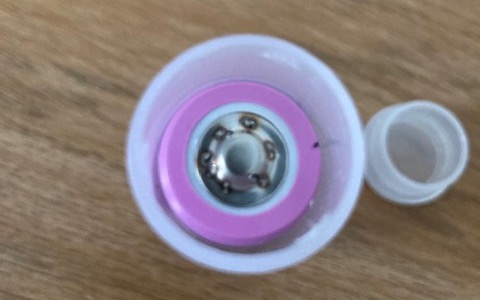

Thanks for the transformer specifications, S4Simon, but I'll be blowed if I can find a suitable match. Most transformers that go to 15V are 45W, with an output current of 3A, and I'm not sure if that just means R2-D2 will charge faster, or if it will risk burning out the electronics. Also, the 5.5mm/3mm jack size really seems to be a non-standard size. I've pinged CS again, and will see what they say.
On another issue, I got my batteries, but they all have these strange burn marks on the button top (see photo). Is this just part of the manufacturing process?

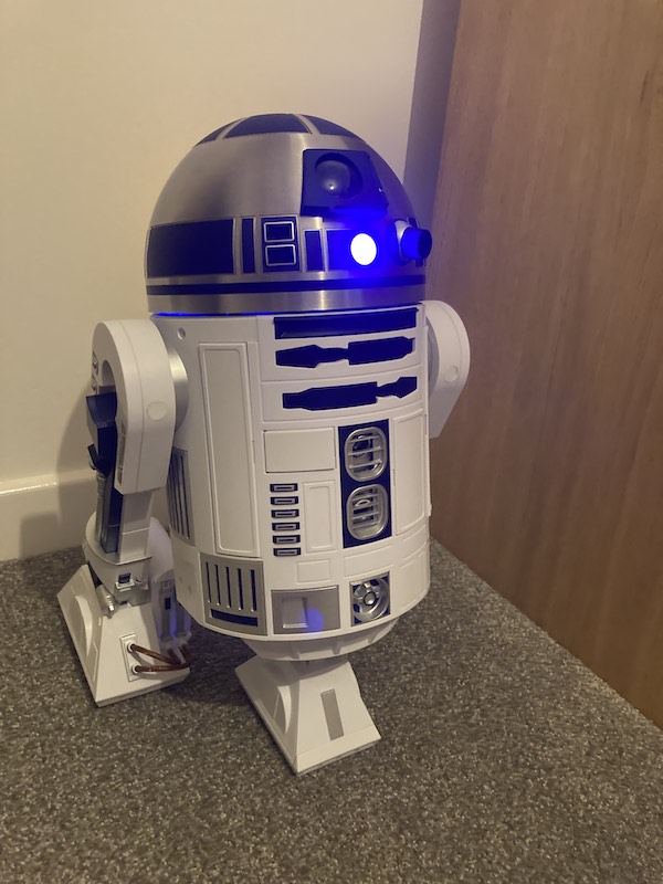

We've got a heartbeat! Or... we did. Briefly.
I decided to install the batteries, even though I thought one might be a little dodgy, and R2 started up perfectly. The arms work, the speaker works, the lightsaber popped up, it was great. I was laughing like a maniac.
The patrol mode movement was a little jerky, I assumed that there were too many obstacles confusing his sensors, but after I cleared some space to try again the right leg motor started making a horrific grinding noise, followed by a slight cracking sound. And with that, R2 is dead and won't boot up any more.
So, any advice on what went wrong and where I go from here?
Is carpet a major no-no for running R2-D2? It didn't seem to be affecting the left leg, but could it have caused the wheel to jam such that the turning motor has cracked the internal gears?
I really don't want to have to strip R2 to the metal framework, iIs it possible to dismantle the right foot without detaching the right leg from the body?
NathanR attached the following image(s):
#15 Posted : 07 November 2022 12:24:45
Hi Nathan
Carpets are not good for R2’s operation, it makes it jerk and possibly topple over. You could take the bottom panel off the leg to see what is going on, but the removal of any insides would mean the leg has to be detached as most of the assembly screws are on the side that is closest to the main body.
