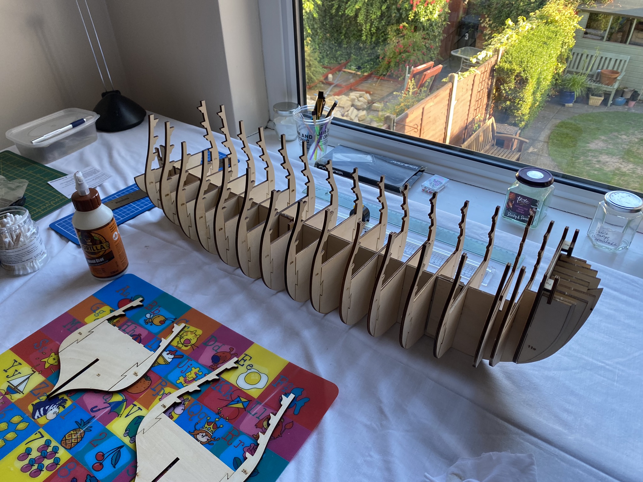

well here we go. I have a couple of days on my hands, and curiosity got the better of me, and I checked out the first five issues of this big build.
Reading carefully the building instructions I thought I would make a start. The first thing that struck me was that apart from the laser cut hull and keel sections, there were smaller packs with cannon cannons, and the ships cutter available to build.
I would assume that this was to keep up the interest of modellers who were getting the part work on a weekly or monthly issue.
As I have bought the whole kit in one go off eBay I have everything to hand, so I have set aside the “side” builds until later. I am waiting for some tools and paints to arrive, notwithstanding postal strikesCursing .
So I have made a start on the framework of the hull. I’ve gone off piste alreadyOhMyGod
The bow framework, I fitted the formers flat on my bench, because laying it flat I found I could exert much more pressure. Some pieces are a much tighter fit (a good thing?) than others and to press them home takes a fair bit of pressure. A loose fit isn’t good, I thought, but the glue I’m using, Gorilla wood glue seems good, odour free, and overspills clean up easily.
I have also fixed the keels three sections together flat, with a weight on top, and it seems to nice and level. And I have assembled it all, without glue, of course.

BigGrin Hi, and welcome. All looks good so far from what i can see. You will need to check Rib 15, as they notoriously fell short of the bottom edge of the false keel. It's nothing to worry about (aparently), and would just need building up to the correct size, or use filler blocks. Apart from that, everything else in Pack 1 (stages 1-10) should be plain sailing LOL

With respect to your build so far, an important thing to remember at this stage is this: The better your accuracy at this stage the better the end result will be and will minimise the chances of any major issues. For example, at this stage make sure all the ribs are fully seated in their slots and that they are set square to the false keel.

I noted the infamous rib 15 issue, and sure enough, because my kit is of 2010 vintage, it does fall short of the false keel by about one eighth of an inch. An issue I hope to resolve.
As I have a few days available for making a start on my build, I have set aside the cannon, carronade, and ships boats for now, and have continued with the hull build. I have mostly followed the instructions, and have not glued the ribs in place, etc.
I have reached a problem within part 15, with part 32x8, 33x2 and 34x2.
The instructions on page 15 are vague to non existent on where exactly they go. Transom and gallery supports, they are called. Are they to be fitted in place now, or later. If later, why are they supplied now?
Trawling through videos on utube to try to find an answer.
Or am I even dimmer than I thought. Thanks in anticipation

Those parts are not fitted till Stage 18, so just store them away safe for now.

Looking at my unglued assembly so far, the three section keel seems to be slightly warped in the bow end section, so I have dismantled the ribs and laid them on a flat surface and weighed them all down with books to see if I come back to a truer keel. I think the warp might be down to the fact that this particular kit was manufactured in 2010, and has been gathering dust ever since.
The veer to the left is slight, I hope I’m not being over fussy.
Thanks to you all for your tips and hints so far.

Doesn't look apparent from your first photo, but better to sort it now than regret not doing it later. Soak in water, weigh it down flat and leave to thoroughly dry.

Great to see another Victory build starting up and your first pic shows everything looking good. I would not consider doing this size of build without the use of a build jig. A build jig goes a long way to help ensure your keel remains straight and true, a critical element of successful builds. More info on build jigs can be found here:
