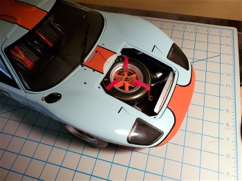

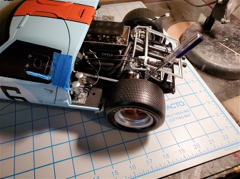

Now it gets good........... Remember I kept on saying I CANNOT STRESS ENOUGH TO LEAVE THE REAR WHEELS OFF THE ENGINE AND TRANSMISSION. IF YOU WORK WITH THE WHEELS ON, YOU WILL HAVE DAMAGED PARTS!!!!!!!!! Now we get to put on these rear wheels. The mounting stem is on a floating axel for each wheel. You will need to take a small screwdriver and line up the diffenteral part of the axel. This will make the threading closer so you can mount the rear wheel (see the picture in this build section).
Let us get back to the remaining parts of the build

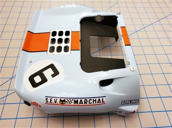

When you get to sate 102. I will ask that you take the chrome bonnet/hood(tire cover) lock pieces and put them in a small jar. You should have 6 total (4 for the hood and 2 for the bonnet - these are smaller in length). Also do not install the hood (tire cover ) yet, as refered to in stages 102-4 & 102-5.
Attach the bonnet. It is a simple line and pressure fit. The next stages are for the rear engine boot. Just install all the stages as shown 103 thru 108 FOR THE MEANTIME SKIP STAGE 108-7 AND 108-8 YOU WILL DO THIS AT THE END, then finish with stages 109 trough 110.
THE MAIN CAR IS BUILT. I WILL POST PICTURES OF THE COMPLETE BUILD IN ANOTHER FILE AFTER THIS.
Remember the rear windshield and the bonnet/hood tire lock pieces. Just add them in and you are done.
