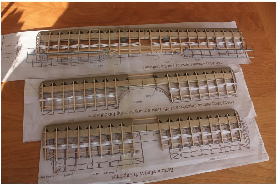

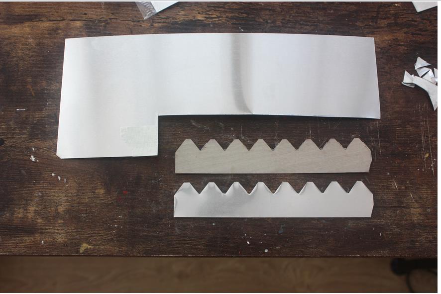

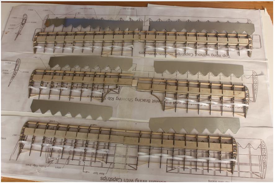

Not had much success with the leading edges provided for this kit. I have soaked and bent to shape but cannot seem to get the correct shape. Don't want to apply too much pressure as they are only .4mm ply. So change of plan, I have purchased some .4mm aluminium sheets (Thank you Cornwall Models) and using the provided cutouts as templates have cutout replacements. Hopefully I will have more success with these.

You know Gil it did cross my mind whether it might be easier to use thin aluminium sheet, but wondered whether it might not be better to use the thin ply in order to retain that 'natural wood' look, but I suppose you could always fit the more pliable and easier to work with metal sheet and then just paint it to look like wood - problem solved?!

Been watching this coming along and very impressed!Cool With regards to the leading edge problem, I just had a thought too. When I built my very first wooden ship, the Constructo "Grimsby" (Supposed to be an 'English Frigate' but with only 12 guns more of a Gun Brig really) I had some problems with bending the planking which was a single layer of 2mm quite hard wood (sapele?) Following advice in a 'how to' book I soaked the planks for a few hours in household ammonia - evil smelly stuff, even with no sense of smellCrying but it did the trick well! I was wondering if, instead of the plywood you could use thin wood veneer as I did on the upper cockpit area on my card model Sopwith Pup but instead of trying to bend it after soaking, over the actual wings, sand a strip of solid wood to the same curve as the leading edge then bend the veneer around that holding it in place with rubber bands or similar. Let the ammonia evaporate (preferably out in the shed or garage!) When dry the veneer would stay in the required shape ready for gluing in place.
Modern books on planking don't usually mention ammonia anymore for obvious reasons but it does really soften wood! Probably not plywood though as Kev said too much softening could de-laminate the stuff hence trying veneer instead.

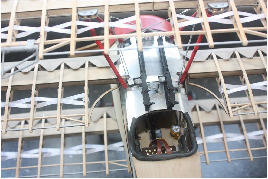

Time for an update on this “challenging” build. Could not get on with the leading edges provided for the top wing so went down the aluminium route. Happy with the result so far, will need to tidy up the paint.

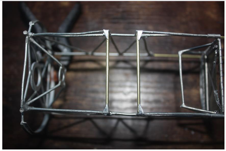

This is one fragile kit, Have made some mods. I have added additional support to the wings by inserting a dowel rod through the foremost hole in the ribs. This also helps with the alignment. The timber provided for the cap strips was too fragile and snapped when I tried to glue them in position. Have replaced with slightly thicker wood strips. Rib twist/leading edge bracing, insufficient length provided, have been able to match.
The Ailerons for the top wing have been attached with some brackets I made from some aluminium strips. Did not like the tape provided with the kit

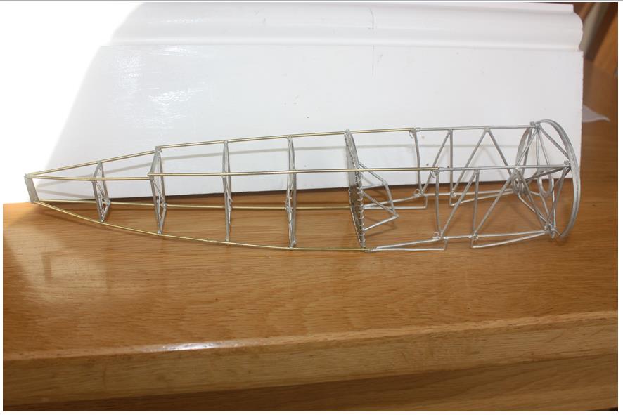

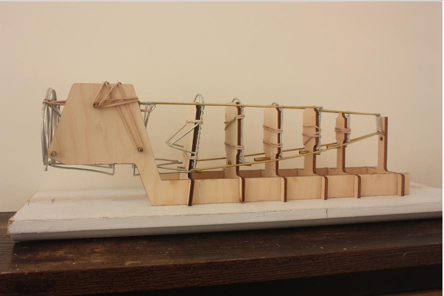

Have started on the fuselage. Will continue once I can get my head around the vague instructions

#25 Posted : 06 December 2021 21:40:30
Great work.The fuselage is incredibly frustrating to get everything lined up properly because the metal is so soft.I ended up using epoxy on all the joints. you are making a superb job of it as always.

I am looking forward to it staying together! I was hoping that superglue would do the trick and whilst it does seem to be ok on some joints I think I shall have to do the same as Carl and use epoxy.
I am disappointed at the quality of some of the fittings, the "metal" is very soft and bends easily, and some fittings do not seem to be complete

Have added additional supports to the airframe to avoid the joints parting
Hope this works

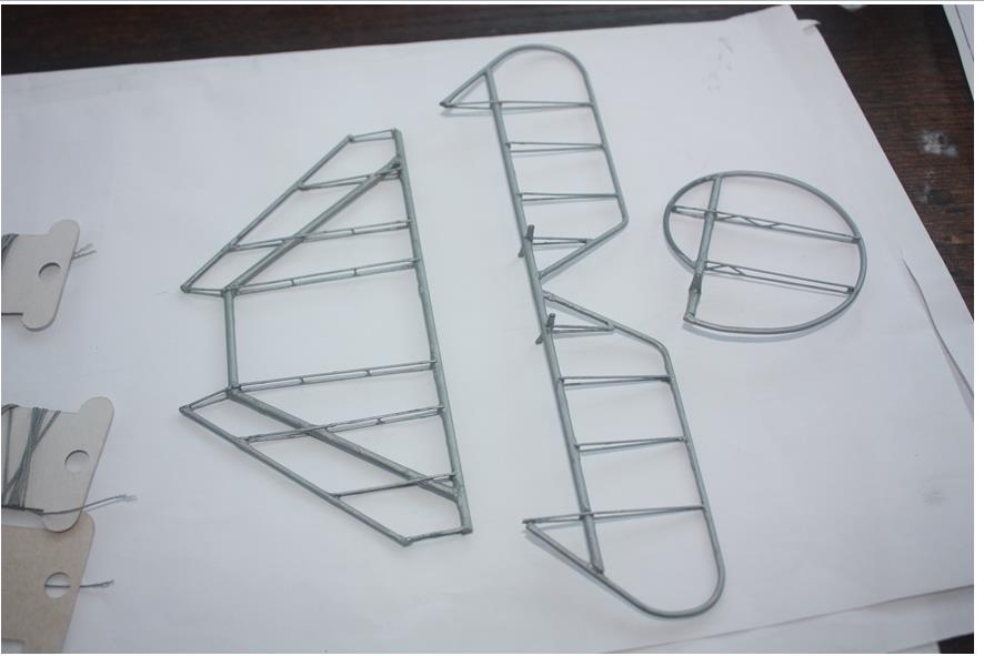

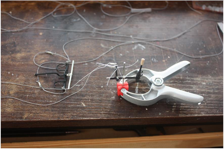

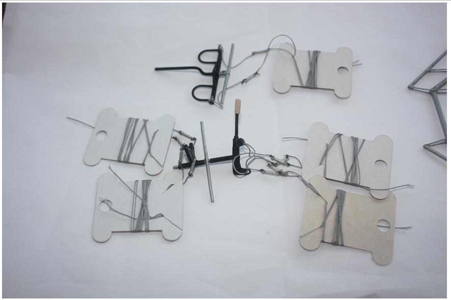

Have assembled the Rudder Tail and elevator. Does not help when you drop a part assembled piece and have to start again (oops) There are 32 separate components to these parts. Its a process of glue a bit and wait, then add more parts
The Aileron/Elevator control is ready to be installed in the airframe (once I get my mind around the instructions)
Pictures attached

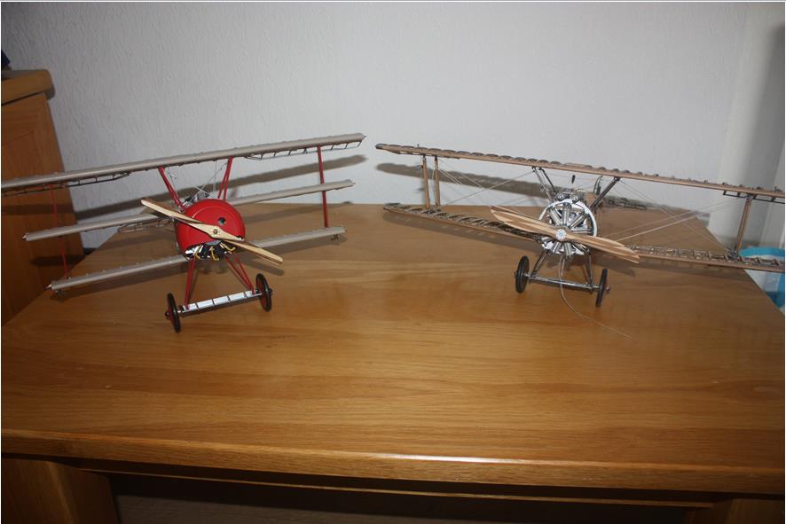

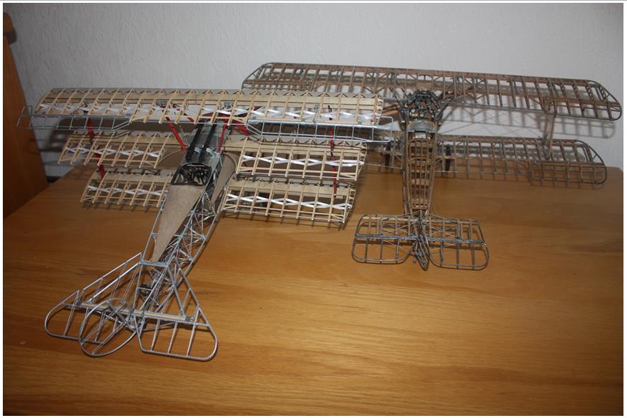

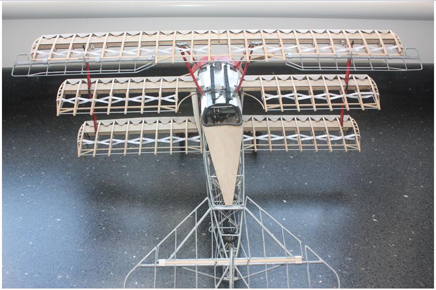

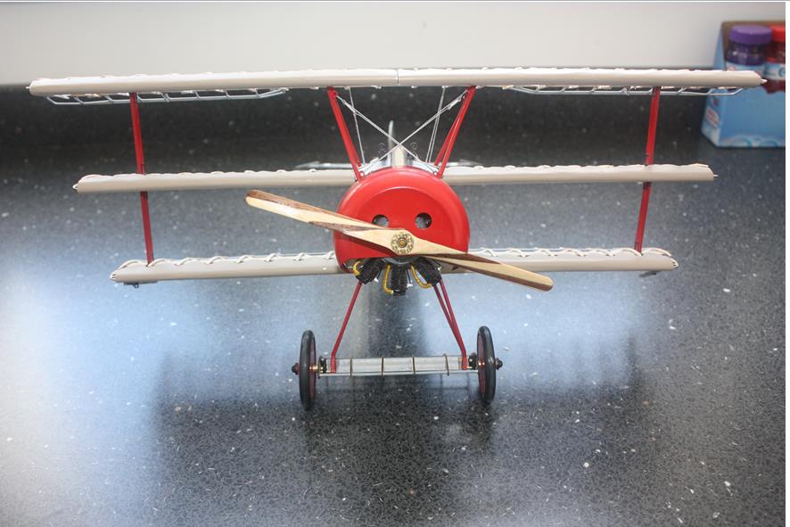

Well I have finally finished this build. Not the most enjoyable build, in fact it is lucky to have survived the bin. Determination and stubbornness replaced my enthusiasm.
Why you may ask? Where to begin? The metal frame and some of the components are made of a very pliable metal. The Airframe in particular is very fragile. Any subsequent “heavy handedness” has resulted in a bent airframe. Most of the components arrived in one bag, there was a list of supplied component and although some of them are obvious the list does not show what any component looks like. My first task was to separate as best I could the components into relevant groupings. Some components seemed incomplete but still usable. The Build instructions consist of an instruction manual together with 5 large technical drawings (1-1 scale) and these are referred to in the build manual. It is the only way you can identify some of the relevant components. I would have liked the manual to have more pictures on the stage under constructing and how it should look when complete and fewer words. As they say a picture speaks a thousand words
Pictures attached.
The finished model will be displayed next to the Sopwith Camel I built some time ago
