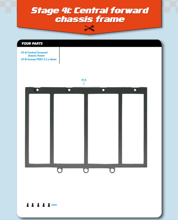

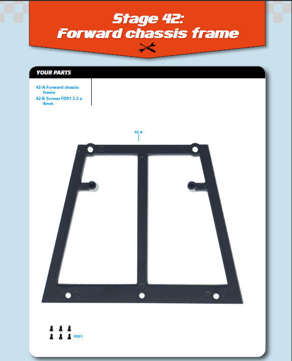

PACK 41 and 42:
These two sets of parts will complete the metal main chassis. They are assembled as per the instructions.

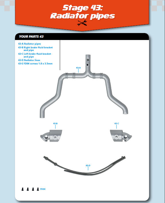

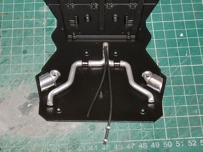

PACK 43:
The parts here are for the front radiator pipes and air inlet scoops.
The radiator pipes should have the edge seams sanded off and then repainted silver. The hose sections can be painted in black.
NOTE: The instructions show the two air scoops incorrectly labelled brake fluid brackets.
They are also shown mounted each on the wrong side.
If they are fitted this way, the front firewall parts cannot be fitted.

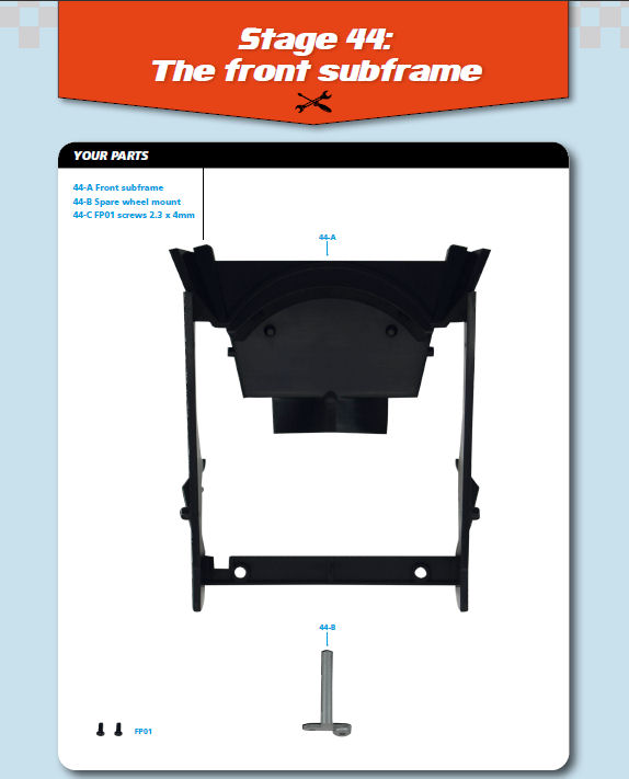

PACK 44:
The front subframe/firewalls.
These parts should be painted satin black to lose the 'plastic' look.
In this build, the front are was completely altered from the kit, to replicate the actual car being modelled.
This will be detailed and shown in a future stage.

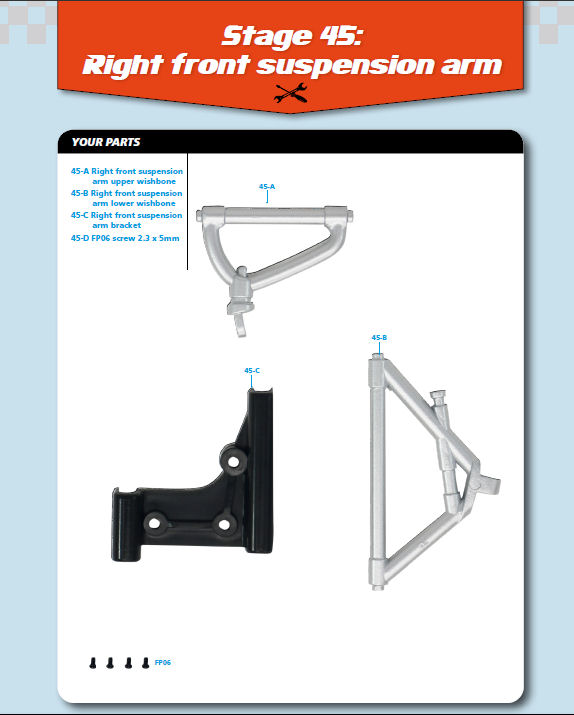

PACK 45:
Right suspension arm parts.
These parts are assembled as per the instructions but on this model they aere added at a later stage to make the front modifications easier.
