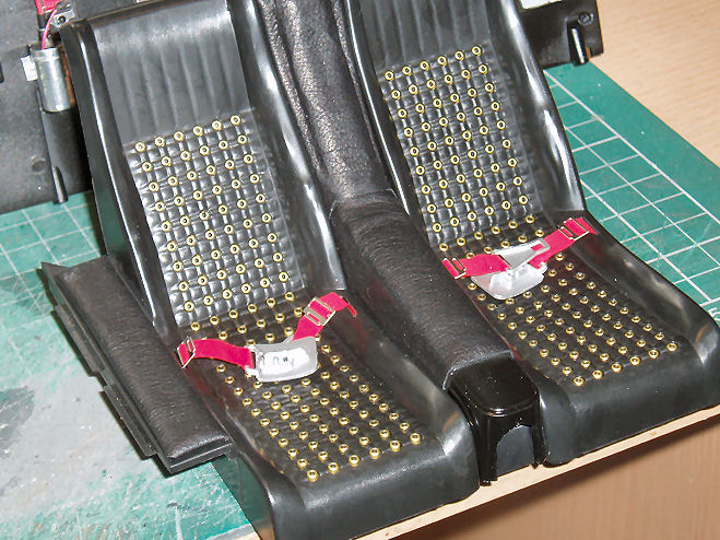

Pack 7 contains the parts for stages 22, 23, 24 & 25.
PART 22;
This set of parts will complete the safety harnesses, the engine compartment tank filler and the rear screen.
All of these parts assemble in a very straightforward way although you may wish to remove any seams from the tank parts and repaint it.

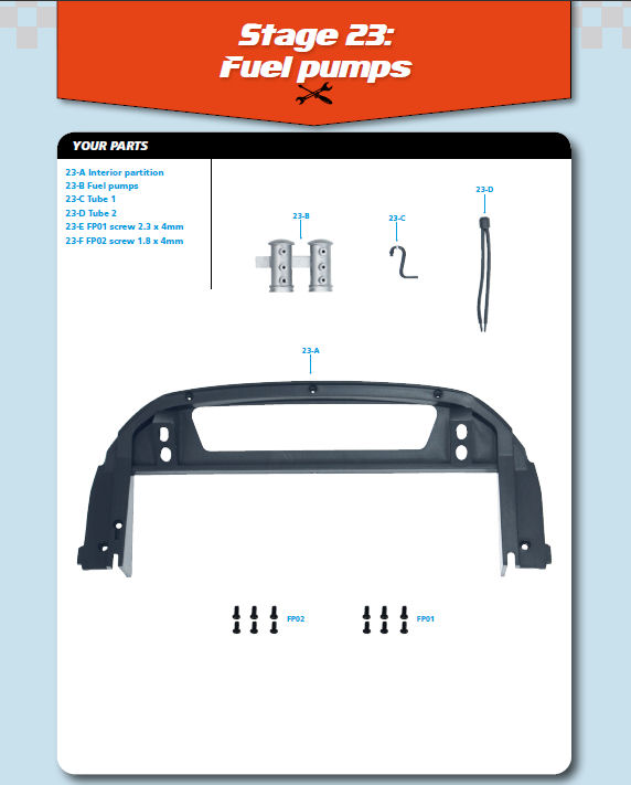

PART 23:

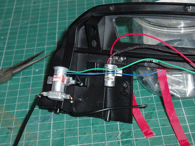

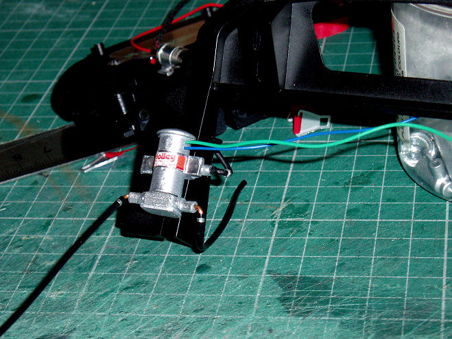

These parts are for the fuel pumps and engine bay partition wall.
The fuel pumps were not used in this build as they are significantly different to the pump in the car being modelled.
The new pump was made from scratch using plastc tube, small resin castings, small nuts and copper wire. A correct decal was printed and applied. The various wiring and fuel line connections were also modified to suit.
The rear partition wall was repainted satin black and the components assembled.

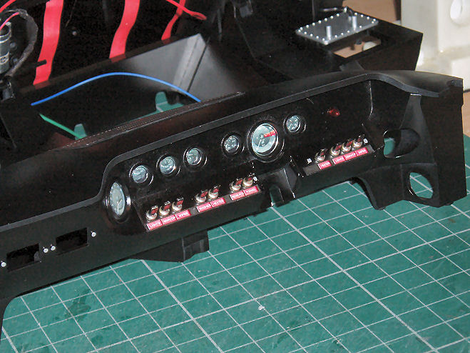

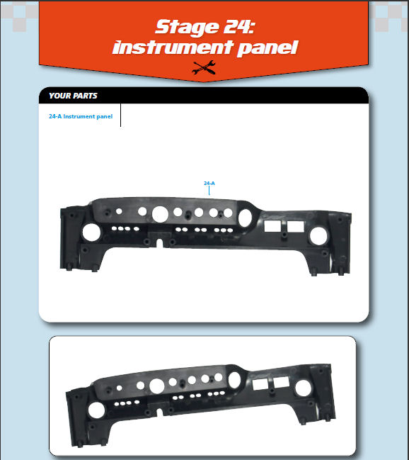

PARTS 24 & 25:

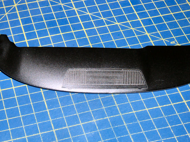

These are the parts for the dashboard and instrument panel.
The dashboard parts were repainted satin black after a correct etched vent panel was added to the upper surface. This part was not included in the kit.
The gauges were also replaced with accurate prints, being taken from photographs from the real gauges in the car.
The switches were repainted silver and black.
Switch label decals were also applied.
More detail and scratch made components will be added at a later stage.
