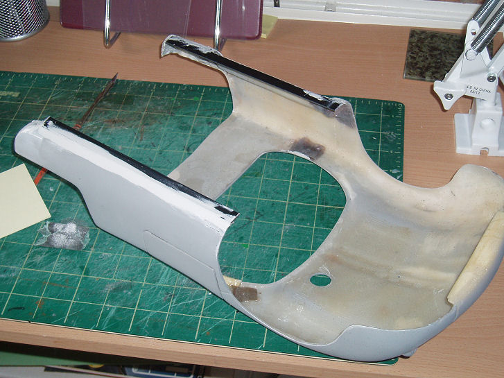

Well, it had to happen.
Another C Type Jaguar.
I make no apologies for being an utter Jaguar fanatic - especially the old ones.

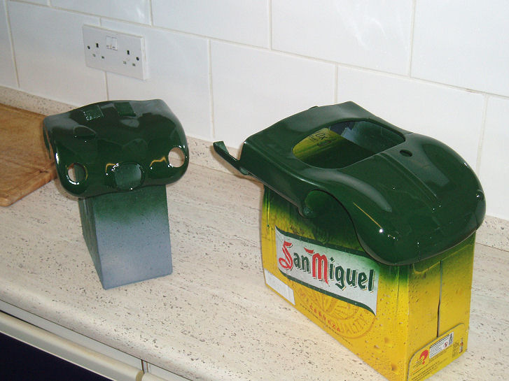

I thought some of you might be interested to see a scratch build from (almost) start to finish.
The original wood buck body has been lost to the sands of time. (It was basically 'removed' from me by someone I thought was a friend modeller many years ago)

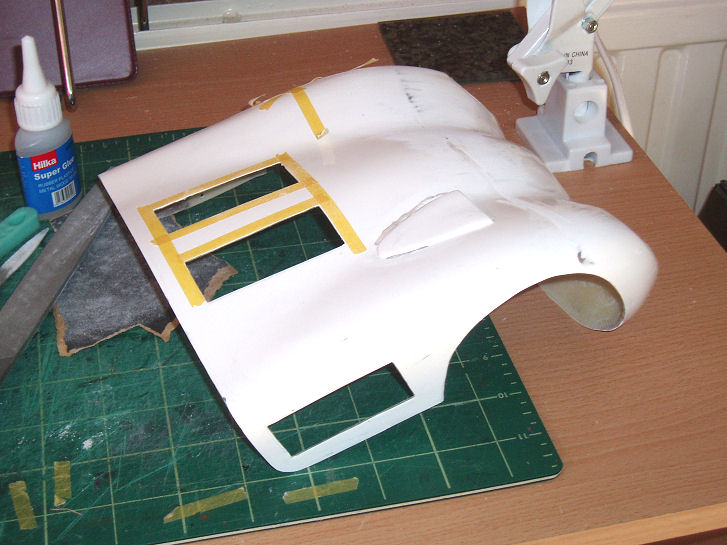

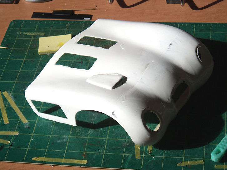

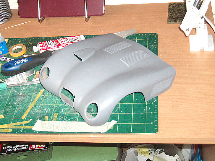

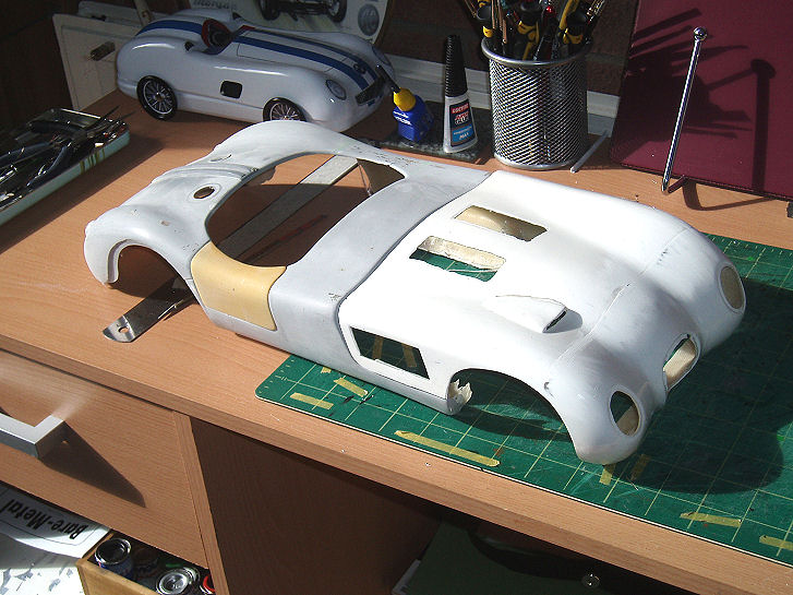

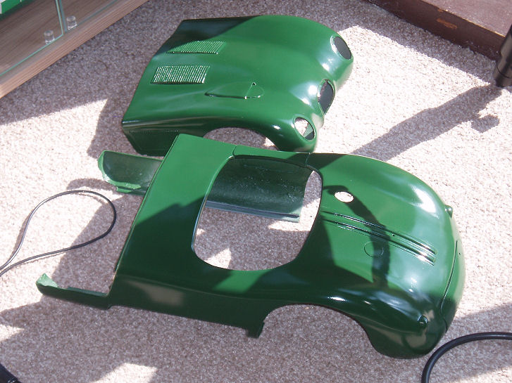

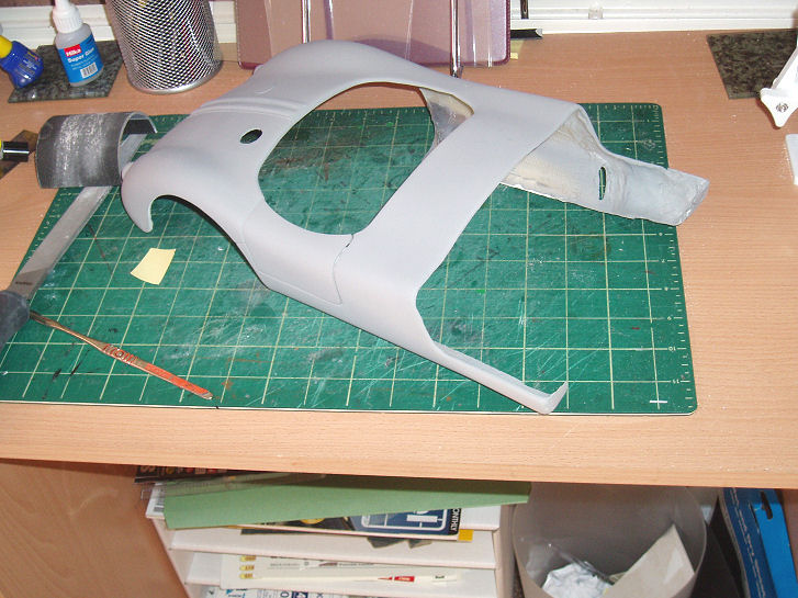

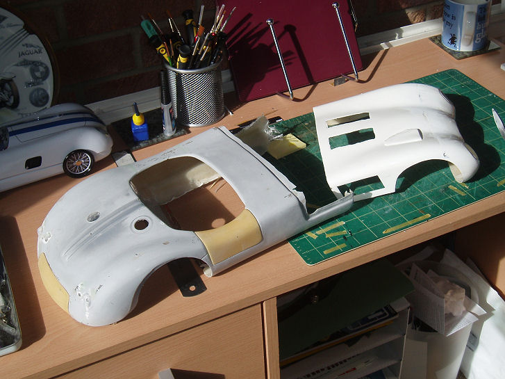

However, no matter as now, I get shells 3D printed and take a vac form from them. Much easier.
Anyway, this one was cast in fibre glass - horrible stuff I try not to get involved with these days.

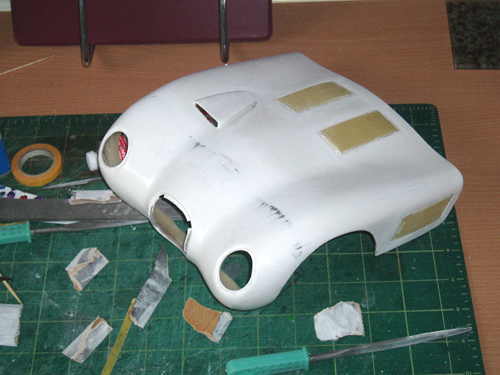

The nose section was also cast in thin fibre glass.
A lot of cleaning up of the parts was needed before eventually, some cast parts could be fitted and a primer coat added.
When building from scratch, you ALWAYS have to think miles ahead as to what will need to be fitted, and how it will be done.
Invariably, parts have to be broken down at times to allow the next stage to begin...

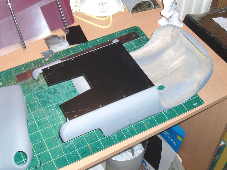

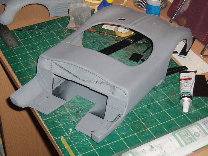

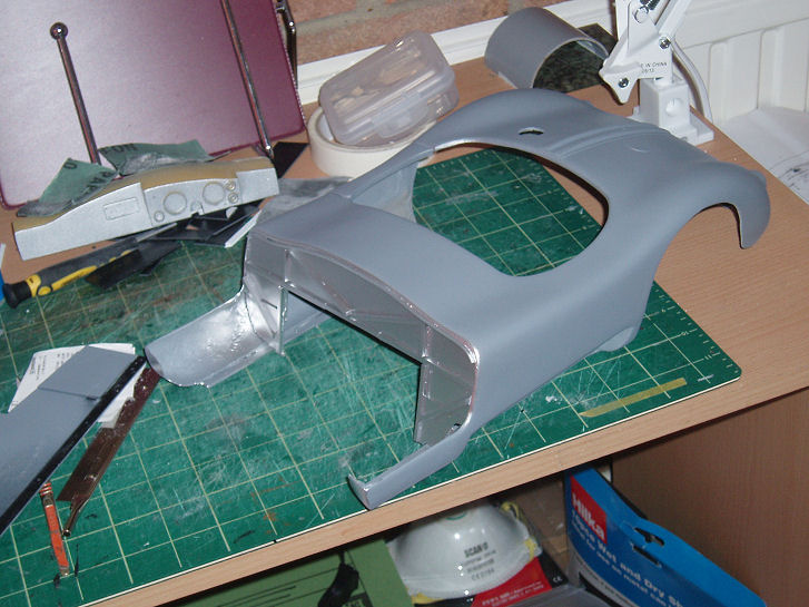

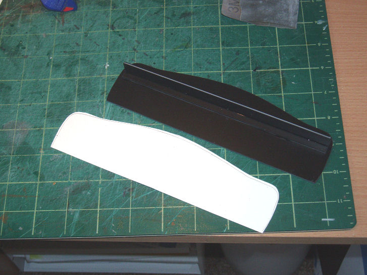

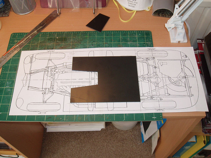

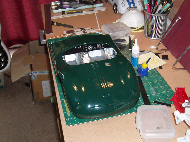

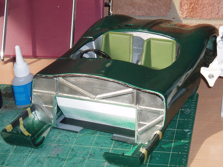

Next up was to add a floor panel - screwed in place for ease of removal at future stages.
Also, the engine firewall was made up and after a good deal of prep, the body parts were primed and then painted the correct green.

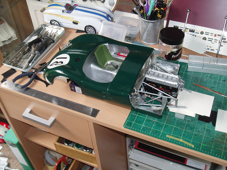

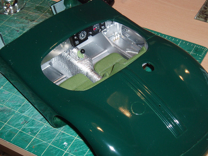

A tad more here for those looking in.

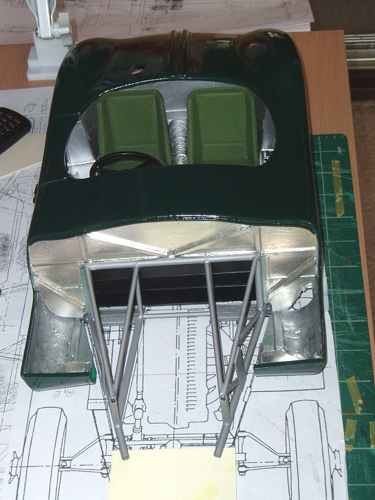

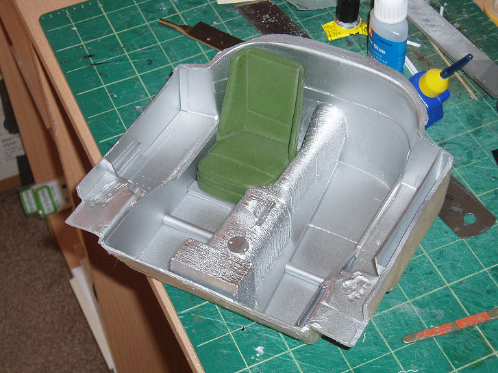

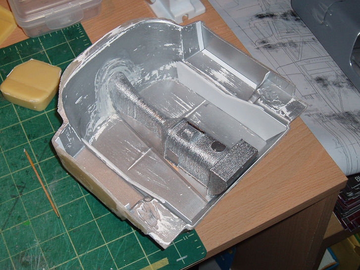

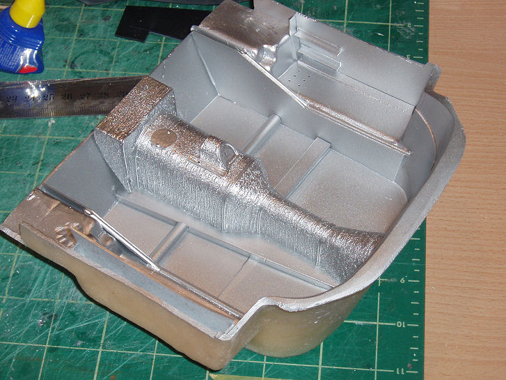

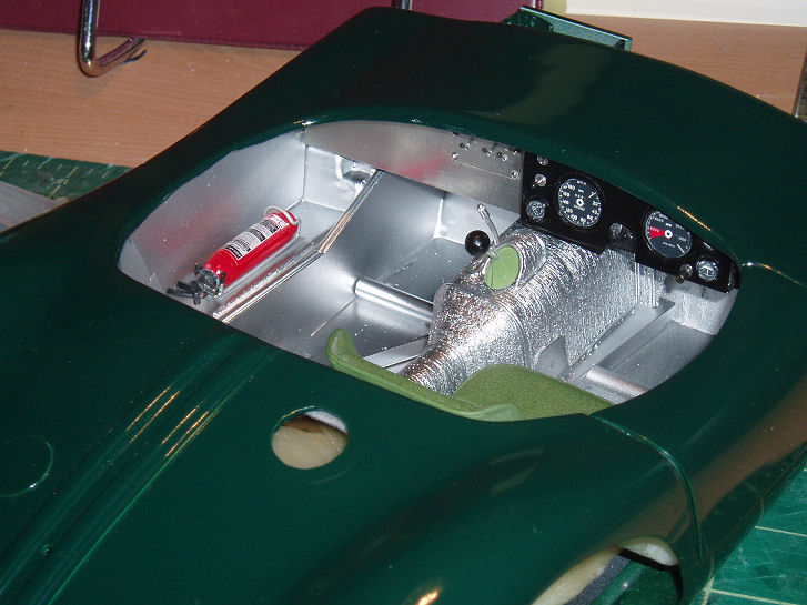

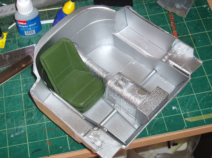

When I started scratch building around 7 - 8 years ago, I didn't keep detailed photo diaries even though I do have a good few pics of this.
The cockpit section was vac formed from a pretty rough wood/scrap/plastic/junk master, now lost to the sands of time.
The cord detail over the tunned was made using umpteen lengths of thin string glued in place. Everything was then sprayed silver and the interior tubing and associated parts then added.
The seats were made from sheet plastic, 'fimo' clay and wood, with thin wire as beading.
All then painted green. That was before I started trimming interiors with leather.

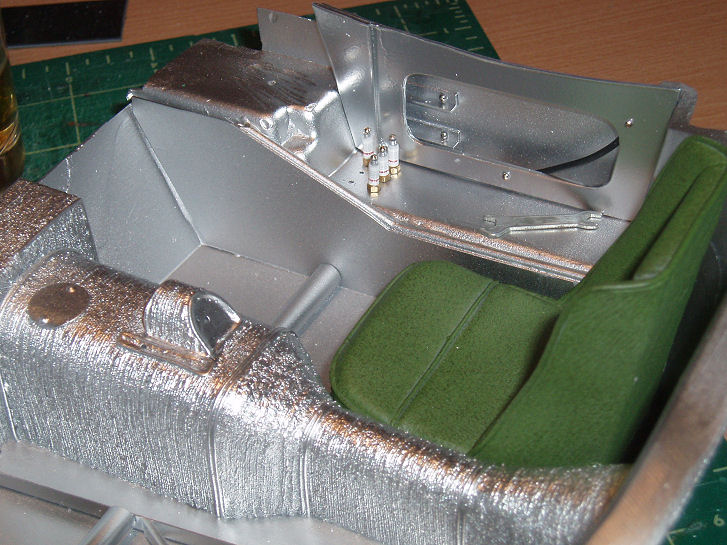

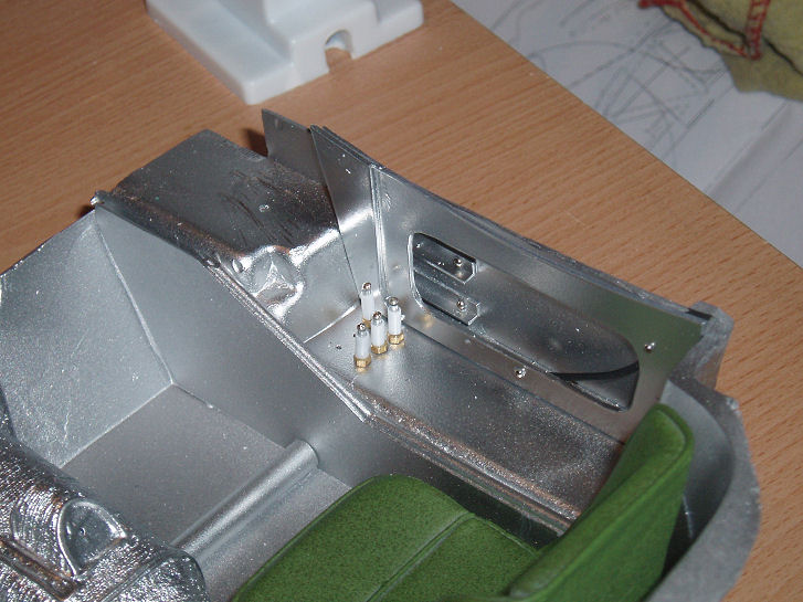

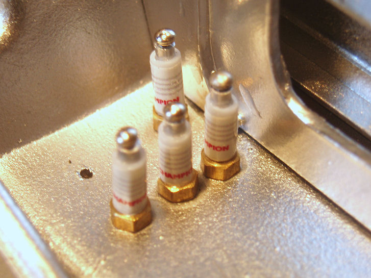

The miniscule spare spark plugs were made from plastic tube, little nuts, pins and minute decals I printed myself.
No idea where I found the little spanner...!
Gibbo

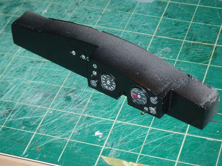

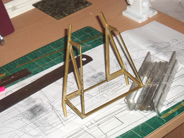

Next up was to make a lot more of the interior parts.

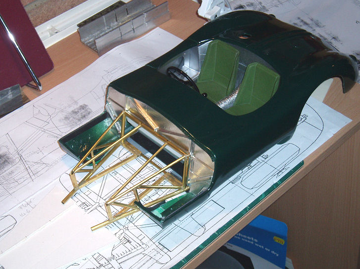

Dashboard (made from wood), passenger seat, fire extinguisher, more inner tubing etc.

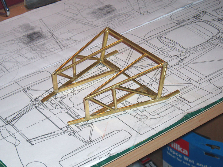

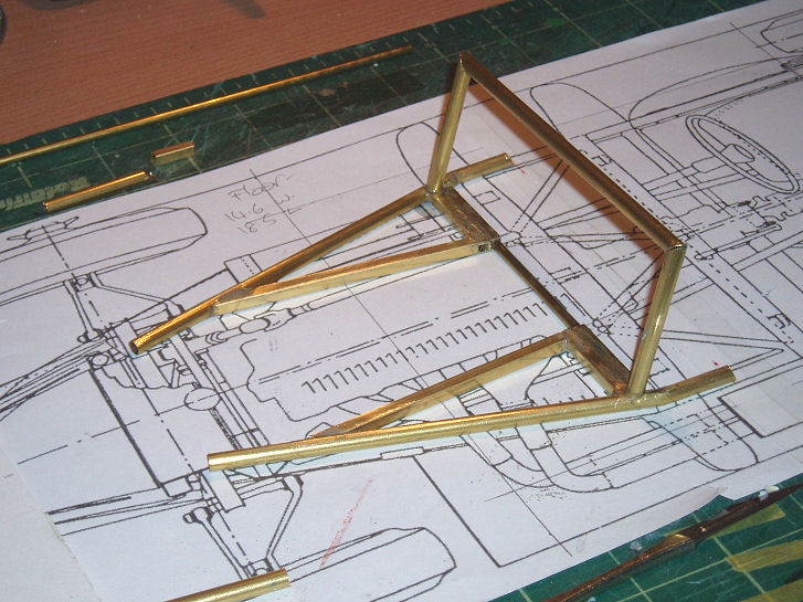

Then the difficult part - the front frames all made from brass section...
Gibbo

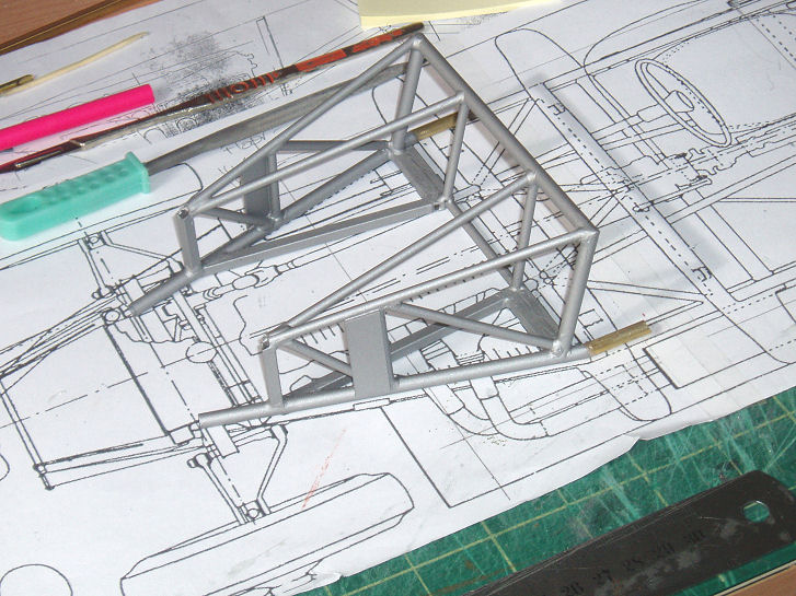

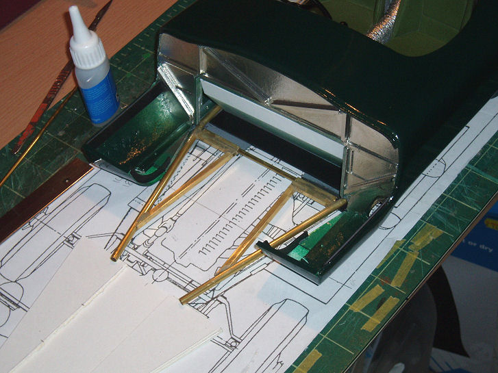

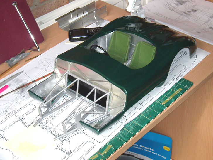

The front frames were built up using brass section and Araldited together.
I don't solder as there's no room for adjustment once it's done, whereas Araldite takes around an hour to cure firmly leaving time to move bits if required.
Once it was assembled, primer was added and then silver.
Fixed into the body with more Araldite...

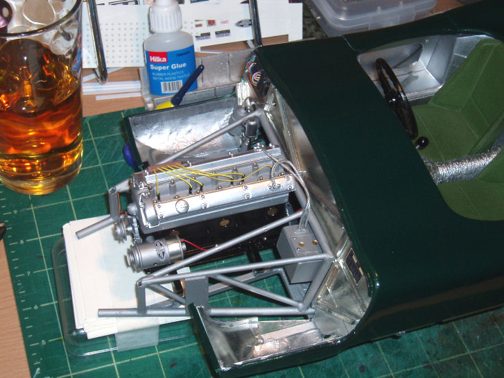

Another update on this one...

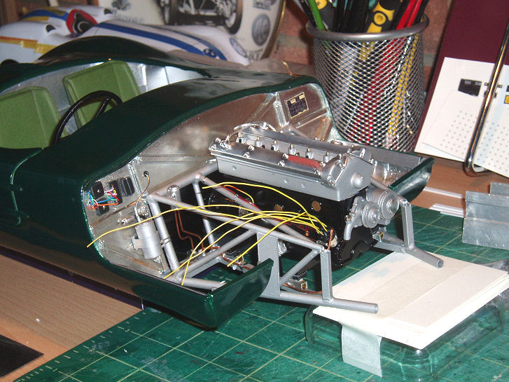

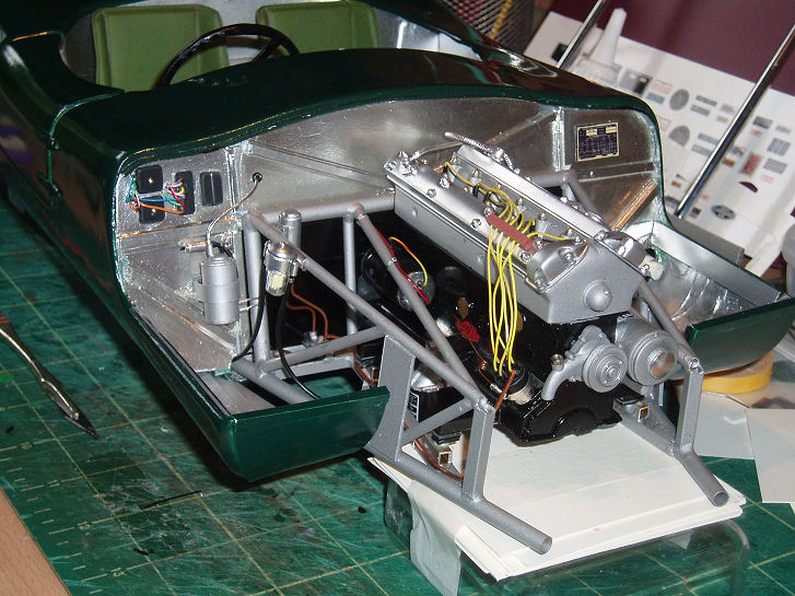

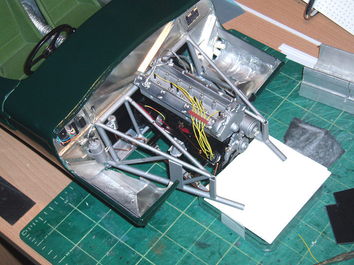

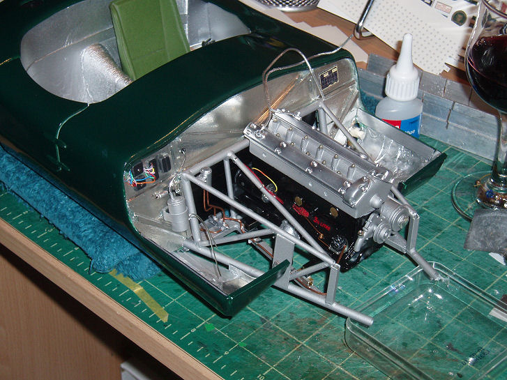

Once the front engine cradle was ready, the main engine block and parts were built up using my own resin castings.
It was test fitted and then many of the 'extra's' and details were added.
Time consuming but worthwhile.
