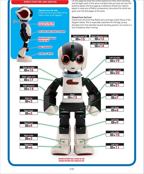

there is some information on pages 537 and 538 of the assembly manual about balancing.If that doesnt help you may need to disassemble and make sure all the servo connections are properly seated and all of the screws are tightened properly.

my guess would be that when he is walking his center of gravity is not changing as much as when he tries to sit up so he is naturally more likely to fall during standing up, especially if one or more of his servos is not moving properly. Did you go through all of the testing before final assembly? Are you sure his neutral positions all correct.There is a section in the instruction manual showing exactly how to ensure all of the limbs are in the correct position. You balance issue doesnt seem to be one that has been commonly reported and thousands of these little guys have been built.

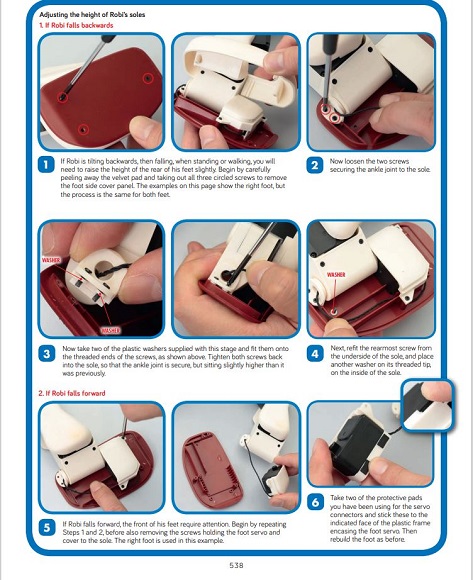

thanks to our amazing Admin Mark here are the sections on balancing Robi.Please let me know you have any questions.

I put the small black pads under the servos in the feet as described in the section, but he still falls when he dances etc.

I put some external stick on pads (probably 1.5mm worth) under the front edges of his feet and he now dances without falling... so his center of gravity must be off.
