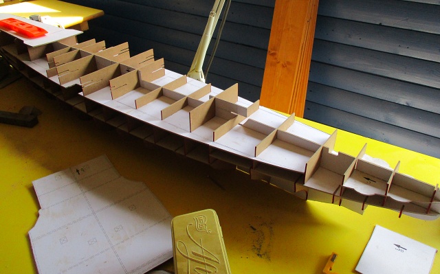

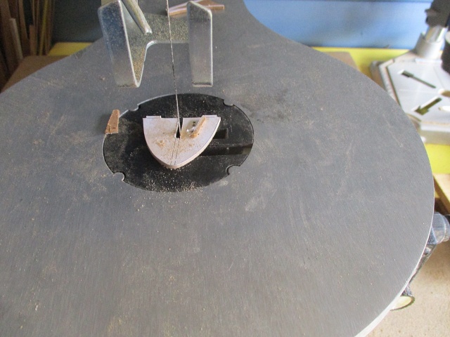

BigGrin Hi Folks

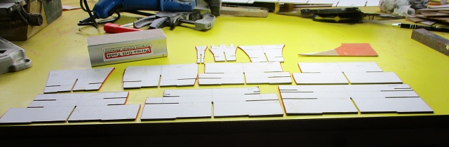

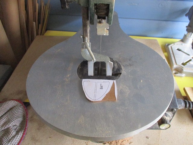

after a considerable break away from modelling, some enthusiasm has returned for me to make another attempt at the card conversion of the SMS Gneisenau
Templates enlarged onto card. This reduces the chance of any wrinkles while gluing to MDF
MDF templates roughly cut out with an electric jigsaw, and finished off iaw with pics (if u can see 'em Flapper )
I see Ken has started a card conversion so will try and pinch some of his ideasCool

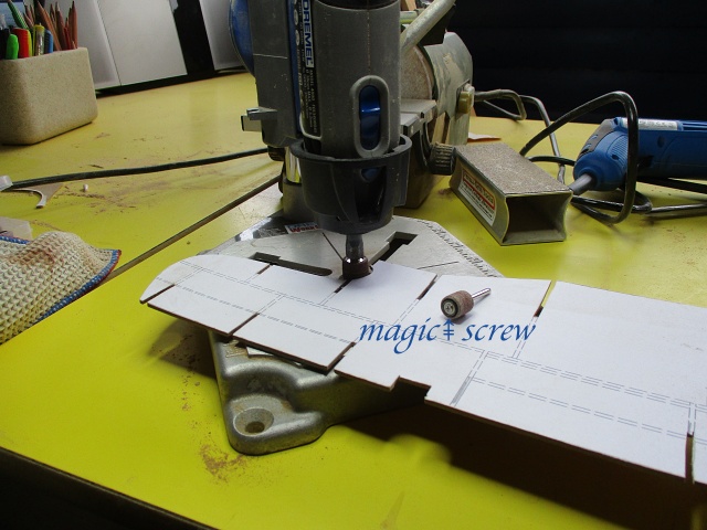

Blushing Thanks for commenting guys appreciated

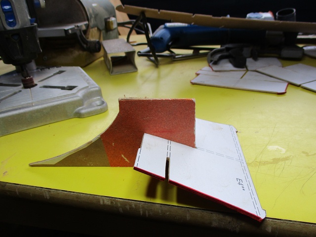

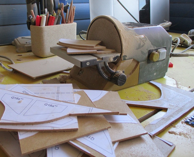

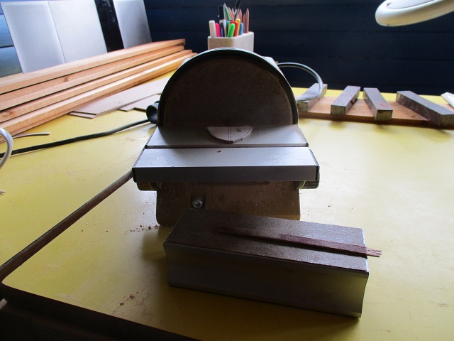

Any Hoos thought I would post progress
as I have a billion views so farConfused
No that's not right.. I have refreshed my page a billion times to see photo's I have postedFlapper
Ah well took me a while to figure out what the wee screw is for on the sanding drumCrying
Couldn't figure out why the sand paper kept slipping offLOL
The slots are sanded by gluing a piece of sand paper to the 2mm mdf.
Hopefully the parts will all slot together without putting stress on the keel
Progressing with prepping upper frames fwd section

Thanks for the screw tip Budgie! I just checked my various sanding drum thingies and they've got screws there too - can't remember ever using them though but its nice to know what they're there for!Blushing Blushing Blushing

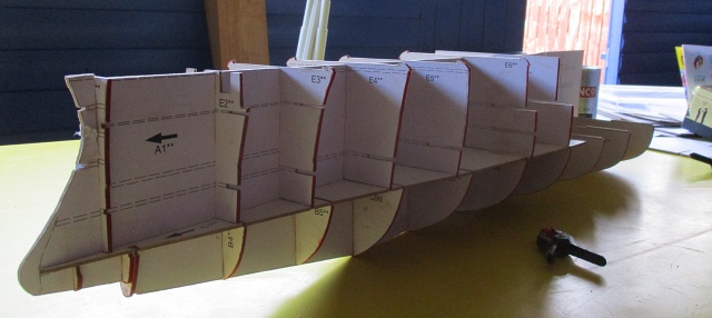

budgie
#7 Posted : 04 July 2021 17:44:20
Joined: 20/03/2010
Posts: 1,199
Points: 3,473
Location: Glenrothes

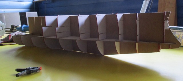

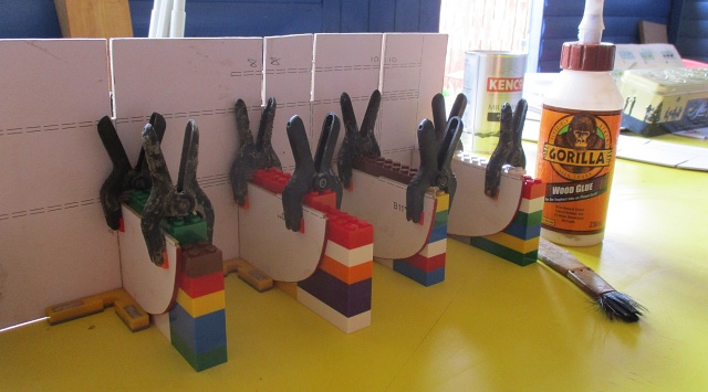

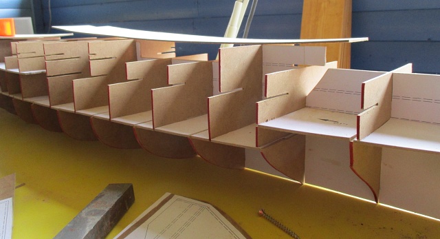

BigGrin Hi Folks
started gluing fwd frames
The way the frames and false decks slot together keeps everything squarish
budgie attached the following image(s):

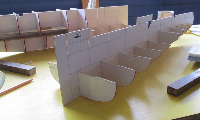

budgie

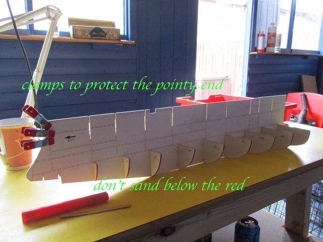

#10 Posted : 10 July 2021 08:56:03
Joined: 20/03/2010
Posts: 1,199
Points: 3,473

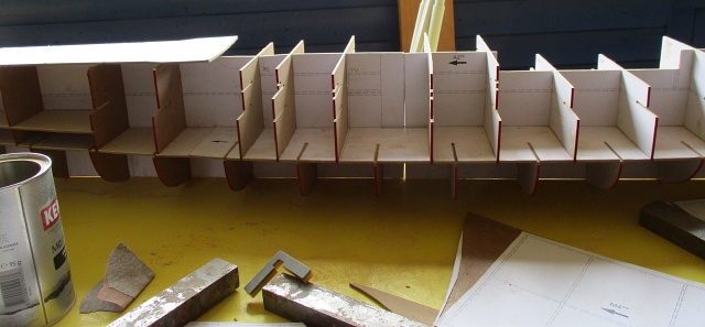

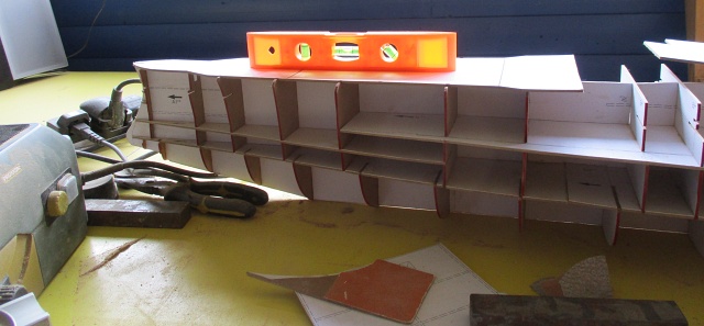

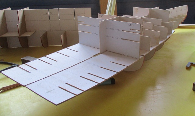

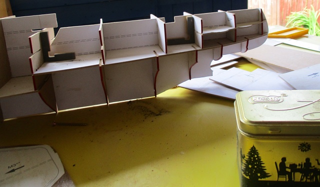

Hi Folks

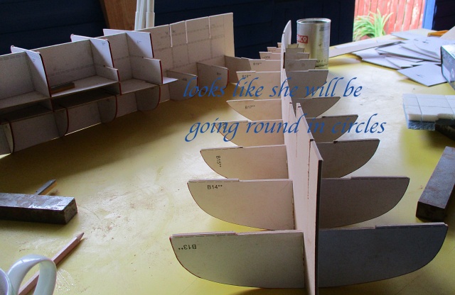

progressing aft
Despite keeping the 2nd keel weighted on a flat surface she aint exactly straightLOL
Not concerned as it will straighten without forcing as the frames and decks interlockCool

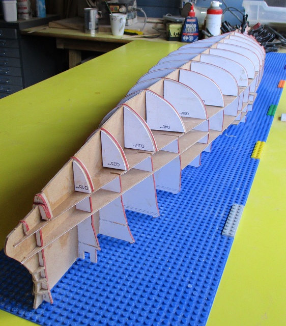

budgie

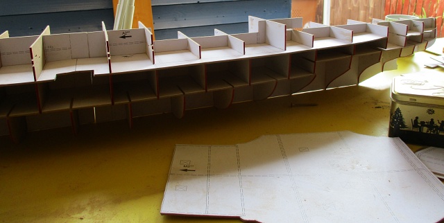

#11 Posted : 10 July 2021 17:15:31
Joined: 20/03/2010
Posts: 1,199
Points: 3,473

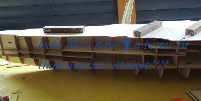

BigGrin Hi Folks

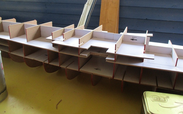

continuing to cut sand and DRY fit below parts
budgie

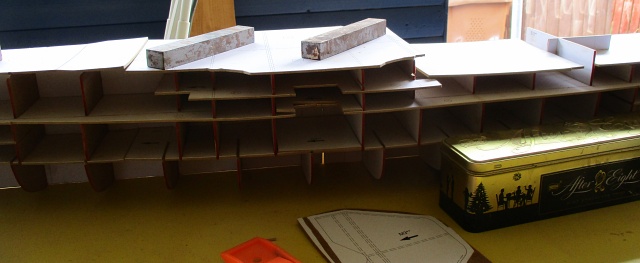

#12 Posted : 11 July 2021 12:31:12
Joined: 20/03/2010
Posts: 1,199
Points: 3,473
Continuing with dry fitting decks
The upper decks seem to be a better fit this time around with no gap between them???
Will find out when I start gluing together laterCrying

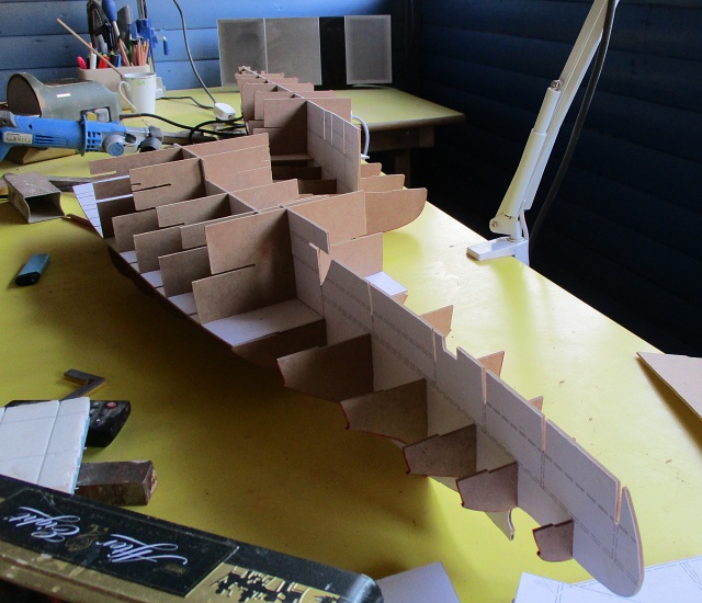

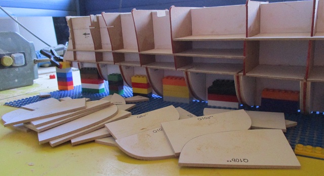

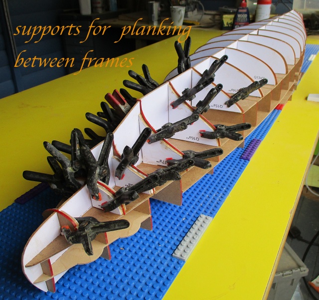

Hi Folks
this model supplies templates for gluing to either side of the lower frames to support the "card" infills between the frames
This was enlarged and transferred to 3mm mdf
There's a lot of them to do Crying
budgie

Blink Slow progress this week
#16 Posted : 25 July 2021 15:58:42

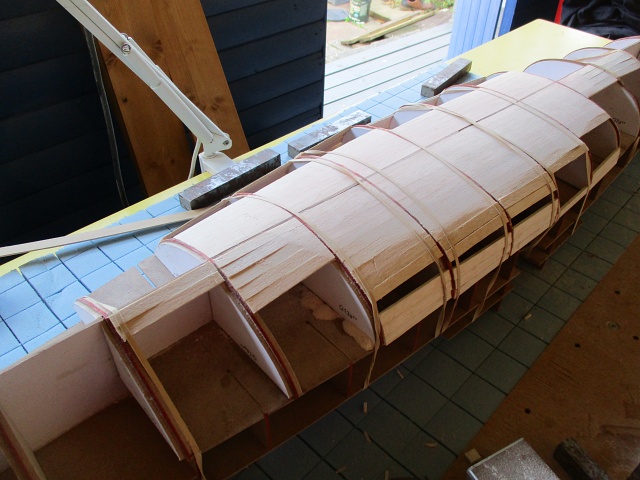

BigGrin Evening Folks

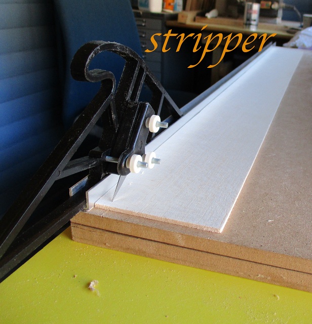

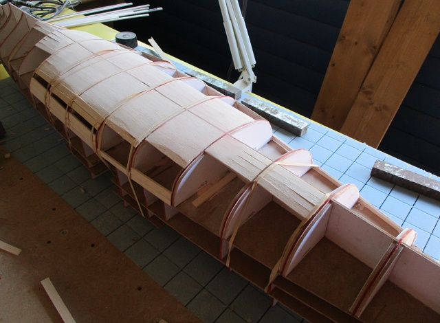

started filling lower frames using 3mm balsa
#18 Posted : 31 July 2021 21:22:46
Posts: 2,083
Points: 6,244
Beautiful work as always Budgie (And I DO like the look of that stripper of yours - I bet that's a great help in forming the planks!)Cool Cool
Robin
