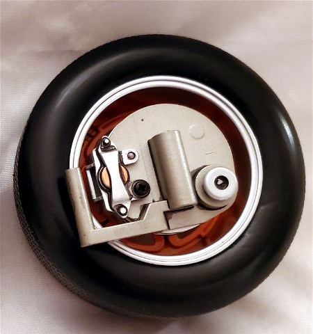

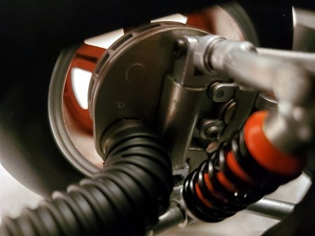

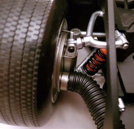

The following parts received a pin wash of Tamiya Black Panel Liner in the recesses. After this was done parts 3D and 3E were left to dry.
Part 3F received a light sanding of a heavy seam and imperfection (just enough to show the imperfection in the casting). It was painted in a steel color and left to dry. When dried the Caliper Piston Head was painted in a Pale Gold (Tamiya X31 Titanium Gold). When that dried a pin wash of Tamiya Black Panel Liner was added.
After the assembly was done the black screw head was painted in a steel color.

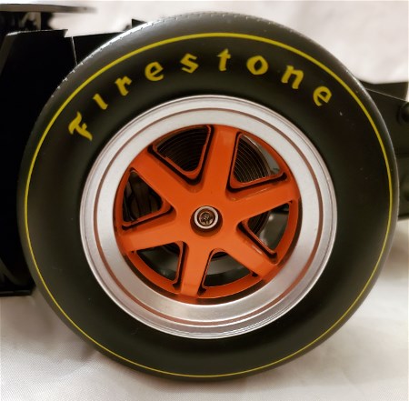

AT THIS POINT.... I chose not to weather the parts until I have the car built. So here are the results.

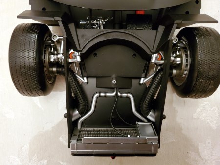

When the tire and wheel are fully assembled, attach to the car sub-frame In Steps 52.

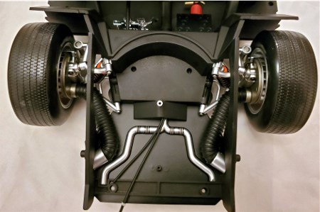

Stage 53 - WARNING...... PAY PARTICULAR ATTENTION TO WHERE THE WIRES WILL LAY IN AFTER YOU SCREW THE DRIVERS COMPARTMENT IN.
Follow all the assembly step in Stage 53 and the car is starting to look like something.

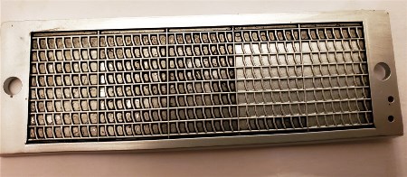

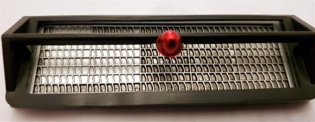

Stage 54 and 55. The aluminum finish is a little toy-like. Using the Tamiya Black Panel Liner add it to the recesses of the radiator low points. I took a picture to show the difference with and without the panel liner.
When dry, Install Stages 54 and 55.
