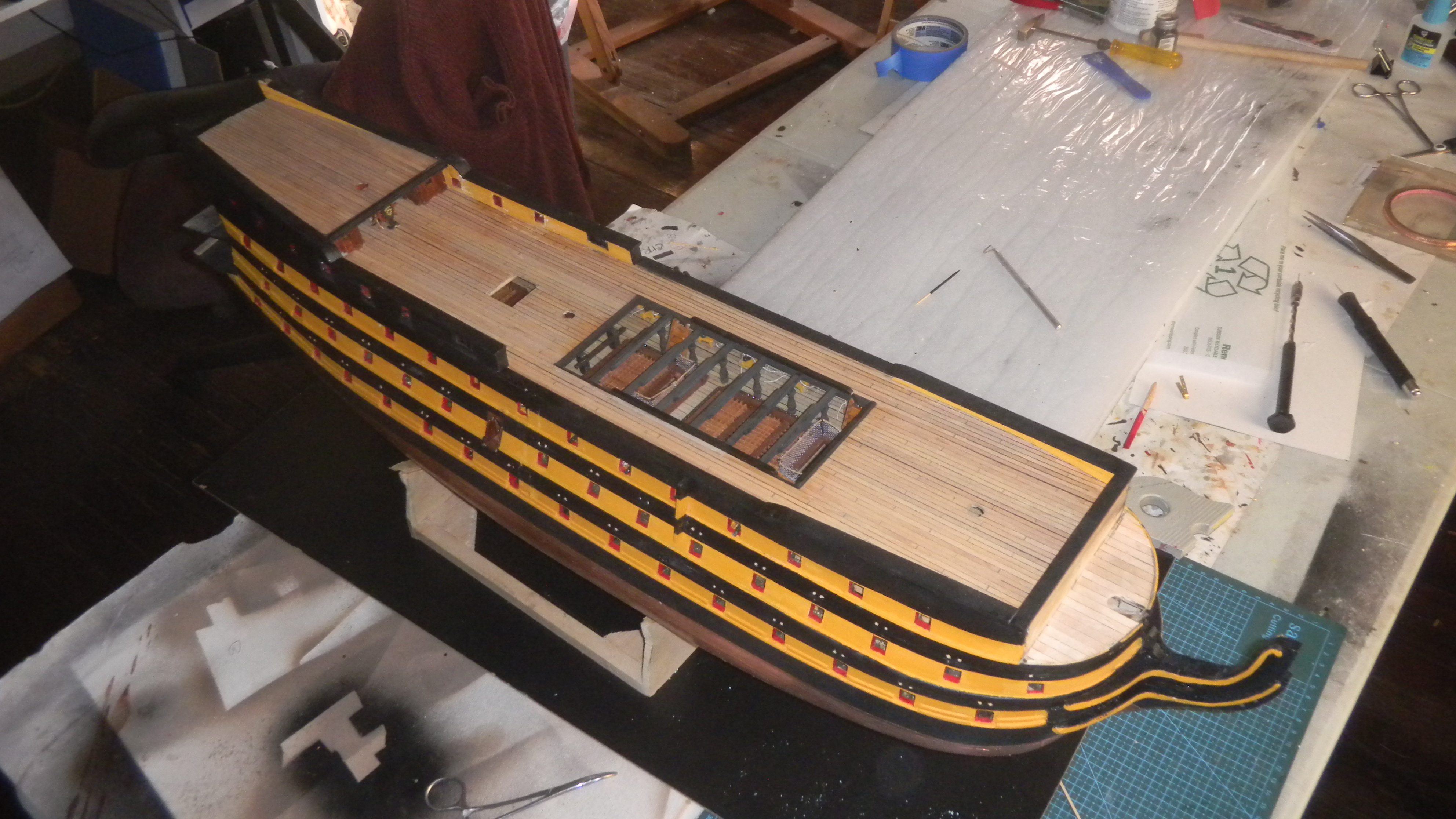

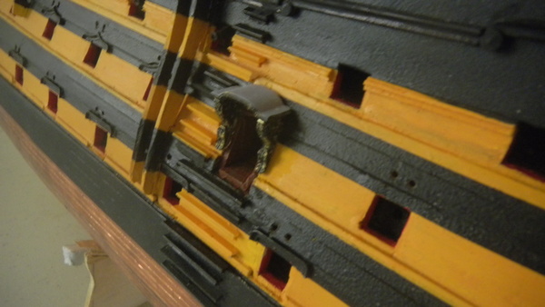

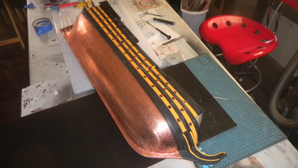

After going 3 years and so far behind, I finally have a decent camera to show a little progress.
Seeing how long it was taking, to use the real copper tiles I bought from this site, put them away and decided to go with the tape method as some have suggested. Not as nice as the tiles, I'm sure, but presentable (although I'm never happy with anything that is simply "presentable", there are other issues to deal with time wise). Should add, a bit concerned on the adhesiveness, and also found using an agent like JAX to get a patina will destroy the copper, as it did on my test piece.
Hope all are keeping well, any advice appreciated!

That looks wonderful Bruce. Lovely, neat work.

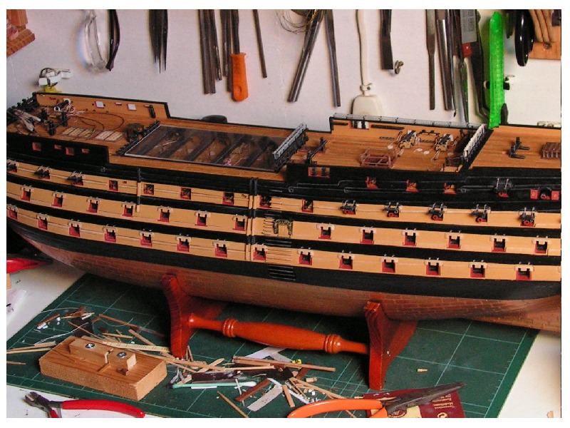

Hi Bruce.
I did my DelPrado Victory hull using the copper tape method, this was a number of years ago now (MUST get back to her soon!)Blushing
So far not one of the tiles has come loose, I used the 5mm wide copper strip as sold for anti-slug protection with rivets embossed using a dremel type circular saw blade (didn't have a Pounce wheel back then!)
A few years of aging and the tiles have dulled down considerably from the shiny copper finish they had to start with so you can just leave them to get on with it if you like! I think there are some diaries on here where home made 'gentler' solutions to add a patina have been used to good effect, I'm just leaving mine to nature - she's pretty good at it!BigGrin
Great looking effect on yours, well done!
Robin.
PS the photo was taken soon after completion so still shiny!

Very nicely done.
You guys put me to shame when I see the quality of your work.

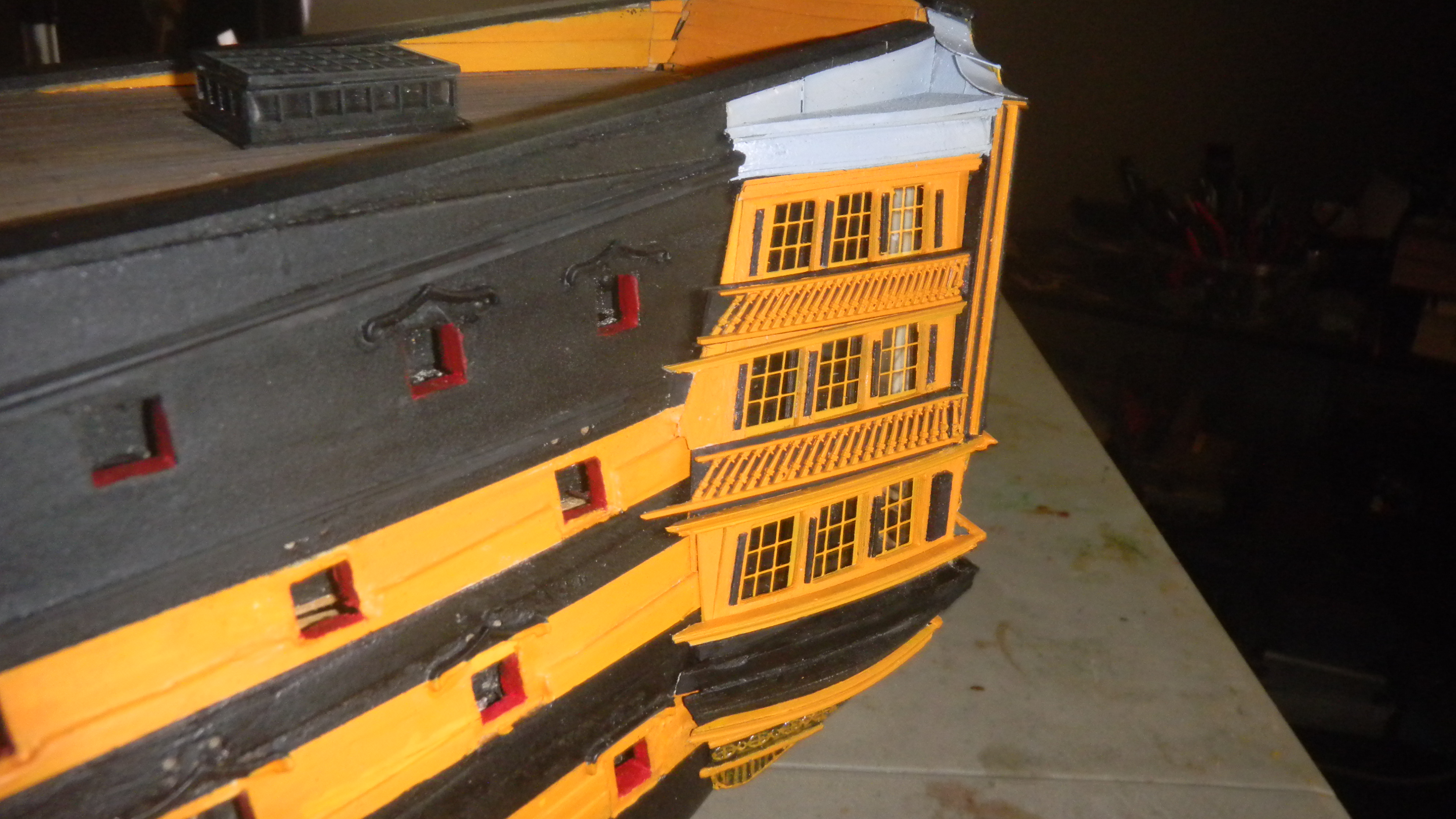

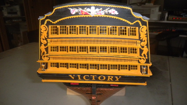

Hello all, finally made some progress to put up here. I find it really diaappointing as to the quality of the Artesania kit for the price, so took a bit of time to improvise the galleries, and a bit of money, well spent, on the decorartive pieces from Woody's Model Works.
Just a few simple adjustments, seperated the bottom side galleries to offset them from the top 2, added black panels under the side ballusters, made a new roof, and squared off the bottom corners as per photographs from the ship. Also added Woody's companionway, (added the middle rail myself).
Next up is Woody's bow parts, they look very good.
Only question, 3 1/2 years in, will I ever finish this?

Very neat and tidy work.
The enhancements really look good.

Hi Enjay,
The gallery improvements you’ve done are superb, it’s looking absolutely top notch. With regards to the amount of time you’ve spent on it, don’t worry about it. Building any model is a labour of love, it’s finished when you think it’s finished.

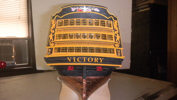

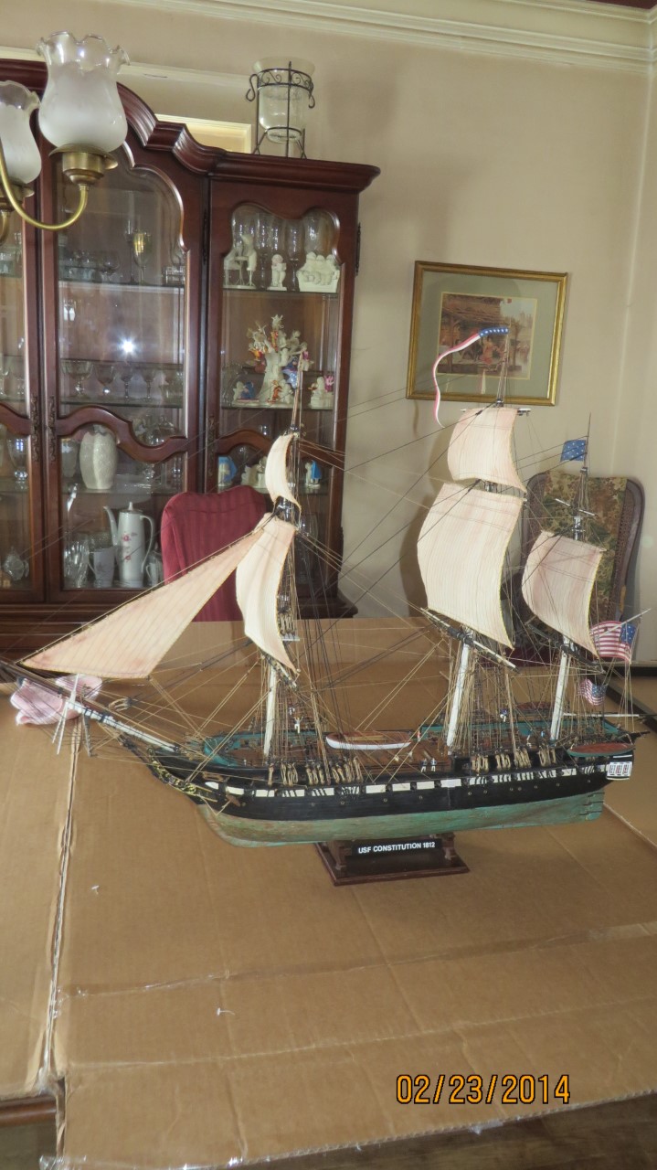

Thanks, everyone. for the really nice replies. Now about to turn 72, I'm (half) joking about finishing her. Like you, richard, I started my Mamoli Constitution, put away for 4 or 5 years as life got in the way, ended up being 10 years from start to finally getting her in a case. I had the same thought, glad I waited to finish the galleries. Again, thanks to all.
