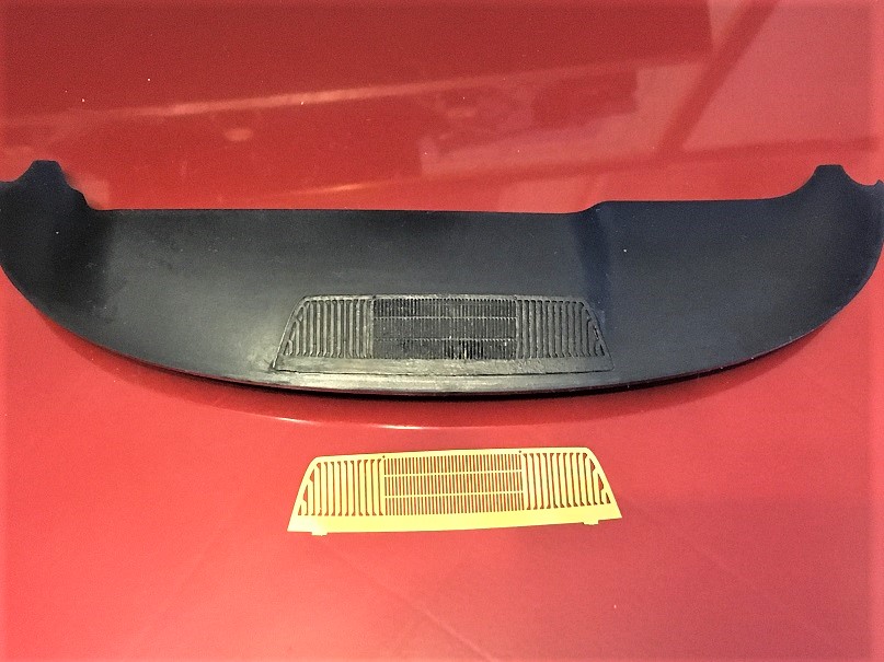

I am having trouble getting a good paint finish on the dashboard vent Grill, which I think is because of the preparation of the brass etching. I have cleaned the brass with all sorts of cleaner even Trichloroethane which was a brilliant degreaser and cleaner (so good that it has been banned) I then used AK interactive Photoetch Burnishing fluid but even after a couple of hours in the fluid still wipes off. Has anyone any suggestions please

What kind of primer and paint are you using? Also are you brush painting or spraying?

There used to be a Humbrol paint called 'Makes paint stick'.
It was amazing on just about anything. I used it long ago to prime a brass live-steam garden railway engine. Worked a treat but Humbrol must have changed the name as I can't find it. Maybe a bit of searching will bring it up.

This is what I do.
I go over the part with either a Scotch Bright pad or some #0000 steel wool.
Clean with 91% Isopropyl Alcohol
Then I prime with Rust-Oleum self-etching primer. It has a mixture of acid and zinc in it to help it stick to the brass. You should be able to find it in any hardware store or automotive shop.

Thanks for all the answers and advice. The reason I wanted to leave the vent in a blacked condition (not painted ) is because the slots in the center section are only 0.45mm wide and can easily become clogged with paint hence loose the definition. the question as to where I got the item from I will answer in a later post as I am trying sort something out at the moment. but I will answer very soon. Thanks again for the response

The PE looks great! Search for a model railroading product called “Blacken-it” which will do the trick.
