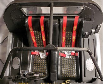

Stage 31- The Roll Bar. The only modification and am doing with this is adding Plastic Medical Tape 50.8mm / 2" wide. This tape has a grid like texture (the trade name is 3M Transpore). When applied paint it flat black paint. This tape is thin and easy to apply. It can be found in local drug/pharmacy store. Cut/tear (it tears straight) 5 pieces to match the "T" section of the bar wrap the tape around the roll bar section width wise and the vertical supports from the dashboard area.. You will need to trim the excess off the bar wrap. The adhesive should hold in place, If you wish, you could use a black thread for that added bind.

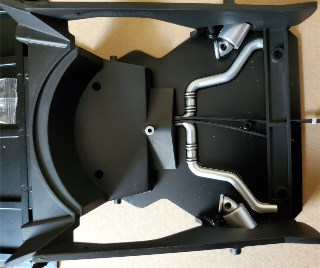

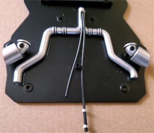

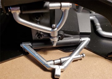

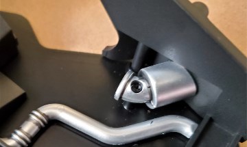

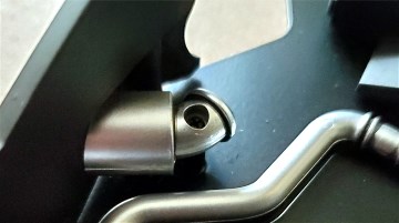

Stage 43- I used the Black Tamiya Panel Liner in the pipe recesses. On the black radiator line (part 43D) I painted the compression nuts aluminum. There seems to be a mistake with the instructions. Parts 43B and 43C should be reversed, the angle of the pipe should match the frame. See my special note and the last picture.

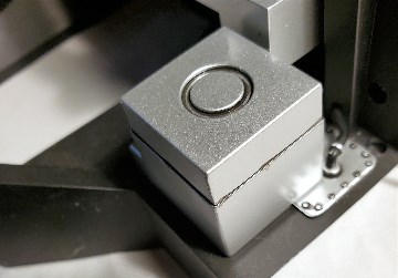

Stage 44 - This was a very easy build. The only modification was painting part 44A in a flat black to get rid of the plastic look.
Stage 45 - Before we go into the build on this section, part 45C was painted in the same flat black to match part 44A in the previous stage. Tamiya Black Panel Liner was added to the recesses on parts 45A and 45B. Well all was dried it was installed into part 44A
Special Note: When you "dry fit" part 44A on the frame. You will see how the pipes (parts 43B and 43C) going into it.
