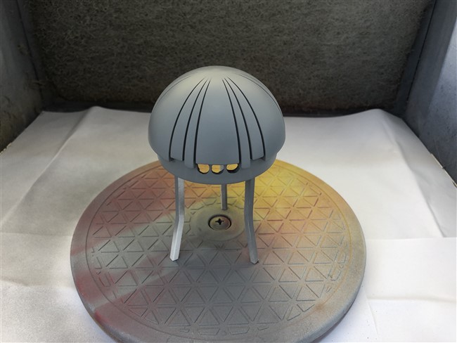

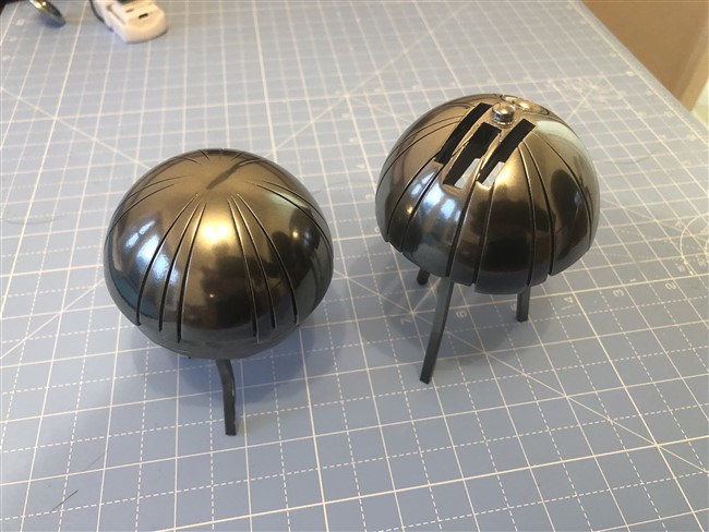

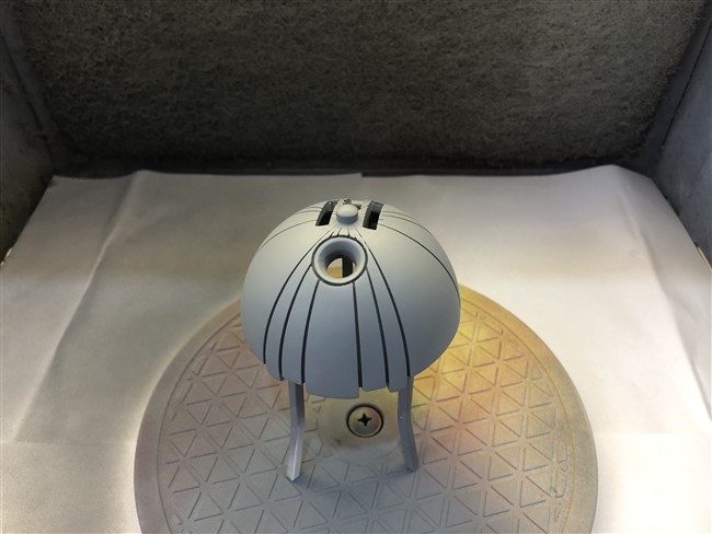

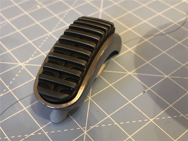

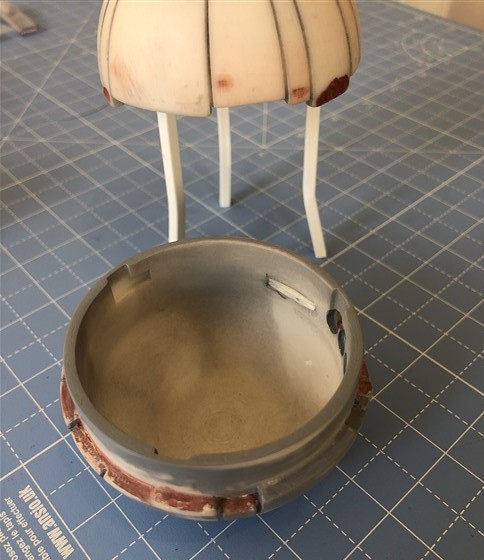

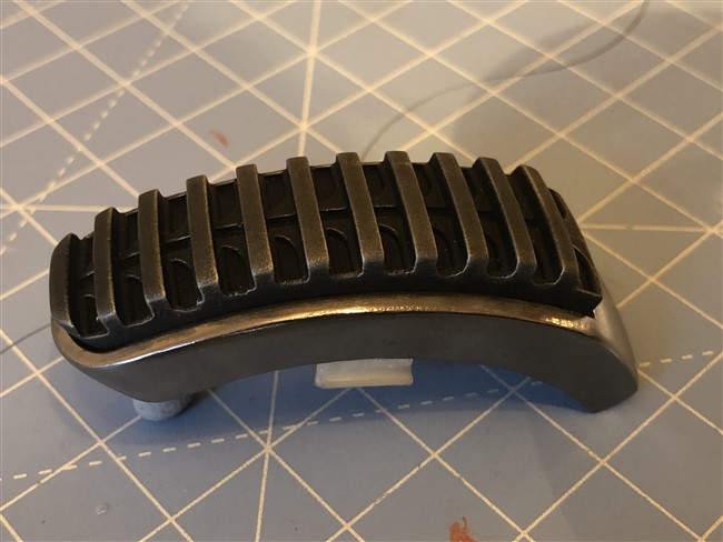

A lot of filling and sanding later and I’m ready to prep both the domes. I used some plastic putty at first, but this just wasn’t getting the very fine lines out. So, I used “bondo” glazing and spot putty. This is a red putty and dries very quickly and sands down beautifully, so I shall be using this again on other models. I used a filler primer, again sanding this down with a very fine sandpaper until I was happy and then primed the whole thing. The bottom dome was masked off and painted with a polished steel, as this area differs from the chrome finish the rest of the dome has. The trigger switch was also painted with polished steel with black metallic for the grip section.

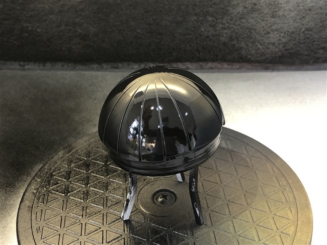

Once all the parts were dry, both domes were given a high gloss black coat of paint. This will be allowed to dry and harden for a week, when they will both be further polished up to create a mirror effect result before the chrome is applied.

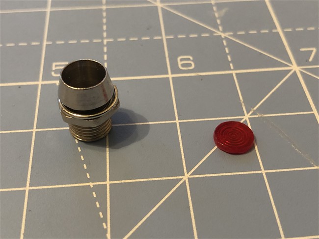

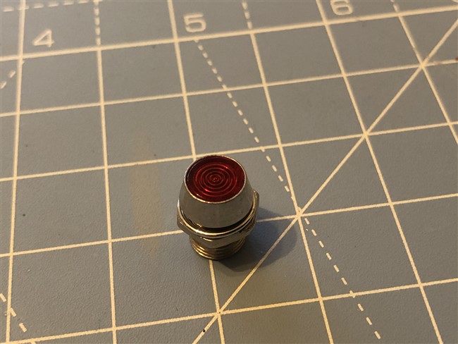

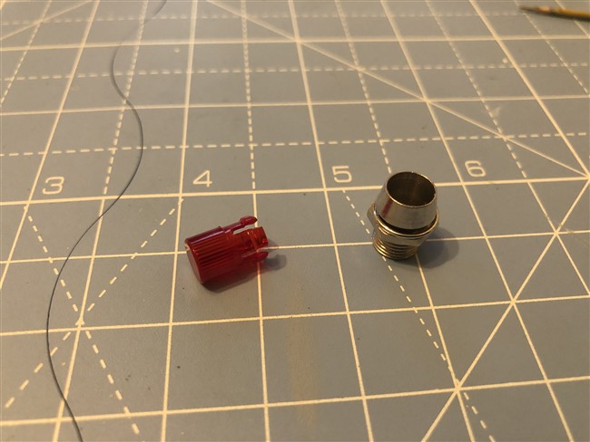

I have also fixed a red cap on the top chrome bezel as shown.

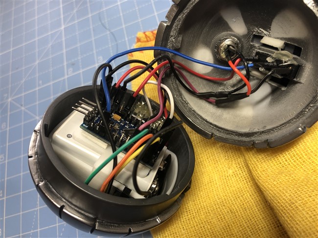

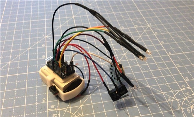

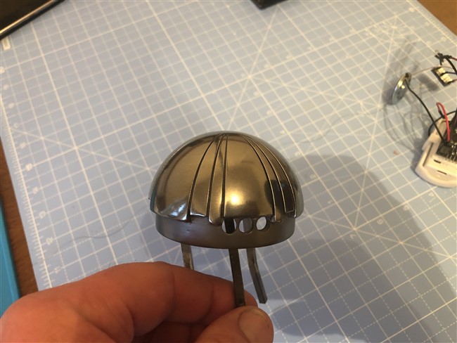

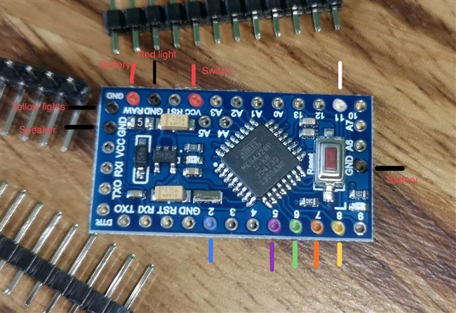

Small update, although it has taken all day to do this. I started the day with the electronics taking it from the test board to soldering the sections ready to insert into the detonator. As you can see, I have colour coded all the cables for ease of attaching them to the Arduino board. The 9v battery has been fully charged as well. All went well and worked first time.

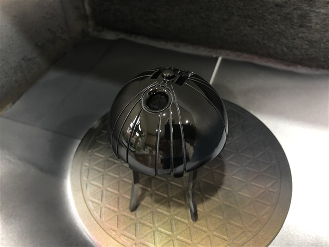

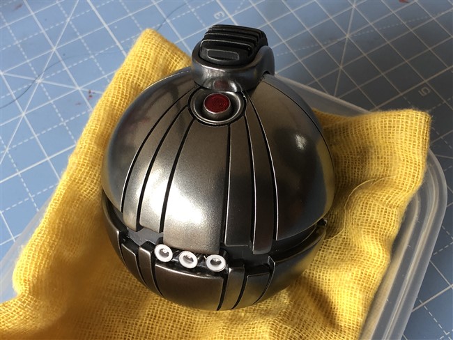

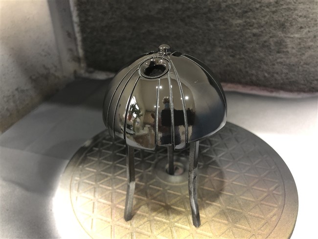

I then decided to chrome the domes, now the gloss black paint has had several days to cure.
I used Alclad 2 metal chrome paint and was very pleased with the result.

Thanks Carl.
The photos really don’t do the chrome paint any justice at all. The Alclad paints are brilliant, you just need to do a lot of prep work before hand. When spraying the paint on, you need to know when to stop. Too many layers will quickly turn it into silver paint rather than the base colour coming through. If you want a lighter chrome, you can use a high gloss white instead of black.
Alclad also do an aqua gloss clear coat, designed for these paints and it doesn’t affect the shiny metallic look they create.
I will be applying this as well. I usually don’t bother, but as this will most likely be handled quite often, I didn’t want to spoil the effect. The chrome can wear after time when handled if not sealed.

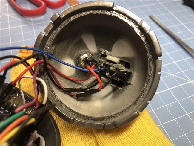

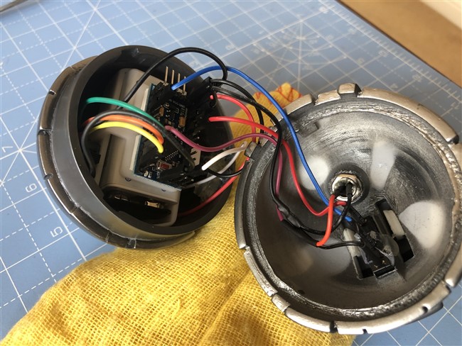

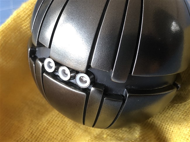

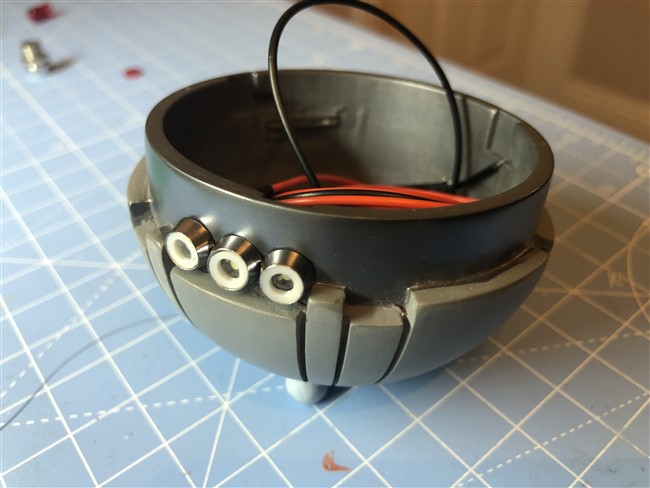

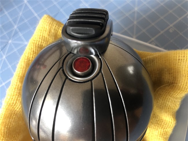

Now all the paint and varnish has been allowed to harden and cure, it was time to polish those domes. Next, was placing the handle on the top of the dome and connected the switch to make sure it was placed in the right position. All the chrome light bezzles were fixed in place using a glue gun and then the LED’s were then placed inside them. The rest of the electronics were fitted inside, and boy there wasn’t a lot of room left.

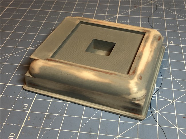

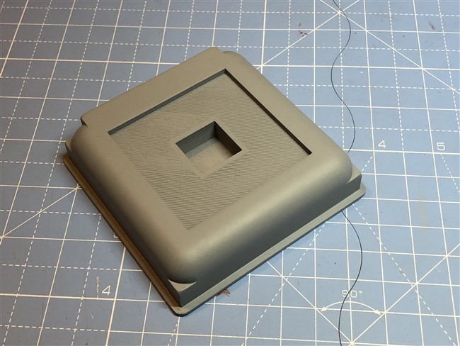

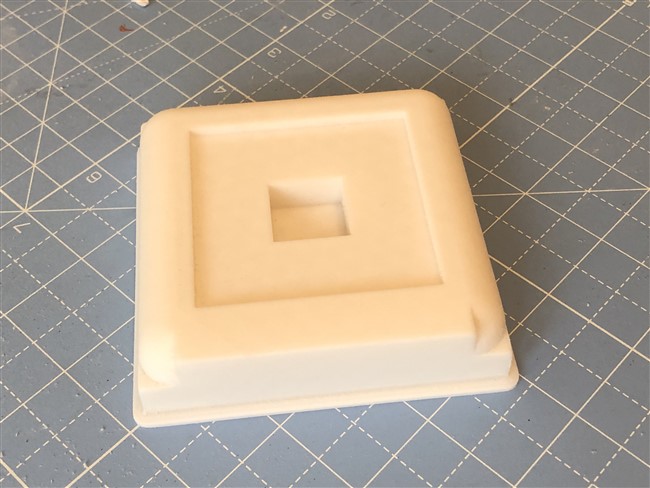

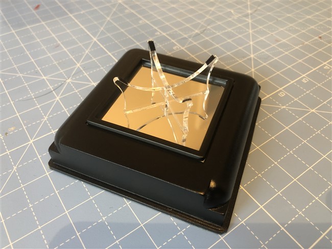

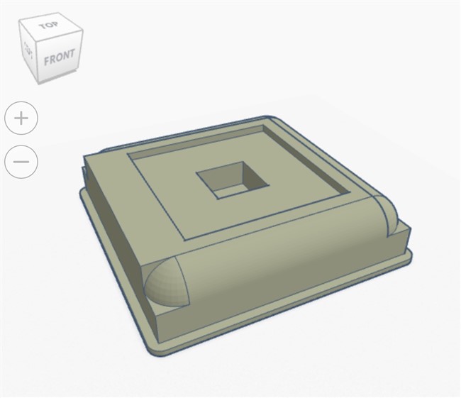

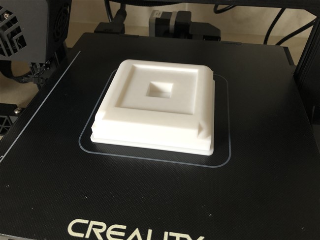

This time I have designed a display case. Rather that try and make something out of MDF as I usually do, I decided to print it instead. The hole in the middle is for a lead weight to give it some weight and then a mirror is placed on the top or outer recess.
The stand itself is made of clear acrylic and fixed to the mirrored base and some felt backing applied to the tips to stop it rubbing the chrome dome.
Just awaiting the brushed steel name plate to be fitted to the base and all is done.
