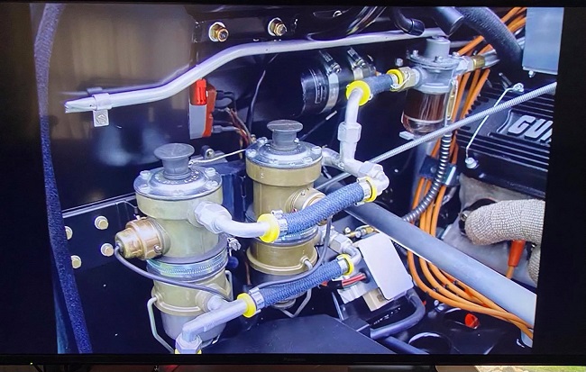

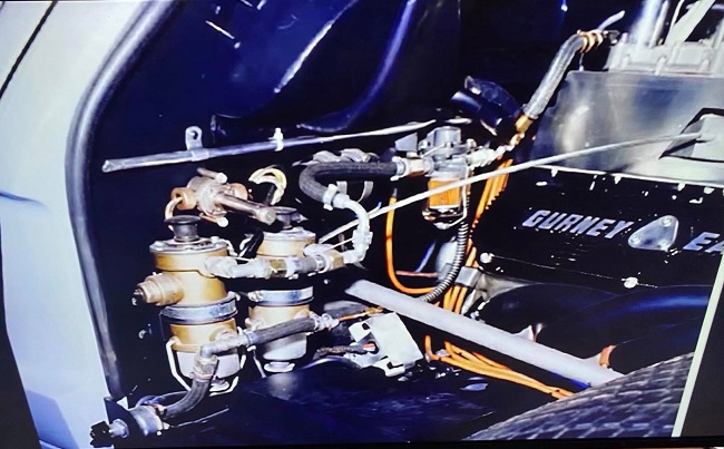

Hi Eagle, I found a good source of images on You Tube I hope these are helpful to you.

Thank you for the photos, they are much better than what I have found; there are differences in the plumbing between the two however, perhaps these are photos from a semi accurate restoration....

Hi I believe these are from chassis no,s 1075 and 1076 when they where displayed at the Amelia lake concours about 3 years ago

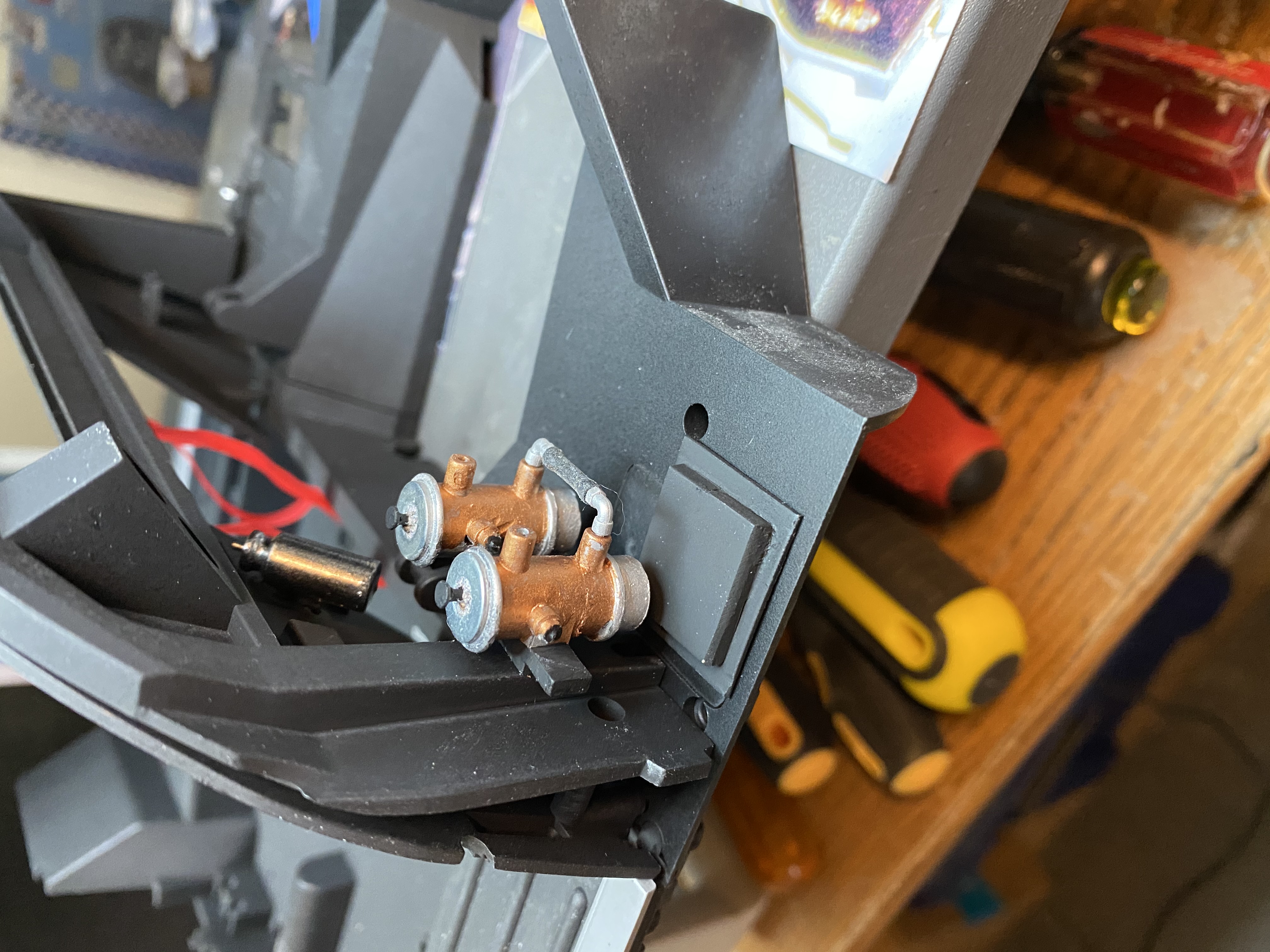

Thanks GlynD for the photo; decided to modify the kit fuel pumps as I don't have any 3D graphics experience and I'm too old to learn it. I cut off the pump bottoms and reversed them, shortened them and then added material to the bottom under the flange. , scratch built some switch parts and scrounged up some lines from a parts box, washers, etc. Still need to work on the top flange and add more fuel line fittings either from resin or metal. I also reworked the left floor panel and scratch built the compartment cover to look like the period correct photo

That’s looking a lot better I’ll be doing something similar as well , I’m wondering how much other wiring / fuel line detail will be included 🤔

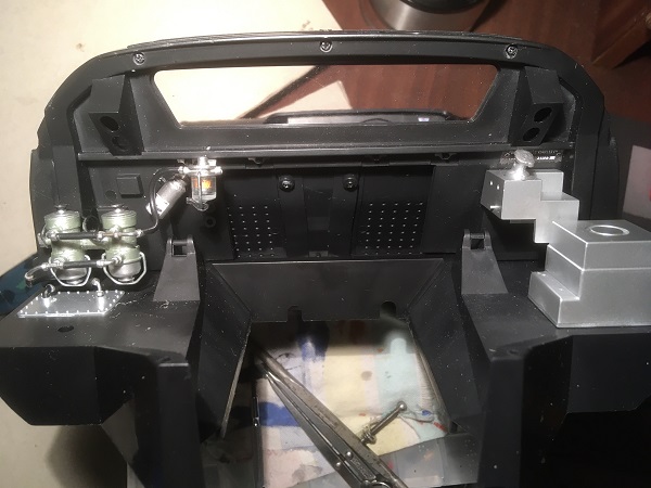

I agree with the need to upgrade from the facet Red-top fuel pumps to the ones fitted to all the original cars as they came out of the factory (the majority were from Slough) which were Steward Warner 240s and a Fispa fuel filter/ regulator that was fitted between the pumps and the carburettor’s. The attached picture is my effort at reproducing the said parts.

Nice work Brian! Looks much better than the stock kit. Did you build from scratch?

I cut the top and bottom off both pumps supplied and turned the new parts on the lathe using alloy, the Fispa fuel filter/regulator was made from scratch. I just hope this model dose not take me as long to finish as the one in the garage as I started that one in 1986 hopefully it should be on the road early this year.

Great work Brian; much better than what I was able to cobble up; must be nice having a lathe to machine things up.

Very impressive Brian especially the pipe work I constantly feel the need to up my game which is no bad thing 👌🏻

Yes the pipe work was the easiest part, a length of piano wire, a few 12 BA nuts and the outer casing of some electrical wire for the piping the main problem is I have rather large hands and I am forever dropping small items such as nuts and screws Did you notice the chassis plate above the header tank?

Thanks for the tips Brian I had been wondering about the pipe unions but your idea is brilliant and yes I noticed the chassis plate 👌🏻
