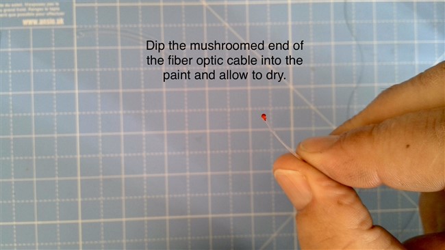

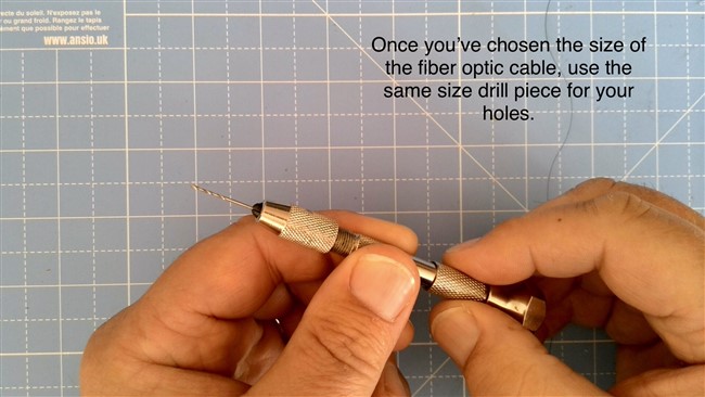

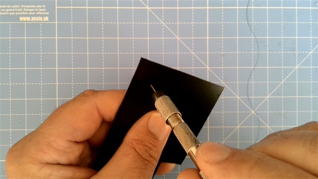

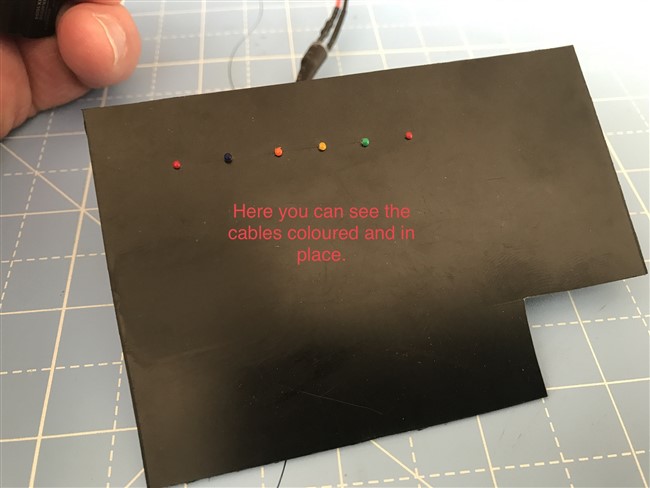

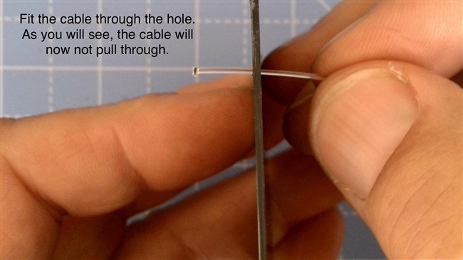

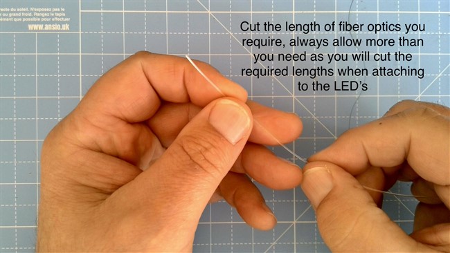

I thought I would start by using fiber optic cables into a model kit. These are particularly great for lighting panels with small lights where LED’s alone will be too big. There are many sizes of fiber cables, the one I have used in this tutorial is a 0.75mm cable. This is quite big in comparison to others, but it allowed me to photograph it easier.
Most of the model kits I have done, including the Millennium falcon, have been 0.25mm.

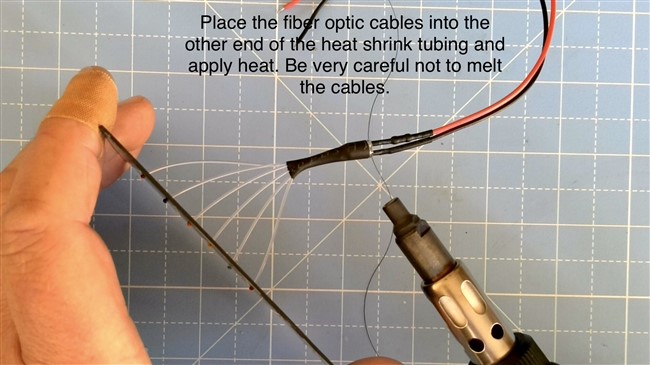

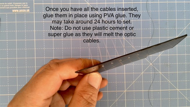

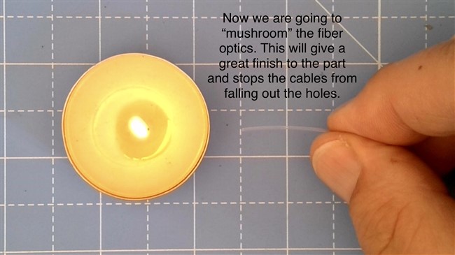

It is important to note that these cables don’t like heat, particularly the smaller gauge and they have a low melting point. They also don’t like most glues we use in a kit, such as plastic cement, super glues, and even plastic putty that you fill gaps with. So carefully spend time and plan where you will be placing these into your model.

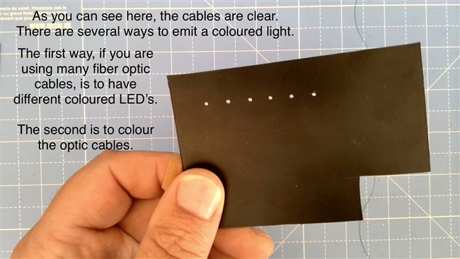

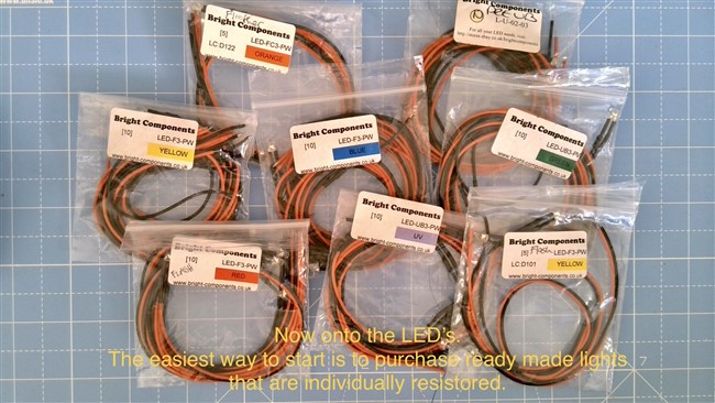

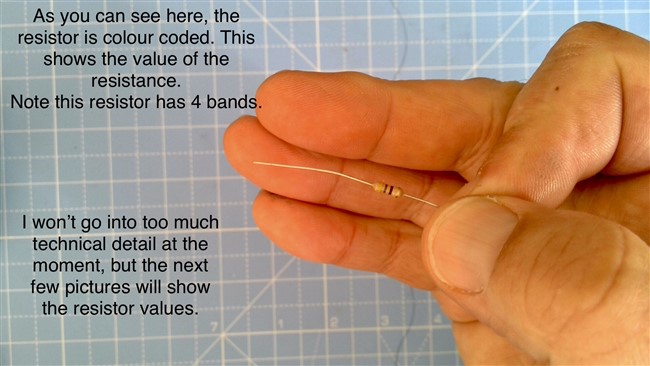

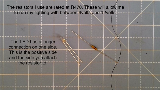

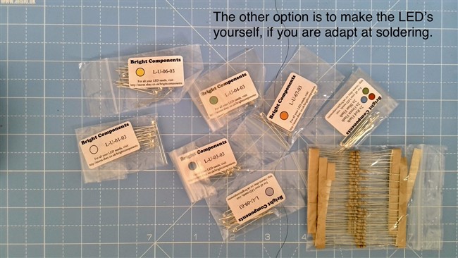

As you will see, I tend to source my lighting readymade. These come in all different sizes and colours. Most of what I have used have been the 3mm LED’s. They also come with multi coloured flashing LED’s as well as flickering ones. The latter ones are great for fires, candle lights on ships and pulsating engine exhausts.

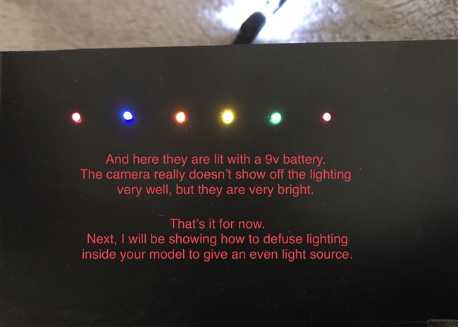

I will go into other lighting methods next time. This will include lighting whole sections of a model, such as ships and sci-fi models and show you how to defuse the lighting to get a subtle even effect.
Until next time, happy modelling.

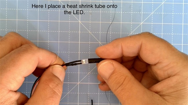

A well put together article and something I have thought about for aircraft navigation lights.
I do have one question though.Blushing
When you put the fibre optics in the heat shrink (opposite end to the led) do the fibres have to be touching the led lens or would very close be ok?

Thank you for looking in guys.
Hi Derek.
As long as you have the fiber optics in the sleeve you make from the heat shrink tube, you will be okay.
A tip though, when applying the heat, make sure the optic cables are near the LED. If you have a too bigger gap, the heat shrink will close between the optics and LED blocking the light to the fiber optics.
A tip though, when applying the heat, make sure the optic cables are near the LED. If you have a too bigger gap the heat shrink will close between the optics and LED and will not allow the light from the LED to the optics.
Thanks Mark,
"Guessed" they had to be close Blink , but didn`t know if they had to touch to get the light source down the fibre.
Now I know.BigGrin
