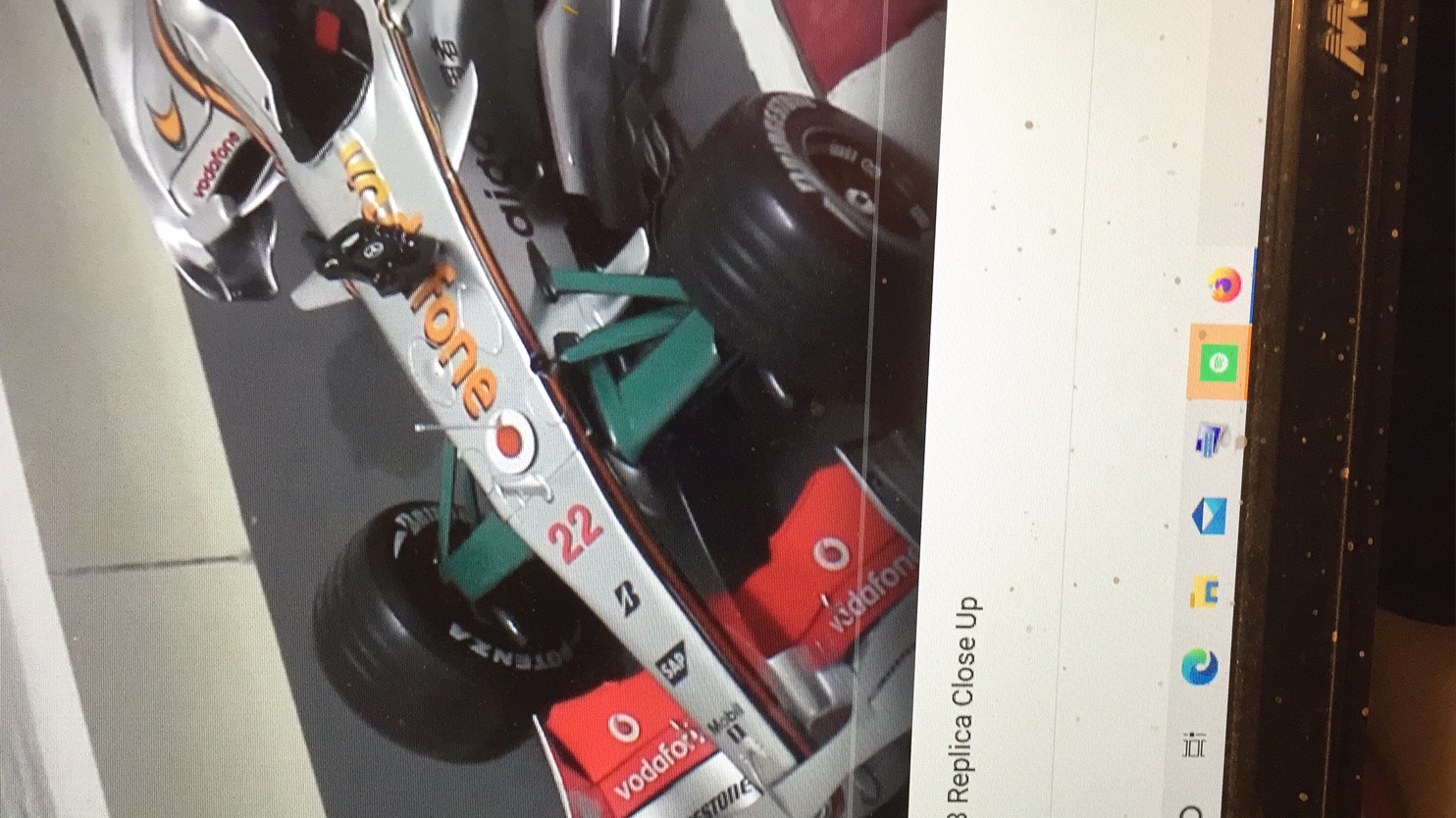

I've noticed that a number of the models that I have seen have had their carbon fibre decals turn green over time. Is there anything one can do to avoid this other than keeping the model in a dark cupboard?

Hi Derek, thanks for your input, much appreciated! I will definitely look into that UV blocking Polycarbonate sheet material that you suggest. I am in South Africa so I will have to find a local supplier but that should not be a problem I am sure. I have attached a picture of one of the cars that I have seen on you tube, it is quite unbelievable how green the suspension has gone.... apparently it was ten years old and I assume in the sun most of the time!
