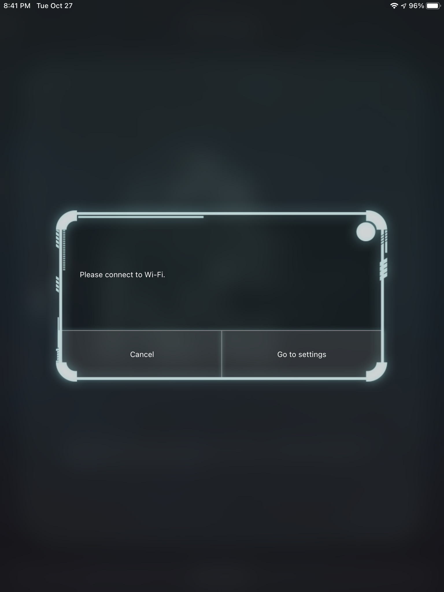

Hello, thank you for posting this. I am running into the exact same thing. The droid worked perfectly when connected to my previous router, not an issue. I recently switched over to the Google mesh network, and ever since then he cannot connect on either direct connection or local Wi-Fi. I have no idea what to do. The user troubleshooter guide wasn’t very helpful.
Is there a way to reset the internal router and wipe out the previous memory of my old IP address. The Google representative asked me if I could do that and I wasn’t sure. Any insight would be helpful.
#8 Posted : 28 October 2020 09:43:47
By pairing the new router as stated in the guide for the first time should reset it. You may want to clear your device, the one with the app on, as well, or maybe reinstall the app.
There were certain devices that R2 would not work on, such as kindles and some google android phones. Whether that will be the same with the google router, although using direct mode should not effect this.
Hope that helps.
