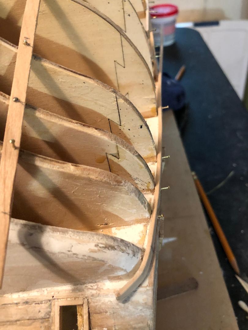

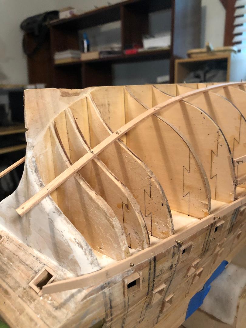

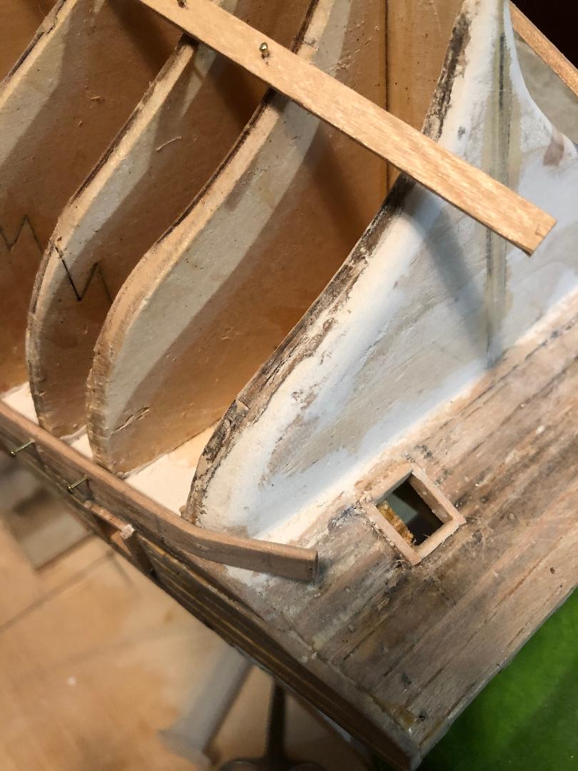

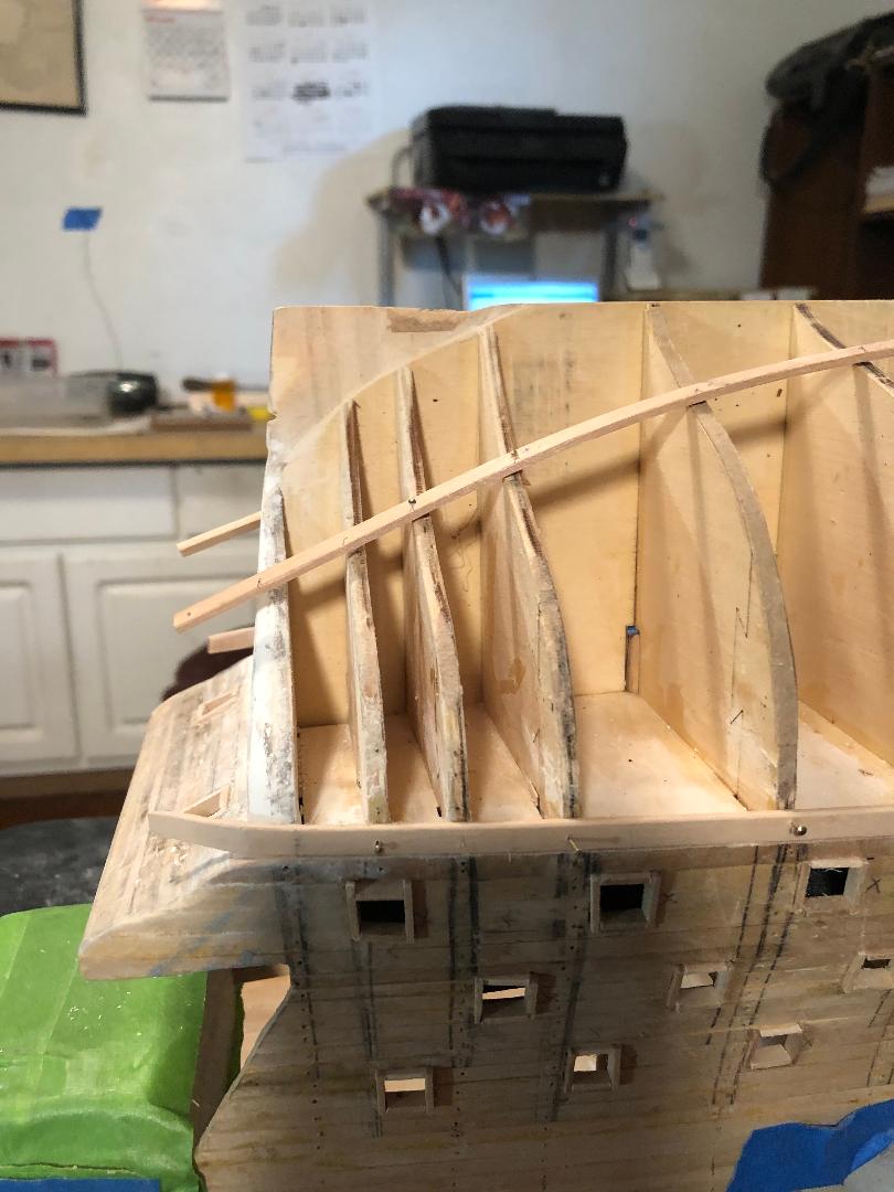

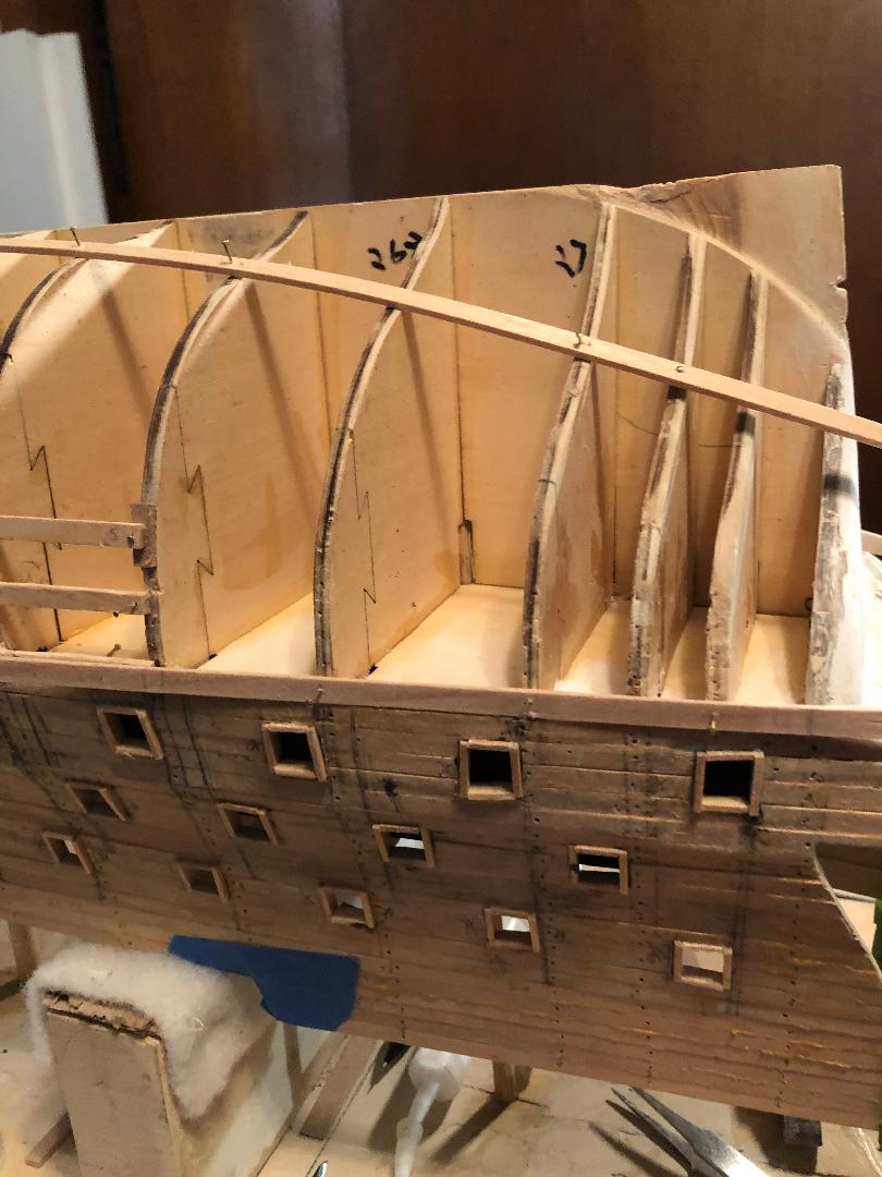

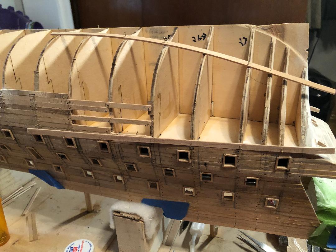

Hi Alan
here are a few photos of the bent stern planks and the top planks in place
as far as the stern planks I tried to bend a them like the ones in the
instructions they are not coming out good with the crimpers that is even when I
tried to be gentle the turns are still showing splinters, so would like your
permission to try bend theme using my iron as I did in the past soaking them as
well, try two new ones, I almost forgot to mention since the stern planks are
temporary and not glued I did not trim the ends toward the bow as you can see
in the pictures
Ronald

HI Alan

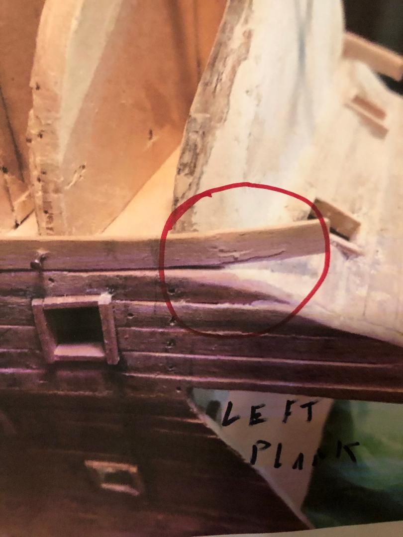

I had these two photos taken of the right and left side of the stern with the
bent planks in place as you can see the left side has a bad turn to it I tried to fix it by soaking it and using my iron but the stress marks and splitting is from using the crimpers first, that will have to be replaced the right side is not bad that I can see. I did not do any twisting to either one they just have the bend in them PS this post is a part of the last post I sent this afternoon, your thoughts, advise & next instructions
Ronald

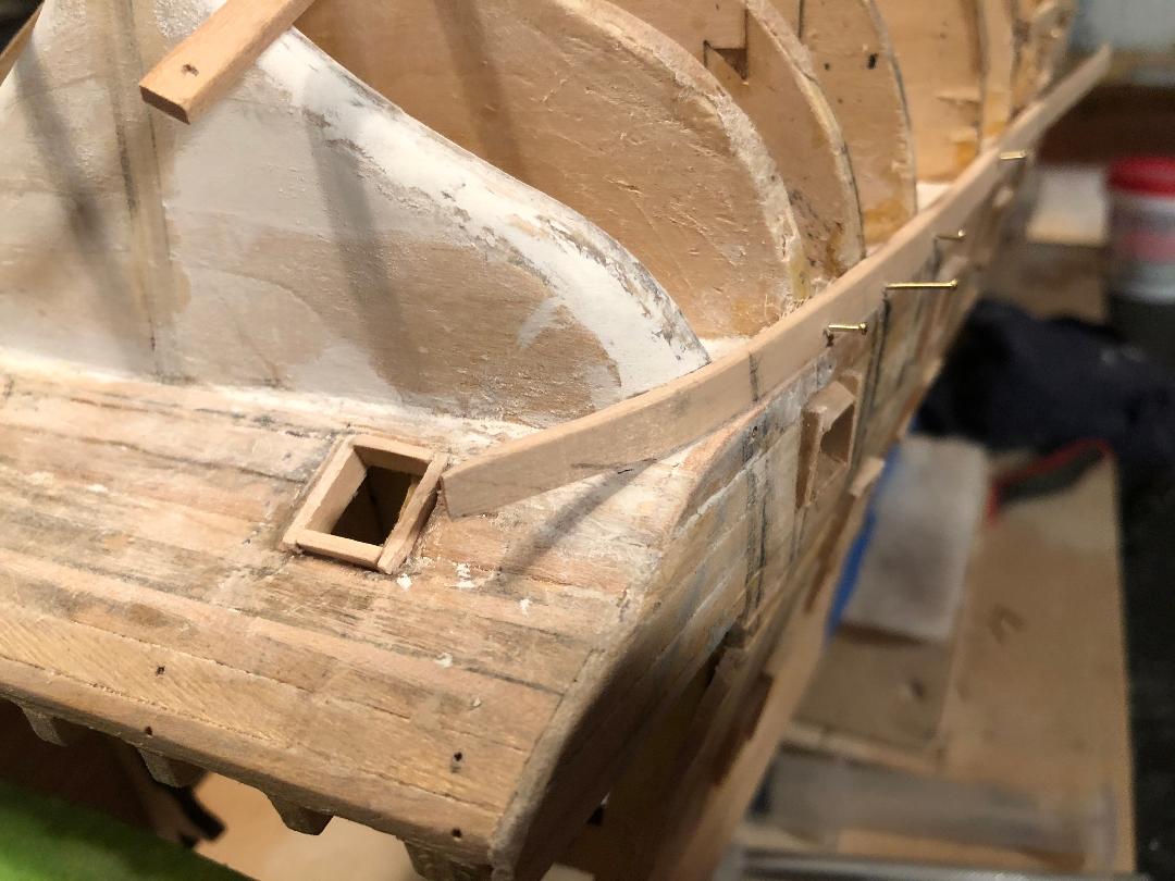

two new and better photos of the stern planks bent right and left ( replaced the left plank with a newer one
Ronald

#70 Posted : 29 September 2020 22:33:39
Its getting there Ronald but you need to bend the plank more to get round the curve. Use the iron first then the crimper, not the crimper first. It is tricky and you just have to keep trying. Once you have the plank looking like step 4 of the instructions then we can move forward a little more. There is nothing more I can tell you on how to achieve this I'm afraid.
