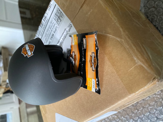

A small follow up on my Easy Rider. I managed to buy a FatBoy helmet out of Hong Kong thanks to MWB's help. Now it has to be painted and decorated and I believe Mark Warren did one.
Mark can you tell me what paints and colors you used. The photos look like the paint is an silver undercoat with a translucent top coat. Sort of candy color as on model cars.
How did you do your stars? Decals? And how many did you use. Hard to tell from the movie photos.
All in all, very happy, took a while, not cheap on the after market but it makes the project.

Hi Tom
The colours were Aston Martin colours
Intense blue
Frozen white
Hyper red
Glass effect
A friend of mine used to work there and got the colours I needed after I gave him the fuel tank as a reference.
As for painting, first mask off the rim and inside and spray white. The stars were cut using a star cutter, you can get these from various stationary stores, and cut out on some decent masking tape. I then place around 17 of these over the top of the helmet and masked the bottom part off. Then apply the red paint to the top. Finally mask the top section off and make the stripes to the bottom and paint blue.
I finally sprayed the whole helmet with a sparkle effect varnish.
Sound easy, but it took many weeks to do and on one occasion had to start again when my spray gun took to a turn for the worse.

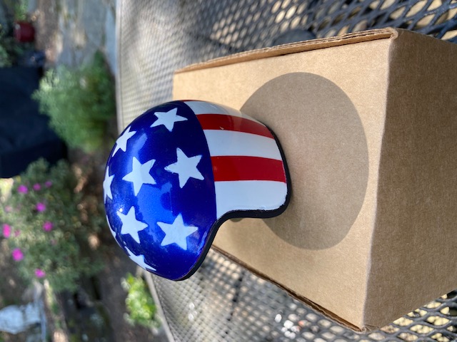

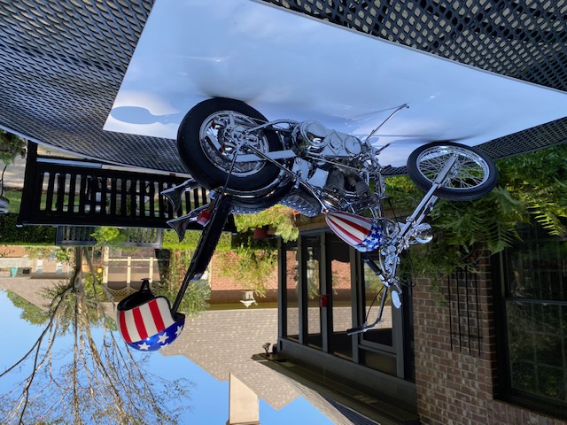

The final postscript. The helmet is done. As Mark warned me, not an easy chore. Paint colors is the best i could do. matching his paint numbers for Aston Martin is not easy But with some understanding folks at a large auto parts store and internet Duplicolor info, we came out OK.
So, here is my true end effort.

Superb result Tom.The helmet looks fantastic

A superb result. If it weren't for the table setting it looks utterly real.

Fantastic job Tom. The helmet really makes it complete. Display it proudly.
#91 Posted : 21 September 2020 19:12:55
Well done that man.BigGrin Love That looks excellent, you must be very pleased with that.Love Love Love
Looks superb on the bike.Love

Thanks for all said. The helmet is the kiss, the iconic element of the movie, cycle and the age. I know.
And now ,for me, the whole image represents letting it all go, you handle things, l’m outtta here.
That helmet should be part of that kit. Thanks for all the help in finding it and finishing it to match and seal the deal.BigGrin BigGrin
