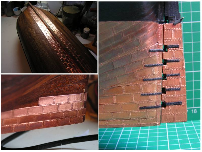

Derek's right about the copper tape alternative! The pics below show my DelPrado 1/100 scale Victory which I copper bottomed with self adhesive 6mm copper tape (sold on ebay as anti slug protection)! The left pics were taken about five years ago? The nicely weathered shot on the right about five minutes ago! None of the strips have come away over that time.
I did mine by marking the strip for the length of each tile and then scribing it with a blunt knife. Although I now have a pounce wheel with a set of wheels, at the time I did the coppering I hadn't even heard of the things! I used a miniature circular saw blade from a Dremel type tool, holding the shaft between thumb and forefinger and running it along a steel ruler from the backing paper side to emboss the nails into the copper strip. I applied the strips in lengths of about 10 to 15 tiles at a time with individual tiles shaped for the odd shaped areas.
Overall I was quite pleased with the result even though as Derek says, it's a lot more work!BigGrin
