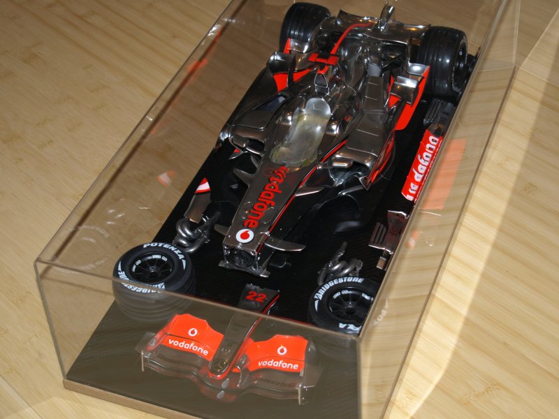

Here it is but the McLaren is only in there to keep the dust off it at the moment...

BigGrin looks AWESOME Spence!!!! I can't see my dislay case until Christmas day, as it is a present from my GirlfriendLOL LOL LOL

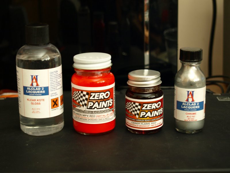

#290 Posted : 23 September 2014 23:21:55
Hi Rift and first of all a big welcome to ModelSpace and your kind comments regarding my buildBigGrin
You have also chosen 2 very nice kits to do.. Ok lets se how I can answer your questions.
The carbon decals I got from HLJ(hobbylinkjapan)and are still available but they may be low on stock but the ones you have a link to are just as good.
With regards to the "Smoke" over the decals, I used Tamiya Smoke from a rattle can as this gave better coverage but only do 2 very light dust overs.. to many coats and it will go too dark. The reason for the smole was to tone down the decals and to give them a "Glaze" so that when completely dry they could be given a go over with 6000 micromesh and then 8000 and 12000 to buff.
Woth regards to repainting the body, initially I used Automotive cilicon carbide 1500 (wet and dry) but later found out it was quicker to submerse the parts in automotive brake fluid for a few hours. This stripped the paint without attacking the ABS. Once the parts where washed and all traces of fluid removed.
The areas where the Zero Paints MP4 red was being added where outlined and the body parts where given a coat of Halfords white primer.
Where I had marked the lines that seperate the MP4 Red from the chrome was masked off only leaving the areas that needed spraying for the MP4 red, one this had a few coats the Red was then masked off and the rest of the body panels where then treated to a coat a Halfords Matt Black and allowed to dry for at least 24 hours.
Once the body panels had been left to dry for a few days they where given 2 coats of Halfords Clear Lacquer and once again given 2 days to completely dry. This was then given a rubbing down with 6000 micromesh then 8000 then 12000 to achieve the shine ready for the AlcladII Chrome.
No finger prints had to be on the car what so ever otherwise the chrome would have shown them up like something out of a murder scene.. (they use the same type of powder for fingerprint dusting and someone had the idea to mix it with Cellulose to make the AlcladII)
The black you see in some of the pictures in this build are of the highly polished black ready for the Alclad and the £Grey£ is in fact the Chrome but under flash photography can appear to look like grey BigGrin
Aa for the rest of the decals I would suggest looking on ebay as thy are still available..
Hope this has helped answer your questions and feel free to ask any more
Spencer
BTW: I did'nt use the candy red for any of the build as it was not needed.

#293 Posted : 29 September 2014 20:21:39
Hi Rift and great you've got your first sets of parts BigGrin
No clear coat was added after the Alclad Chrome as most if not all will dull it down so kid gloves will need to be used here...
As long as the Alclad is left to dry for days rather than hours then as long as your wearing cotton gloves to reduce the possibility of leaving fingerprints then you should be ok.
I have used a different Chrome from the Zero paints range and it's comes in a 3 bottle pack at around £18:99. It has the Black for the base coat, the chrome for the topcoat and the clear varnish. Since my original Build, others have been done using the pack below and is now my favoured choice as the lacquer can be applied over the decals to give that "painted on" look as with the real MP4/23.
http://www.hiroboy.com/c...fo.php?products_id=2054
This is also the better option if you have not used Alclad chrome before to get a mirror finish as it takes time... And a lot of it to get it right.
The MP4 red is a 99.9% match to the original McLaren red that they use on there cars, one of the reasons why it was the best option.and my final choice.
The Micromesh is the cloth and not the foam, I have not used the foam pads but I am sure they will work just as effectively.
Happy to help as always Rift
Spencer
