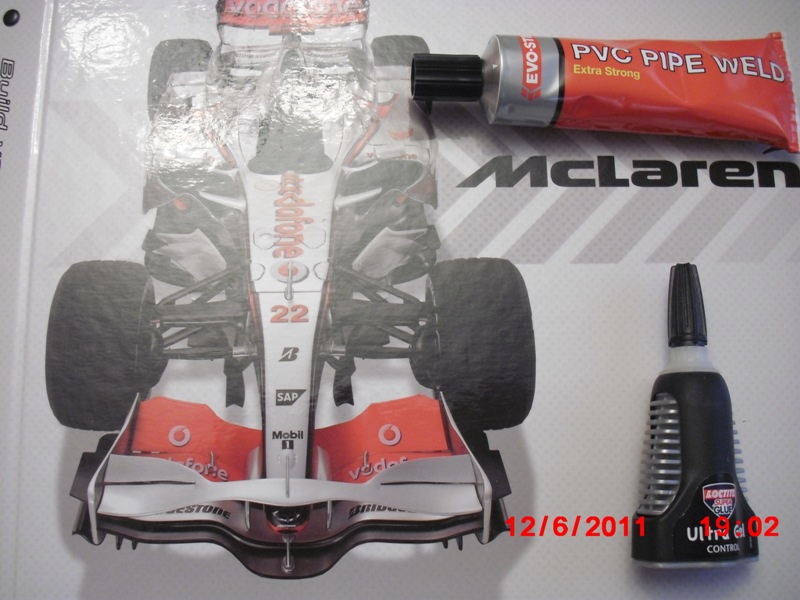

Hi Dan you have been sold polystyrene adhesive. This is ok for normal plstic Kits, but the Mclaren is ABS plastic so you need an ABS adhesive.
Have a look at this from B&Q

You won't go wrong with the glues that Mike(MWG) has recommended. Just bin the Revell glue or use it on an "Airfix" type kit, it is no good for the ABS plastic in this model. The superglue needs to be a thick 'Gel' type like the one in Mike's picture or another brand, as long as it is 'Gel', so that it doesn't run and both glues are best applied with a thin spatula or 'cocktail' stick. That way you avoid any unwanted spills onto the prepainted surfaces which will be ruined otherwise. Take your time applying the glue neatly and NOT excessively and you will be fine!!
I wouldn't advise using the 'superglue' for everything as you suggest as it can leave nasty white 'blooms' (similar to what you get on the skin of red grapes/plums) on some of the painted surfaces as it dries, due to the vapours reacting and attacking exposed plastic around the glue joint and which again will ruin your model. Just use it where the instructions advise and the ABS glue where that is advised then you shouldn't have a problem!!
