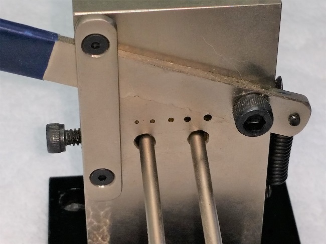

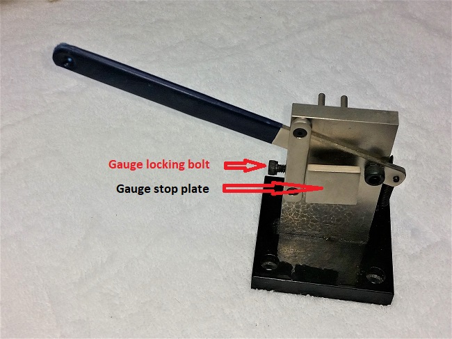

I feel for you with the problem with your hands and wondered if a wire guillotine may be beneficial for you as there is no having to squeeze on cutter handles just press down on a lever. It has an adjustable gauge so you cut exactly the same length every time up to 65mm and you get a square cut end not pointed as with wire cutters.There are five different wire gauge holes. It has a drilled base also, so it can be fitted to a larger base plate or work bench.
I purchased one a while back now and have attached a link for you and a couple of pics of mine.
https://www.proopsbrothe...0-15mm-j1002-1428-p.asp
Hope this may be of help.

That cutter looks a nice piece of kit, Derek.
I have always had problems with getting a straight clean cut on wire and to be able to cut more than one at a time is also a help.
