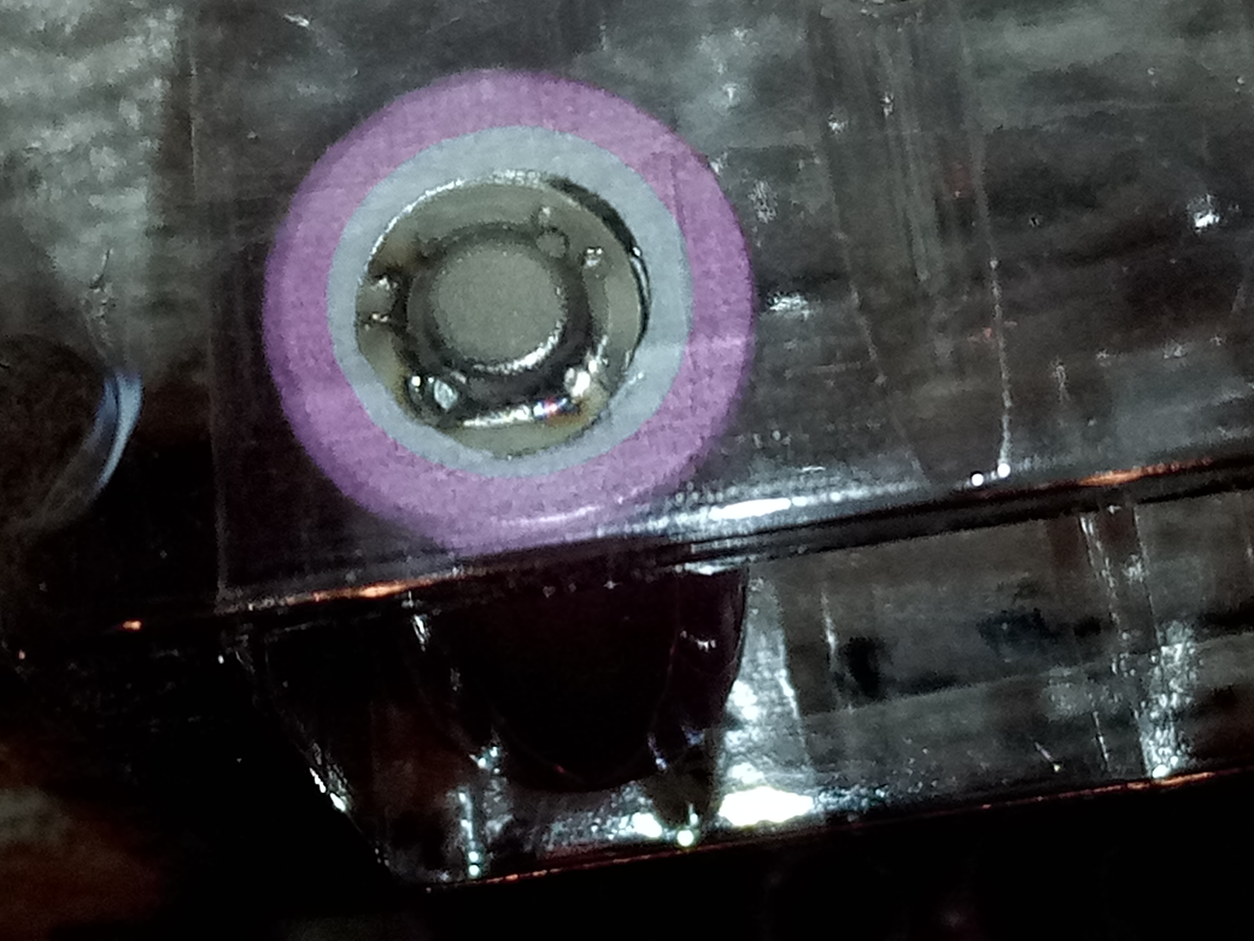

Hello, individually recharging the Samsung 18650 INR 30 Q 3000 mAh 15 A batteries with the battery charger provided by De Agostini, having a laptop that turned off several times during charging with a USB socket, which then resumed until FUL was in the battery, some batteries have small burns around the positive pole and in some points the isolation ring is a little raised. Is it dangerous to use them on R2D2?, Because I haven't put them in the robot charger yet. Hello and thanks.

Hi, thanks for the help, I followed de agostini's instructions in using the battery charger supplied for charging the 18650, instead you are telling me that it should not be used. The batteries I ordered online did not show any signs of burning or lowering of the insulation before recharging them. Among other things, I had previously used 18650 batteries by Melchioni, unique found in an electronics store and after having recharged them with the battery charger dea they have no defect unlike the samsung. I ask you, you can photograph with a smartphone the detail on the positive pole to show it to you, the battery with the photo on the defects does not get damaged, right? . Let me know, bye.

The battery I was talking about in this post as the other 5 have these conditions. Are they damaged? , can they use them on r2d2?, hello and thanks
#10 Posted : 15 May 2020 22:27:49
Posts: 6,968
Points: 21,211
If you are concerned about the batteries, then don’t use them. I would recommend you talk and get advice from the source you bought them from or ask them for a replacement.
