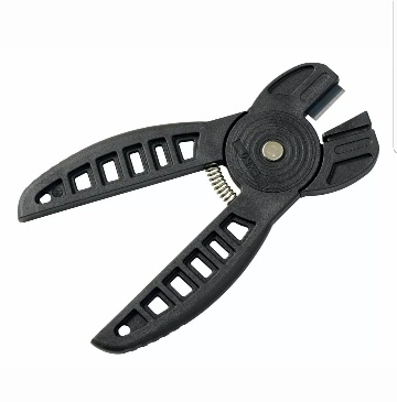

I thought that i would try the plank bending tool so i decided to order one.
Now ive several videos and its basically simple to use.
But after it arrived and decided to try it im disappointed as to me it is feels rather flimsy and unstable the plastic isnt very thick and it seems to have no rigidity once i try it..
Do all these tools feel the same or it it just this one..

I have several versions of this tool by different manufacturers but to be honest i never use them.
I find them to big to hold comfortably as i have fairly small hands.
When i do need to use something like this i resort to a set more like a small pair if pliers as as i get my “tiny mits” around the handles easier.
Model expo is one brand they appear under and while this link is NOT a recommendation as that is down to you to seek out your best price, if you want to see what they look like have a look at this ebay code.
333064613823 192559658278
As regards that pair you have you will find the screw holding the 2 halves together is prone to bevoming loose so you may need to tighten that up

I take it that metal the ones on ebay are a lot more sturdier than these plastic versions....
The make is modelcraft but they do feel cheap and at £8 they aint cheap...
When i squeeze them together they bend under the pressure.....

I have a model expo pair and they are just like your usual small hand tools (nippers, pliers and the like)
One blade if you could call it that is a square section flat anvil section about 6mm across.
The other blade is just that, a blade, but not razor sharp but sufficient to crimp the plank.

I've used them, there ok if you only apply little pressure.
But I steam my planks now its makes bending planks so much easier.
you just need one of these
Yep a food steamer cheep easy to use, just place planks in the try and steam for 15mins.
