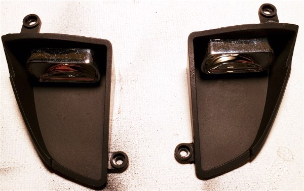

1) Take parts 1-B (Right Headlight Housing) and 1-C (Left Headlight Housing) Paint it in Tamiya XF-1 Flat Black Paint(my preference, you may have your own) This will give the area a flat finish and enhance the chrome headlight housings.

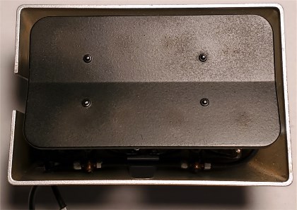

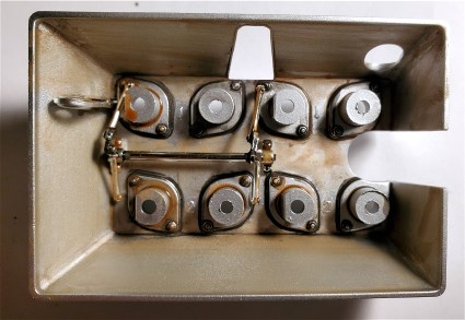

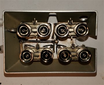

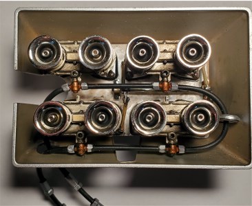

Stage 2 The Carburetors
For Part 5A. I added Tamiya Black Panel Liner in the recesses and gasket bases. Then mixing Tamiya Brown Panel Liner into the Black and touched op some more recess areas. Take a paint brush and lightly brush the interior walls with a little Tamiya Brown Panel Liner. Let this sit and dry. Insert the throttle arms and add a little more Brown Panel Liner to the recesses. Install the carburetors, and add a little Black Panel Liner to the recesses. Paint the rectangular boxes (between the diaphragms) a Tamiya Titanium Gold, then let dry. Insert the diaphragms as shown. The add the fuel lines as shown. Where the fuel line attached to the carburetor, paint that are a brownish copper (Tamiya Metallic Brown). Add a small drop (via a thin brush) of Black Panel Liner into the diaphragm recess. Let Dry. Then add the carburetor cover.

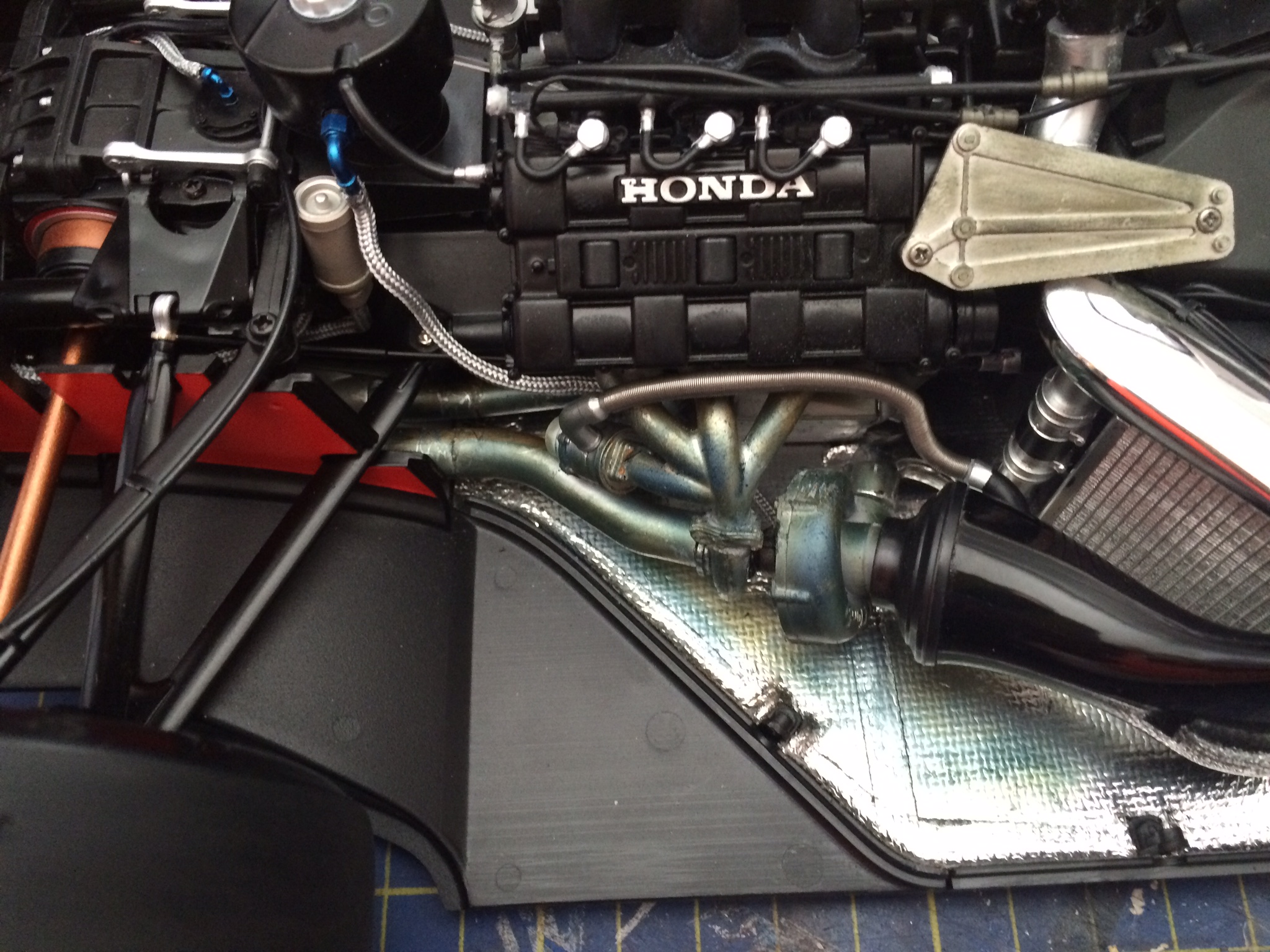

I did some similar weathering on the McClaren MP 4/4
