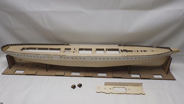

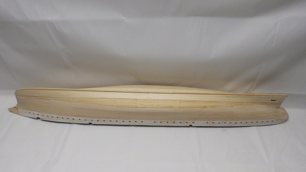

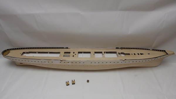

Imperial Yacht Standart, Pack 7, Stages 58-67.

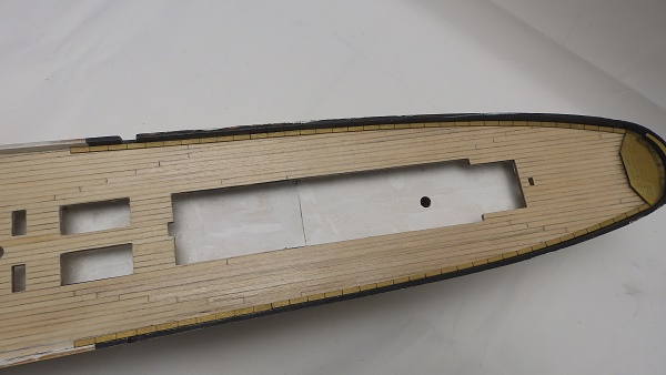

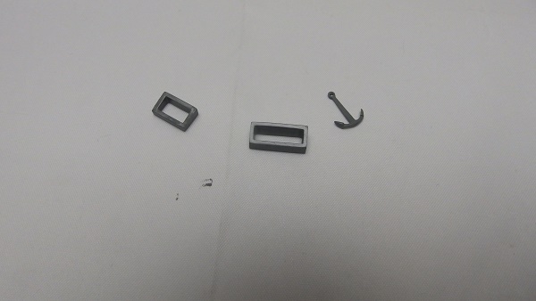

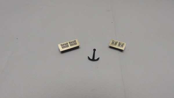

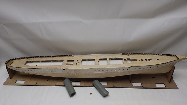

Stage 58
Stage 58 contents:-
Wooden strips, hatches and an anchor.

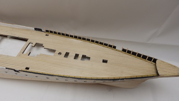

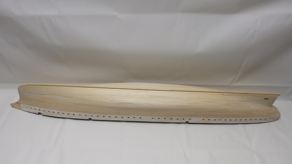

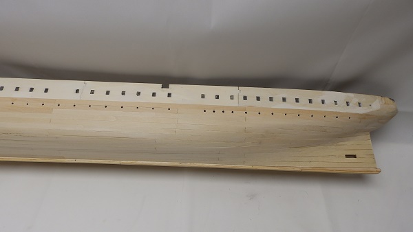

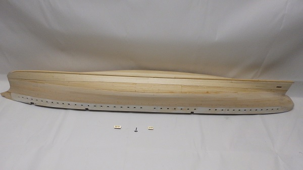

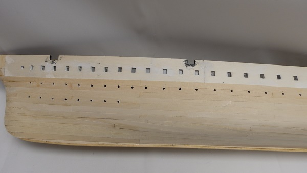

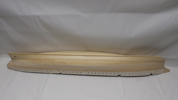

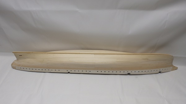

Take a strip and lay it next to the keel at the bow the end of the strip should be in line with the bow bulwark access. Complete the first row then lay a second row keeping the joint stagger the same as the upper planking. Add a third row noting that at the stern there will a wedge shaped gap. When the glue is dry trim the excess planks at the bow and stern. Repeat the above stages on the other side of the hull.
Take the two hatches and the anchor and clean any burrs off them then paint them with undercoat. Paint the anchor black then paint the hatches brown. Remove the two skylights from the fret supplied in stage 56 and prepare them in the same way you have the other skylights. Glue the skylights to the hatches.
Stage complete.
Store any unused parts in a labelled bag for future use .
#2 Posted : 12 November 2019 13:08:50

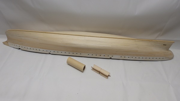

Stage 59
Stage 59 contents:-

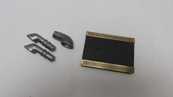

Wooden strips and a vent.
Measure the length of the keel and mark the half way point on the hull between the strips already laid. Next take a wooden strip and make a mark at its halfway point. Line up the mark on the strip with the mark on the hull and place it on the bulwark edge of the strips laid. Note the ends of the strip should touch the plank below leaving a thin wedge shape in the centre.
Take another strip and place its end at the mark on the hull and lay it towards the bow. The strip end will make contact with the strip below it again leaving a wedge shape. Lay another plank on that row towards the stern again leaving a wedge shape. Start row three by lining up the plank ends with the first one laid.
Continue adding another plank forward noting that this plank will need to be chamfered where it meets the plank below it. Lay the next plank on the row towards the stern again chamfering it where it meets the plank below it.
Next fill all the wedge shaped gaps and any other gaps in the planking until the planking is complete on that side. Repeat all the steps above on the other side of the hull.
Stage complete.

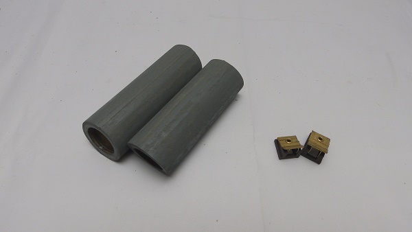

Funnel fret, crane and davits.

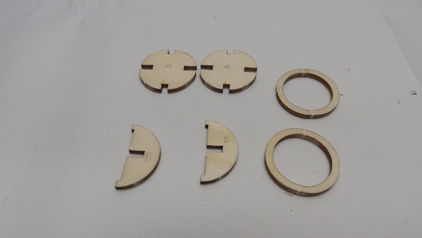

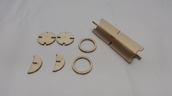

Take the funnel fret remove the parts and sand them smooth. Then assemble it in the same way you assembled the other funnel.

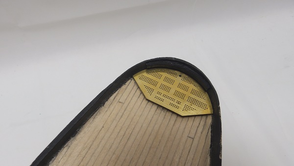

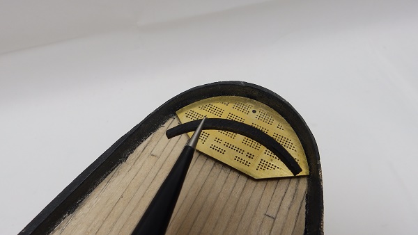

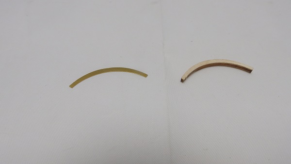

Retreave the fret from stage 20 and remove the crescent shaped part sand it smooth and then undercoat it and afterwards paint it black. Glue the part above the brass piece at the stern. From the brass fret from stage 53 remove the crescent shaped part. Clean it up and glue it onto the crescent shaped piece you just fitted to the stern.

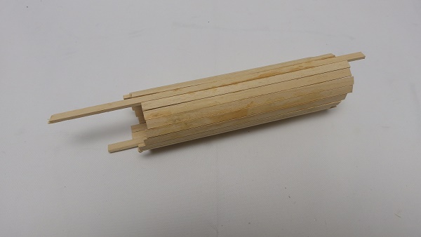

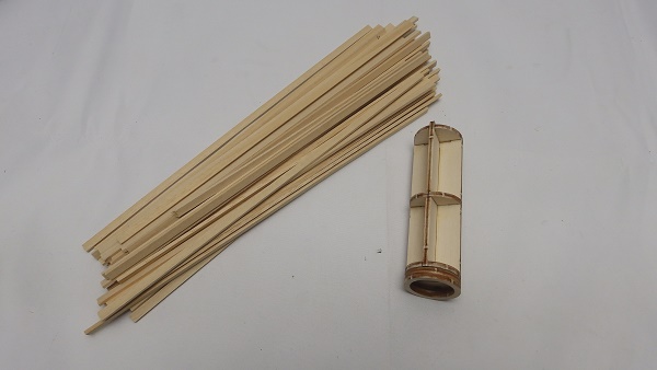

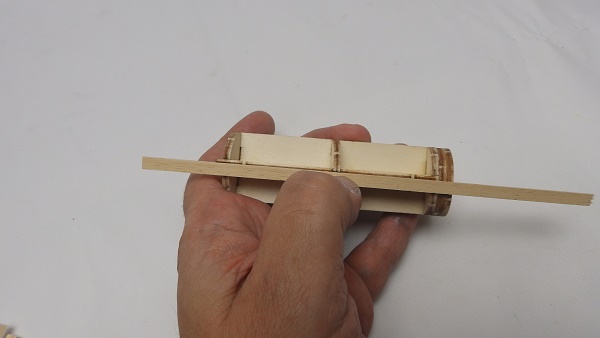

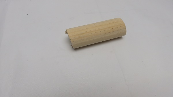

Take the funnel you made in stage 54 and sand it smooth. Next take 2 x 5 x 250 strips and lay the first one half way across the cross piece of the funnel. Continue adding more planks until the funnel is clad in wooden strip. When the glue is dry trim the excess strip from the two ends of the funnel making sure you do not damage the two locating lugs at the base of the funnel. Sand the strips flush with the ends of the funnel.
Stage complete.

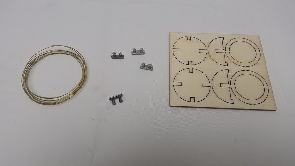

Funnel fret, cleats and brass wire.
Remove the funnel parts, sand them smooth and assemble them in the same way you made the first one. Now plank the funnel like you did the other and remove the excess from the ends.

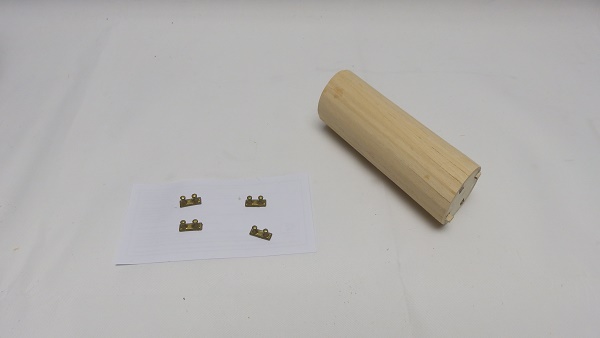

Take the cleats and remove any burrs from them then undercoat them and when dry paint them with brass paint.
Stage complete.

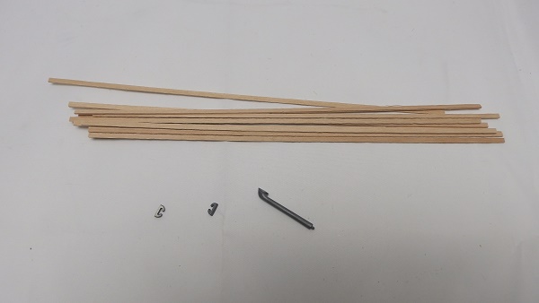

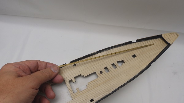

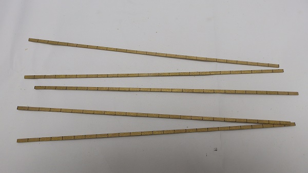

#5 Posted : 13 November 2019 12:40:11
Stage 62
Stage 62 contents:-

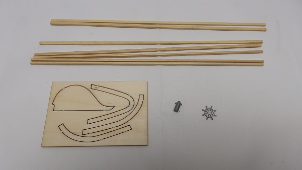

Wooden strips, fairleads and a vent.

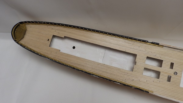

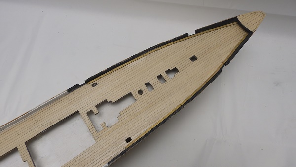

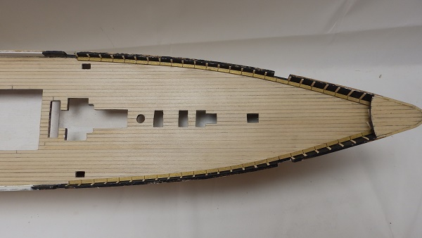

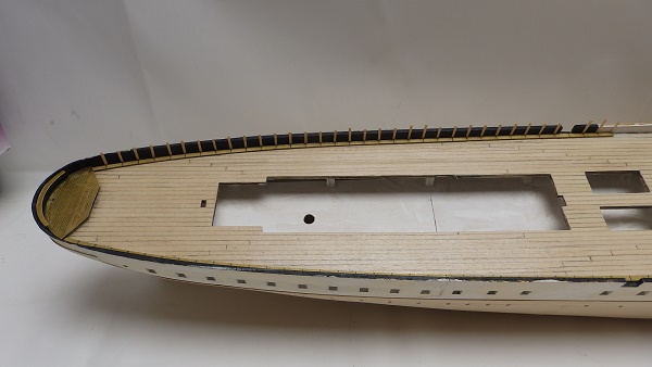

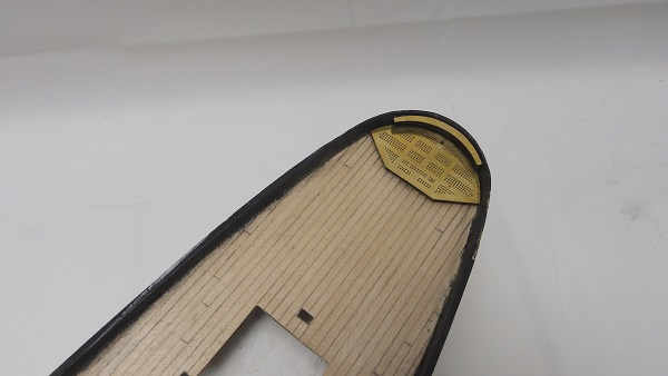

Take five of the wooden strips supplied with this stage, smooth them with sand paper then paint them with brass paint. When dry mark lines at 10mm intervals along the strip. Take one of the strips and cut the end to match the angle of the bow deck bulkhead then glue it in place following the curve of the bulwark towards the stern. The end of the strip should end at the second opening along the bulwark. Repeat the above on the other side of the bow.
At the stern add more strip along the bulwark finishing 15mm past the gap in the bulwark. Repeat the above on the other side.

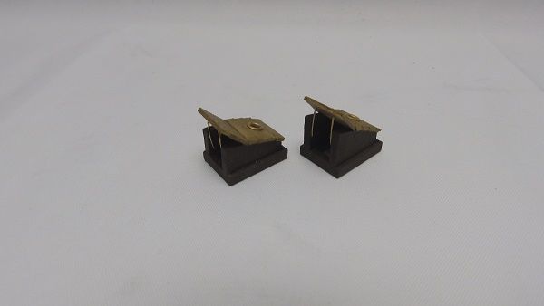

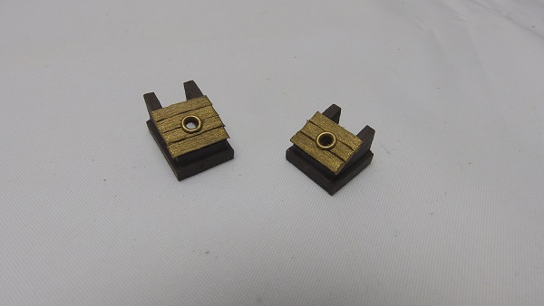

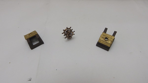

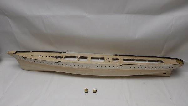

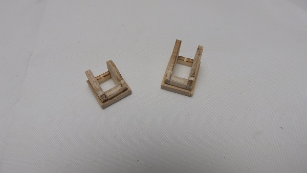

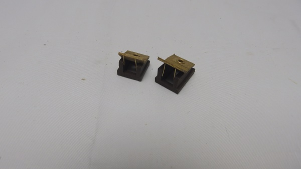

Take the hatches assembled in stage 35 and add wooden strip to three sides then sand it smooth and paint it brown. Paint a 1 x 3 wooden strip with brass paint when dry add three strips across the small hatch and four more across the larger hatch. When the glue is dry drill a 3mm hole in the centre of each hatch and add a porthole from stage 52 into each hole.
Stage complete.

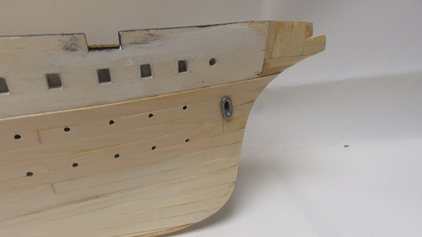

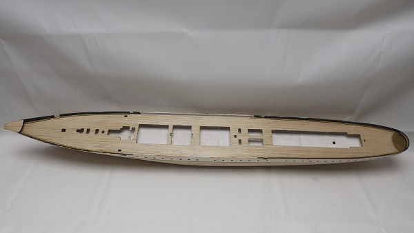

Open up all the portholes you marked the positions of on the hull being careful not to damage the plastic lining the bulwarks.
Take the left over 0.6 x 3mm deck planking and cut it into 10mm long lengths, then cut the strips just cut in half along the length. Now glue the strips prepared in the last step onto the inner bulwarks in line with each mark along the brass strip. Add more strip at the stern brass plank and when the glue is dry trim them and sand them smooth to the tops of the bulwarks.

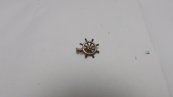

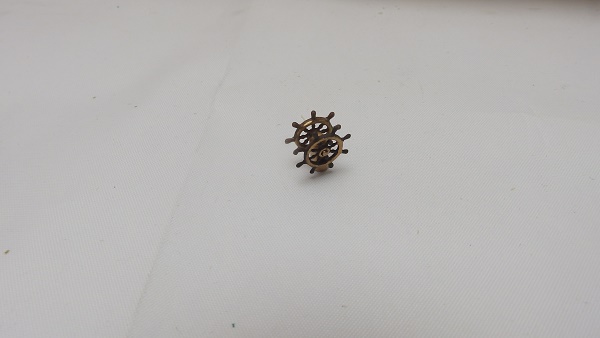

Remove any burs from the wheel and pedestal then paint the wheel to match the other one from stage 4 the same colour. Then paint the pedestal brass and glue the two wheels to it.
Take the two hatches from stage 38 and assemble them in the same way you made up the two hatches in the last stage.

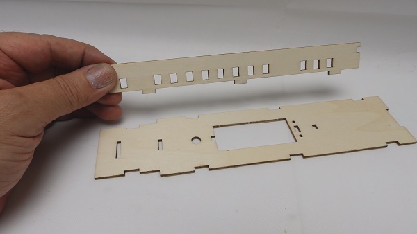

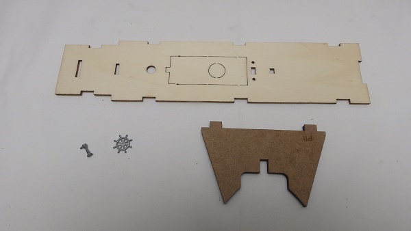

#7 Posted : 13 November 2019 16:13:38
Stage 64
Stage 64 contents:-

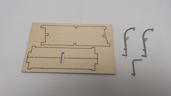

Superstructure fret, stand, pedestal and wheel.

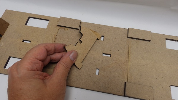

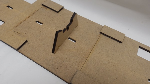

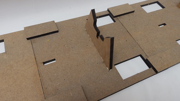

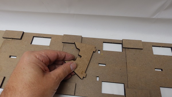

Glue the support R11 into the work stand base.
Clean any burs off the pedestal and wheel and paint them in the same colours you painted the others then assemble them.

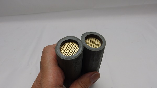

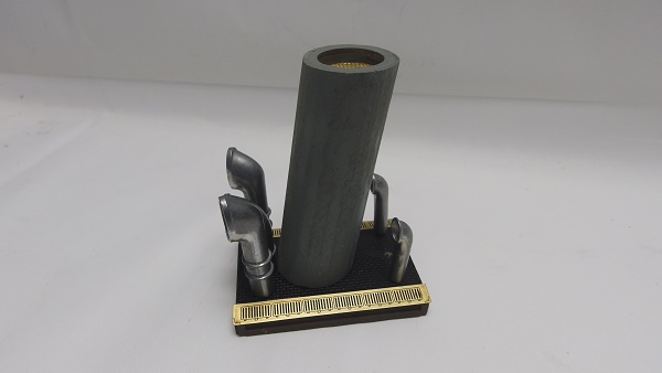

Take the two funnels and fill any gaps with your chosen filler. Then sand them smooth with sandpaper. Apply a coat of undercoat to the funnel then smooth it again and repeat until you get a smooth surface. Do the same with the other funnel.
Make up the two hatches from stage 40 in the same way you have assembled the others.
Stage complete.

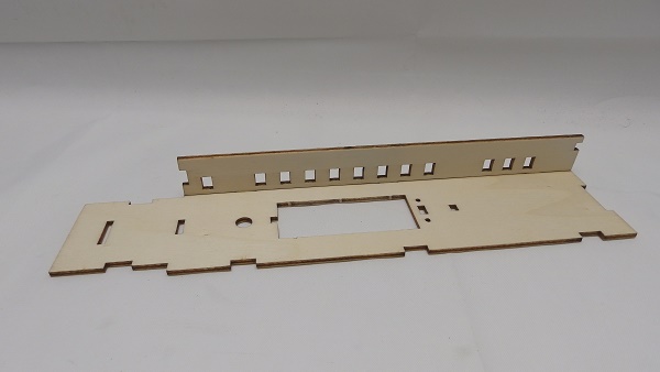

#8 Posted : 13 November 2019 17:10:33
Stage 65
Stage 65 contents:
- Work stand support, etch, davit and a crane.
Glue the work support R12 into the slot in the work stand.

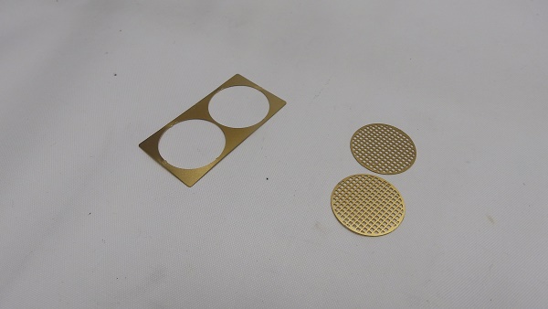

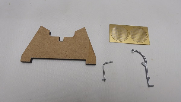

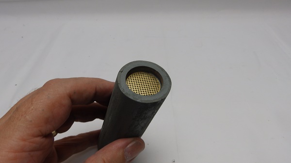

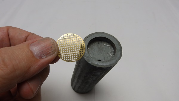

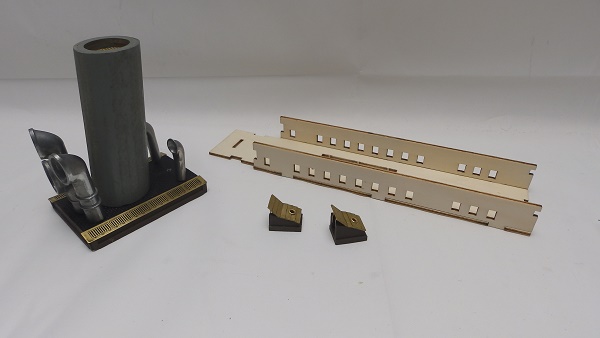

Remove the two funnel screens from the fret smooth any edges then glue them into the tops of the funnels.

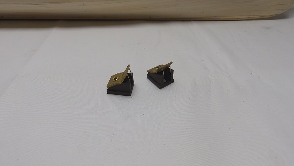

Retrieve the two hatches you made up in stage 62. Make up the hatch lids from brass painted strip then glue them in the open position using brass wire from stage 61 to make the lid supports.
Stage complete.

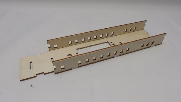

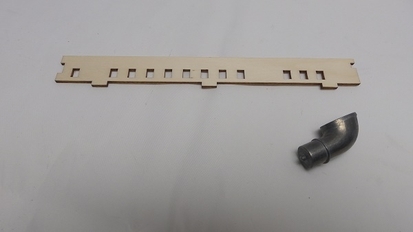

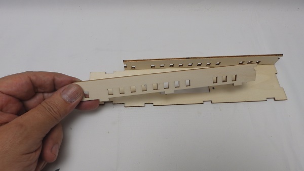

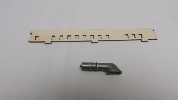

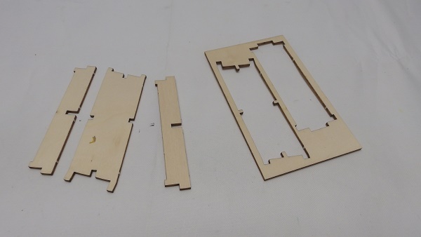

Take the superstructure from stage 64 and remove the centre section. Take the bulwark from this stage and glue it to the superstructure side making sure all is square.
Take the two hawsers from stage 41 . Measure and cut the holes for them at the bow and then glue them in position.
Take the two hatches made up in stage 63 and make them up in the same way you did in the last stage.
Stage complete.
#10 Posted : 13 November 2019 18:03:53
Stage 67
Stage 67 contents:-
Bulwark and a vent.
Attach the bulwark from this stage to the superstructure you started in the last stage making sure all is square to each part.
Take a boiler room and measure and fit the vents to it. Test fit them only for now do not glue them in place.
Prepare more roofs and stays and fit them too the last two hatches.
