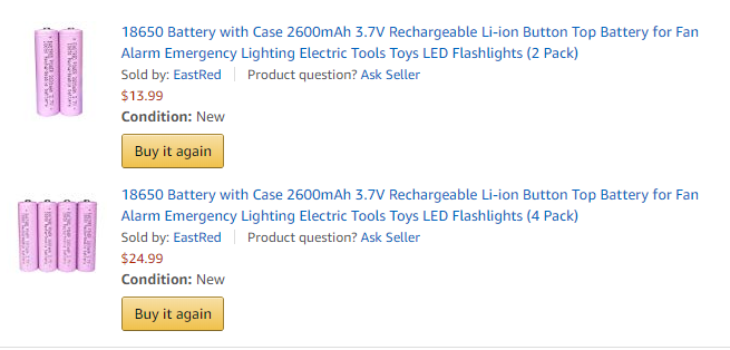

I started with the TS guide. The batteries are 18650 3.7v 2600mAh rechargeable Li-ion batteries bought from Amazon - they look just like the ones in the magazine. When I put them in they all registered "FUL" on the tester. SO should I try recharging them inside of R2 or what is my next step?

First check that they are unprotected batteries. You must individually charge the batteries in the supplied charger first before placing them into R2’s. It is very unusual that they would be fully charged when bought. This usually takes a several hours to get the batteries in the same state.

I did test and charge them before I put them in. According to the info when I bought them, they are unprotected. Is there any way to verify on the batteries themselves since they are no longer listed on Amazon (red flag there)?
