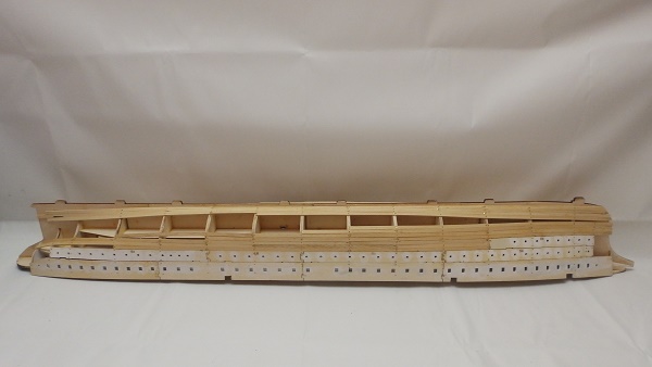

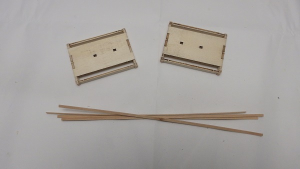

Stage 37

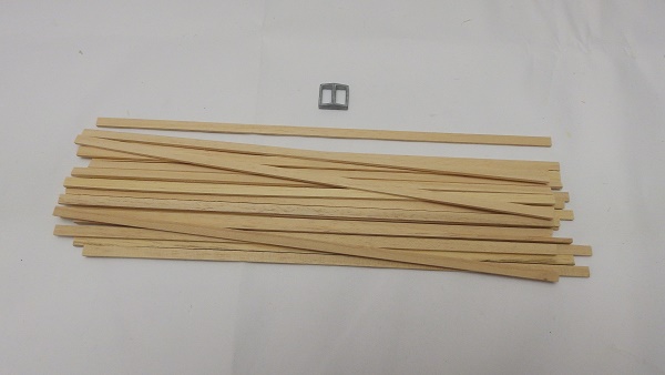

Stage 37 contents:-
 Wooden planking and wooden strips.

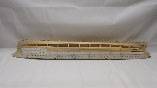

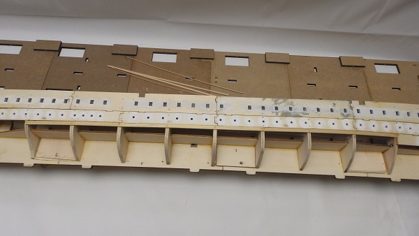

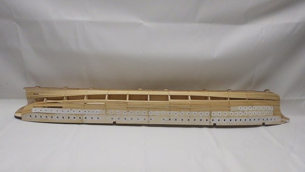

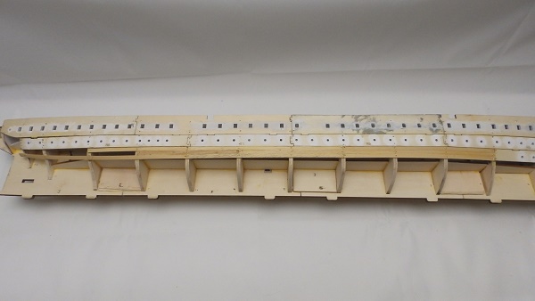

Place a 2 x 5 x 250 planking strip at the rear of bulwark 'A9' frame 5, mark the strip where it passes half way over frame 8 and cut off the excess wood. Glue the plank in place and fix it with pins. Lay more planks next to one just fitted between frames 8 and 11 then finish off the run by fitting a plank between frames 11 to 13.
Lay a new plank below the one just fitted and fit it between frames 5 to 7. Continue laying planks along the run laying them between frames 7 to 10 and then frames 10 to 12.Place a third row of planks following the sequence used in row one but taking the plank to frame 15. Repeat these step on the other side of the hull.

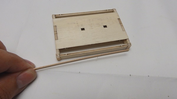

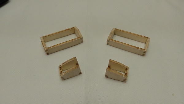

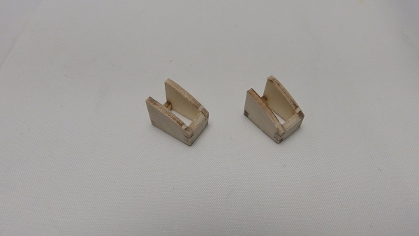

Take the two boiler rooms you constructed in earlier stages and the the four 1 x 3 x 250 strips provided with this stage. Take a strip and fit them around the bottom edge between the corner pieces you fitted earlier of each boiler room.
Stage complete.
Store any unused parts in a labelled bag for future use .

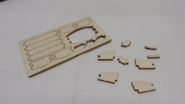

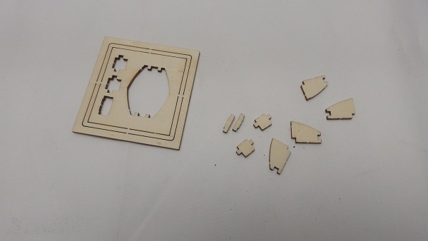

Stage 38
Stage 38 contents:-

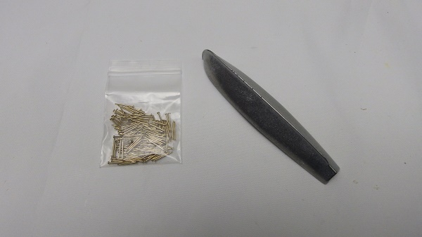

Parts fret and nails.
Take the fret and remove the hatches and assemble and glue both of them. When dry sand the assembled hatches flat like you did with the other hatches previously made. Make sure you save and store the fret as it has parts to be used in a future stage.
NOTE- When you are planking one side of the hull to complete a stage the other side of the hull is planked in the same way so both sides are a matching assembly.
Next on any side of the hull glue a strip between frames 4 to 7 making sure the strip is only half way across frames 4 and 7. Glue another strip between frames 7 to 10 and to end this run another strip between frames 10 and 11.
At the bow from frame 4 add another strip making sure it goes past the bow by a minimum of 1mm. Add another strip from frame 5 forward below the one just fitted. Working backwards on the plank just fitted glue a strip between frames 5 to 8 and then frames 8 to 10. Add another strip in this row from frame 10 to 13 making sure the plank follows the curve of the hull and its end butts up to the plank already fixed to frame 13.Repeat these step on the other side of the hull.
Stage complete.
#3 Posted : 08 September 2019 19:39:29

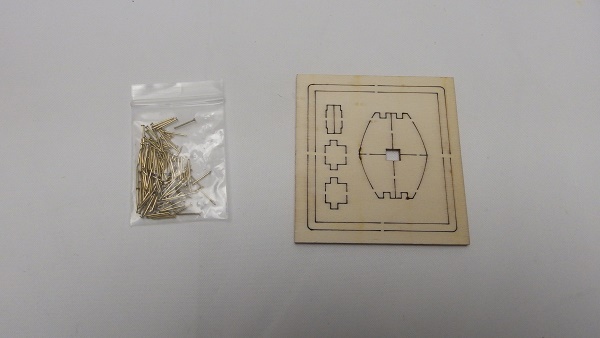

Stage 39
Stage 39 contents:-

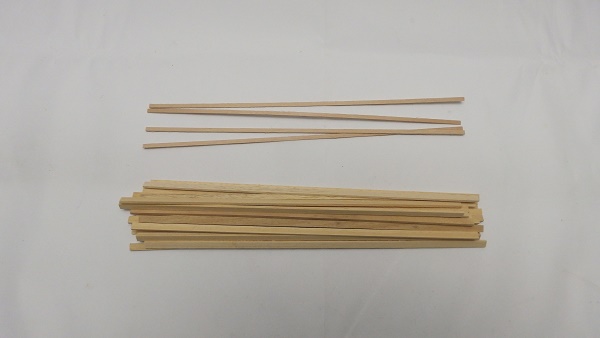

Wooden strips and a hatch.

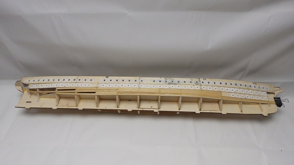

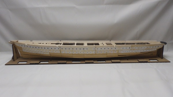

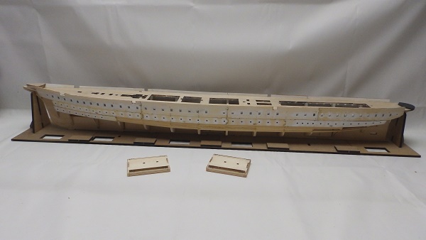

Continue adding strips to the hull starting with a strip between frames 4 to 7 then add another plank forwards to the bow. Now fix a strip from frame 7 to 9. Take another strip and fix it from frame 12 rearwards filling the gap you left when the plank above it was fixed in the last stage. When the strip is dry trim it at the end of frame 16.
Next add another strip against the keel between frames 5 and 8 then add another from frames 8 to 11. Draw a pencil line 10mm down at the stern end of the keel. Now lay a strip from frame 11 glueing and nailing it as you go backwards the end of the strip should be in line and glued below the 10mm mark. Use clamps to hold the strip in place.
At the bow fix another strip from frame 6 forward the strip should be in line with the bottom of frame 3. Clamp the strip at the bow until the glue has dried. Add two planks rearward to frame 12 from the last one you fitted. Now at the bow fit another strip above the one just fixed nailing and glueing as you work forward . Clamp the strips at the bow to hold them in position. Repeat these step on the other side of the hull.
Stage complete.

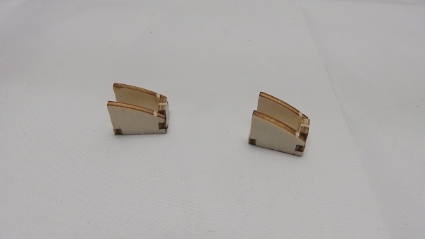

#4 Posted : 11 September 2019 18:13:00

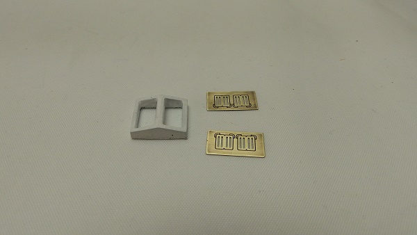

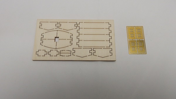

Stage 40
Stage 40 contents:-
Parts fret and skylights.

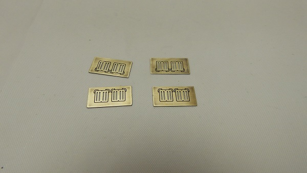

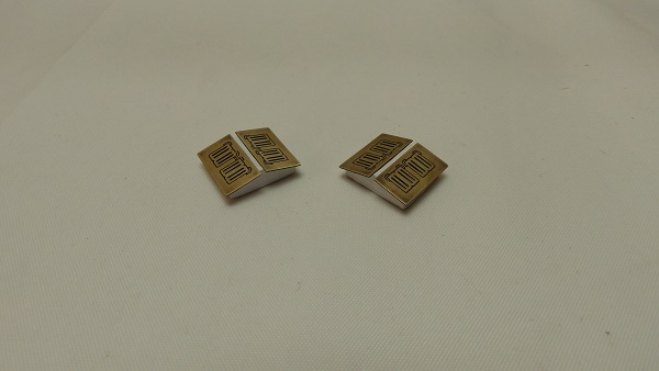

Take the parts fret and remove the hatches parts, assemble the two hatches then smooth the sides with sand paper to match the curved edge and the joints.

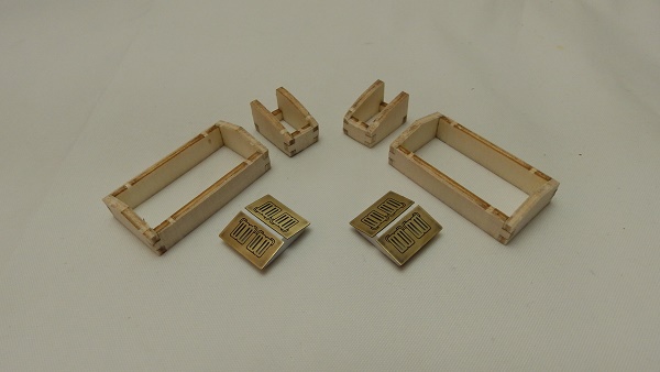

Next remove the remaining parts from the fret and make up the two skylights again smoothing off the surfaces when dry and making sure the roof parts match the sides.
Take the hatch from stage 39 and the one included with stage 23. Clean and smooth the hatch from stage 39 and then paint it white to match the other hatch. Take the etch parts from this stage remove them from the etch fret and remove any burrs. As you did in stage 33 use burnishing fluid to blacken the four parts then remove the excess to reveal the details on the parts.
Glue the skylights to the two hatches leaving a gap of 1mm along the central apex.
Stage complete.

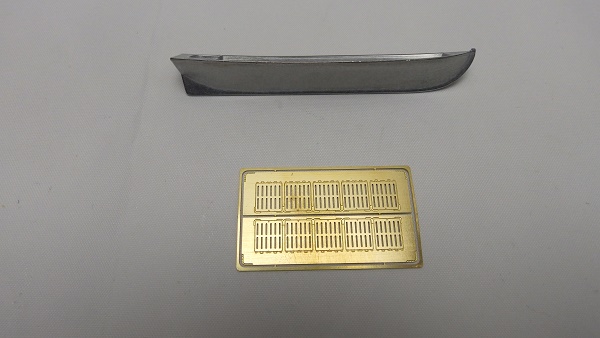

#5 Posted : 14 September 2019 19:20:22
Stage 41
Stage 41 contents:-

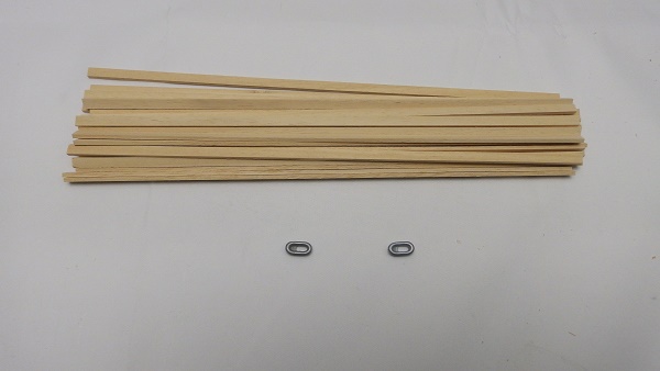

Wooden strips and hawse pipes.

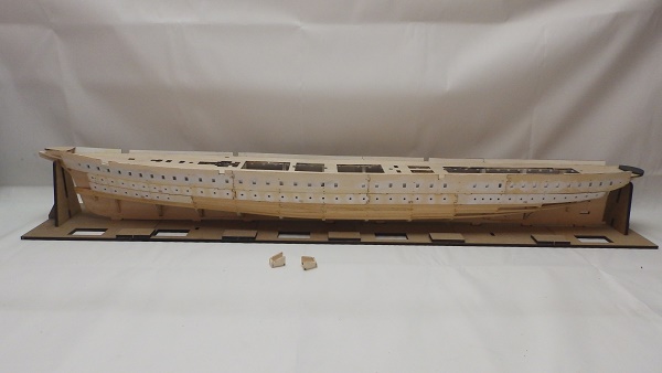

Glue and nail a strip next to the two keel rows already laid. The strip should go half way across frame 5 forward leaving an overhang of 2mm at the bow like before. Add more strips to the row 5-8 and 8-11.
Next finish off keel row 2 at the stern making sure to clamp the strip at the stern post. When this strip is dry remove the strip that is covering the oblong hole in the stern. Now finish off row three back to the stern. Begin a fourth row at the stern starting halfway across frame 4 continue to add strips at 4 to 7 the 7 to 10. Repeat on the other side of the hull.

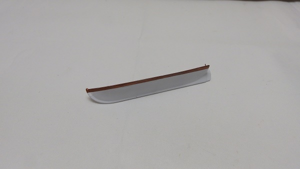

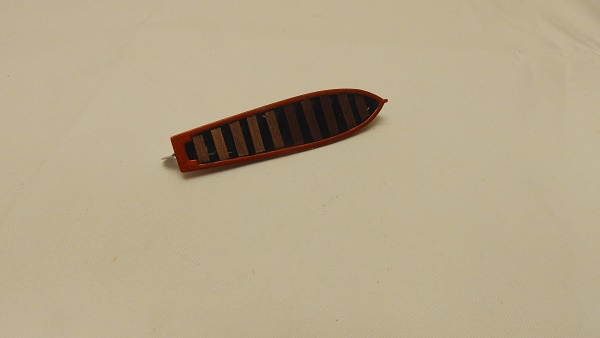

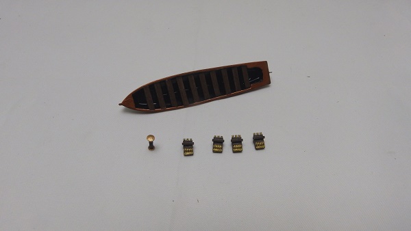

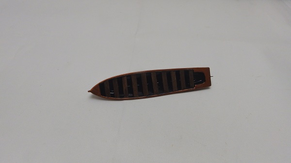

Clean up the boat you got in stage 35 and add the rudder from the etch boat parts fret to it. Paint the boat in the same way you have painted the other boats then add the stained wooden strips to the inside.
Stage complete.

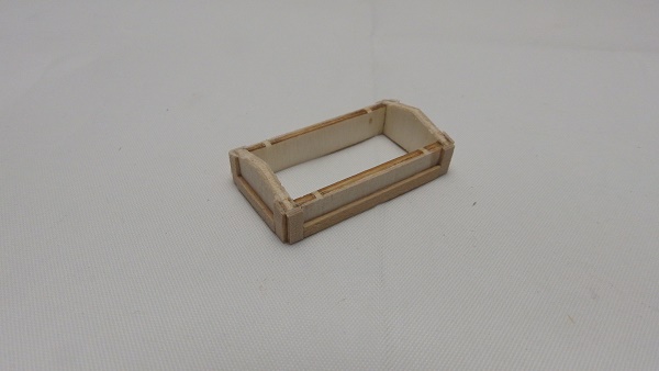

Stage 42
Stage 42 contents:-
Boat and skylights.

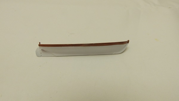

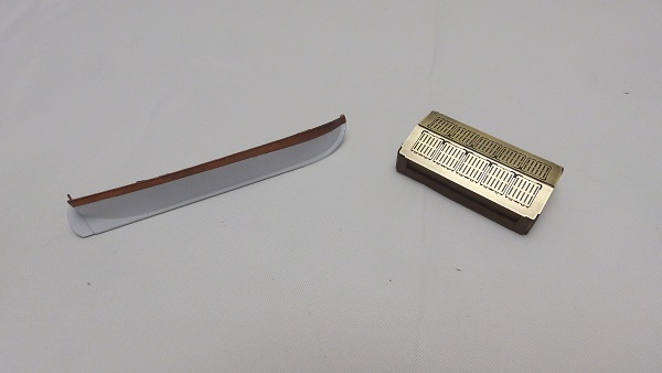

Clean up the boat and add the rudder then paint it in the same way you have painted the other boats then add the wooden strips to the inside.

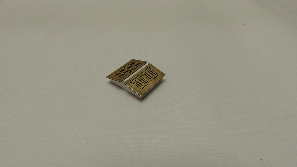

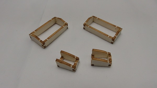

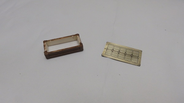

Take the hatch from stage 40 and add 1 x 3 mm strips to the corners and sides in the same way the boiler houses were done. When dry either stain or paint the skylight with brown paint.
Next take the skylight fret received with this stage and prepare it in the same way you prepared the other brass skylights. Bend the skylight to fit on the hatch you just painted and glue it in position .
Stage complete.

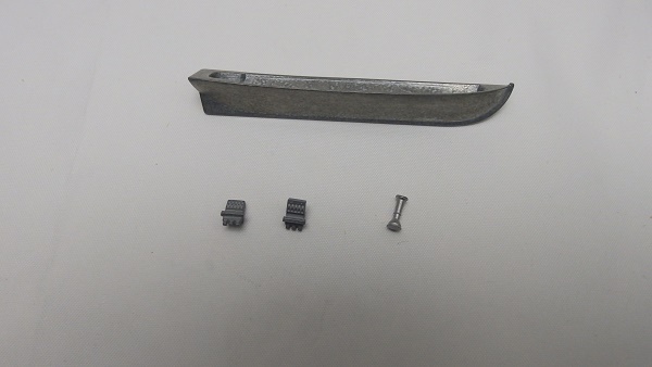

Clean up the boat and add the rudder then paint and add the wooden details as you have with the other boats. Take the mast details and paint them brown and then paint the details brass. Next paint the compass the same way you painted the binnacles.

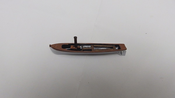

Boat and nails.

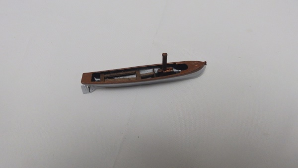

Clean up the boat and paint it in the same way you painted the other boats add the wooden interior detail as shown then glue the propeller and chimney prepared in stage 25 to the inside of the boat.
Stage complete.

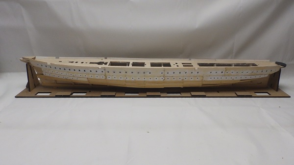

#10 Posted : 15 September 2019 15:47:57
Stage 46
Stage 46 contents:-

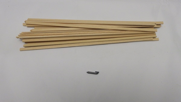

Wooden strips and a ventilator.

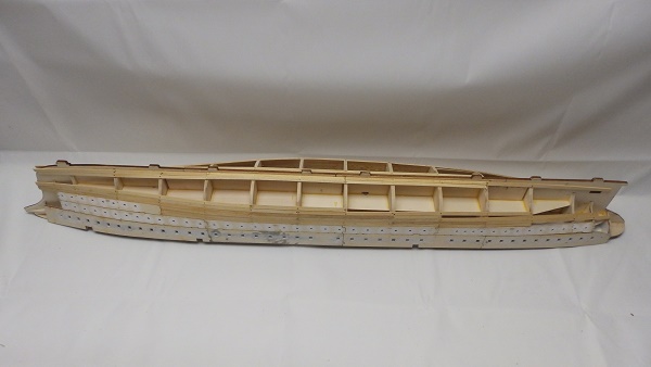

Finish row 4 from Frame 10 to 13 then 13 to the stern post. Take some off cuts and fill the gap between frames 15 and 16 working upwards when you get to the bulwarks trim and fit the planks to fit. Repeat on the other side then trim any overhanging planks flush with frame 16. Add 3 more short strips to finish the plank runs on planks already laid. Next finish the 6th row of planking from frame 9 to 13 and frame 13 to the stern post.
Like you did at the stern use short planks to fill the gap at the bow forward of the lower 2 fitted bulwarks . Start at the bottom and work your way up trimming the last plank to fit under the upper bulwark. When the glue is dry trim back the over hanging planks at the bow to the false keel.
Stage complete.
