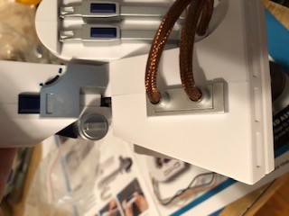

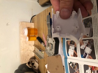

has anyone had problems fitting the ankle fitting in the ankle reason I ask is I am having trouble getting the ankle fitting to lock in on the ankle part from stage 47 for the left leg the parts fit fine for the right leg, how do I get the
parts to lock in without widening the hole. thank you

If you can show some pictures of the parts you are trying to fit please so I can take a look. Have you looked at the official build diary photos for reference. I wait to here from you.

I could but there is really nothing t0 show that page 15 of issue 55 part 9 says
to do it's that only one of tabs will fit but not the other one and that is for
both of them
Ronald
ronald305 attached the following image(s):

Maybe an obvious question but have you checked and double checked you have the correct part that is causing the problem?

HI mark
I just sent you two photos of the parts notice they will not snap in place only the ones nearest the open will not snap in
Ronald

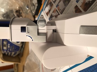

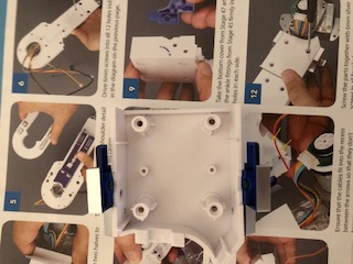

I may be doing something wrong on this leg the right legs went fine assembly
wise the whole thing can get a little confusing sometimes
Ronald

enclosed are two photos of the right leg ankle assembly that is the way they are
suppose to look right
