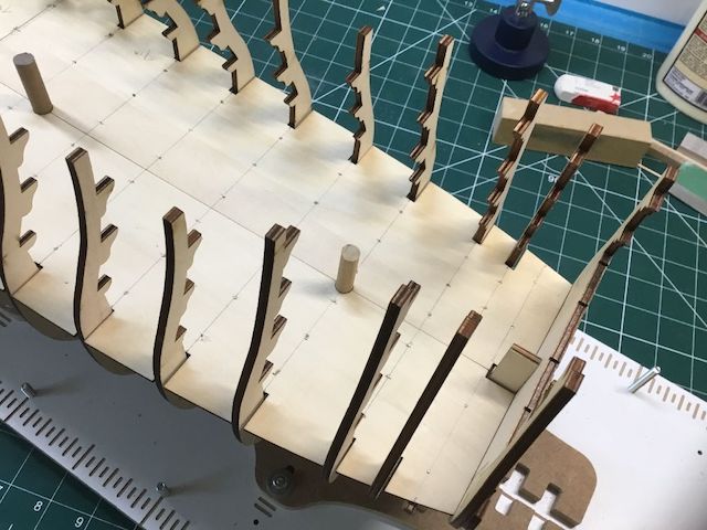

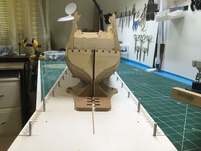

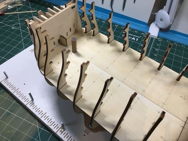

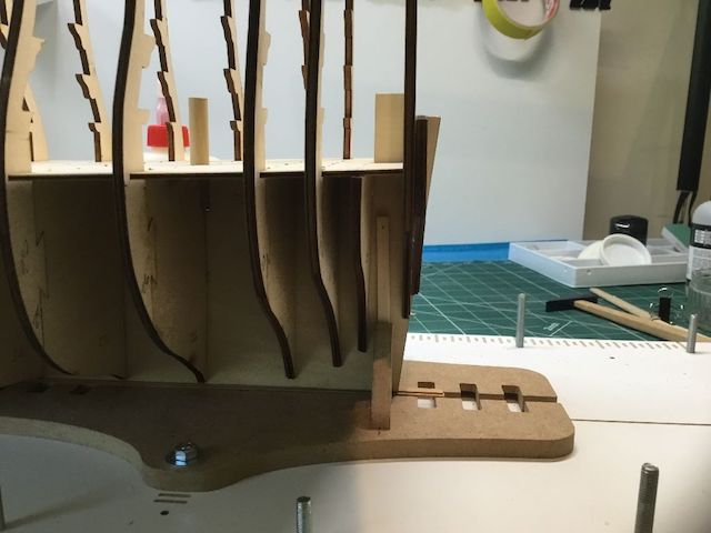

I have reached the point in the Victory build where I have dropped all of the bulkheads into the keel section and pinned down the lower decking. I turned the frame over to apply the watered down glue and immediately noticed that the bottom of frame 15 does not reach the bottom of the keel whereas all the other bulkheads do. When I was assembling the hull, all the bulkheads sat nicely flush with the top edge of the keel sections so I know they are all seated correctly and the 'legs' of all the bulkheads align to allow the deck side beams to sit nicely in the recesses. but if I deepen the keel or bulkhead slots at 15, the upper bulkhead legs will be misaligned.
My question is, do I glue strips of timber to the edges of bulkhead 15 and then sand them down when I begin fairing the hull? I do intend adding balsa wood packing between each bulkhead at front and rear as well, so this may help.
I appreciate that this subject has probably been discussed previously but some guidance would be appreciated. Thanks.

Hi Goddo, can you post up a couple of pics so I can see along the hull. Would like to see the outer and inner hull if possible. I wish to see how far out we are before advising on the best course of action to put it right....

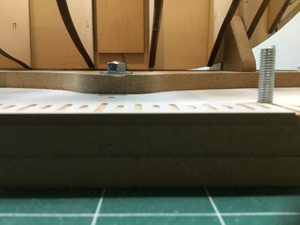

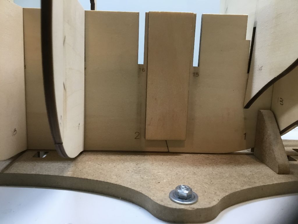

In the first photo, it looks as if the stiffener plates across the joint are proud of the top of the keel but that is just the angle of the photo. The stiffeners are sanded flush.

#7 Posted : 27 June 2019 19:48:40
Hi Goddo, great to see you got the attaching pics problem sorted out albeit they are a little on the large side..... 650x480 pixels is the ideal size to use....
As for your build, looking at what you have posted I'd say everything is looking good to me. Your frames are all level with the top of the false keel which is exactly what they need to be. The bottom and outer sides of the frames will be dealt with when you get to the fairing stage of the build, some of the frames you may need to sand back and some you may need to add filling strips. During the fairing process you will lay a planking strip across all of the frames to assist in achieving a hull with smooth flowing lines, ie, no bumps or hollows. The instructions, official build and video build covers this process fully.
To help understand the fairing process fully here are a couple of links that you may also find useful...
https://forum.model-spac...spx?g=posts&t=19140
https://forum.model-spac...aspx?g=posts&t=5669
Hope this helps....Cool Cool

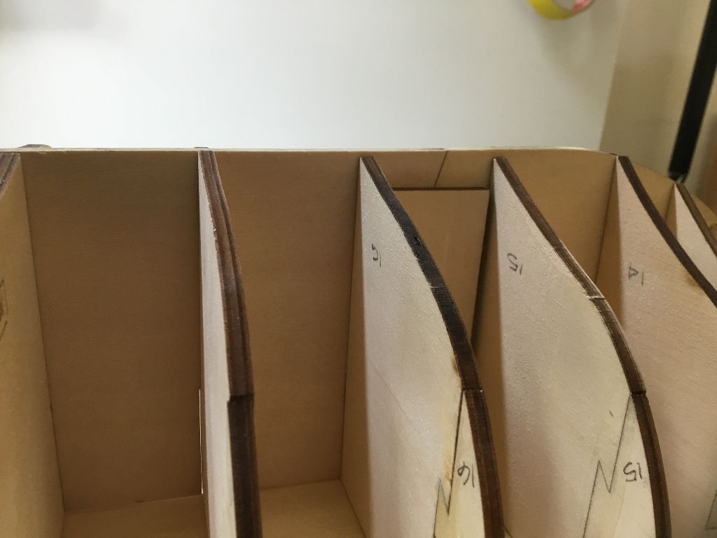

Here's another photo of the frames in place with keel upside down. I think you can see the discrepancy with frame numbers 15 & 16 in relation to the bottom of the keel. I feel that there will be a "dip" in the planking at this point. Your comments would be appreciated.
goddo attached the following image(s):
#9 Posted : 28 June 2019 11:08:12
I see what you are referring to but at this stage I'm still not seeing a problem.. It is quite common with these builds to find the odd frame sitting low and others high. It is likely you will need to build up the bottom of frame 15 and this is taken care of when you reach the fairing stage which I think starts at stage 20. Make doubly sure all of your stern frames are fully seated into the keel, it has been a common problem where the last frame moves when you turn the hull over and is not very apparent until you come to fitting the gallery. Once you have fitted the lower deck post up a pic of your stern looking square on.
Thanks for your reassurances Alan. I will post pics (of the correct size I hope!) when I have attached the stern frame sections.
As a matter of fact, when I again looked at the photos in the official build instructions (part 2) I noticed that frame 15 is not reaching the bottom of the keel on that model either.
Thanks again for all your advice and I will be back, I am sure, with more questions.

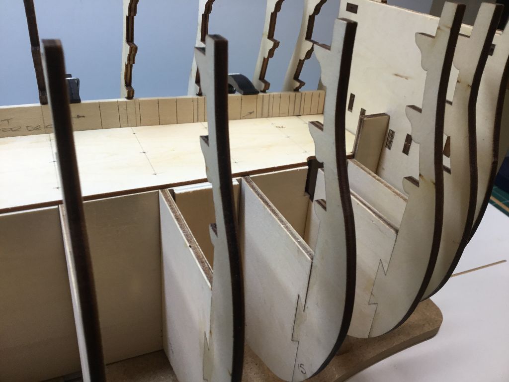

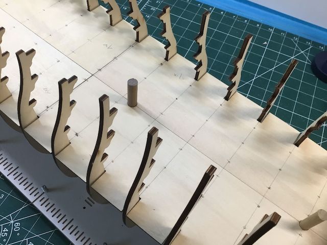

After all the advice regarding keel and bulkheads, particularly frame 15, I have reassembled the framework and replaced the lower gun deck. Progress pics below.
Lower deck in first three photos. Keel/stern bulkhead photos in the last two.
#15 Posted : 29 June 2019 23:56:51
Hi Goddo, from what I can see I would she she's coming along very nicely indeed. The stern looks good to and the final frames looks to be sitting in the correct position. Well done, keep posting and I'll keep looking in.....Cool Cool
