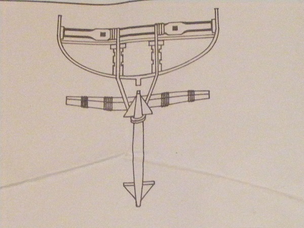

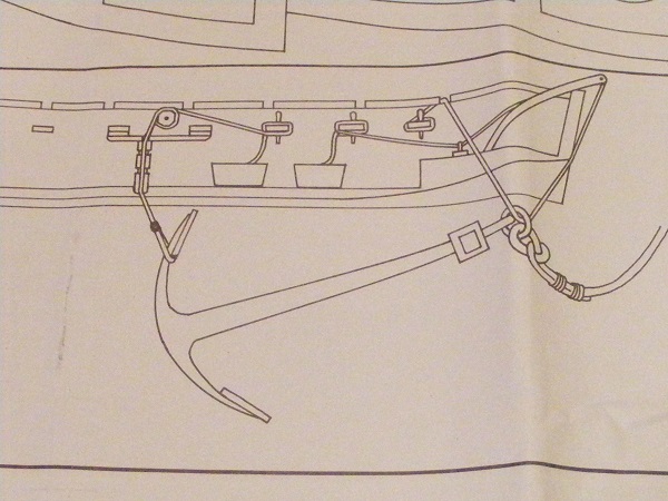

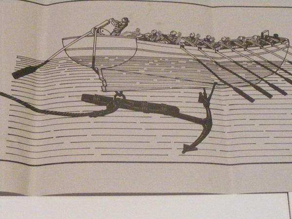

Many of us who have build the Victory or been interested in her history, will be well aware that the one of the main purposes of the launch was in setting and recovering Victory's anchors. What many may not be aware of was how the launch actually achieved this task, so I thought it would be good to post these pics showing how it was achieved. These have been taken from the plans of the Panart Launch I'm presently building.... Hope you find them interesting and informative.....Cool Cool

Very fascinating Alan, something I didn’t know. So Victory lowered its anchors to below waterline the launch then moved away from the hull so far before dropping it to give a better chance of staying put. Or am I wrong in this.

When a ship was becalmed, mastless, run aground or otherwise unable to move, a ship's boat provided a source of motive power. The ship's anchor and cable would be rowed a distance from the ship before being laid, the crew would then man the ship's capstans to haul the ship forward, known as kedging or warping, this would be repeated as many times as needed.

Bringing up an old thread... I'm currently building this one, but I'm perplexed by the stern gantry. I'm really not clear on how it was used. Is it simply a fixed arrangement to clear the transom, or do any of the bits move (like a davit) to lift the anchor with leverage?
If its purpose is to provide leverage, which of the contact points are glued/fixed? Do any of them slide fore and aft? It seems overly-complex to be just a fixed arrangement, so can someone explain exactly how it operates, and just as importantly, how it interacts with the rudder, as it appears to stop the rudder moving?
I also can't see how it was used just to set the anchor, as there is no way to slip the loops off the flukes or the head end the once the anchor is on the seabed (and the reverse is true for weighing anchor). The only purpose for the set-up as shown is kedging, as described.
Many thanks

I had a look through one of my ref books "Boats of Men of War" which had a single drawing from the 18th cent illustrating the recovery of a Kedge Anchor. It would appear that the stern gantry (called a stern davit) in the book, was simply a means to keep the rope attached to the buoy on the anchor away from the transom whilst the crew hauled it inboard. It does interfere with the tiller but the tiller was only used getting from the ship to the buoy, once there the tiller was unshipped and the davit placed in position in its place.
As for the loop around the fluke - absolutely no idea unless some clever nautical knot was used with a loose end which released the fluke when pulled? Never been any good with knots - a simple knot is the granny knot, complicated knots are more grannies tied on top!Blushing

I'm going to make the parts for the gantry/davit, but install the tiller for display, and stow the gantry parts aboard. I'll make an educated guess at which parts are permanently installed to accept the gantry elements. It may be that the parts are designed to be exceptionally strong, yet easily manhandled- it's easy to forget that this is no dinghy.
