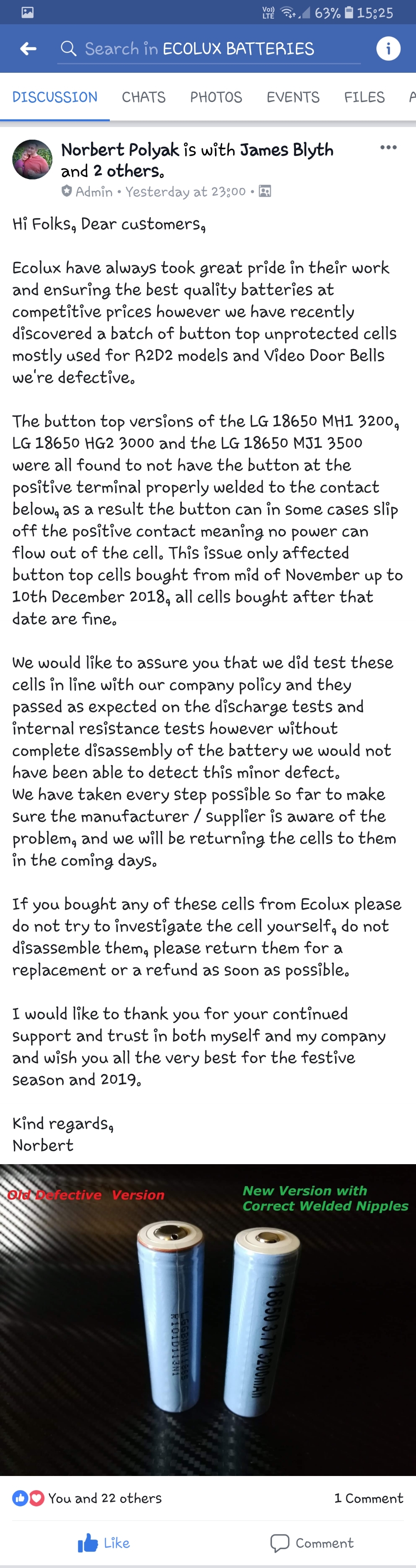

Do you mean recommended by Ecolux as Ecolux have not been recommended by either DeAg or ModelSpace. Suspect the batteries you have are not true button tops as highlighted by Semaj in post 12 onwards in this topic....
https://forum.model-spac...spx?g=posts&t=30393

#5 Posted : 21 December 2018 16:26:47
Joined: 05/03/2017
Posts: 531
Points: 1,710
Location: Midlands, UK
Message on ecolux faceboom page batteries are faulty

Appreciate the post..
Ive just checked and mine seem to be ok. They are the newer ones as I only ordered them 2 days ago, and have power to the unit.
