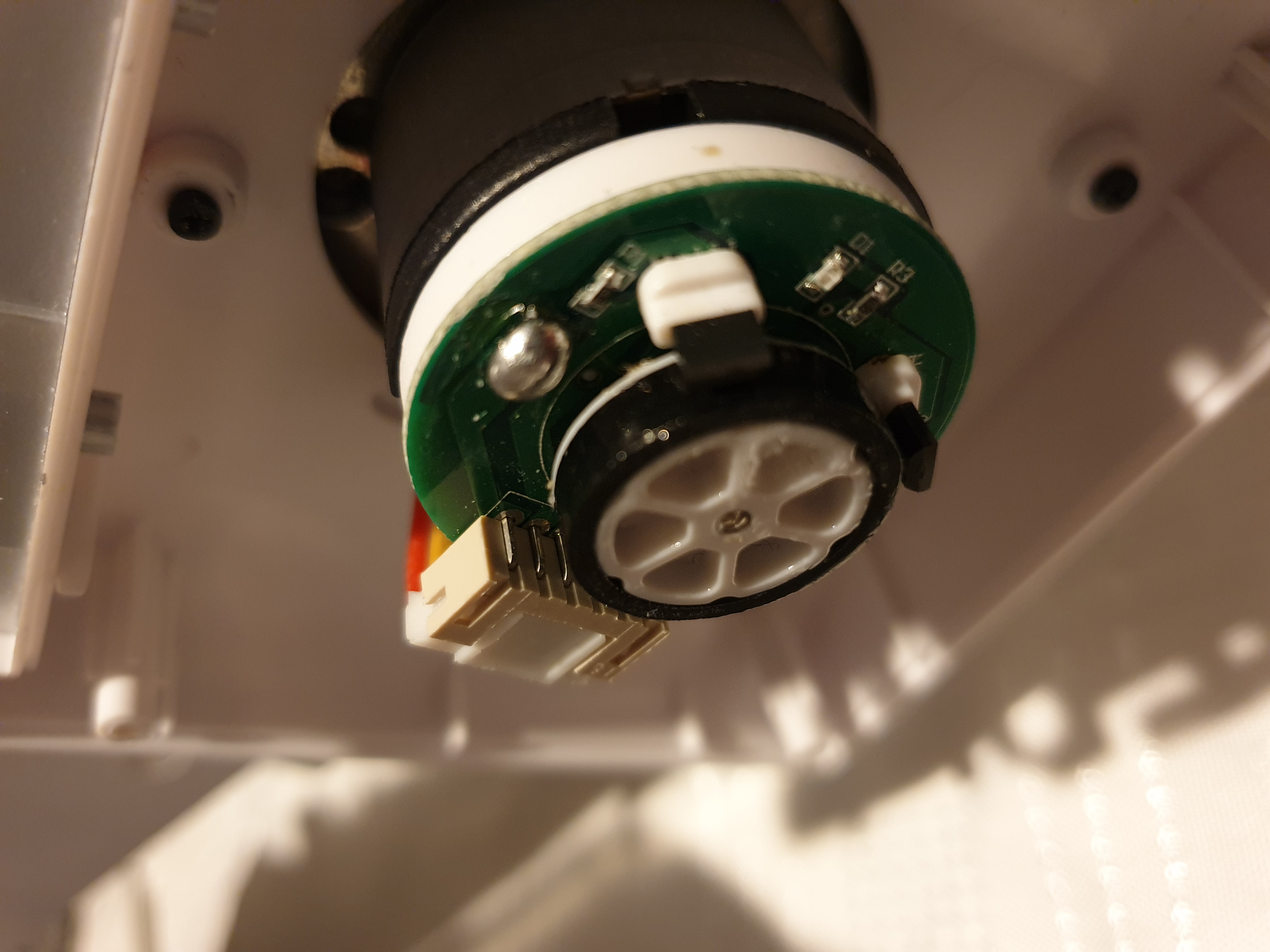

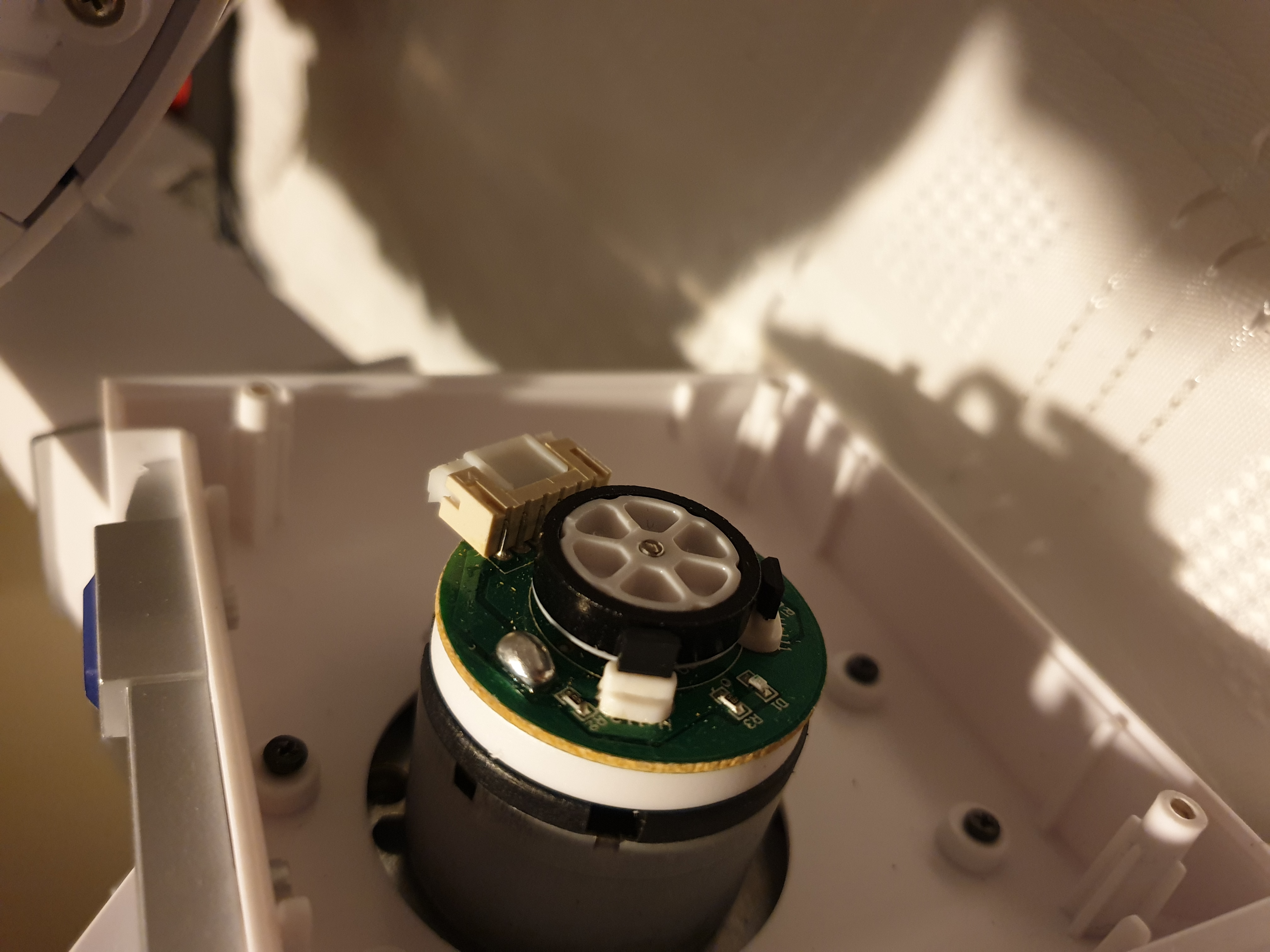

The white wheels both seem to be attached the same, not lose and moving freely.i will attach pictures.

On closer inspection the black rim on one of the wheels isn't as smooth as the other. It has a few small chips taken out of it. Would this effect the speed of it?
